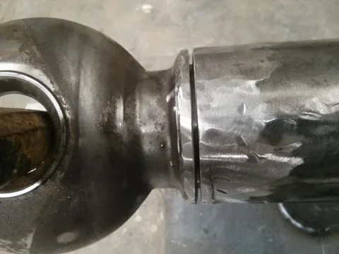

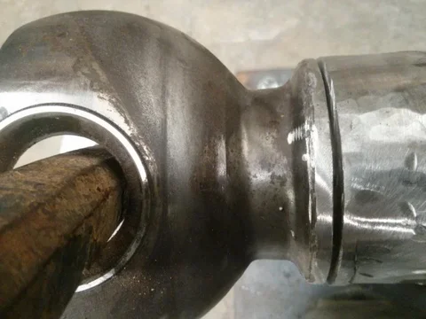

I suppose a brief update is in order:
At some point over the past few days we started the suspension work; we began with the front axle. Late one night, after a series of strike outs, we cleaned up the the front housing and decided to go ahead and cut the ball on the driver's side...just to see what we were up against. After cutting a groove 8 - 9 mm deep and the width of a cut off wheel we tried to turn the ball...nothing. This was with the housing sitting on the floor and braced with a GIANT 4' pipe wrench (everyone has one of those laying around, right?). Ultimately, we called it a night and decided to do some more homework to determine the exact thickness of the outer housing and how deep this cut should be. The next morning (or maybe two mornings later...the past few days are running together), Jrob built a jig.
Here are a few pics of the initial cut and the housing on the jig as we try to turn the ball:
