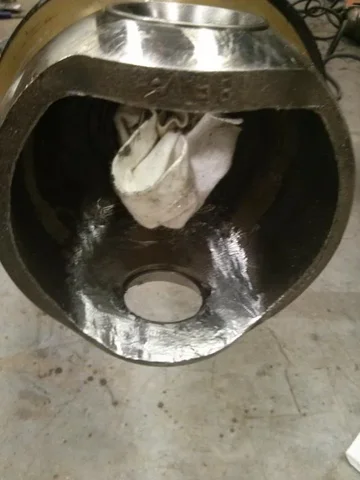

With the cut widened (basically the width of a grinding disc) you can clearly see a concentric ring where the housing and the sleeve of the ball meet. For those interested, that ring is precisely at a depth of 6 mm. Once we made a couple of touch up cuts where that ring was not visible, the ball finally turned.
The conclusion was that we cut too close to the middle of the factory weld and never really separated the material. The final touch up cuts were towards the diff. We also cut too deep (for those keeping score).

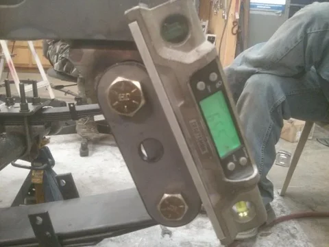

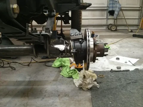

With the balls free, the next step was to put the housing back under the front springs and begin adjusting the pinion angle:
With the balls turned and everything burned in, this is where we ended up:
With the full weight on the front end, the shackle angle should be right at 60* at rest. With the spring completely flat the shackle angle is at 45*. This should allow the spring go into negative arch and pull the shackle back down if necessary...at least that's the theory we were following when putting this together.

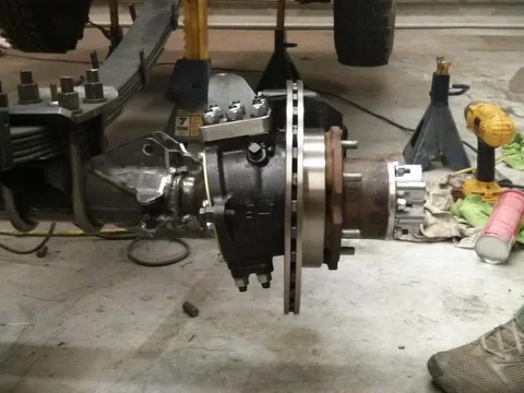

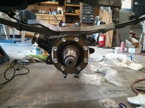

Next step was to convert the FJ-60 knuckles into six shooters using Luke's (4x4 Labs) blocks. Had to grind a bit of the knuckle to get the fit just right.:
Some random pictures of the front axle going back together...
FJ-60 vented rotors and new (a bit longer) wheel studs:

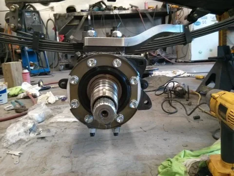

Balls clearanced for Longfields:
A couple shots of the ball gussets:
Lots of grease:

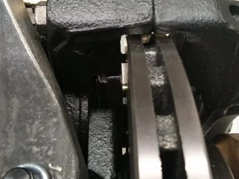

Preloaded V6 4-runner calipers...
There was some gap between the pads and the rotors with the pistons fully compressed...just a couple of shots as there was some initial concern:

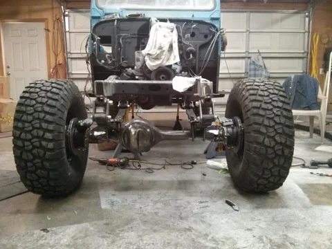

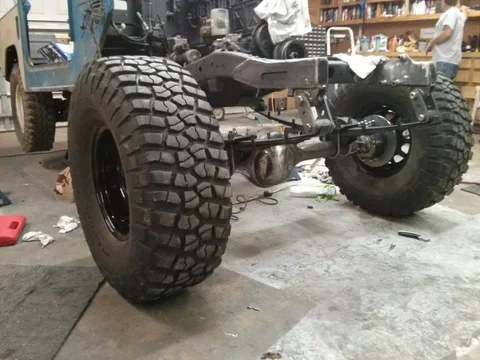

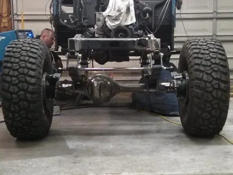

Finally, after borrowing some wheel spacers from Srob, the front wheels/tires were on:
Y'all tell Srob to rest easy...I ordered some new spacers this morning. These will be returned to their proper home shortly.

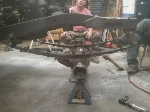

Without even stopping to catch his breath, Jrob grabbed the plasma, and then this happened:

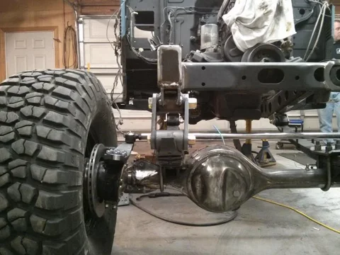

After a bit of figuring, grinding, and welding, we had the rear axle back under there with the truck level and the pinion turned up:

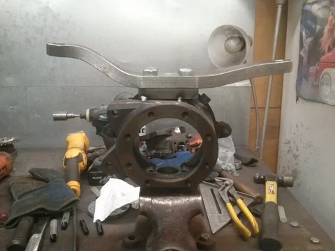

Right now the rear housing is on the bench getting cleaned up. The perches have been burned in, the factory perches have been cut off, and the axle bearings and seals have been driven out. Next step is to finish cleaning it up, get the new bearings and seals in, get the new third installed, get it back under the truck, and do the RDB conversion.
