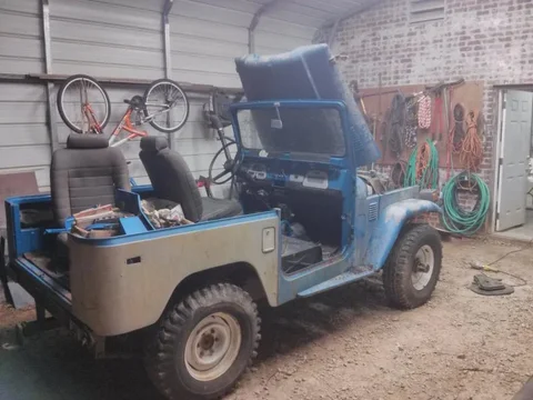

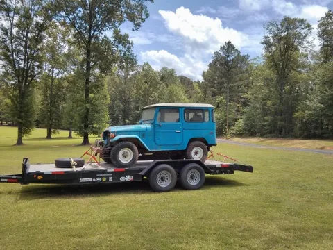

This build really hasn't gotten off the ground yet, but I figured I would start the thread to begin to document things. This is a 1977 FJ that belonged to Bodean's father-in-law. The plan, to borrow a description from another build thread I was reading recently, is to build a moderately capable wheeler with decent road manners. I have no intentions of ever driving this truck across the country, but I would like to be able to cruise around town on the weekends etc.
I've bounced a lot of ideas off many of you, and I'm appreciative of all the feedback I've received to this point. Below I'll outline the plans as they exist today. Quite a bit of this is still up in the air, so please feel free to comment and pick it apart. First, a couple of 'before' pics:

Body has some rust but is in pretty good shape. Frame has a good bit of surface rust. There will be lots of cleanup, sand blasting, coating, etc to do underneath.
Engine turns over, but it hasn't fired up yet. My guess is electrical but haven't had time to play with it yet. On the bright side, though, I've become very familiar with the '77 wiring schematic :)
