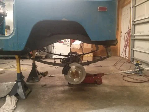

Are you planning to trim the rear panels or does the SOA give you enough room for those 37's?
It's pretty high, so I suppose the tires might fit in there without any trimming if the axle were in the stock location. We've moved the axle a bit towards the rear, though, so, as it sits now, there's no way.

Got the rear axle back together...
New shafts and wheel studs (these are a bit longer as well to account for the addition of the rotor):
Axle cleaned up and rebuilt diff installed (the wire wheel and I have gotten way too intimate):
Ruff Stuff diff cover:

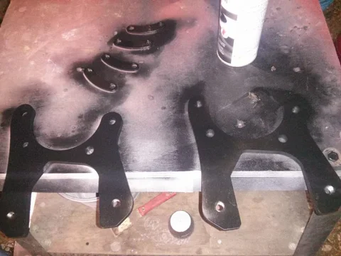

RDB brackets from Poser (from his 'kit'):
Rear calipers (pic shows the small tab ground off...for documentation sake as this issue has popped up in many threads):
One more of it installed:
Jrob and Bodean got the rear brakes plumbed. Under the hood we got the intake cleaned up and reinstalled along with the new header. We also got the new clutch master, brake booster, and brake master installed.
I didn't get many pics because the phone died. Overall, though, a pretty productive evening.
