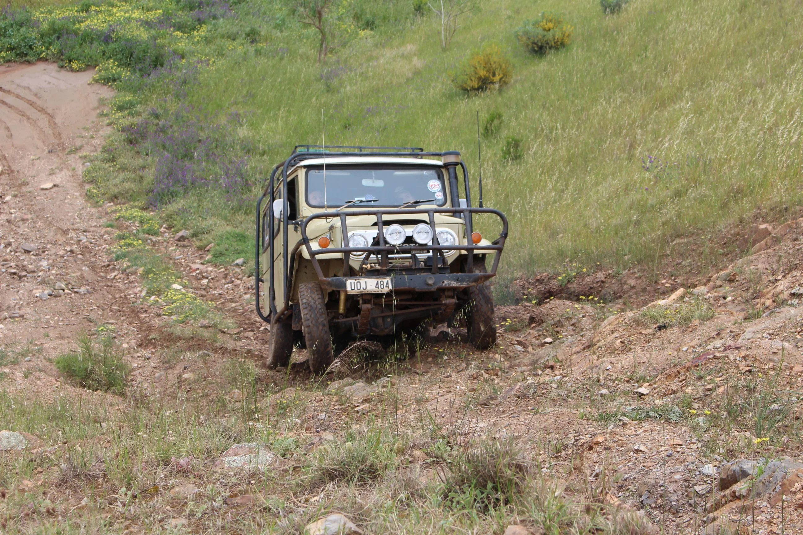

JP147's HJ47 Troopcarrier
Back to the Vic alps again, this time in winter
full
for another 40 series meeting
full
full
full

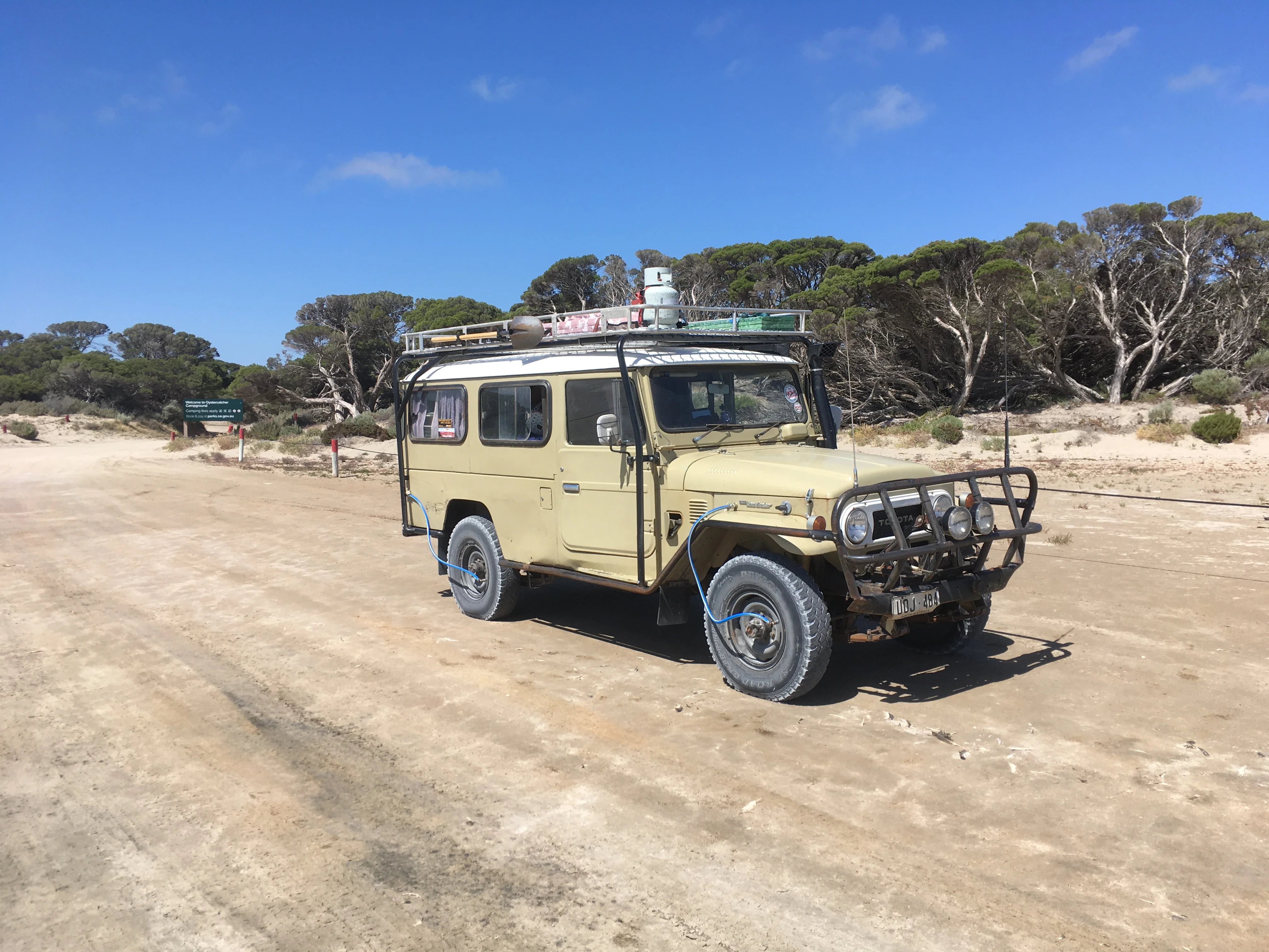

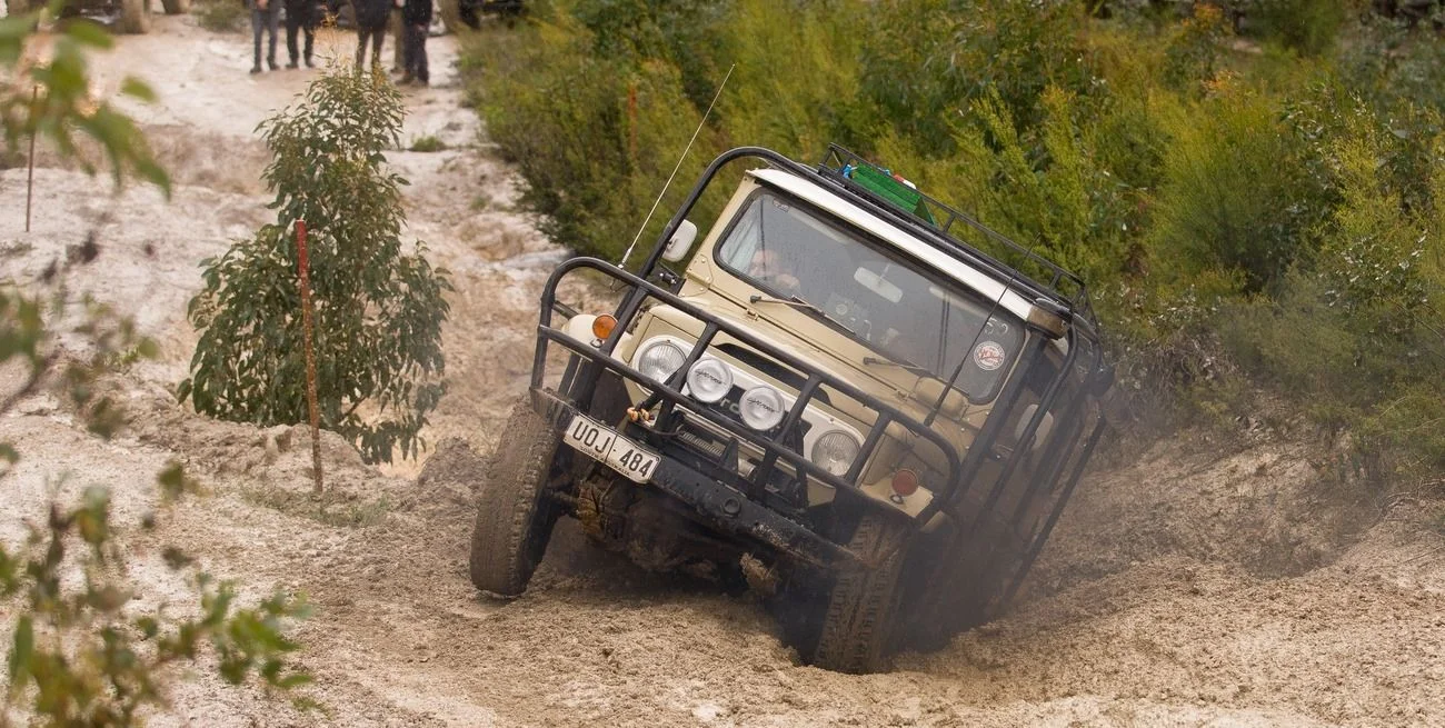

Super cool rig mate. I know it's awile back but what did ya think of the border track and how long did it take? Pretty keen to do it my self. Also, any dramas with the harrop in the front?
Thanks mate.
I have done the border track a few times, always found it easy. Some people have trouble with the sand dunes but I have always been able to idle up them, low tyre pressure is the key. I think I had around 12psi.
Be careful with the bog holes at the end, some can be over roof level when full of water. Test with a stick if unsure, the deep ones can be avoided.
I have had no problems with the Harrop locker. I hope it holds up because I like how it briefly unlocks when changing direction, makes adjusting the line much easier with no power steering.

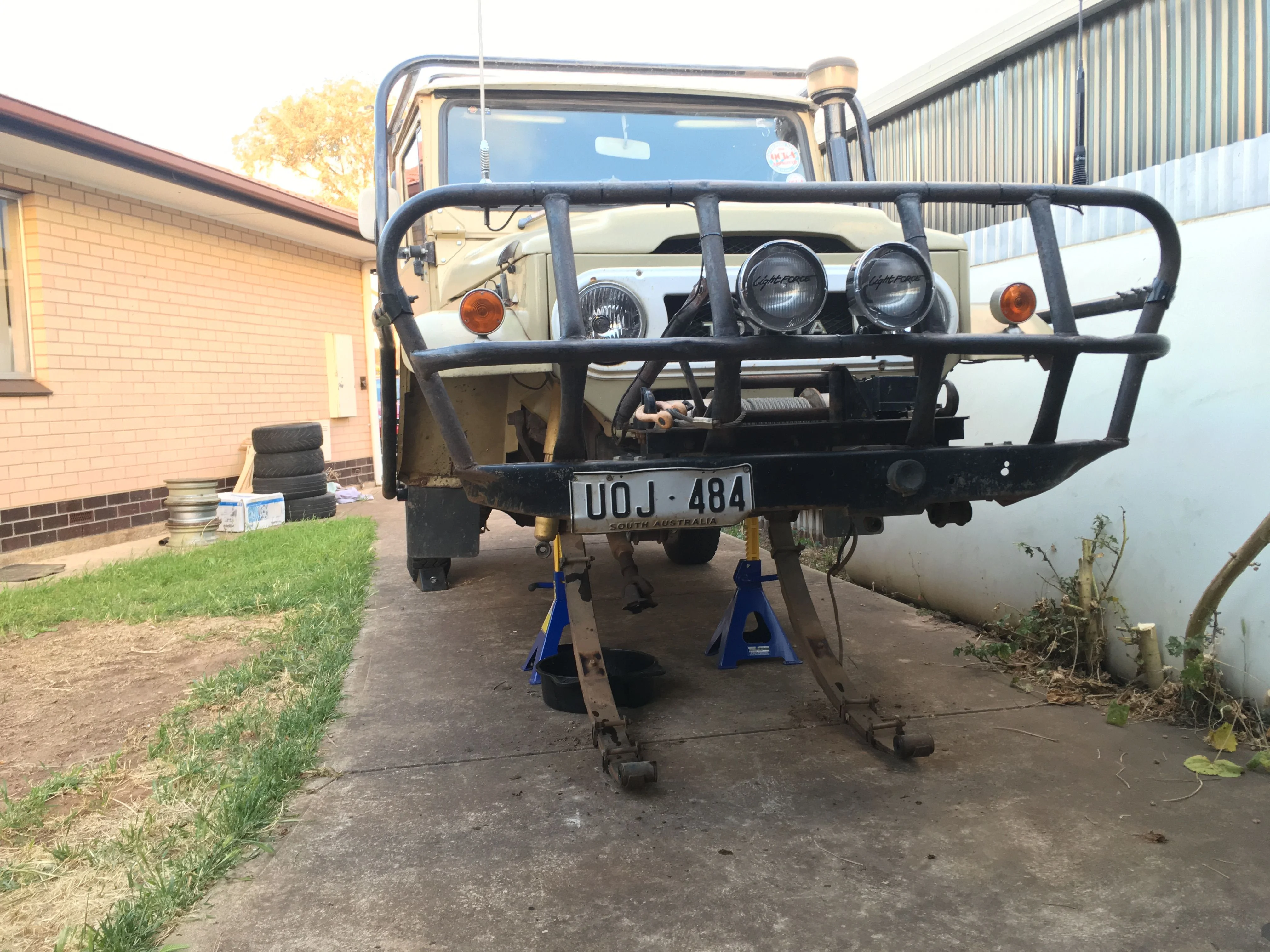

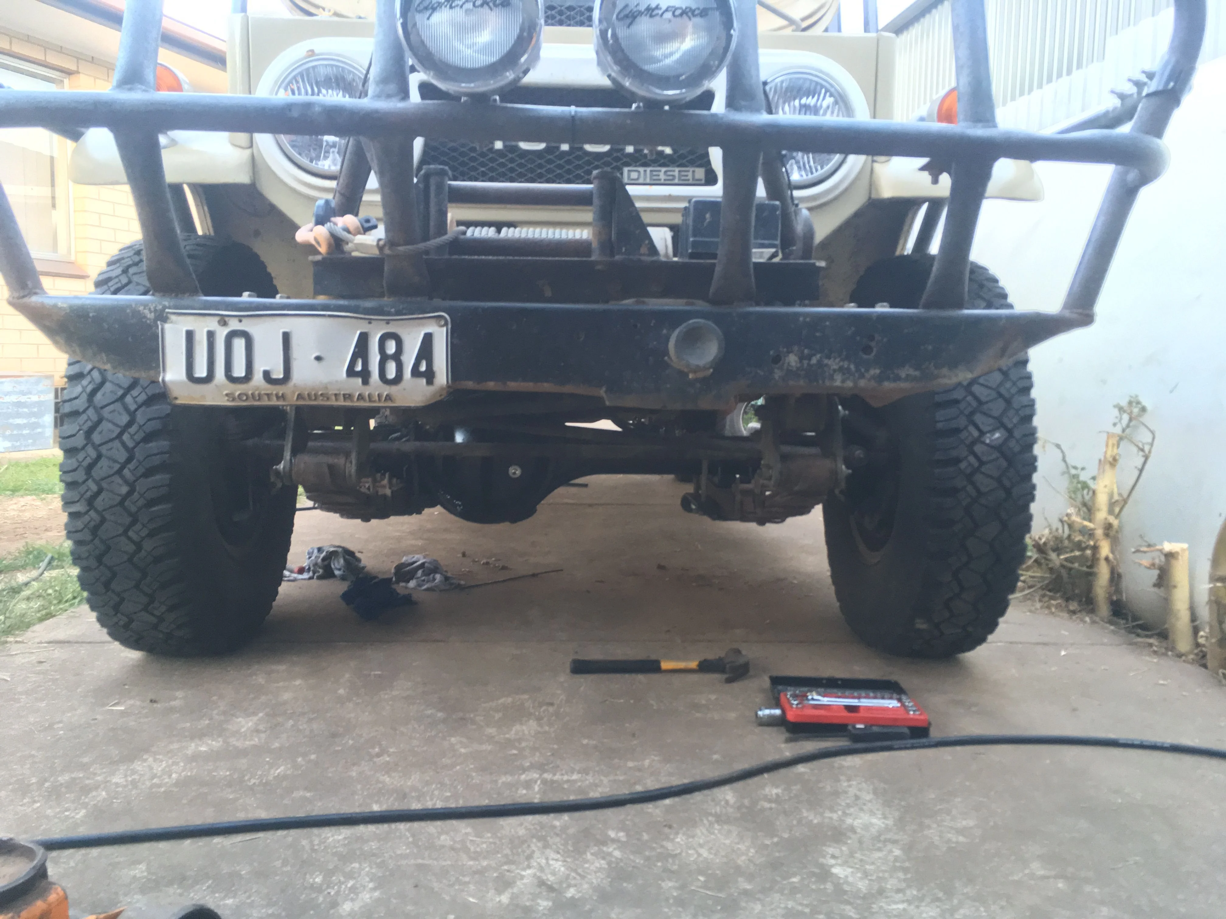

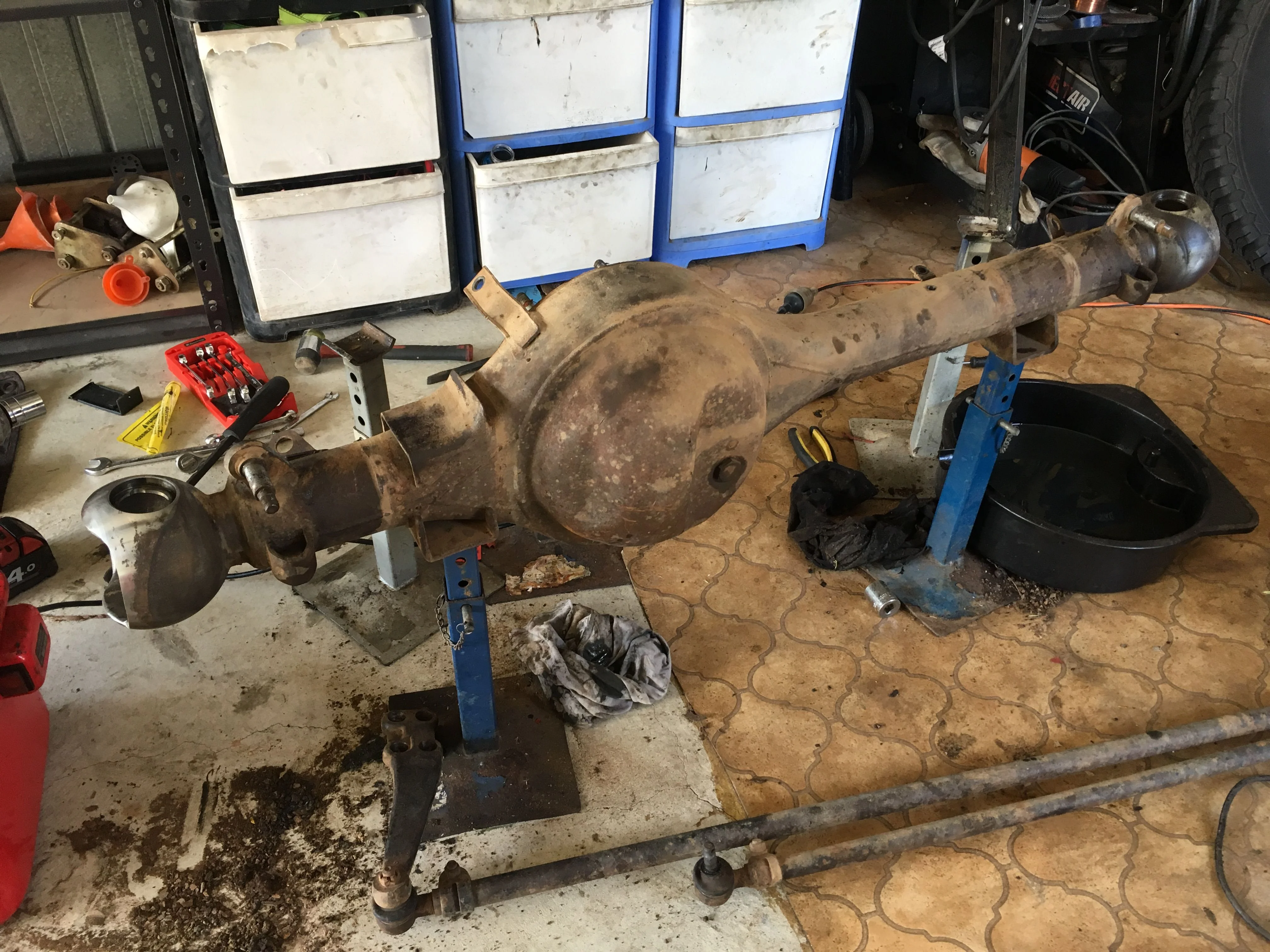

The front axle needed some work so I brought it into the shed
full
full

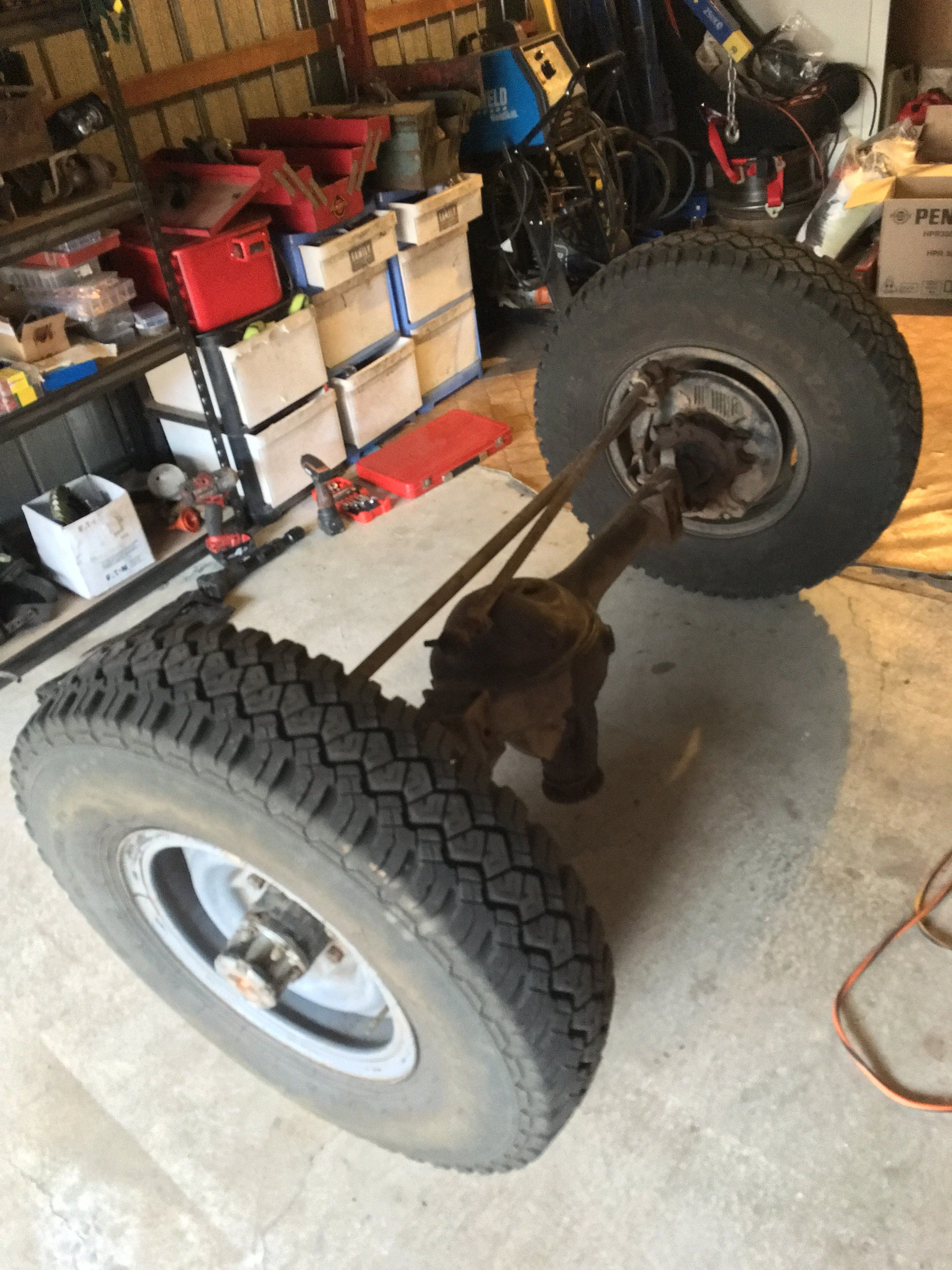

Stripped down
full
The front cover was dented and the drain plug was damaged to I welded on some protection
full
full
Old gears from the rear diff now in the front, they can run on the fresh side of the teeth
full
Chromoly 30 spline

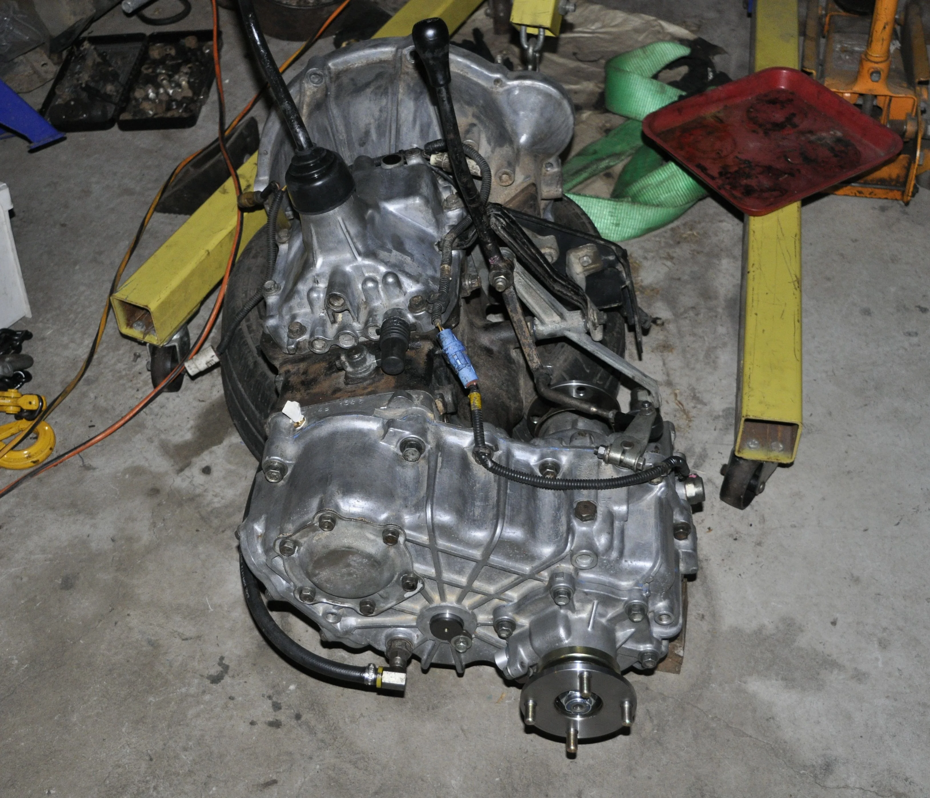

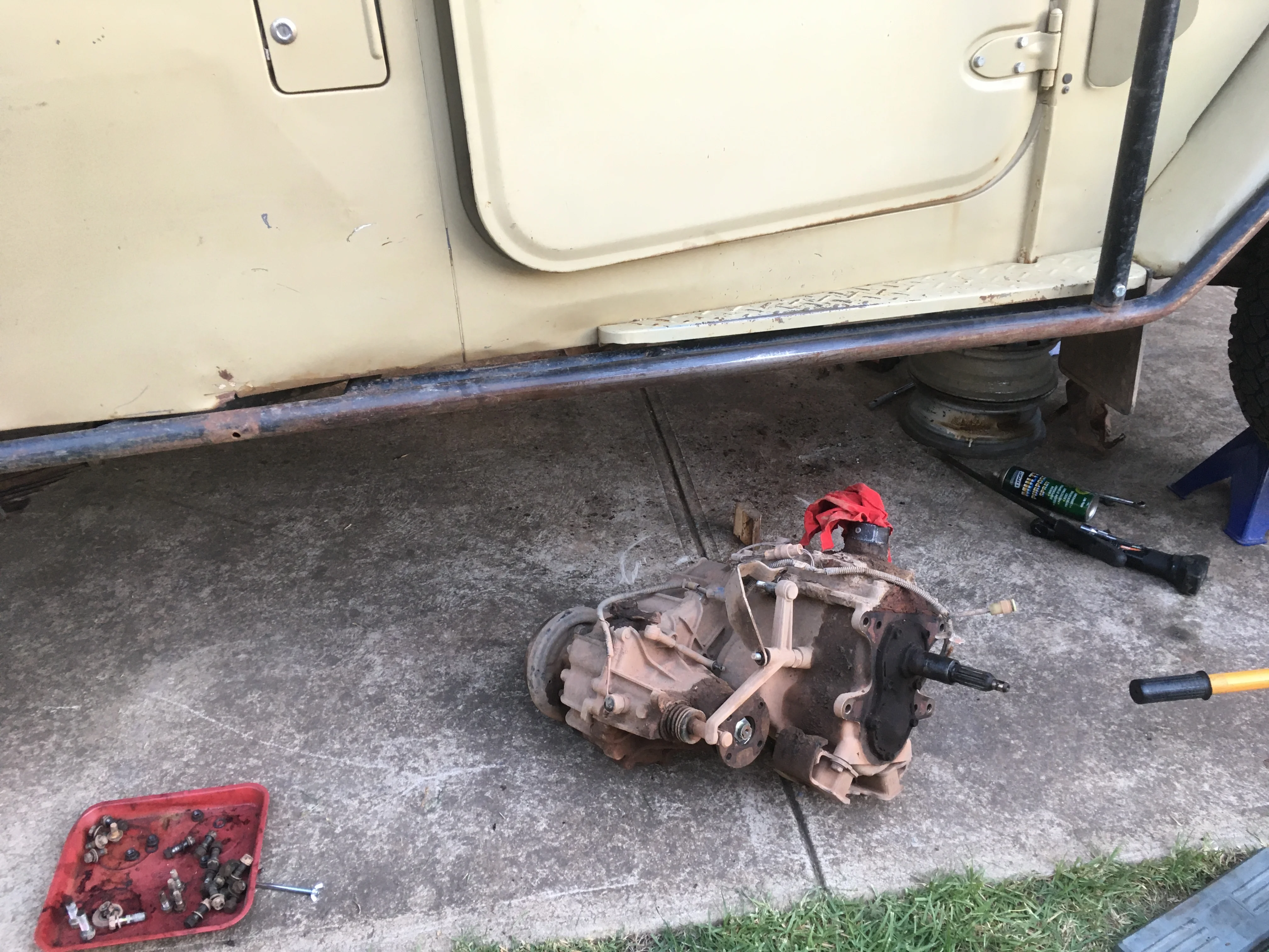

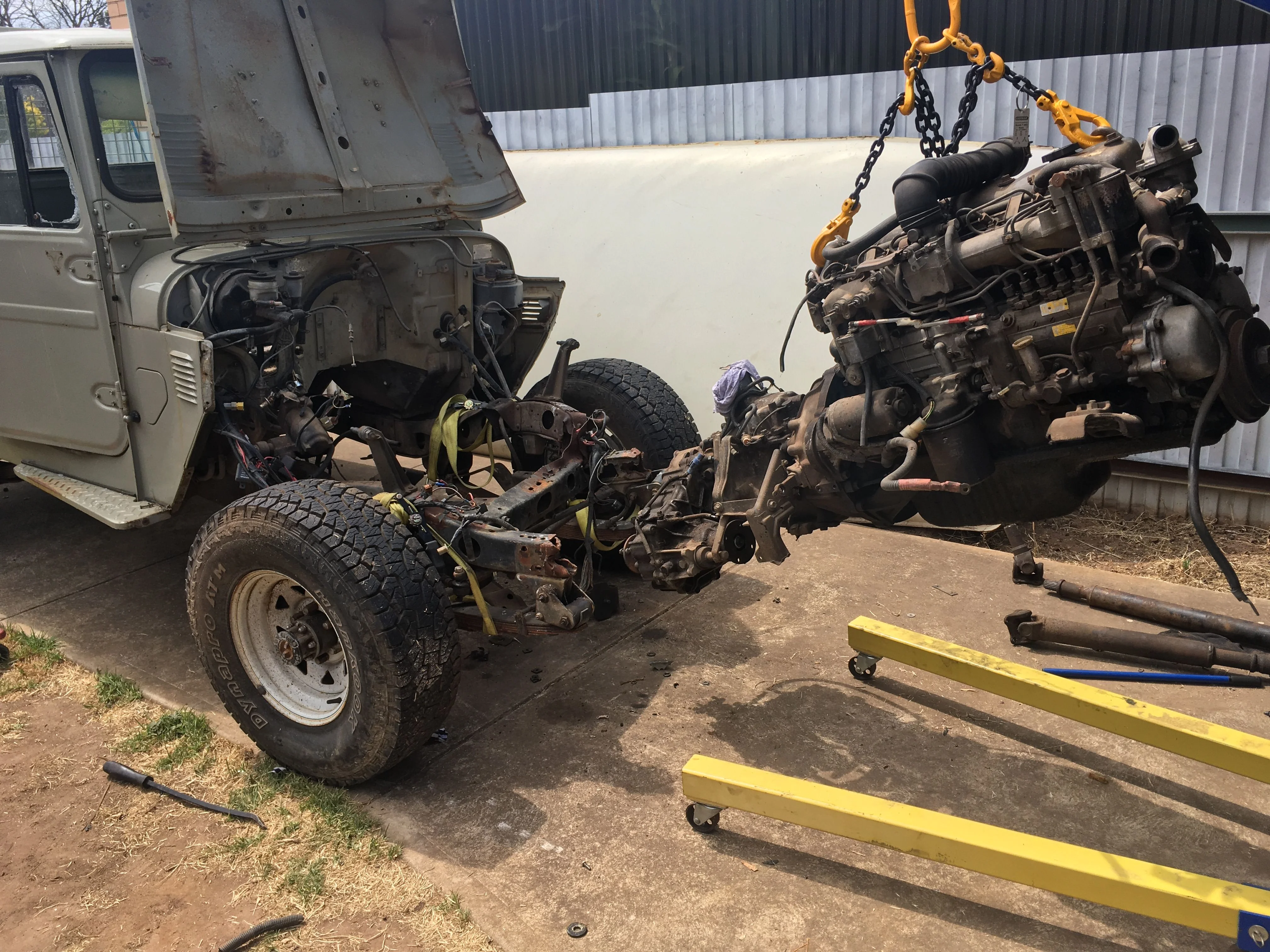

Got a parts car, 1984 HJ47 with 5 speed conversion. H55F from a HJ60 Land Cruiser.
The 2H engine was recently rebuilt but I pulled it apart and wasn't happy with it so that will be for spare parts when I rebuild mine.

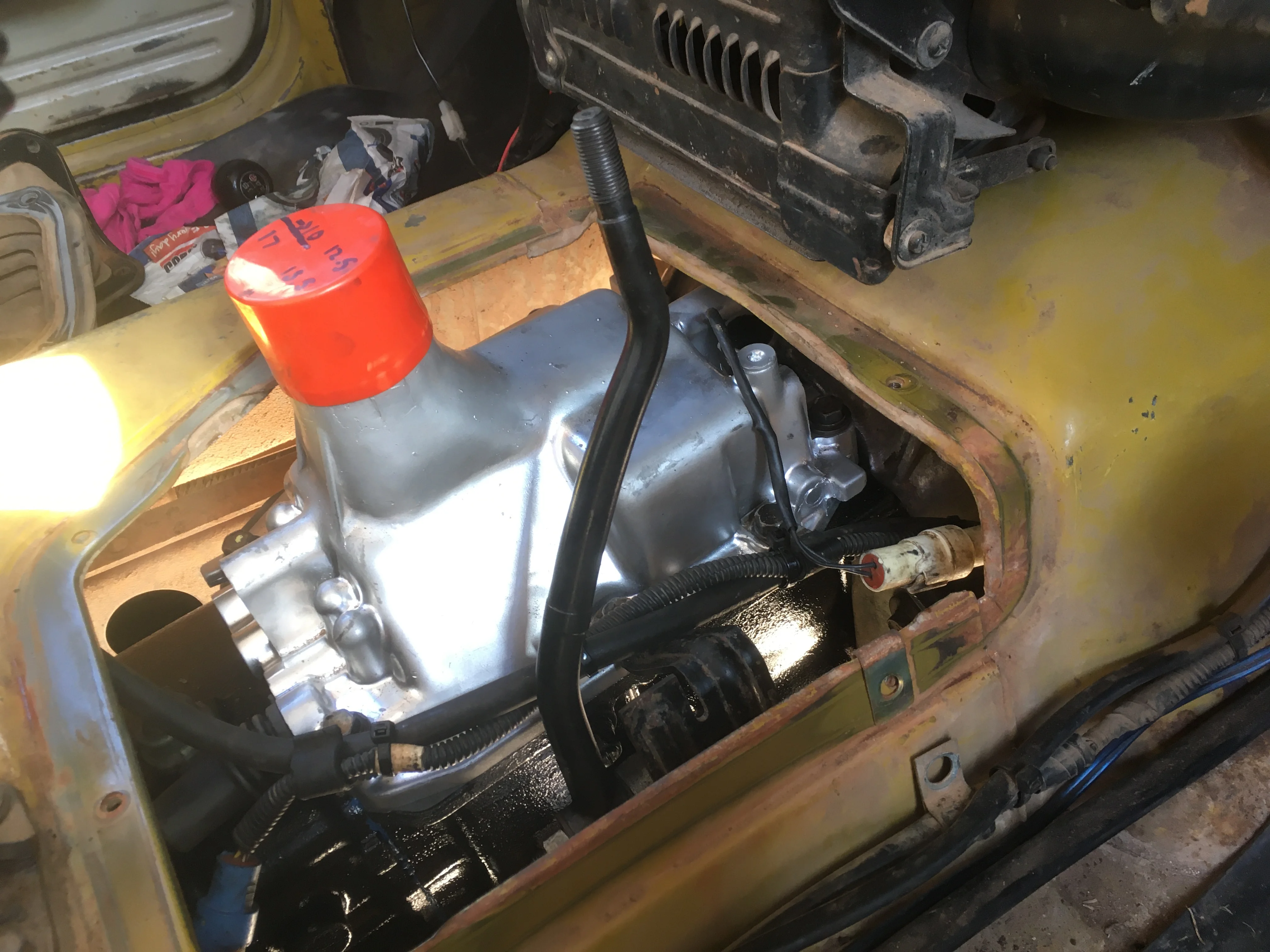

Put some 3:1 low range gears and a breather fitting in the 5 speed. This will go in the car later on when I get the time.

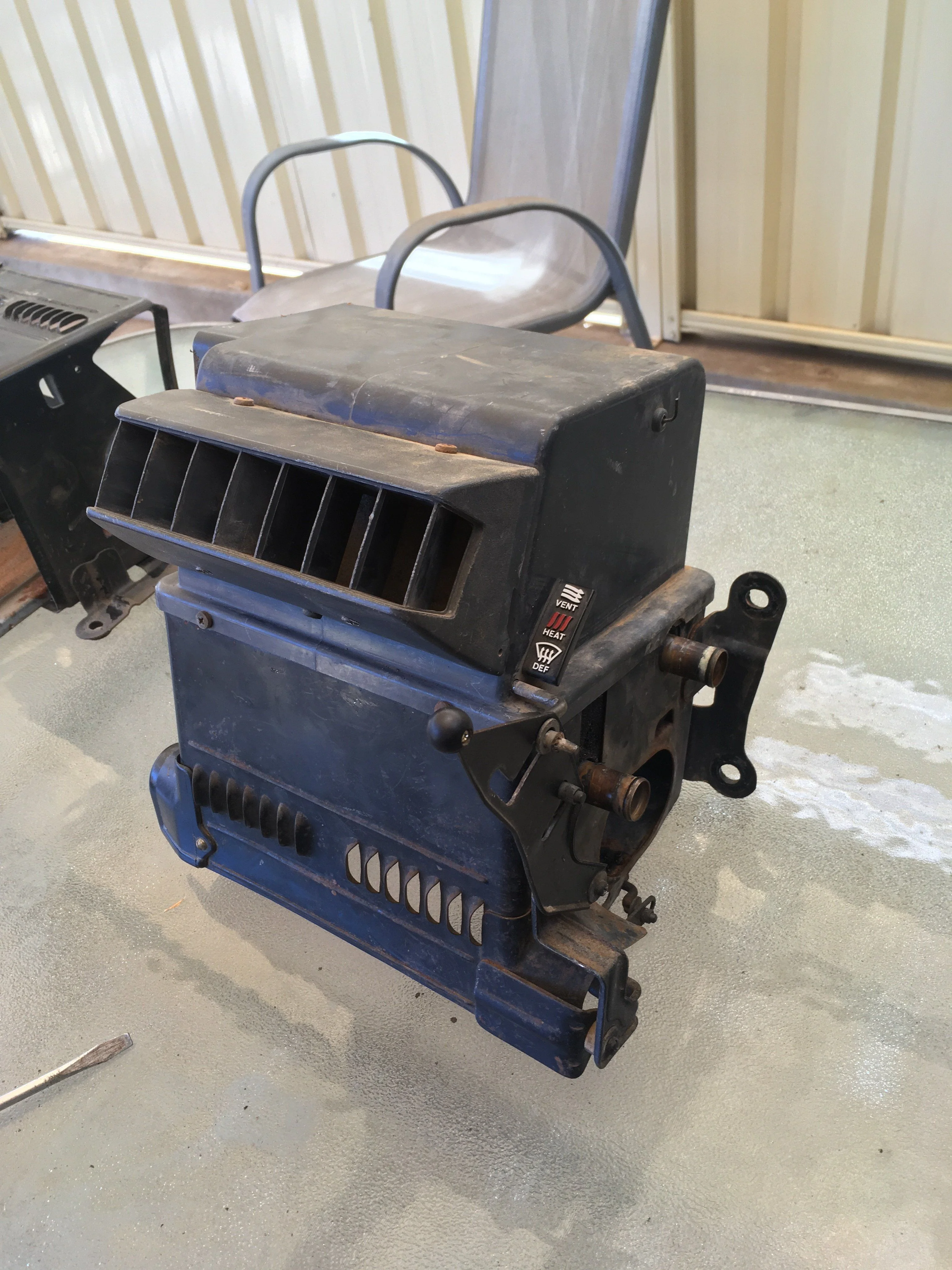

Got the heater working with pieces from 3 different heater boxes and got a new heater tap

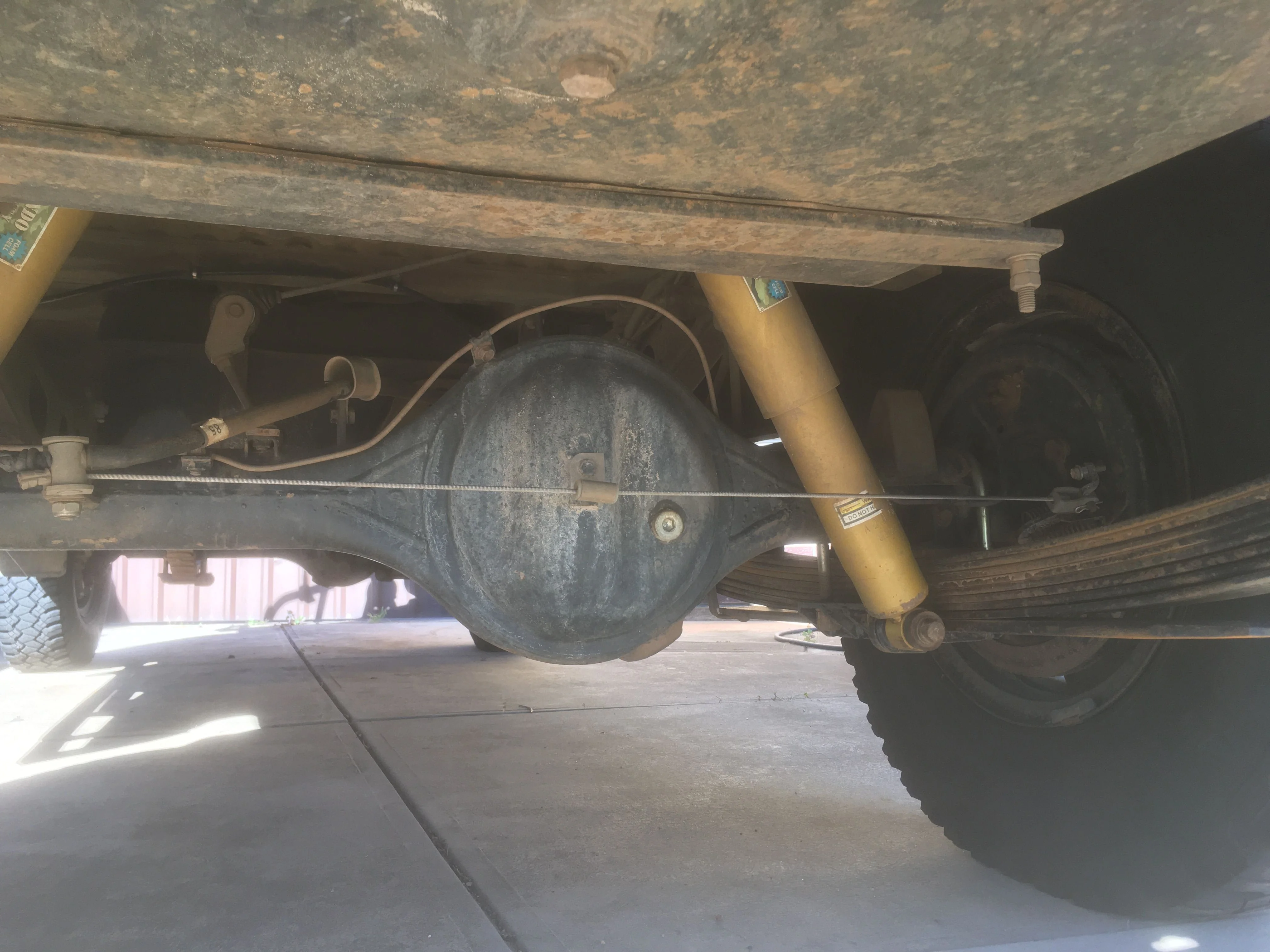

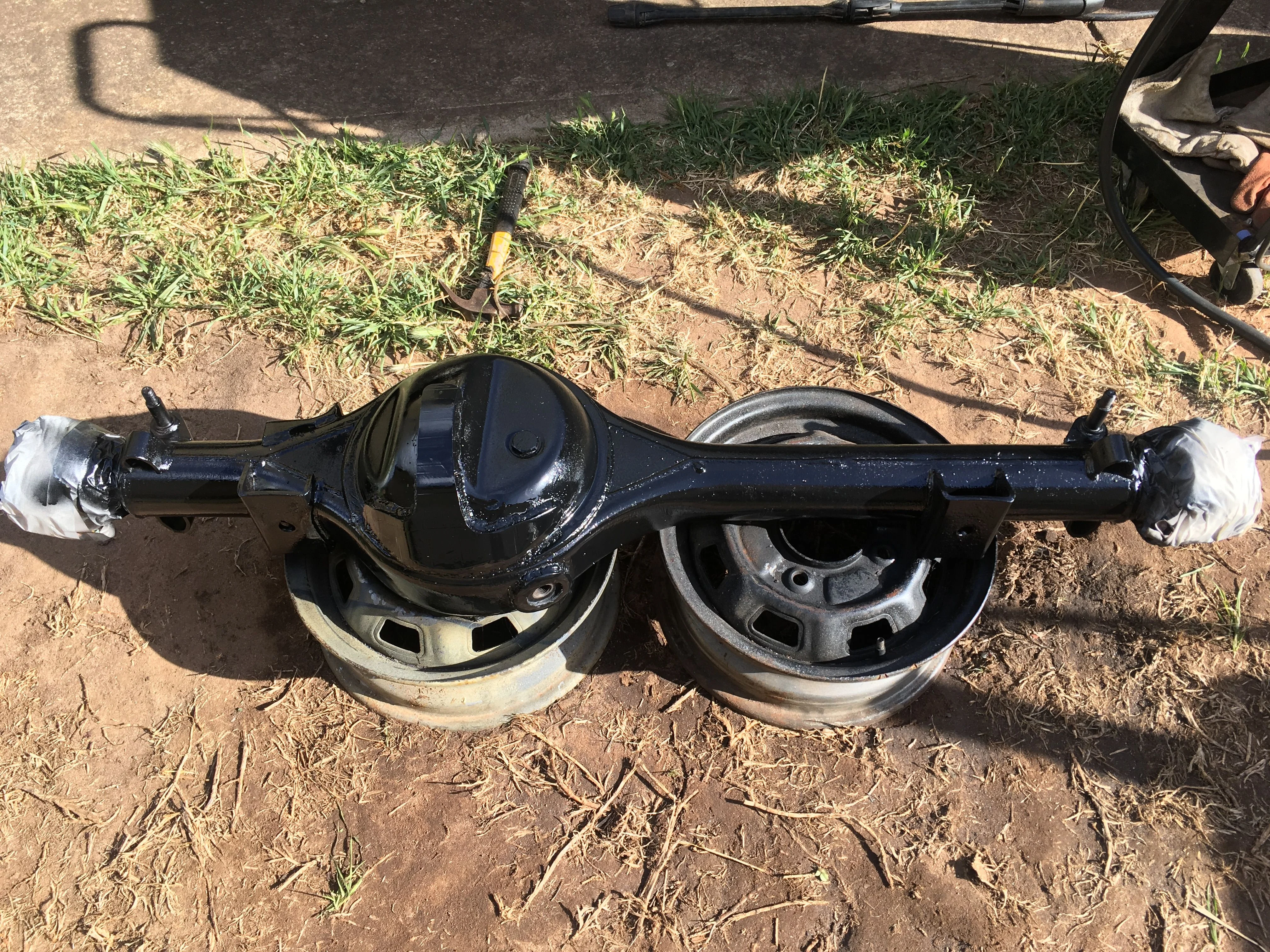

60 series hand brake installed on rear axle, I also replaced the whole rear axle housing because the one from the parts car was in much better condition and had the mounts already welded to it.
Old and new:

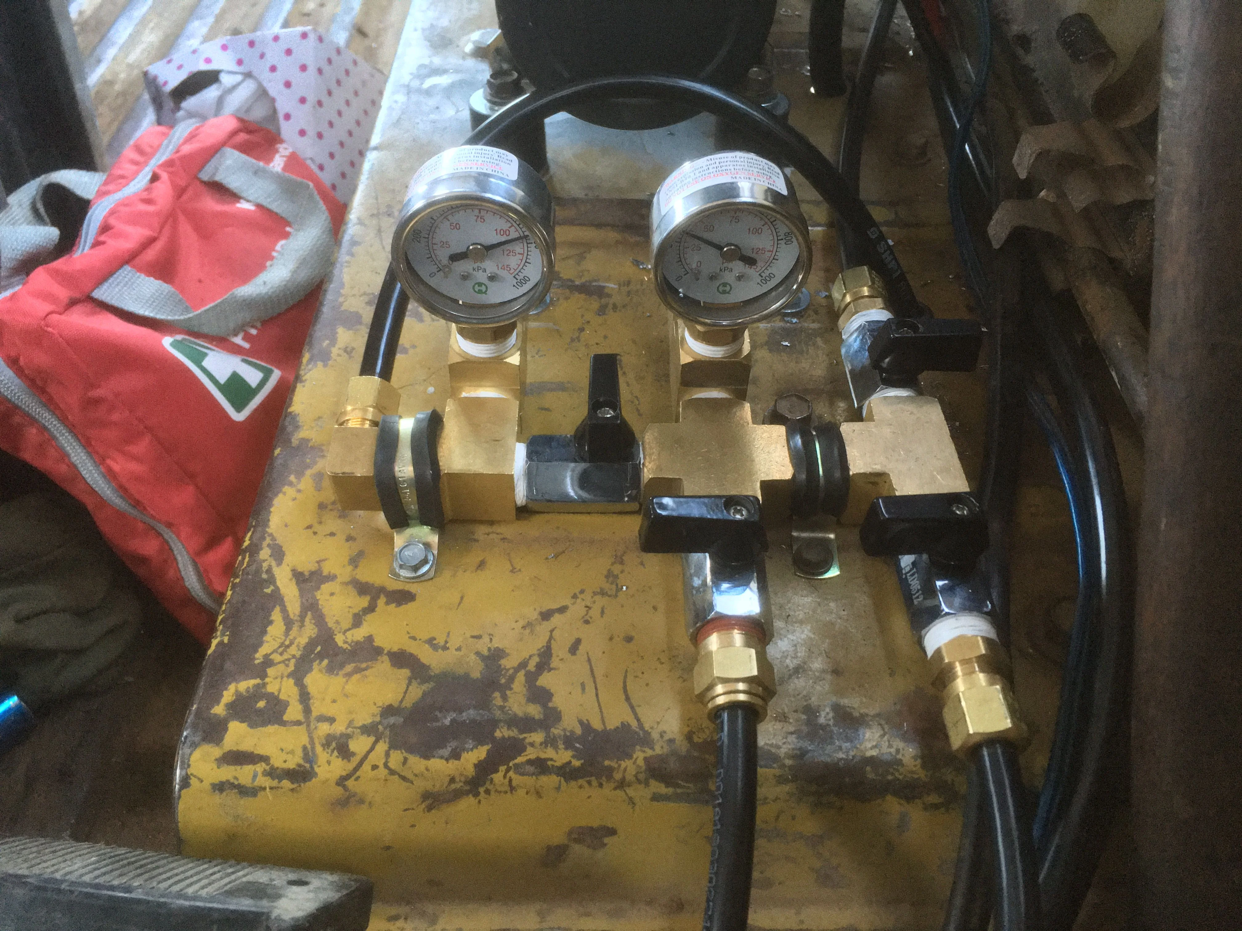

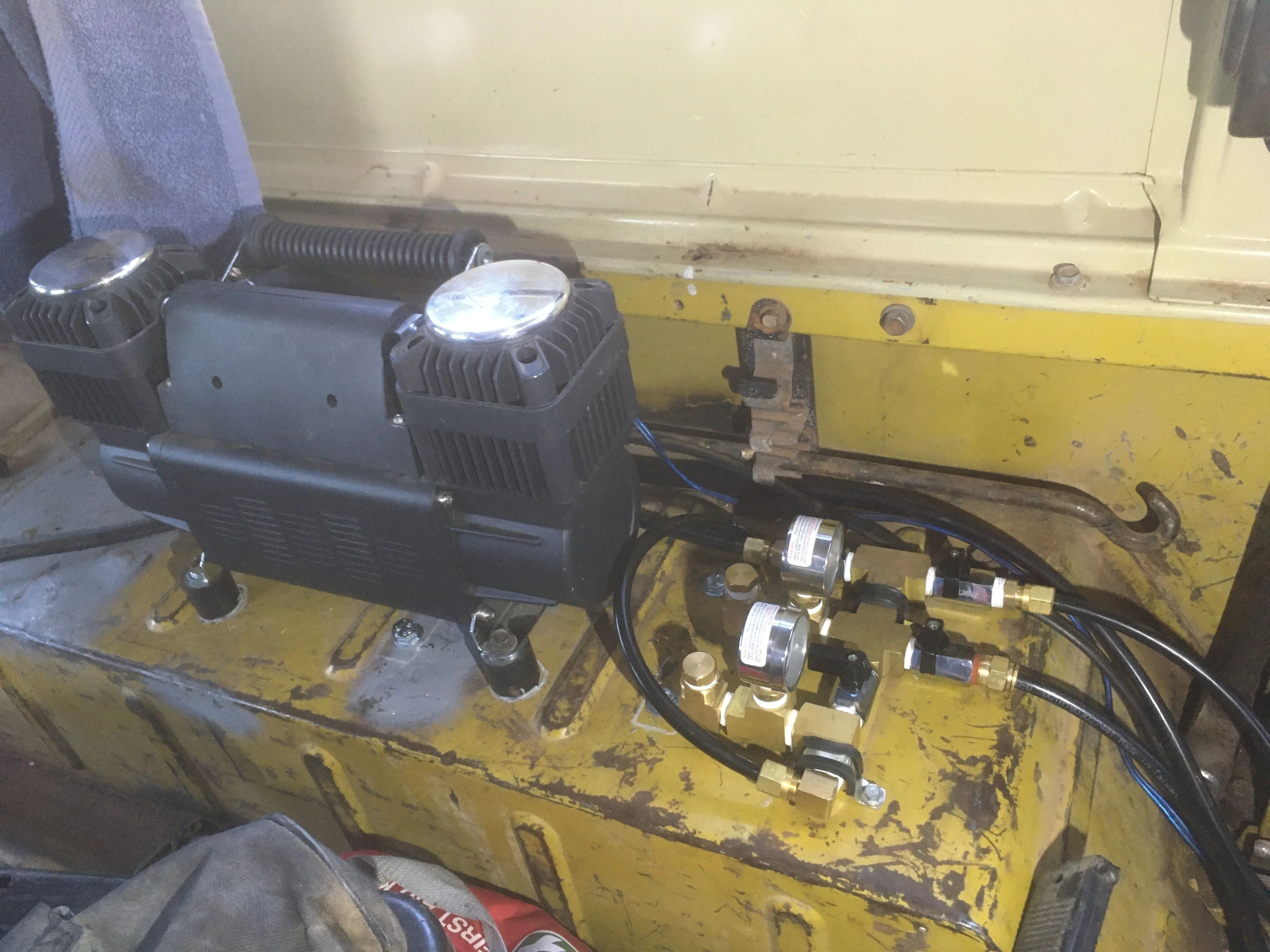

I wanted to make inflating and deflating tyres a bit quicker and easier so I set up this air system.
Air compressor mounted out of the way under the bed

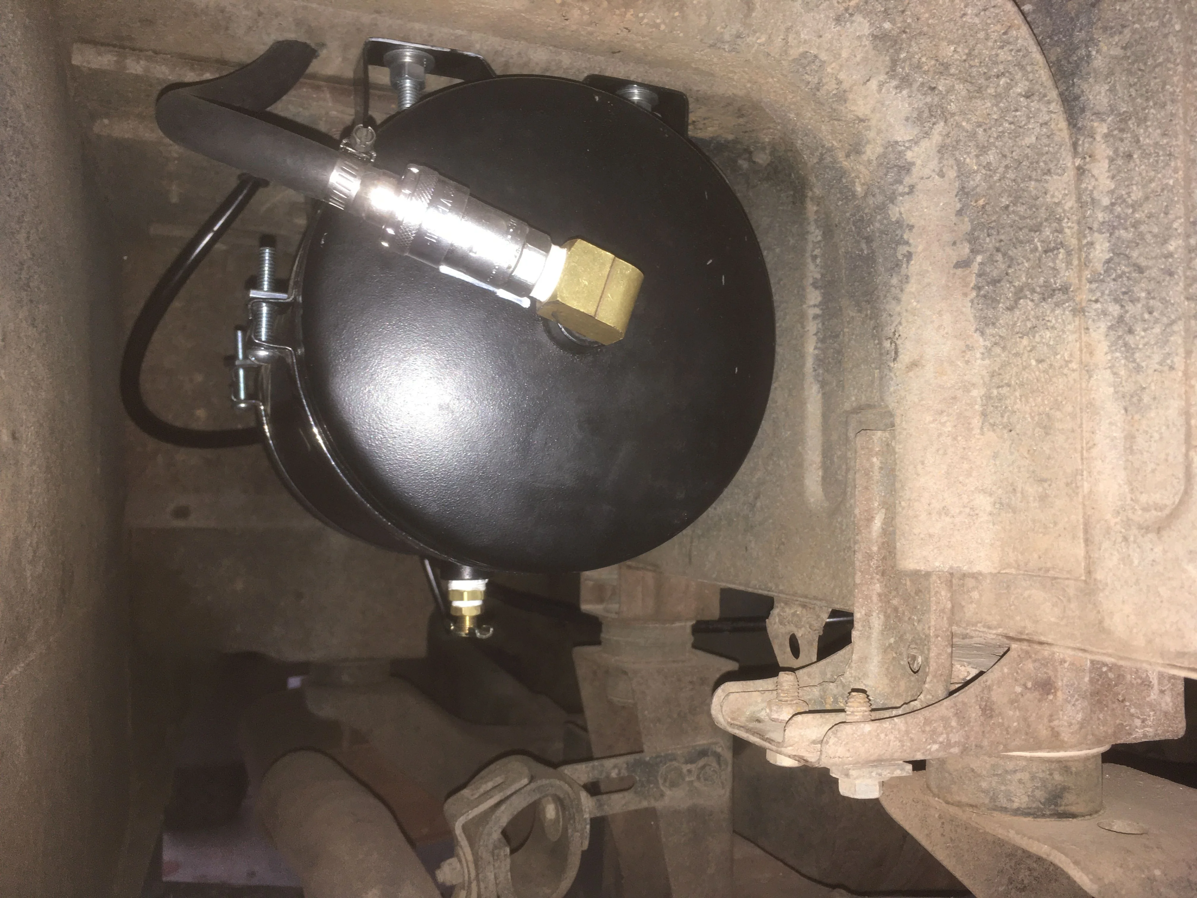

Fills an air tank under the floor. Compressor cuts out at 120psi and back in at 90psi

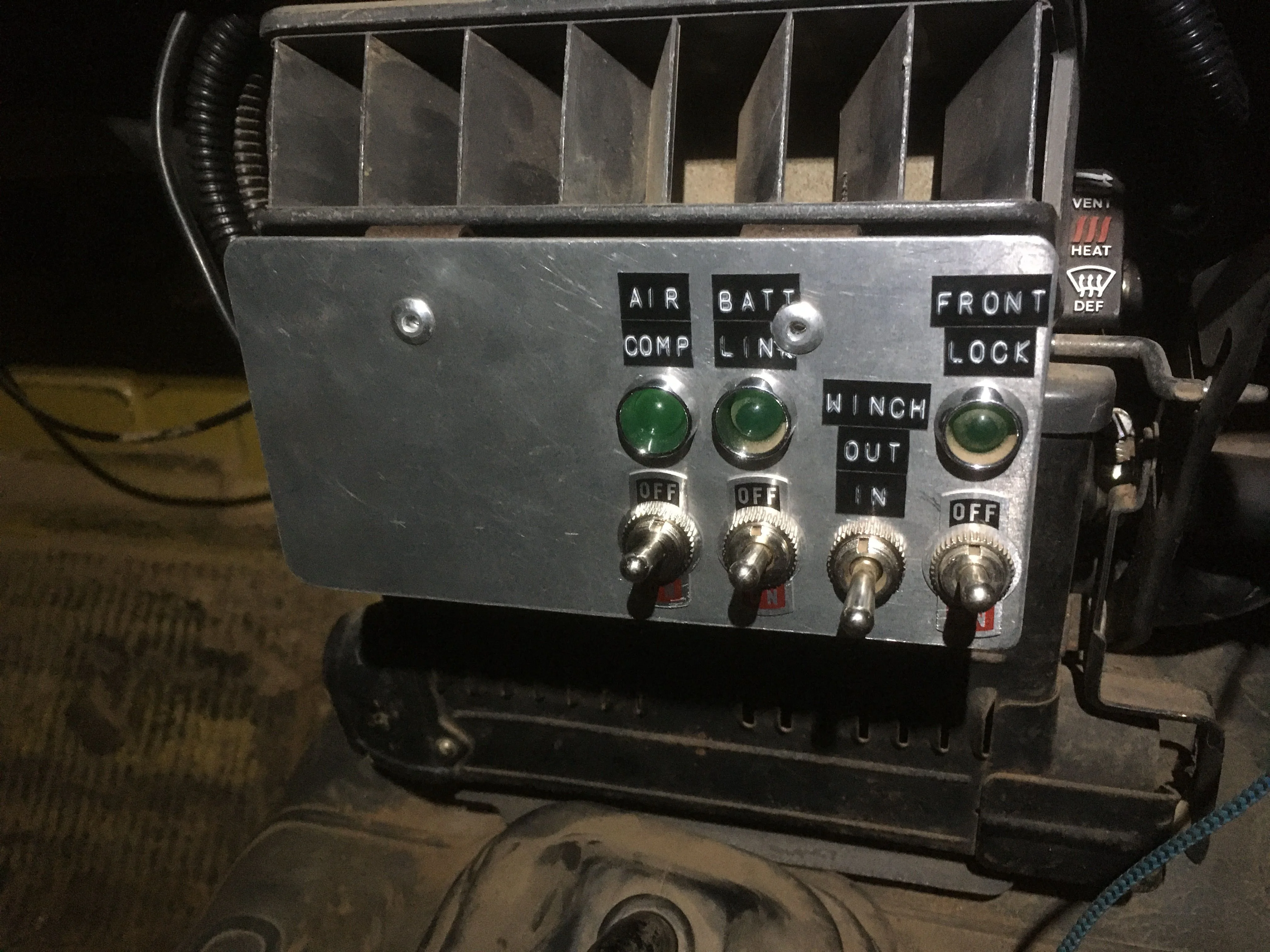

New switch panel
Gauges for tank pressure and tyre pressure. The taps are for inflate, deflate and to close of front or rear if different pressures are needed
4 Nitto air fittings on the body
4 hoses to connect to the tyres when changing pressure
Deflating from 40psi to 10psi takes under 2 minutes. 10psi back to 40 takes around 2 minutes 30 seconds.

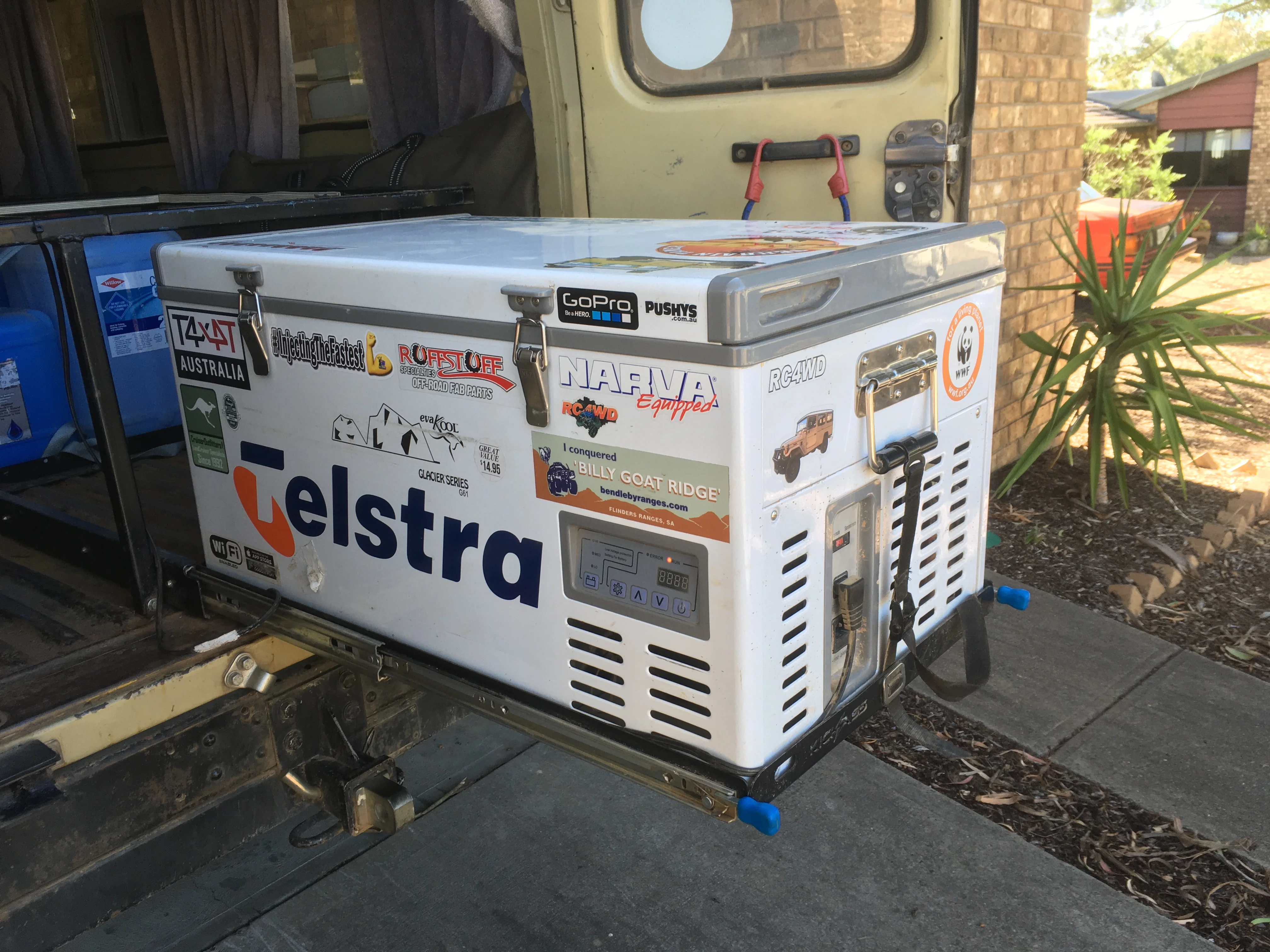

Fridge slide

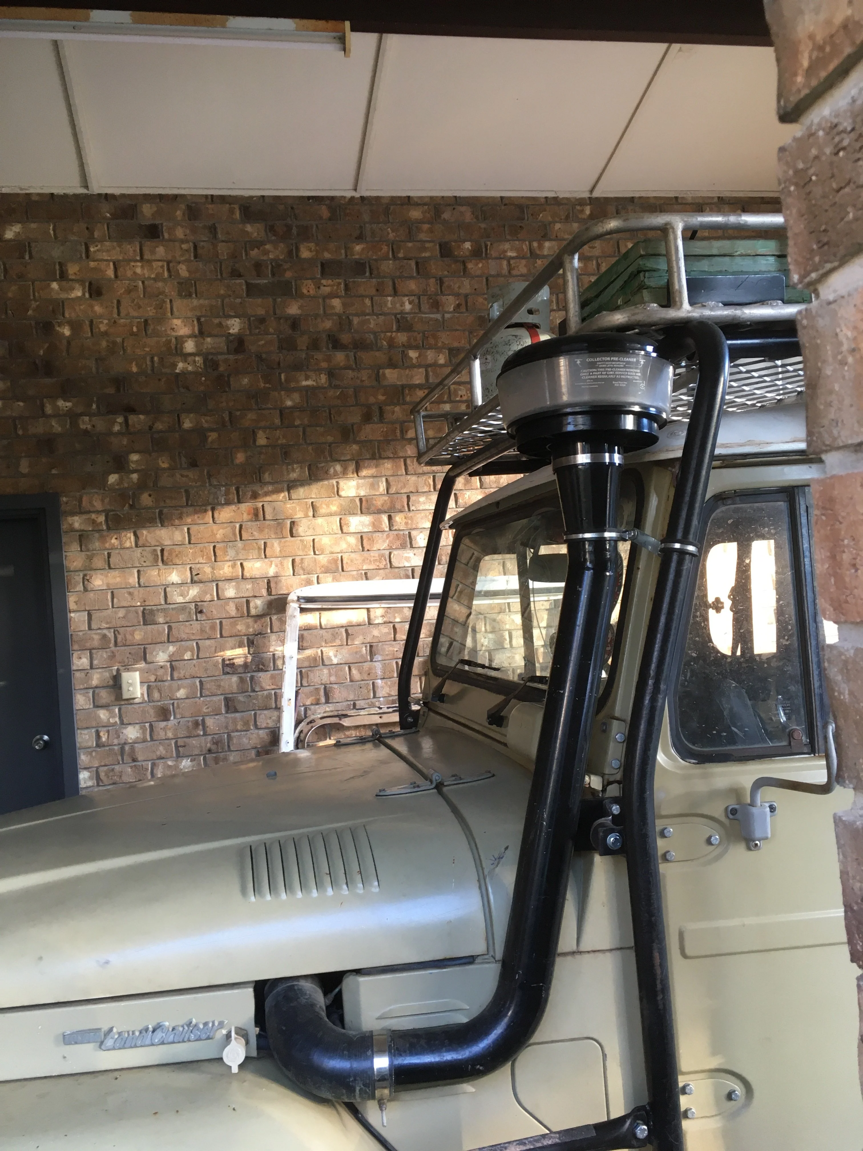

Larger size of pre-cleaner on the air intake. The small one didn't have the correct airflow for the engine and the ram head was letting too much dirt in.

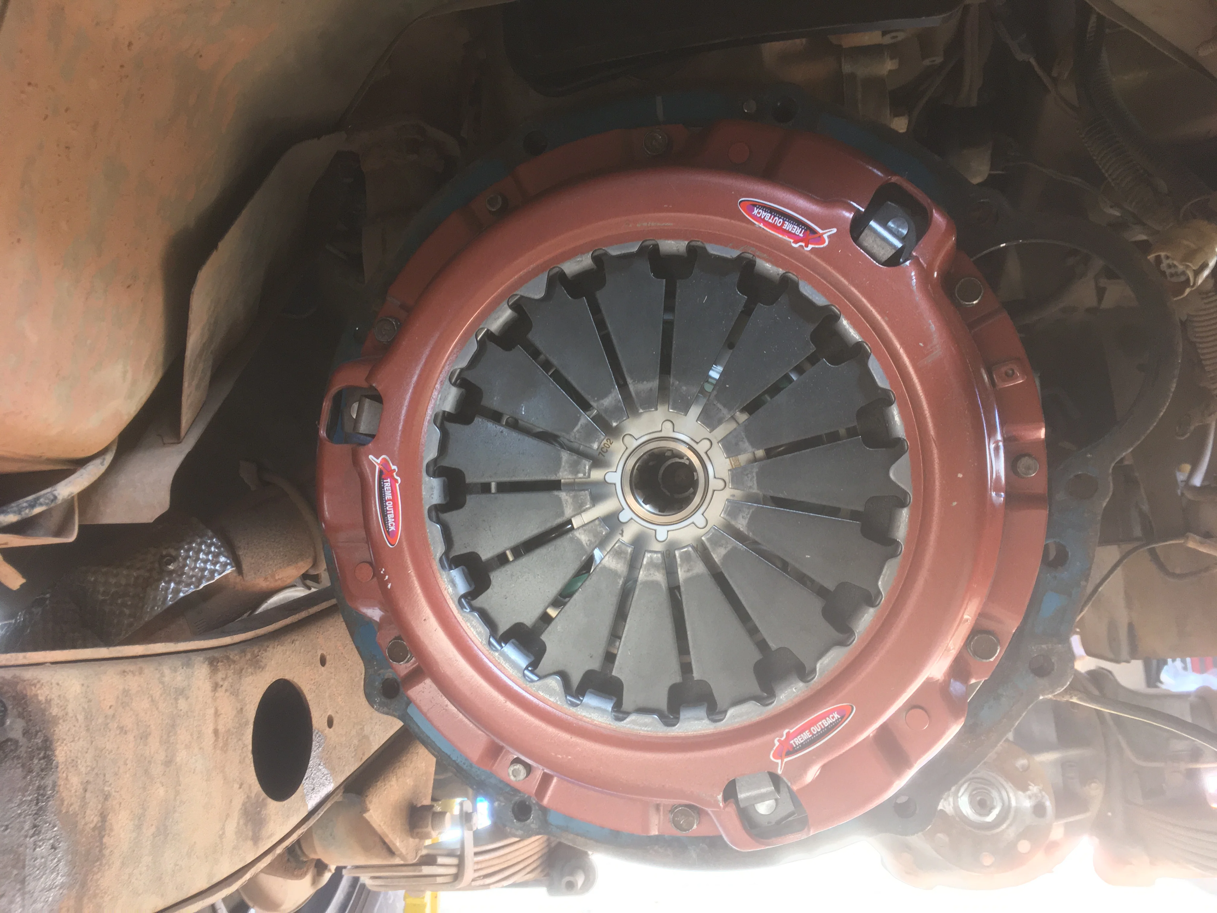

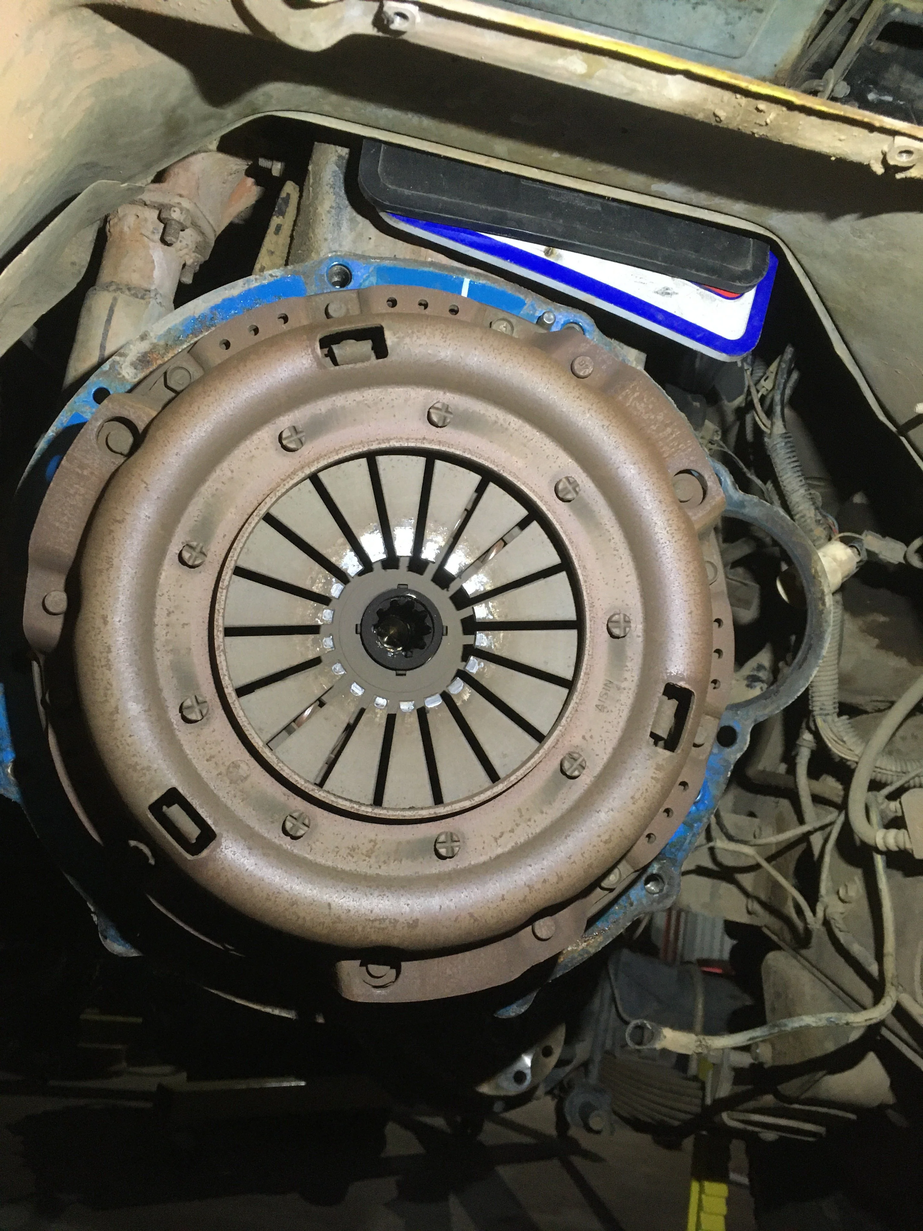

4 speed out. Was a bit old and tired but still worked well.
Old Aisin Clutch, possibly still the original. There was lots of material left and it worked well but the spigot bearing and release bearing were noisy.
New heavy duty clutch with Aisin friction disc.

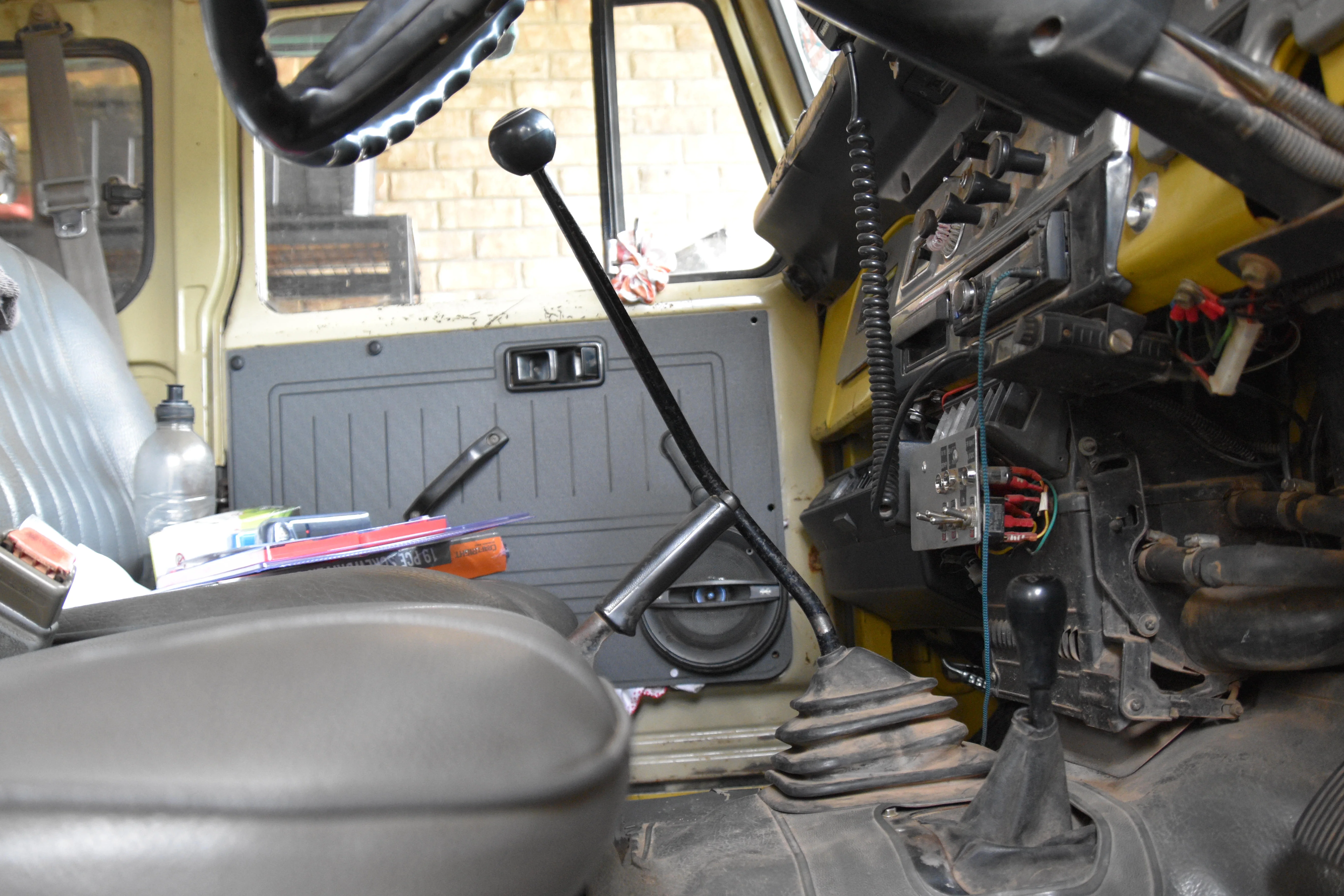

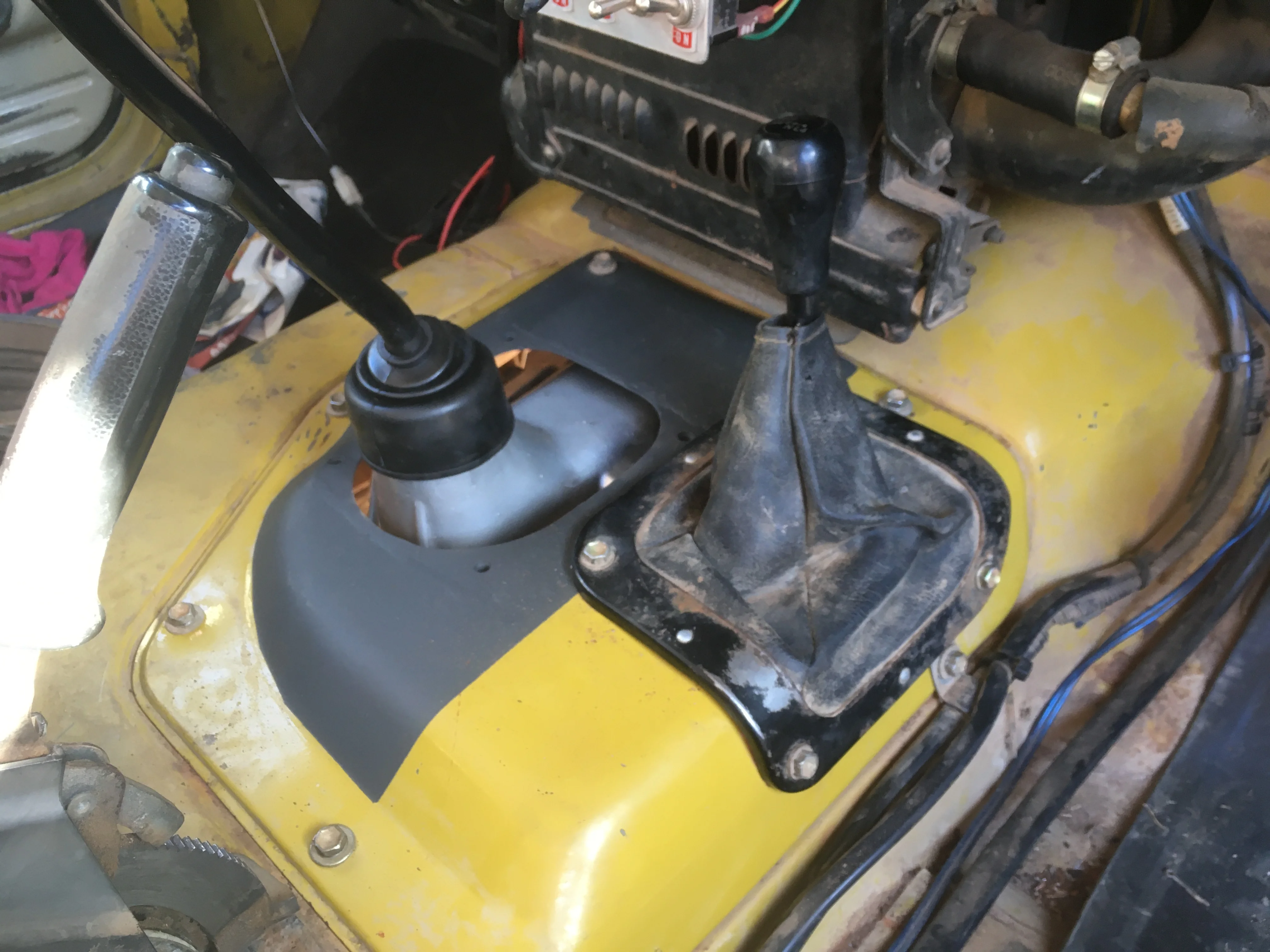

H55F 5 speed in (with the 3:1 transfer gears)
Floor panel modified for new gear stick location

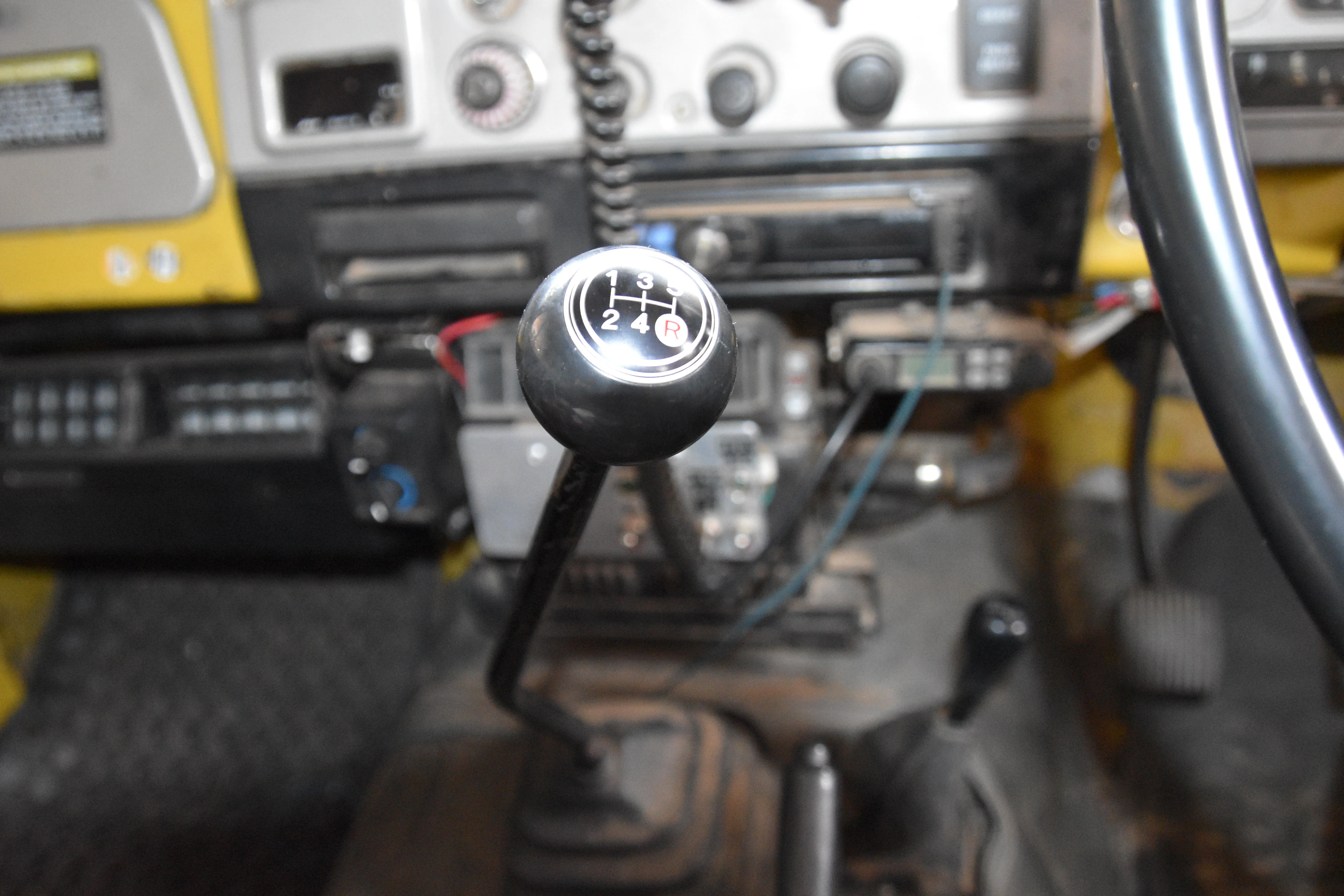

5 speed gear knob
I cut the bottom off the original 4 speed stick and welded on a 5 speed gear stick base. This gives a good length of gear stick and is in a similar position to how it was with the 4 speed.

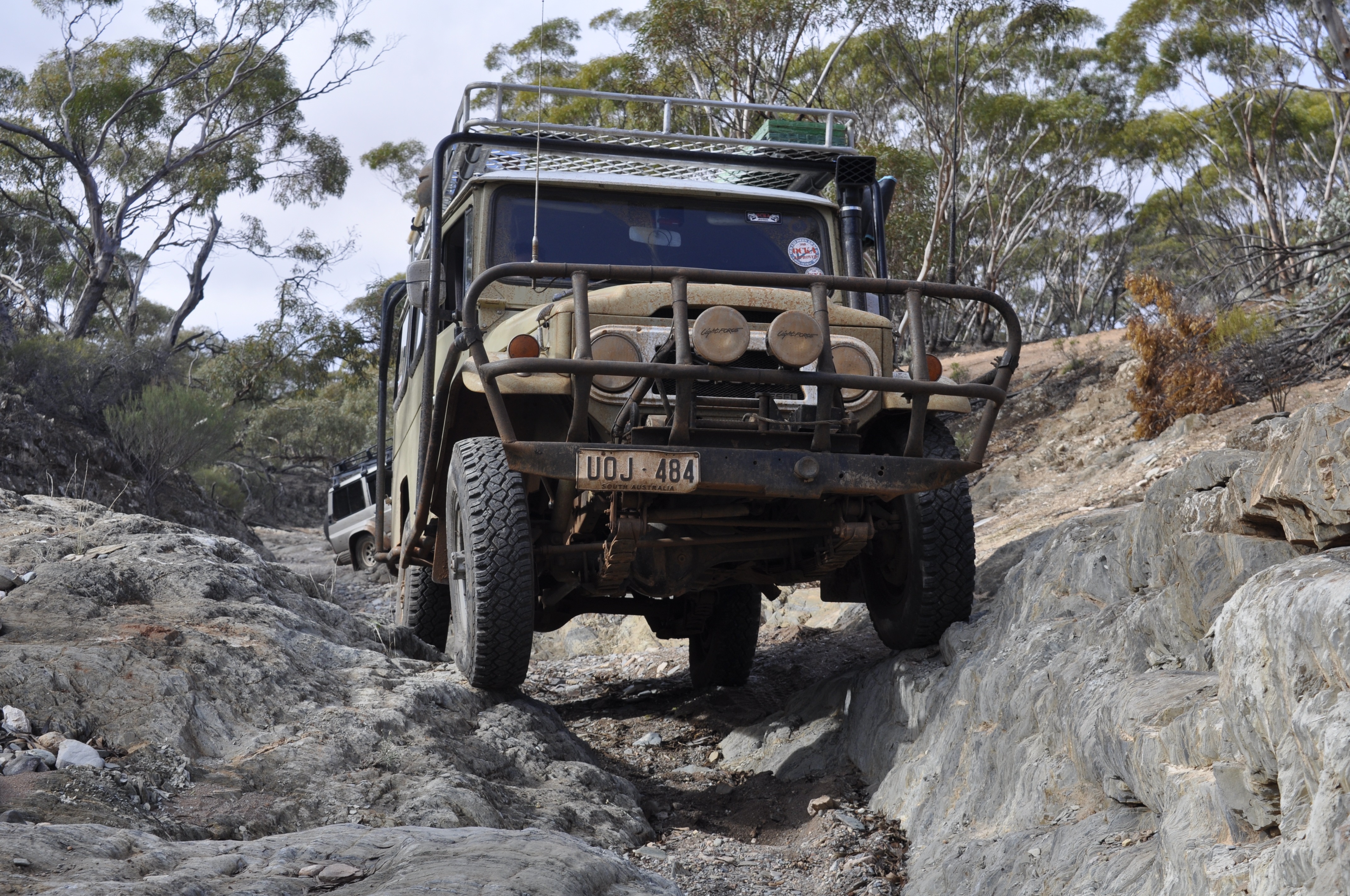

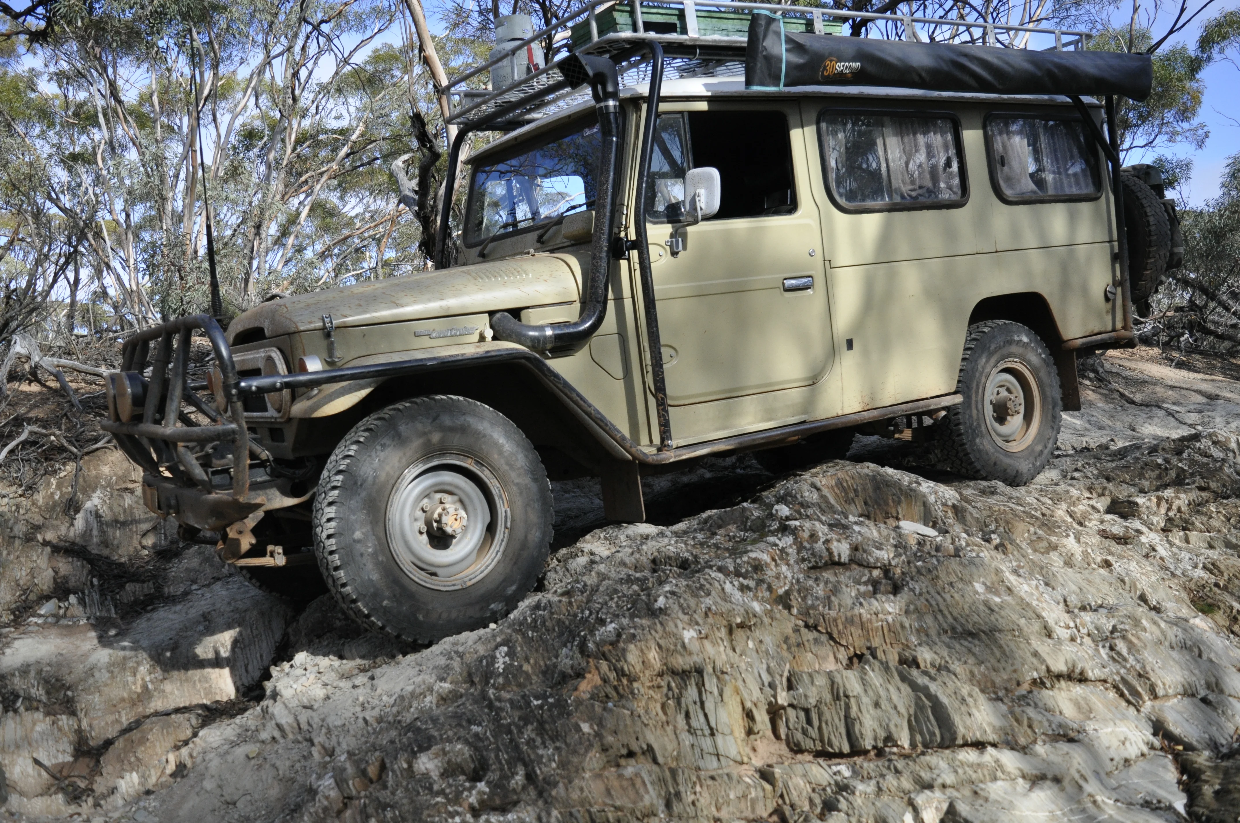

Testing the new 3:1 low range gearing, works well on the rocks. Almost impossible to stall it
Mate what an awesome troopy! I love your mods. Super practical, no frills! How do you rate the 5 speed over the 4??
Thanks mate.
The 5 speed is pretty good. The 4 speed was getting tired anyway so rather than rebuild it I got a rebuilt 5 speed.
At first I didn't like the way it felt to change gears but with the longer gearstick from the 4 speed it feels good.
The only benefit over the 4 speed is the noise. The lower RPM makes it a lot quieter driving on the highway which is good for me because I drive long distances.
But the 4 speed was fine for years and if I didn't do a lot of long distance traveling there would be no point in changing it.

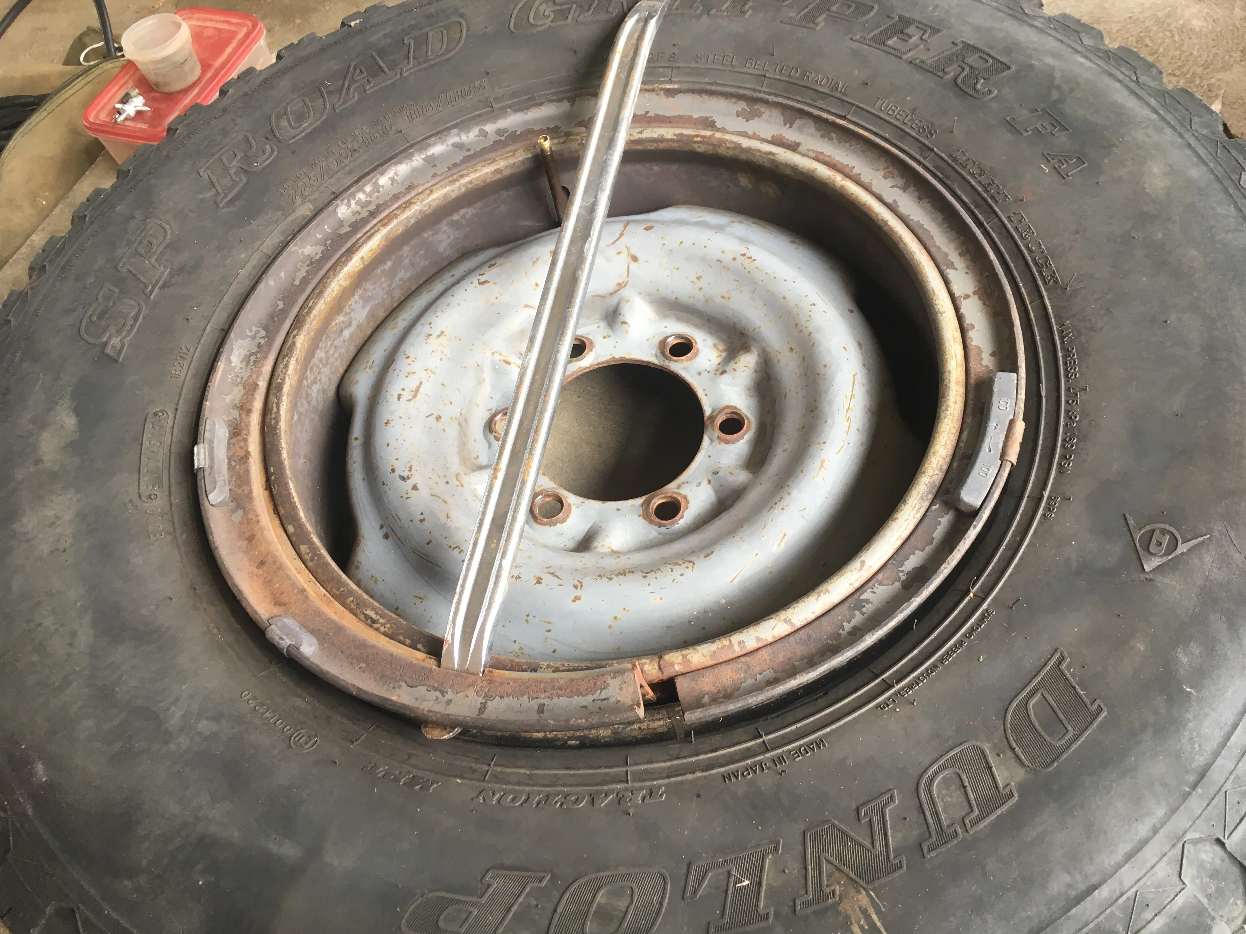

New set of tyres to replace the old Dunlops.
I decided to try some Bridgestone Duelers. The Last set of Dunlops lasted only 30,000km. The Bridgestones have a less aggressive tread pattern so I will use them for summer and general driving and keep a good set of Dunlops for muddy trips. And since there are only 2 different tyres readily available in this size, I may as well try both and compare.

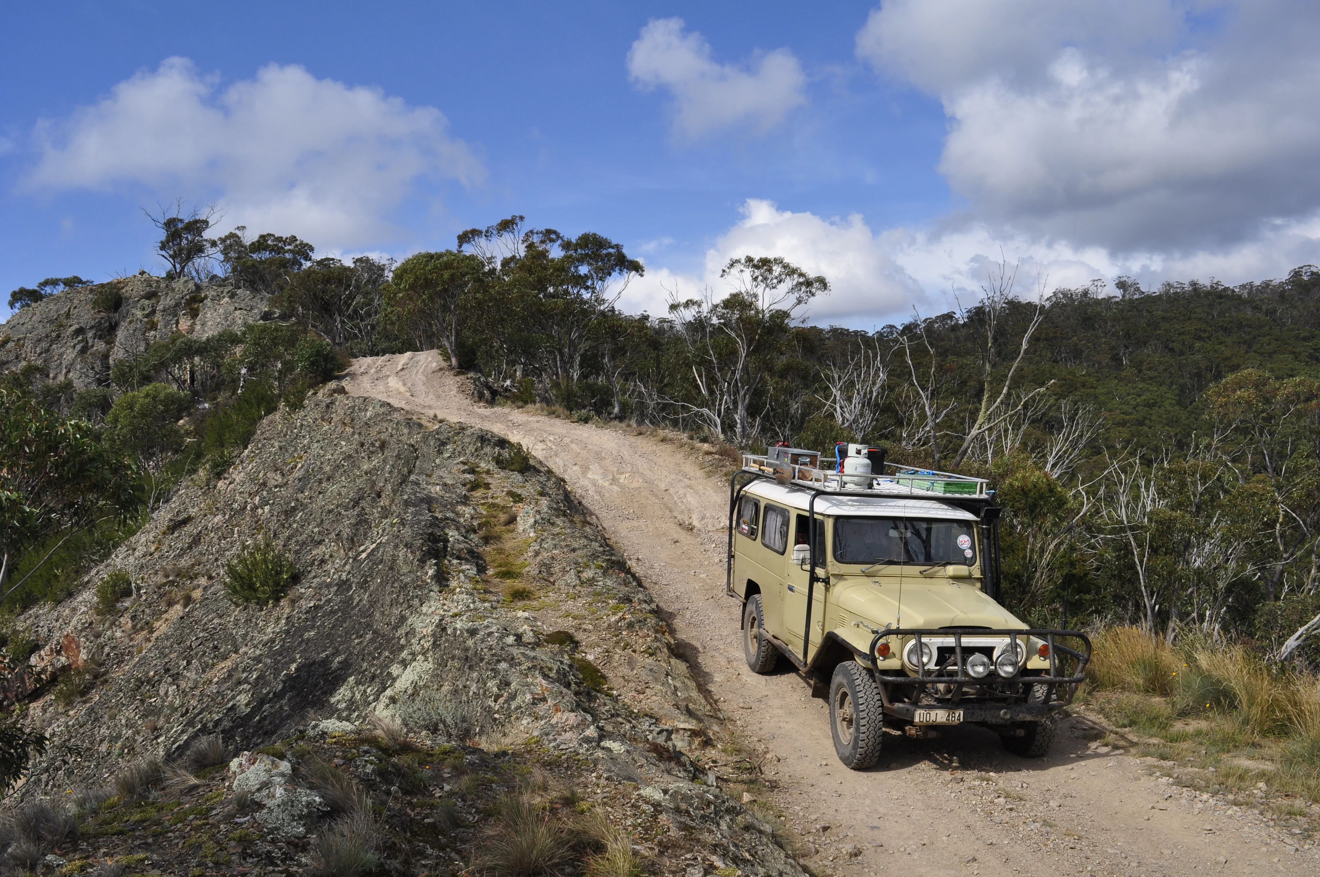

First trip with the new tyres, Vic high country as usual but this time in the middle of summer.
Good grip on the roads, good in dry conditions. Did end up running out of grip on a steep section that was a bit wet.
