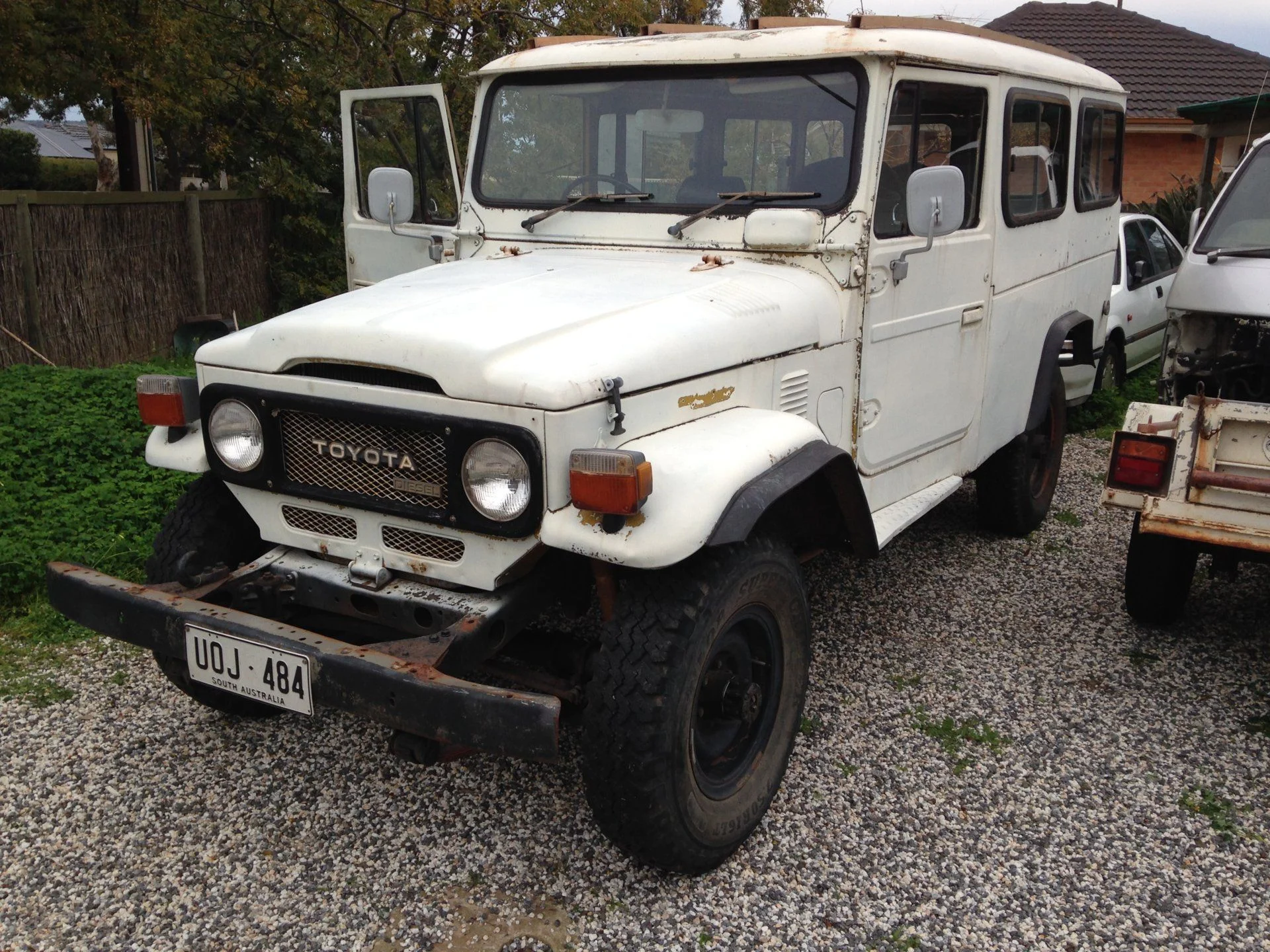

I'm JP and this is a build/repair thread of my 1984 HJ47 Troopcarrier.
I bought it stock, 4L 6 cylinder diesel and a 4 speed transmission.
The aim is a reliable, efficient daily driver, tourer, and toy.
I have done a lot already but I will start from the beginning.
When I bought it. Lots of body filler, poorly done paint, tyres from 1992, etc.
full
full
full

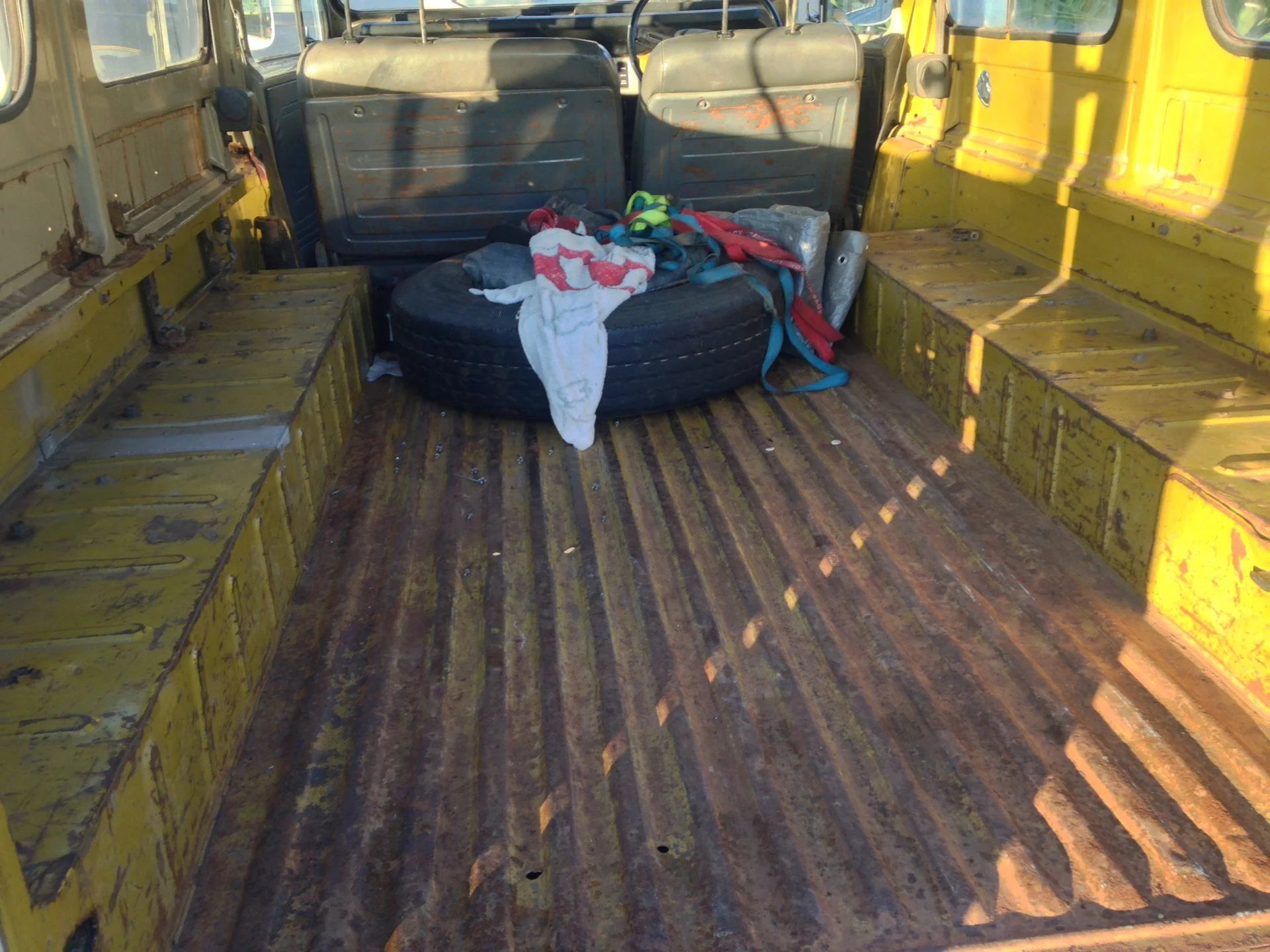

Removed church seats and carpet from the back, got some new tyres and started repairing rust.

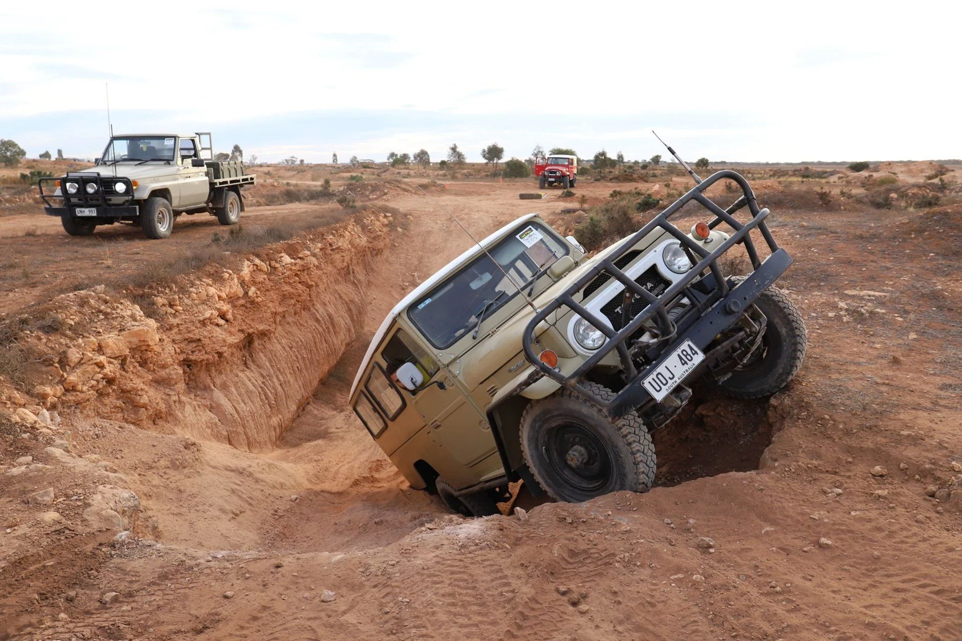

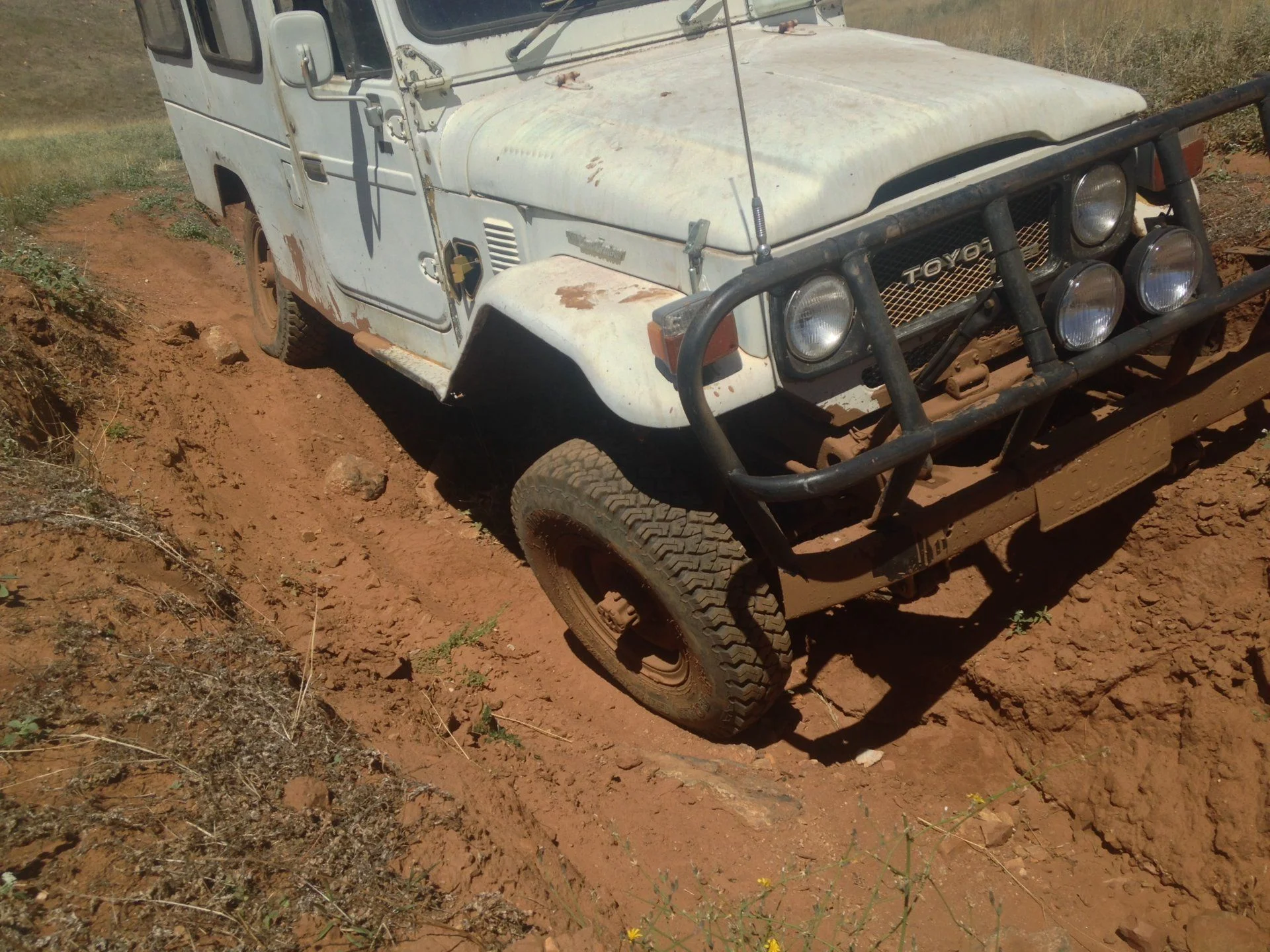

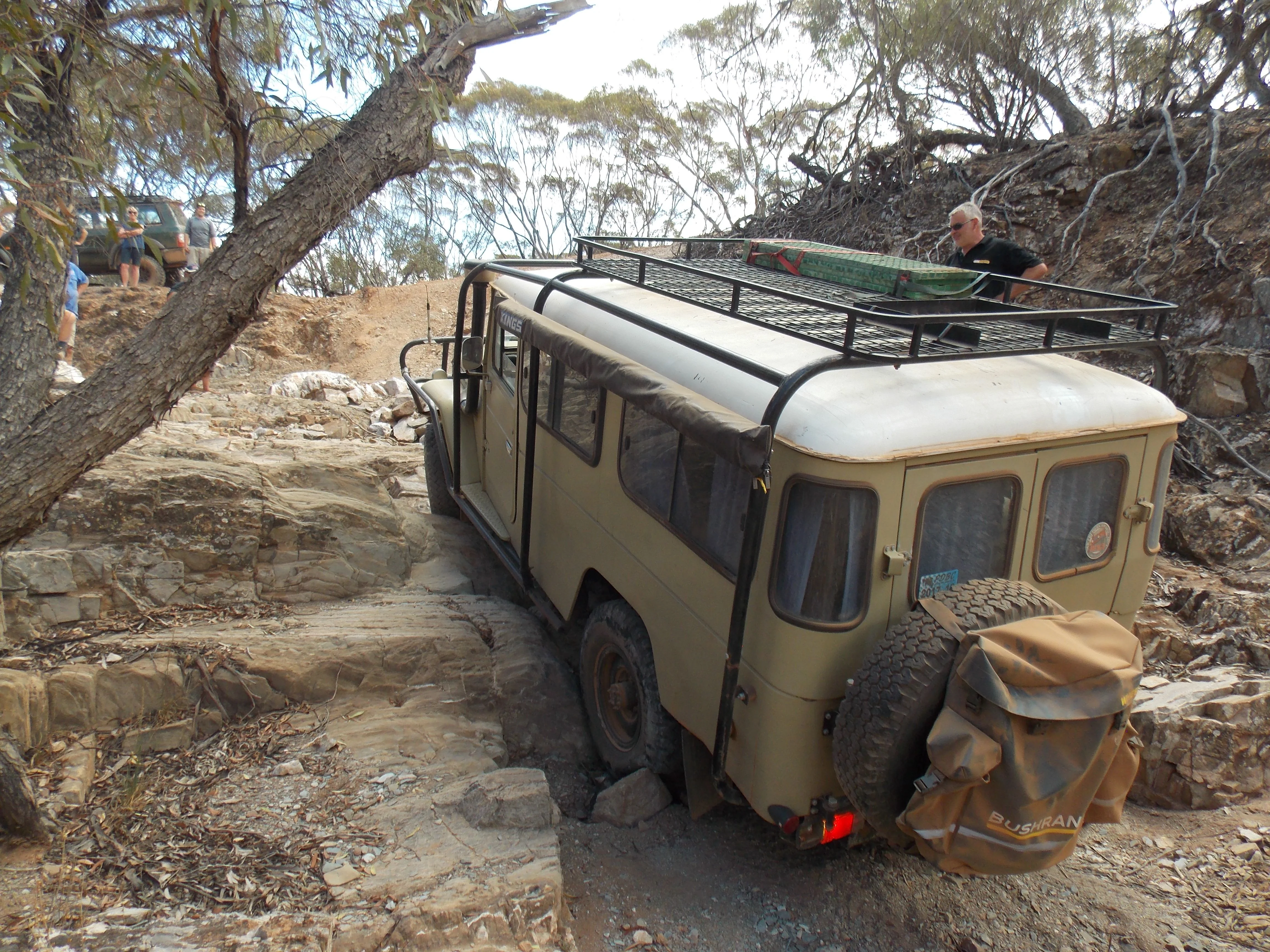

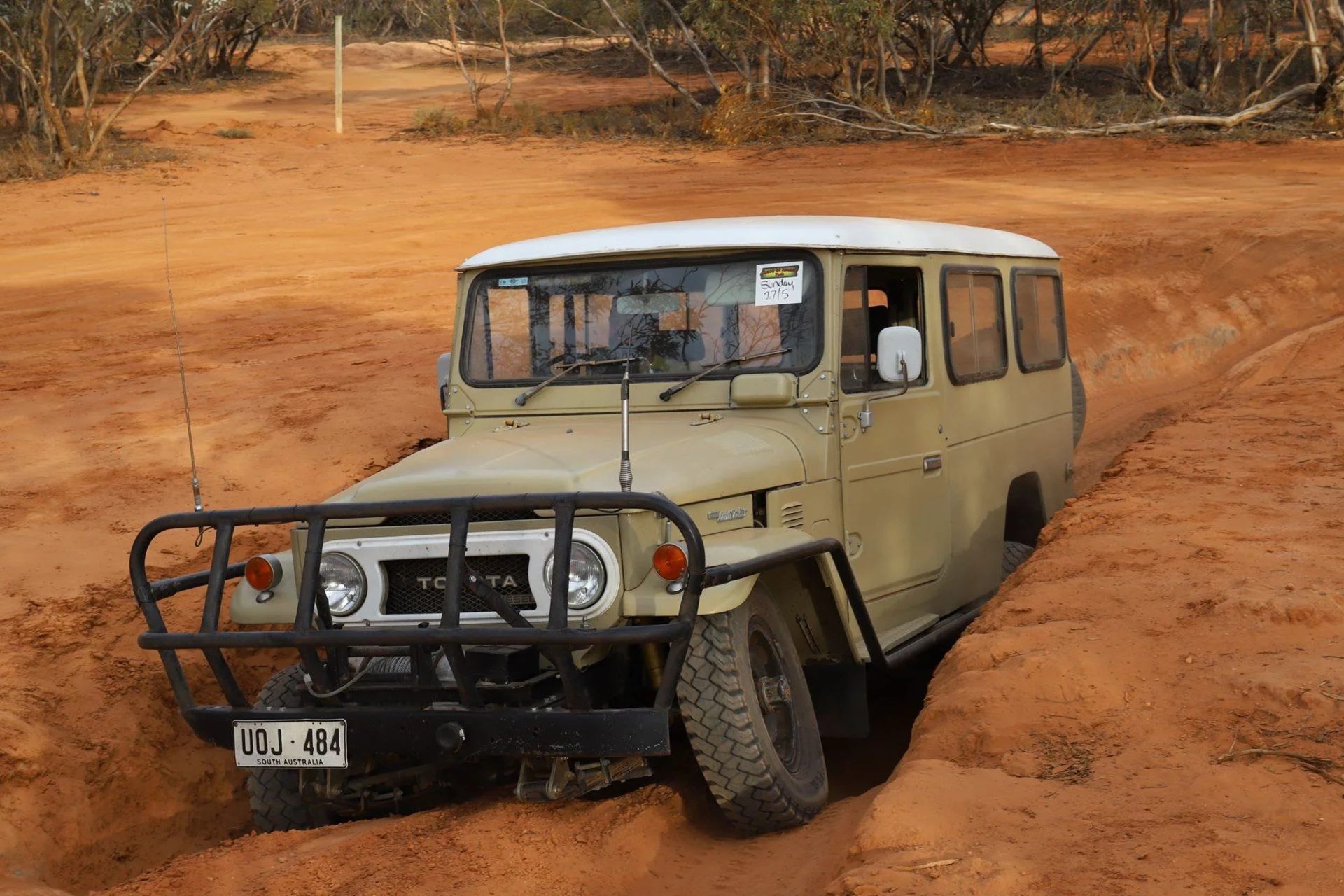

First time off road
full

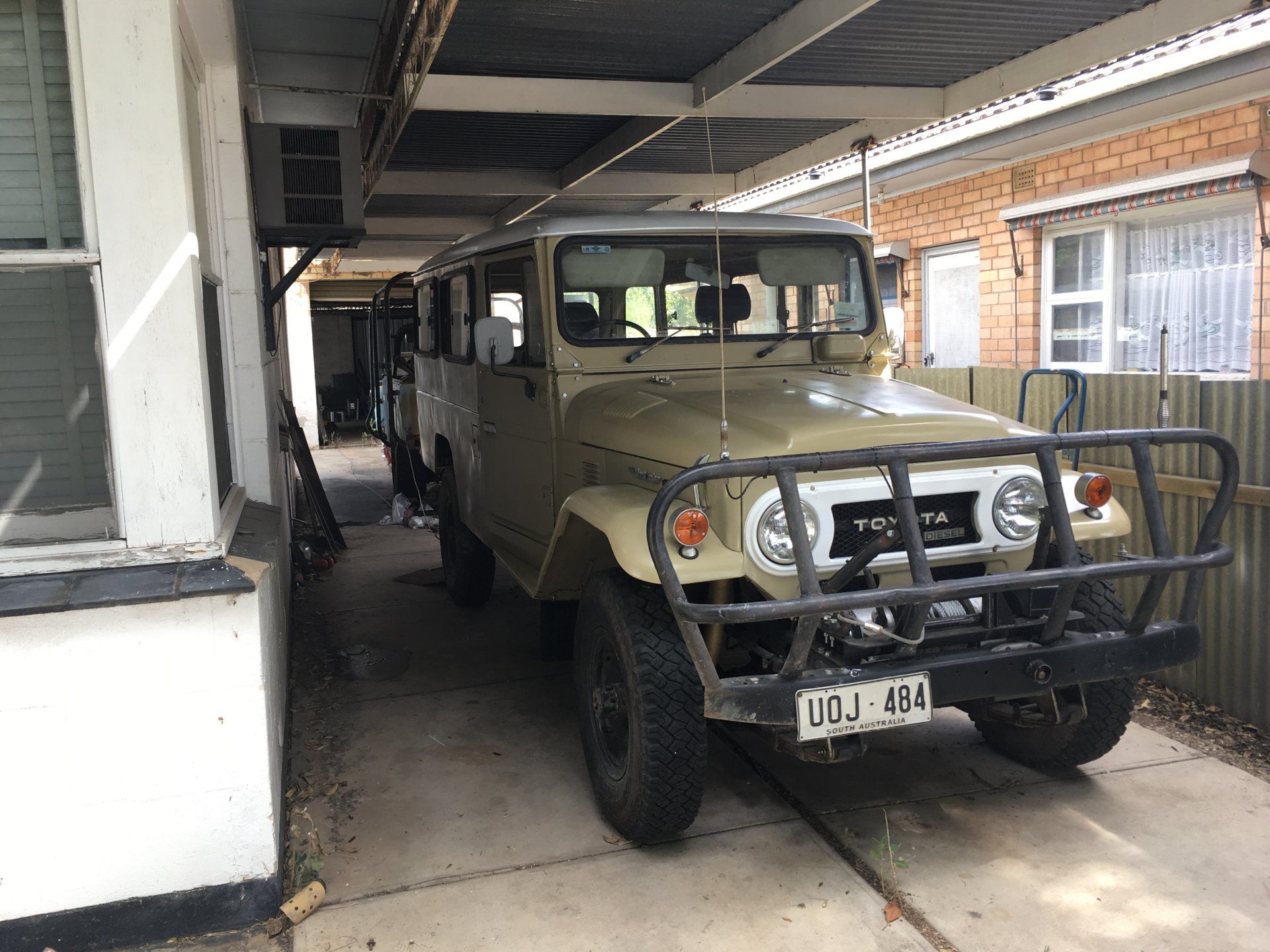

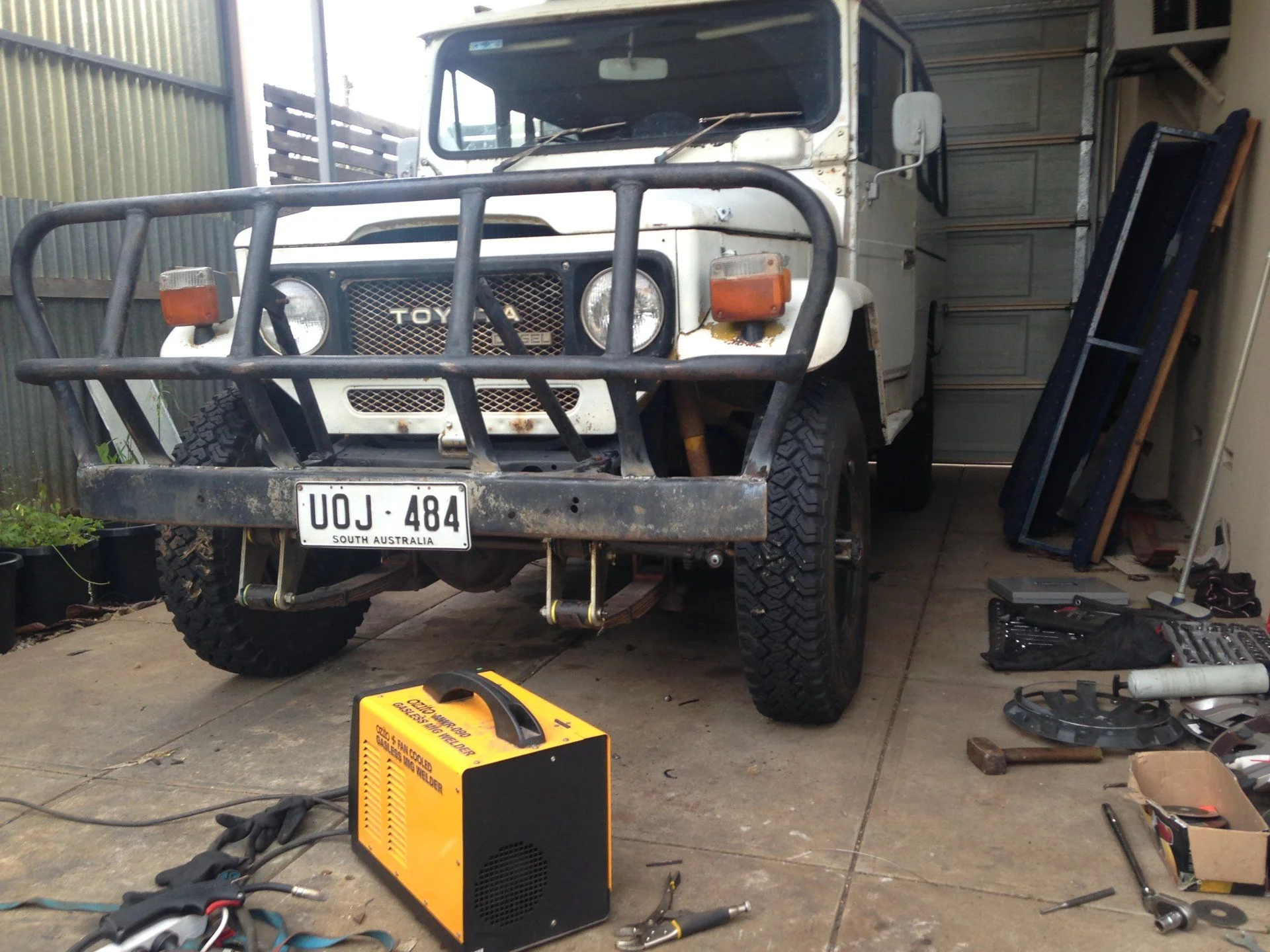

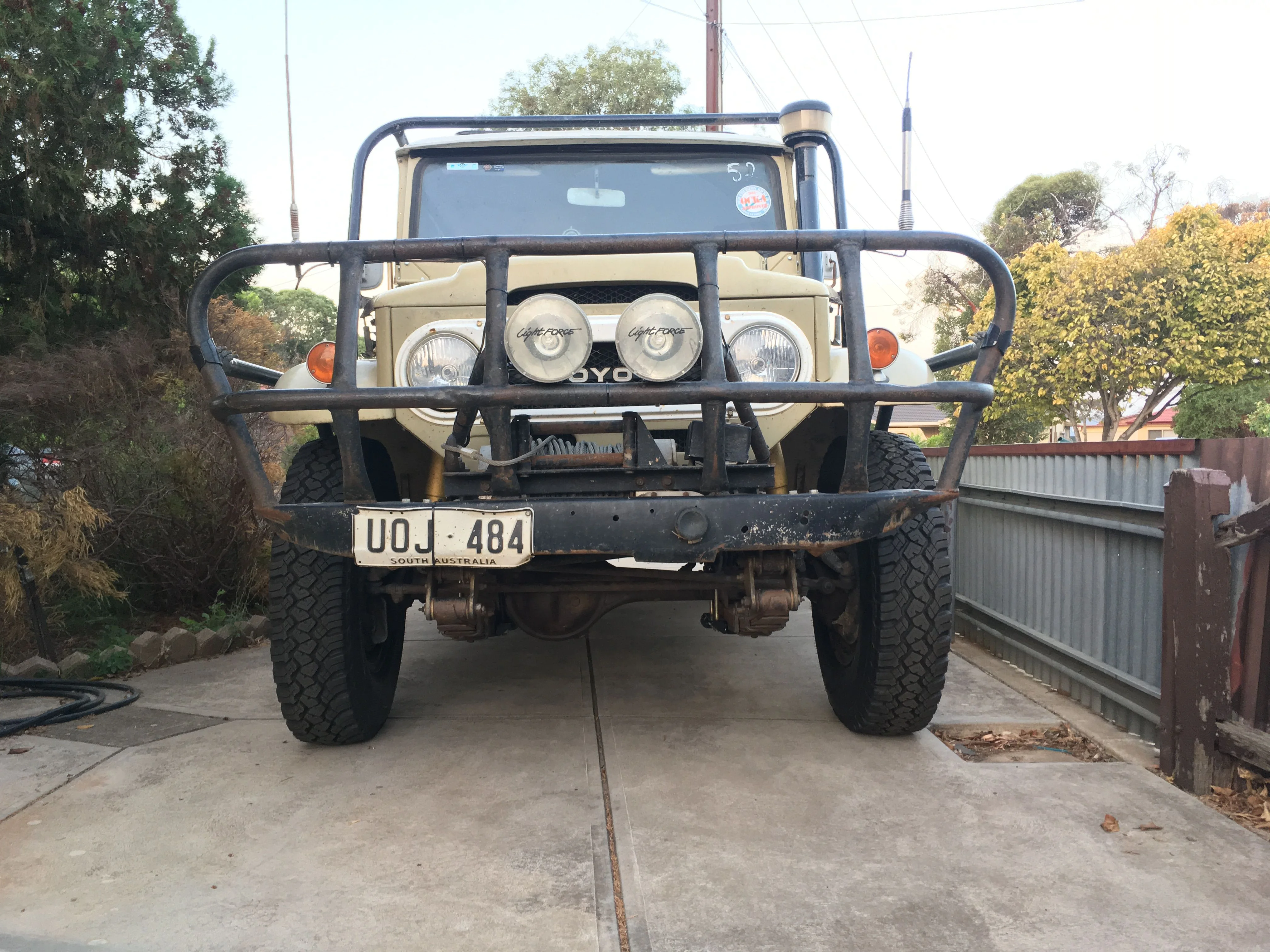

Bullbar made from cutting welding a damaged bolt-on bullbar to the stock bumper.

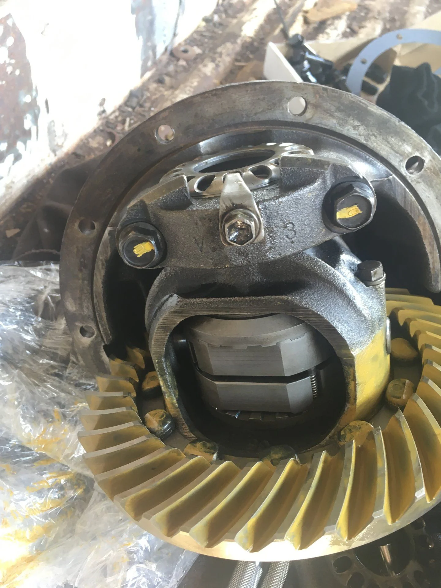

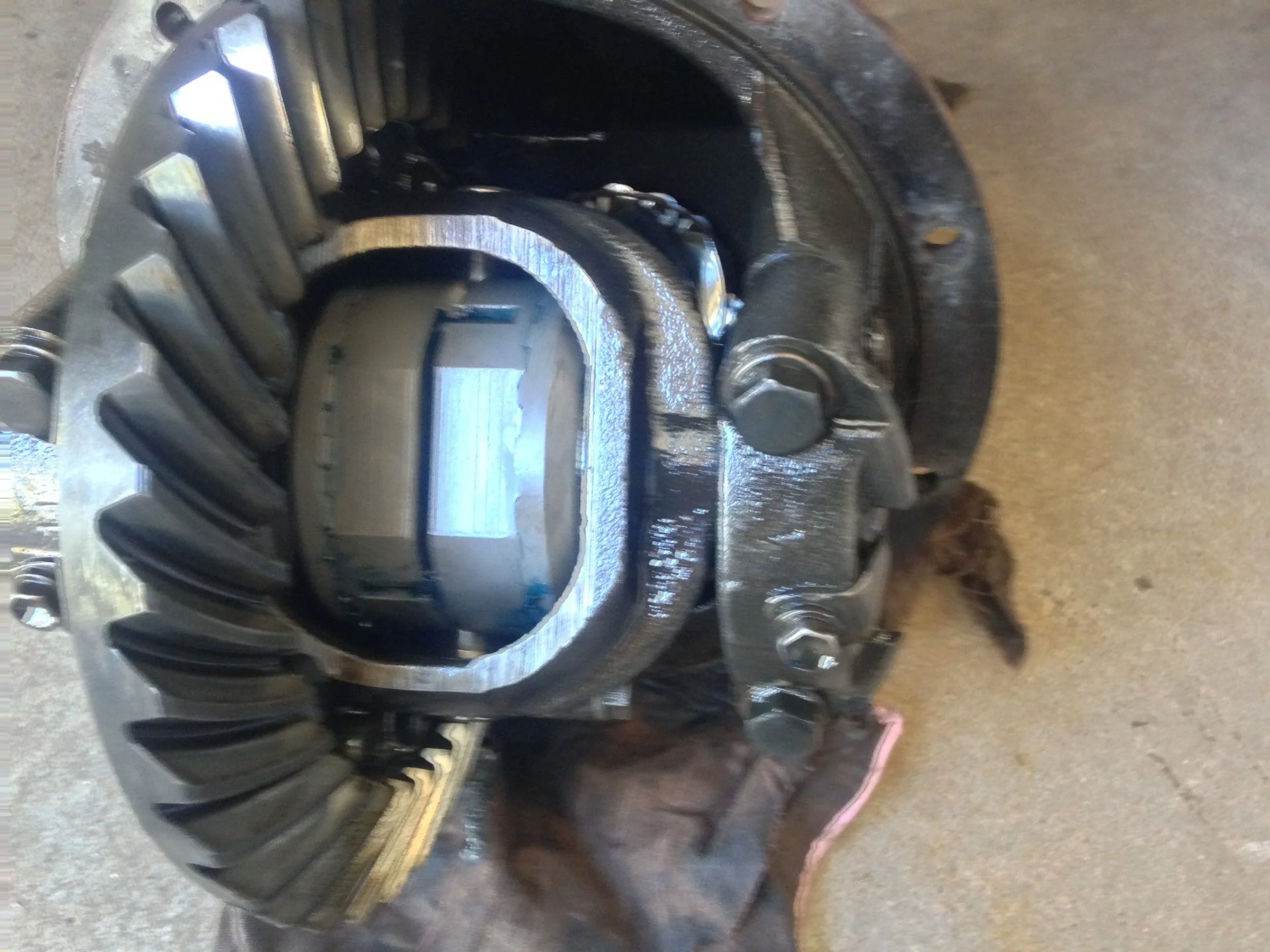

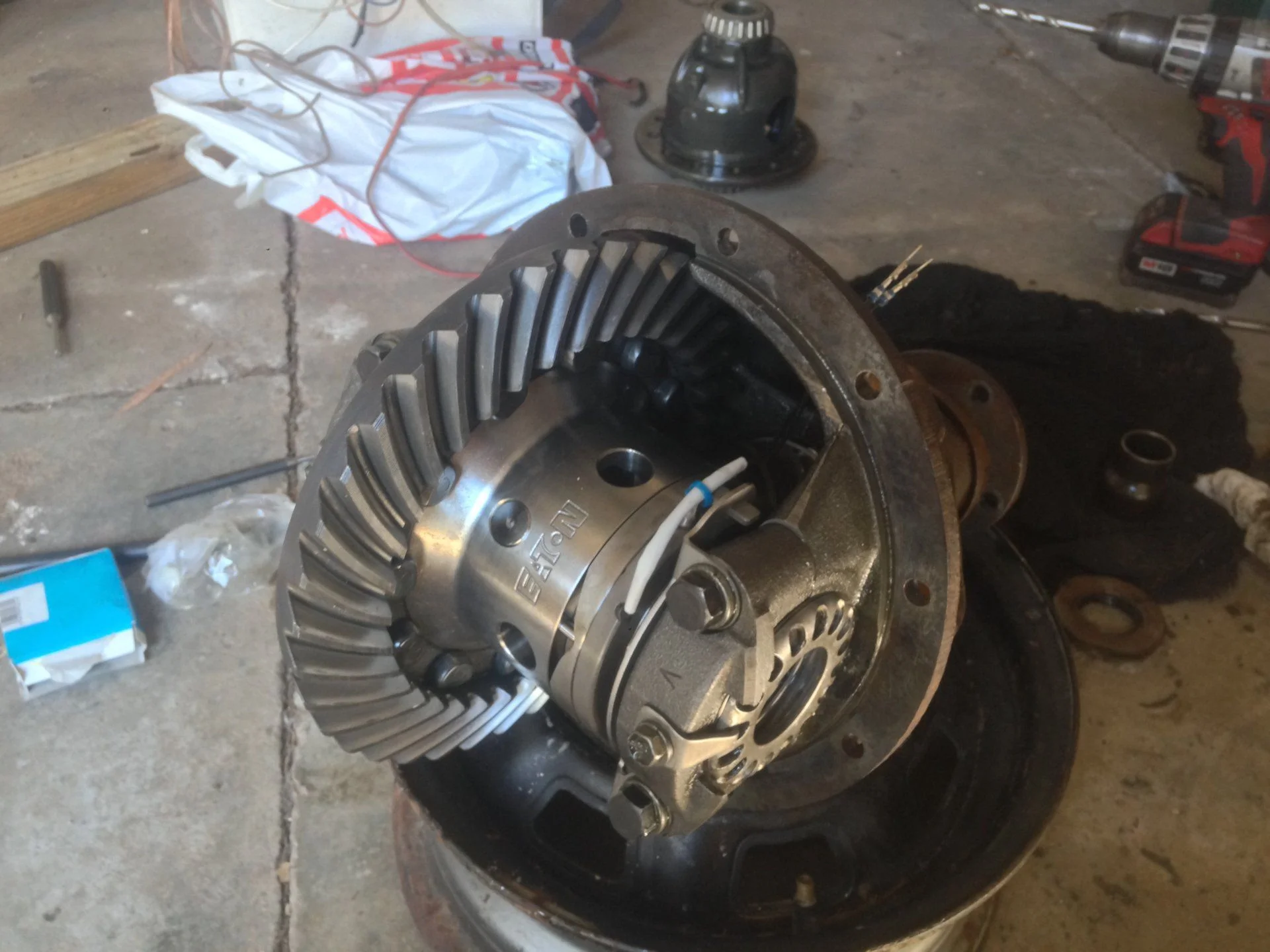

Lokka diff lock for the rear. The cheapest one there was, also the easiest to fit. Didn't even need to remove the carrier or ring gear.
I have since done 20,000km on it with no issues.
full

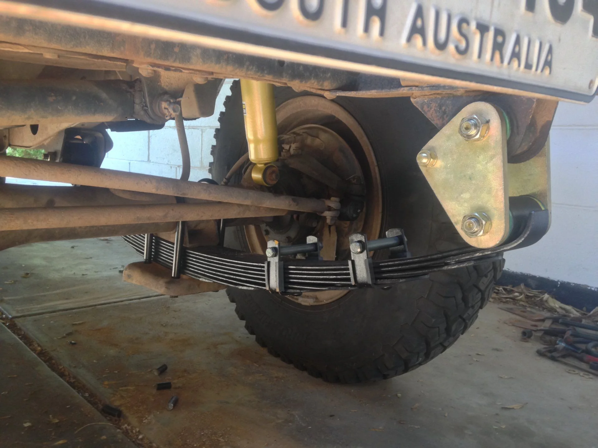

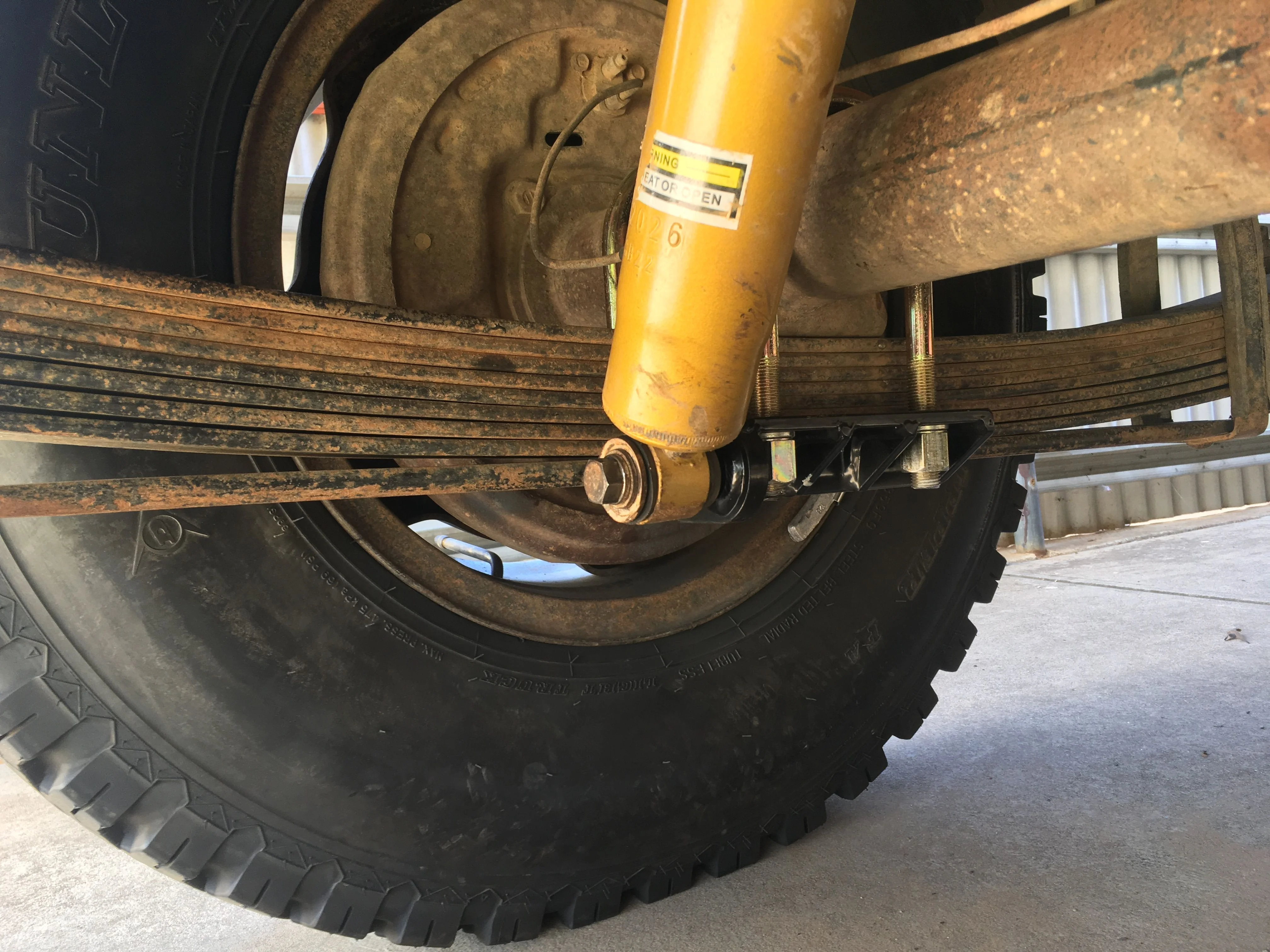

2" lift medium duty springs from 4WD Systems and foam cell shocks. EFS greasable anti-inversion shackles.
full

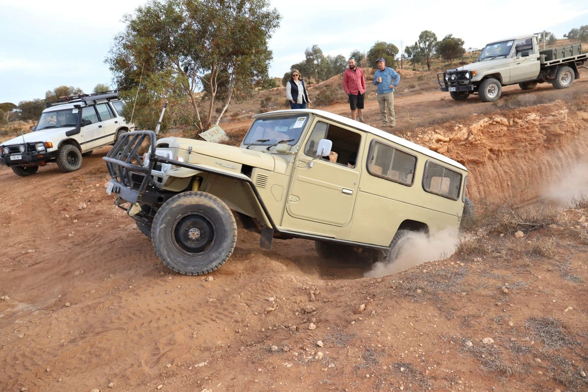

First drive with the locker and it is much better than before. But needs another one.

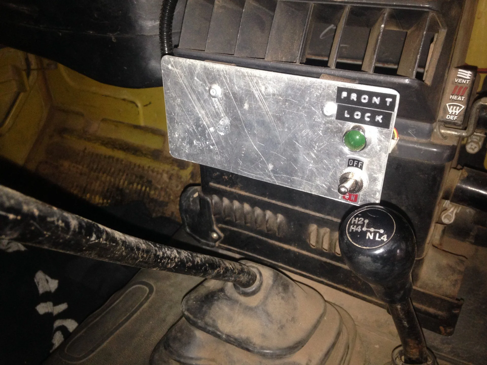

Got an Eaton Harrop e-locker for the front.

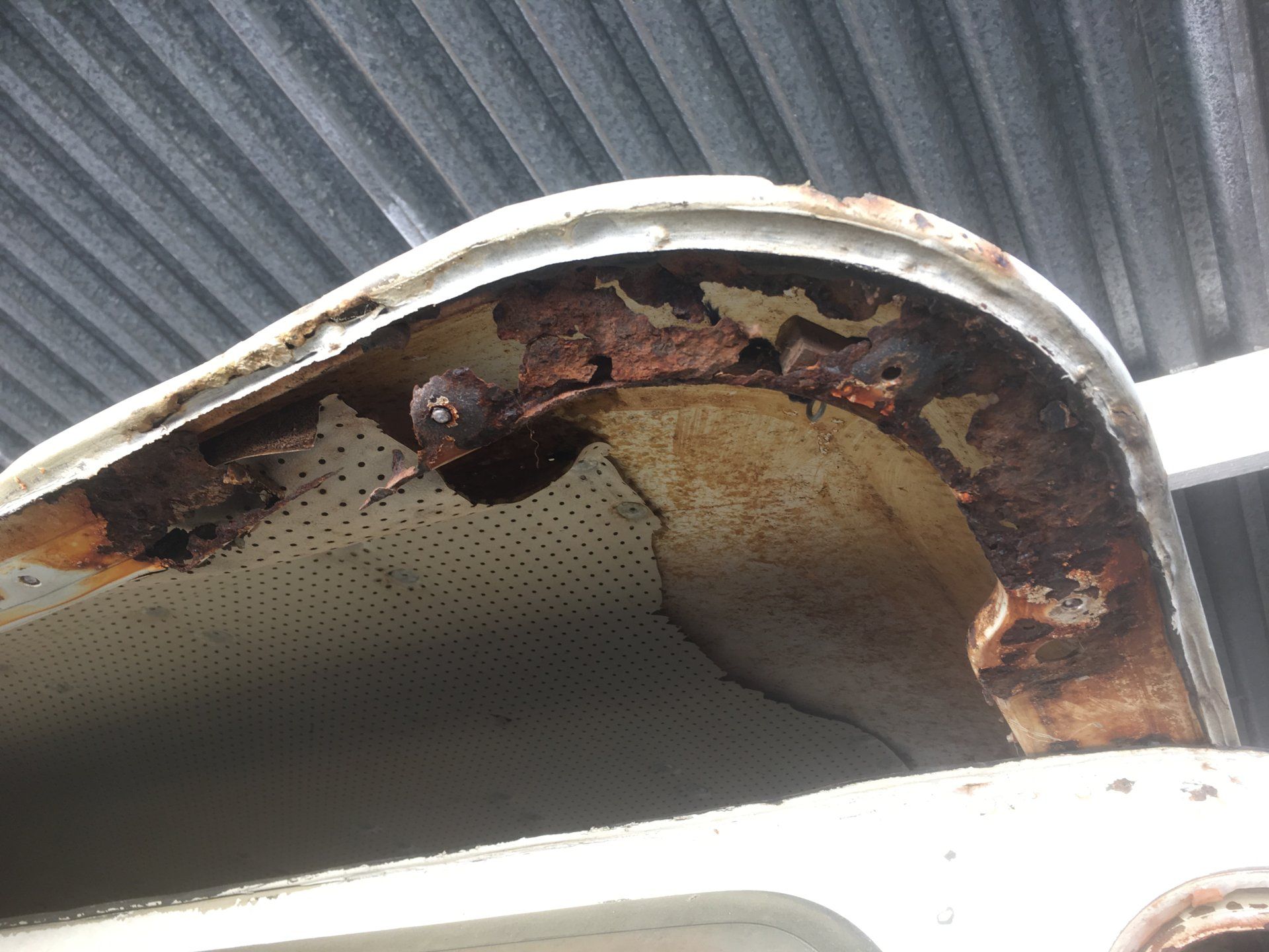

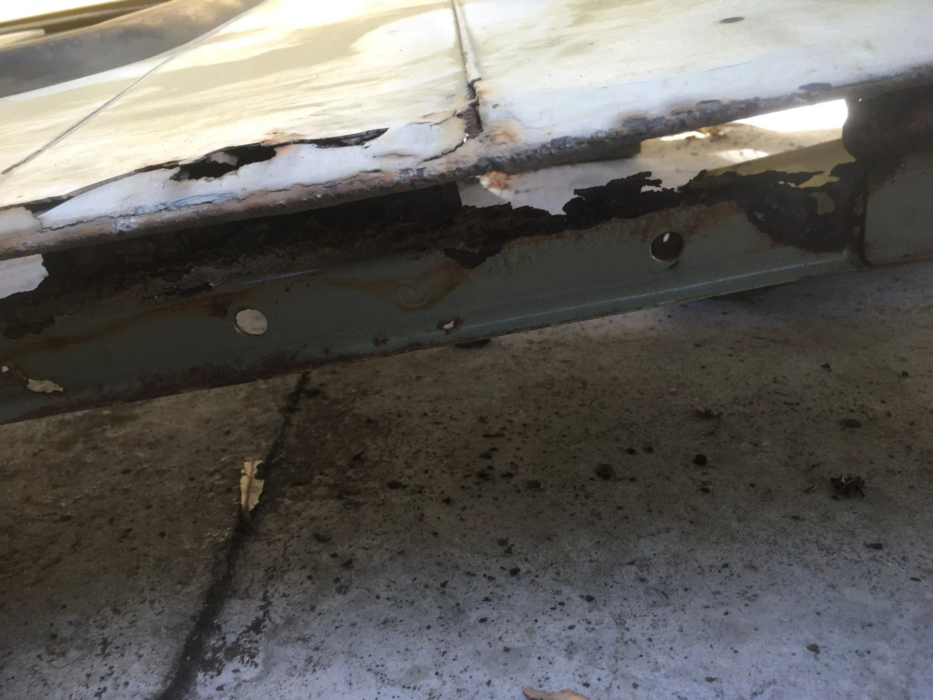

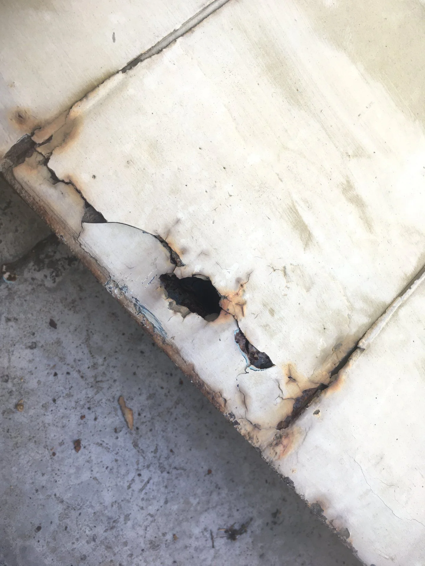

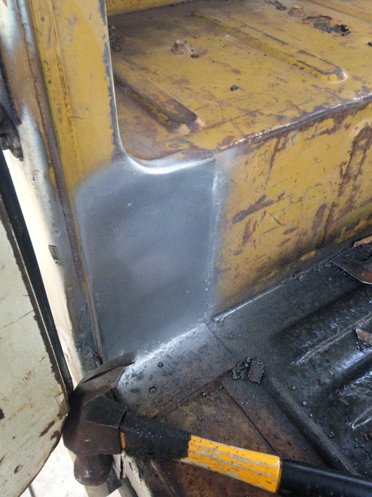

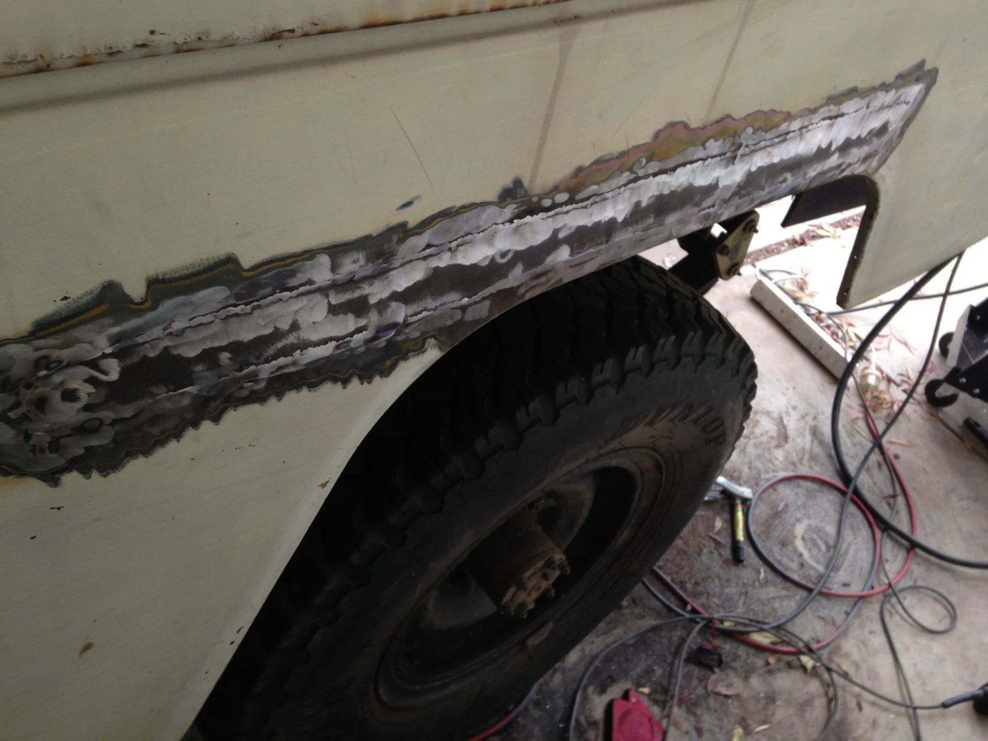

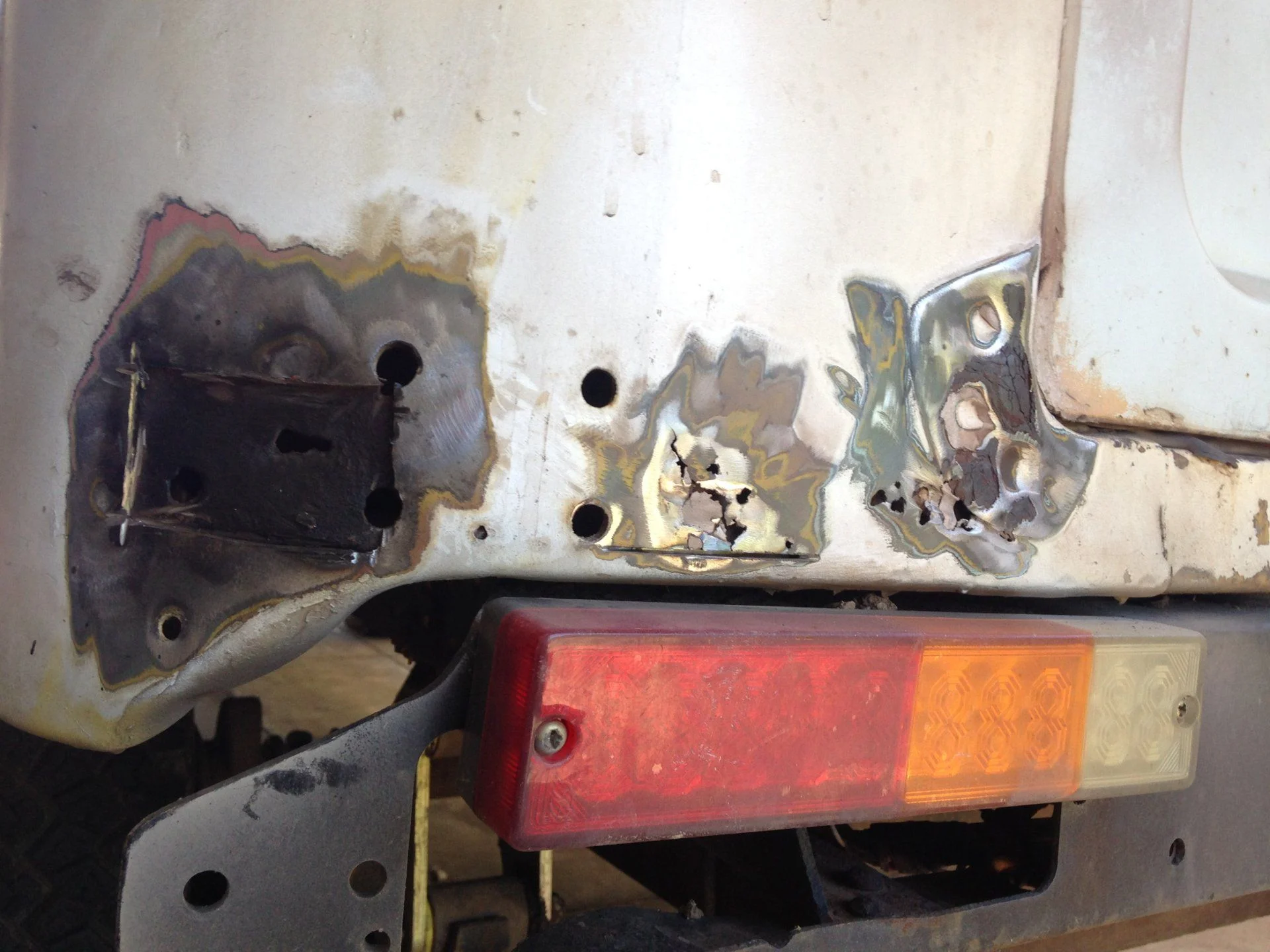

Always more rust repairs.
full

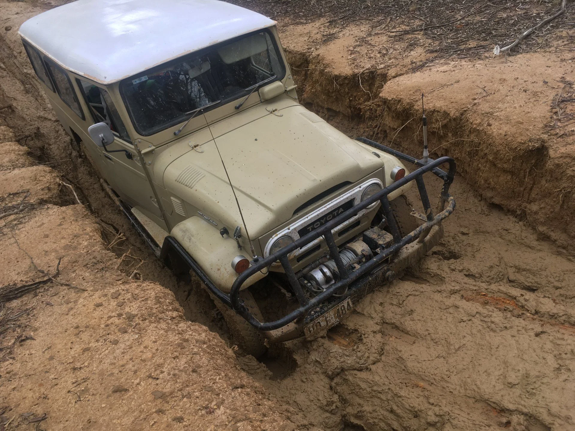

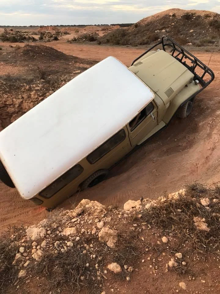

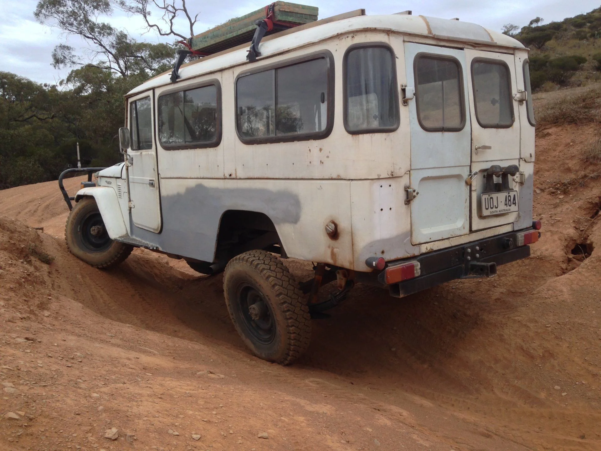

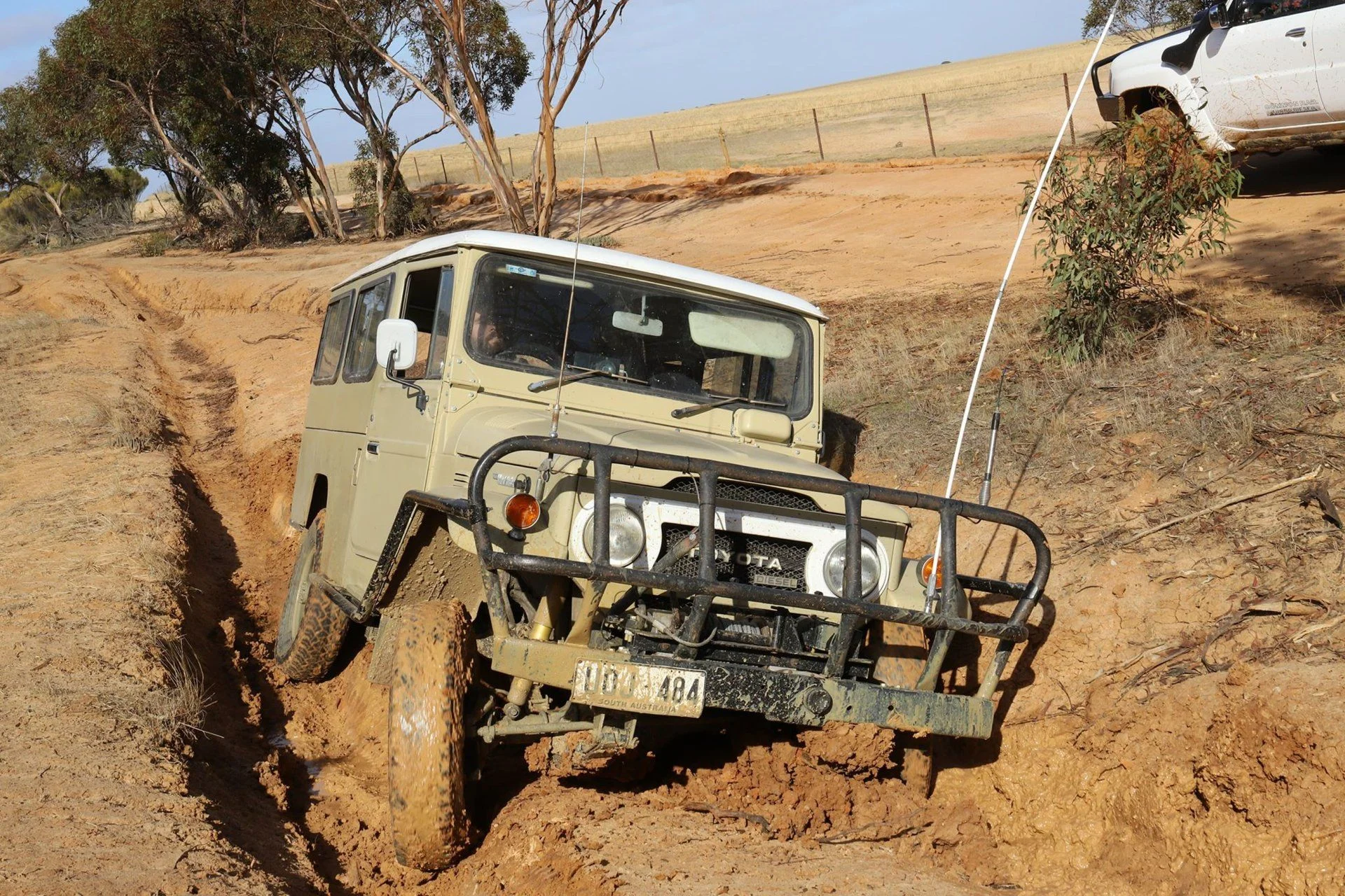

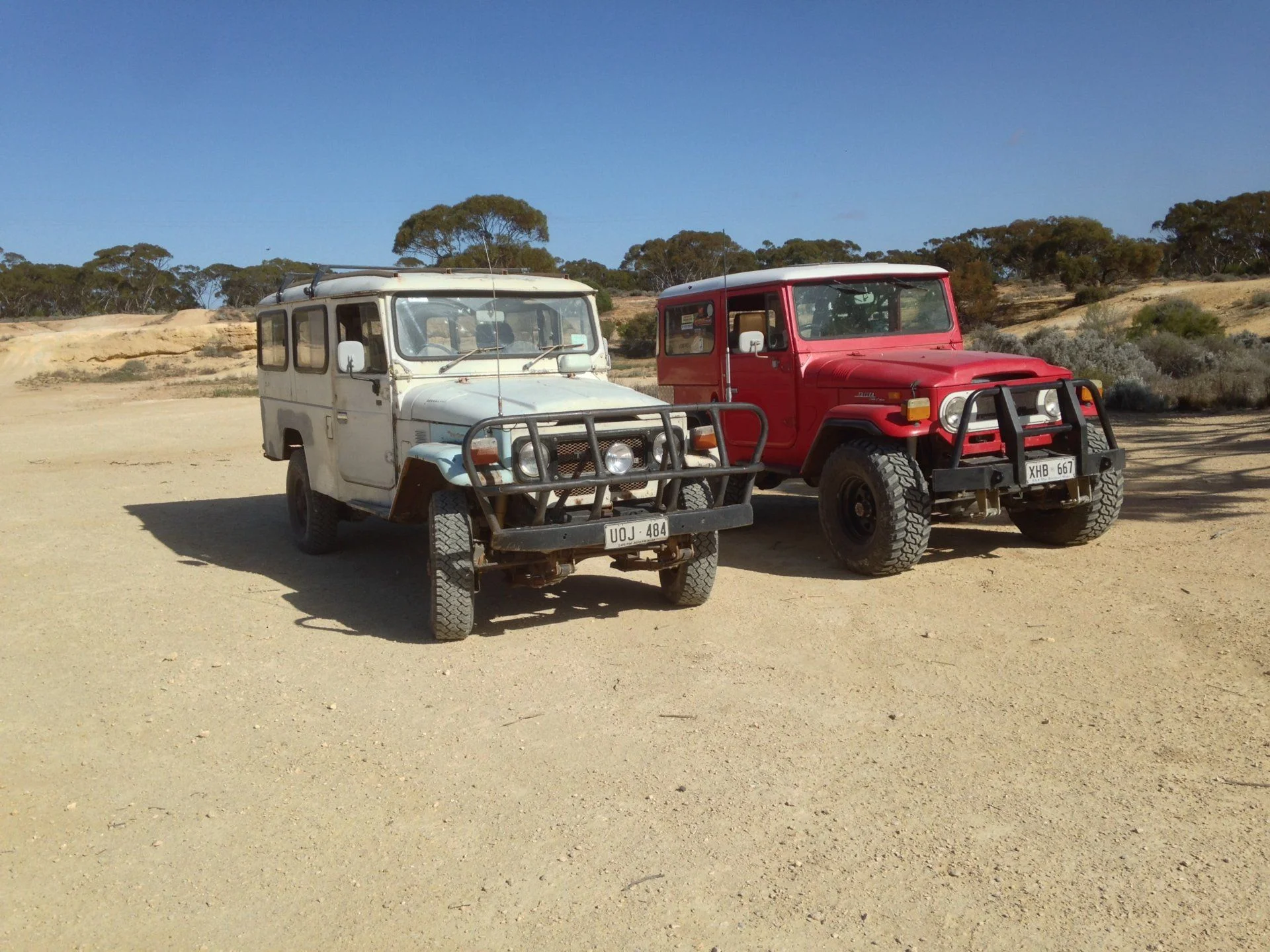

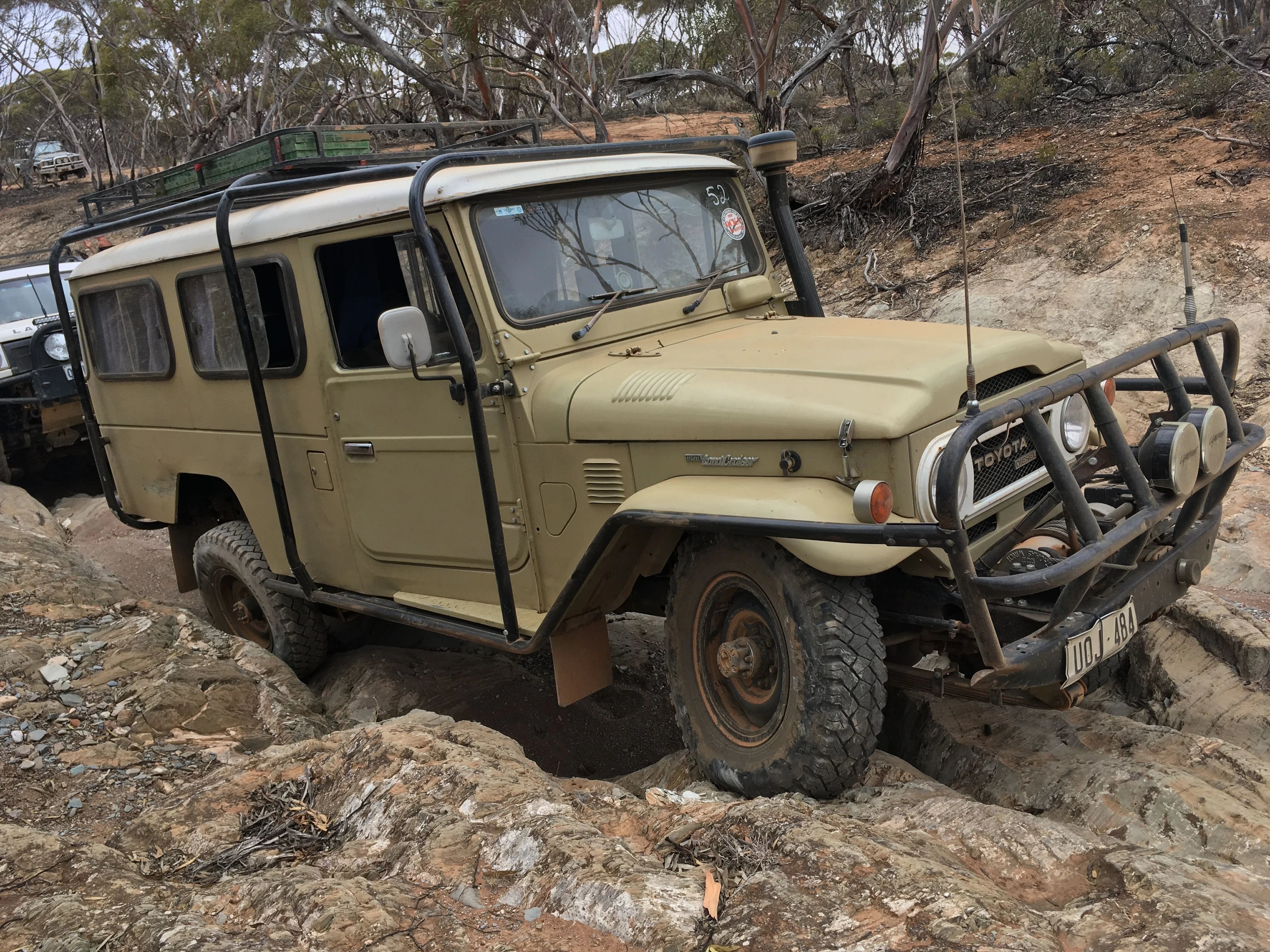

Took it to Terowie, big rocks there but didn't do any damage except the tow bar took a beating.

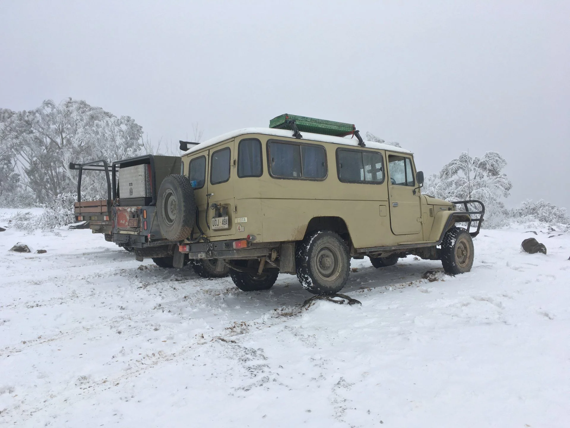

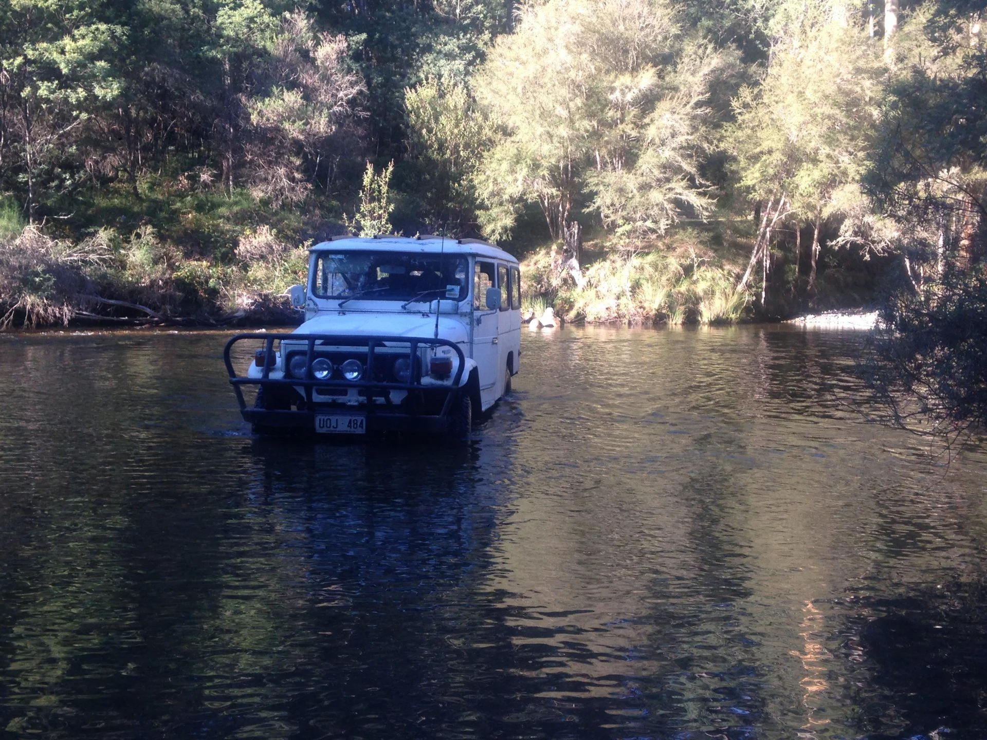

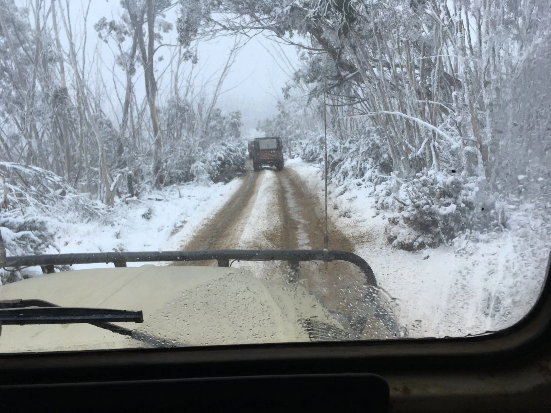

Went on a 4,000km trip east along the coast and up through the Victorian Alps. Very steep tracks and freezing temperatures, the best trip I have done yet.
full

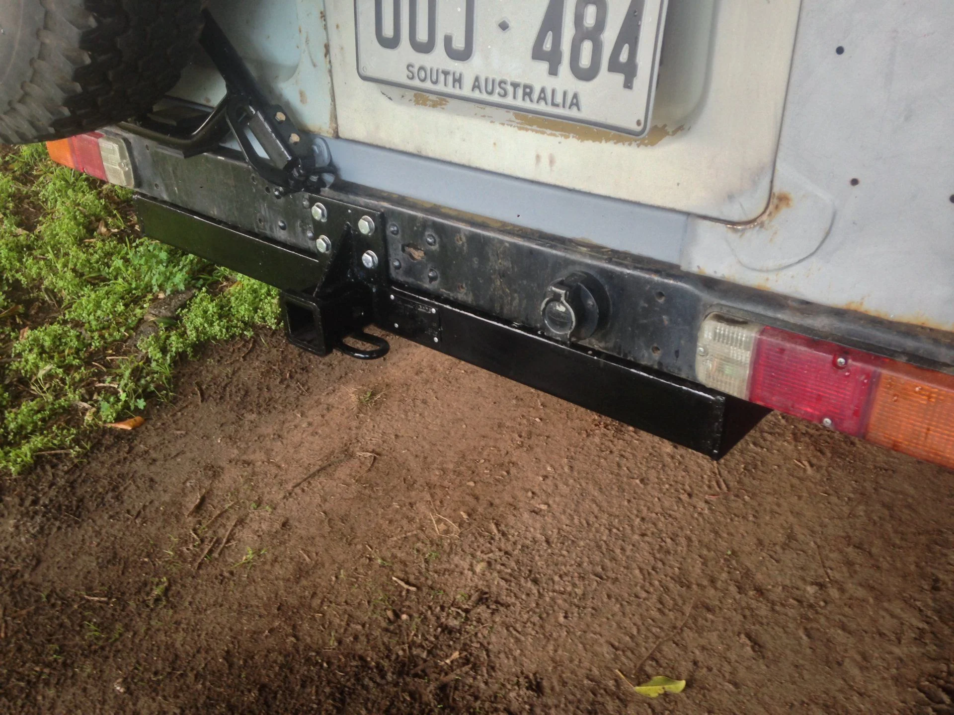

Got a Hayman Reese tow bar rated at 4,500kgs. More than I plan on towing but makes a good recovery point.
full

A bloke I used to work with also got a HJ47 troopy.
full
Nice truck, where abouts did you get the tow hitch?
I bought it off someone who had a few troopies. They are still available to buy new from Hayman Reese, part no. 00665R, but they are now only rated at 2,500kg.

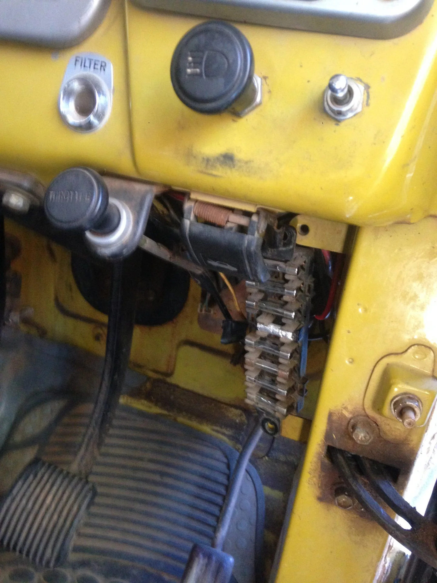

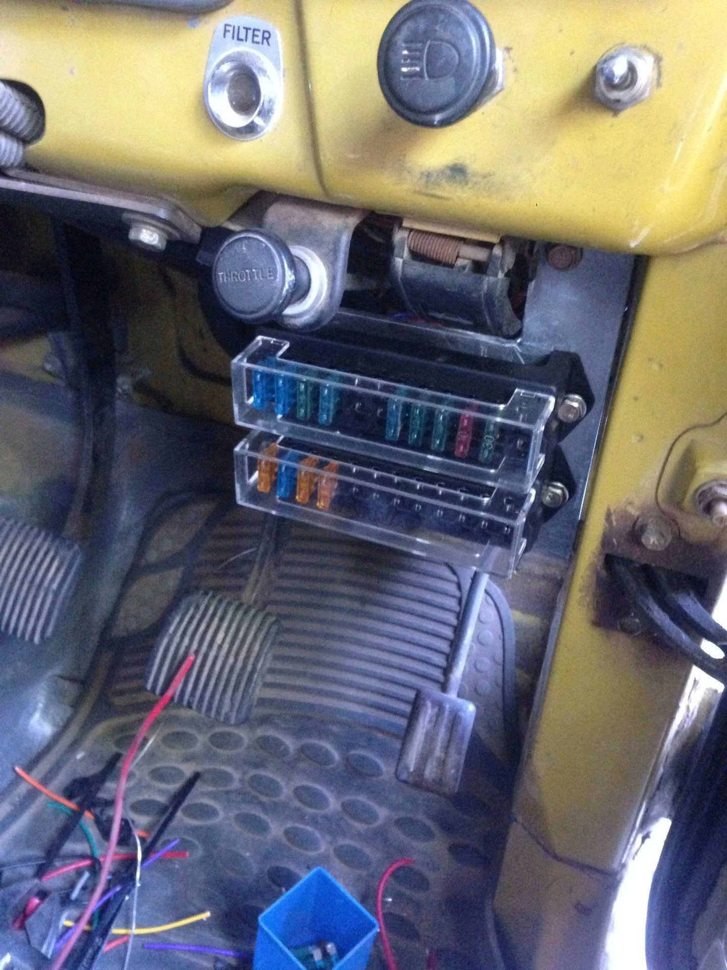

Fuse box before
full
Fuse box after. 2 Narva 2 way boxes. One constant power, one "on" and one "accessories". Still one section left, will probable be another "on".
full

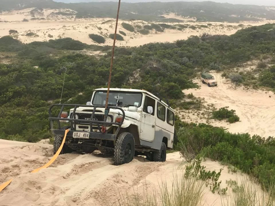

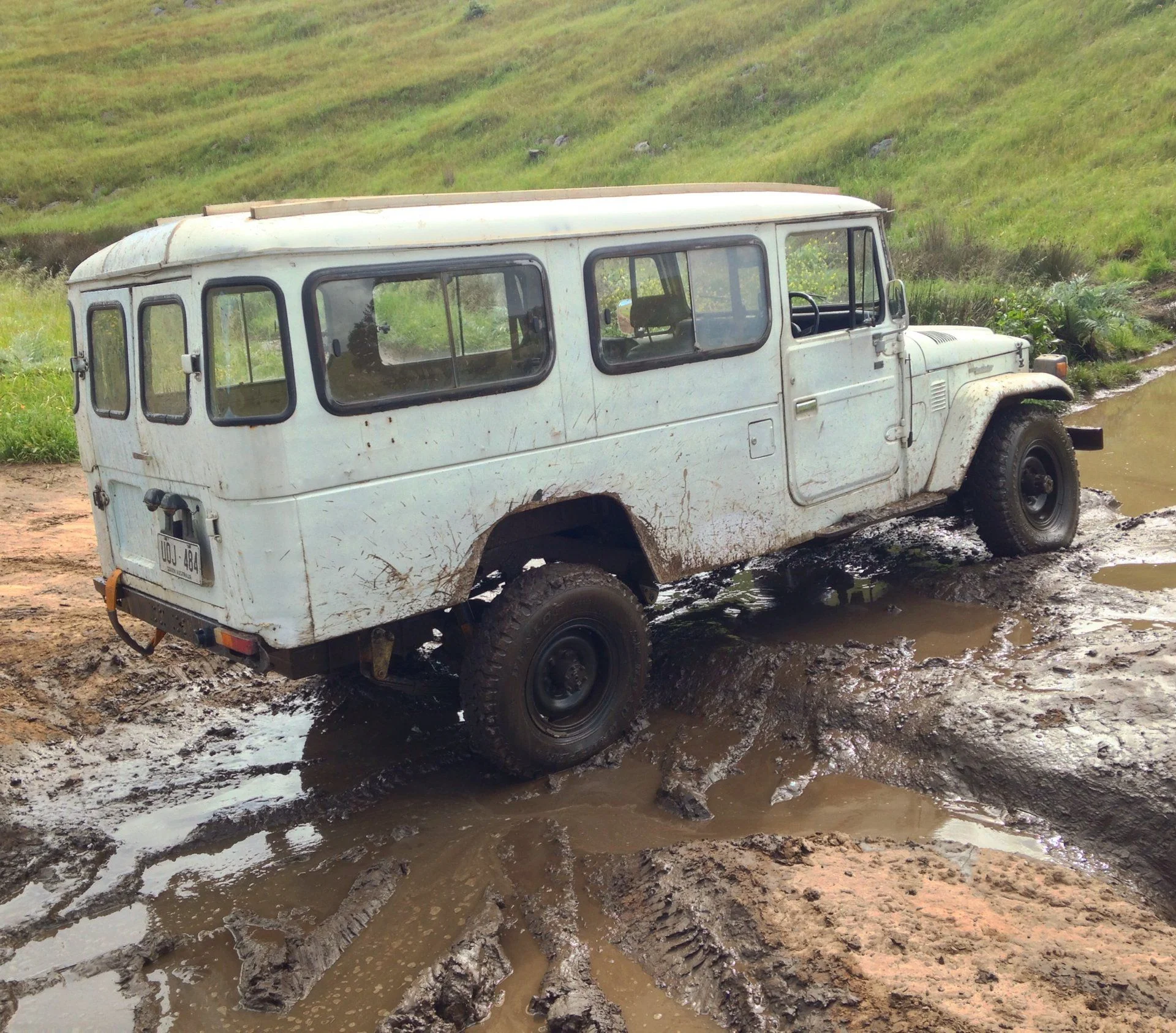

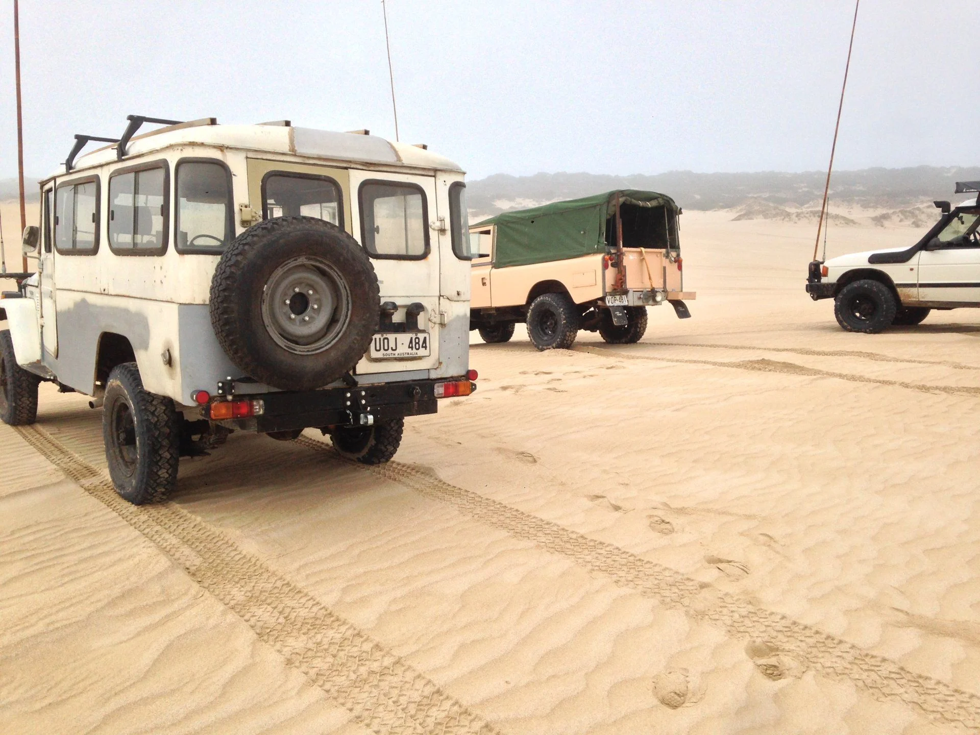

Went to Portland, Vic to play in the dunes.
full
The all powerful 2H has no trouble blasting up even the steepest of dunes.

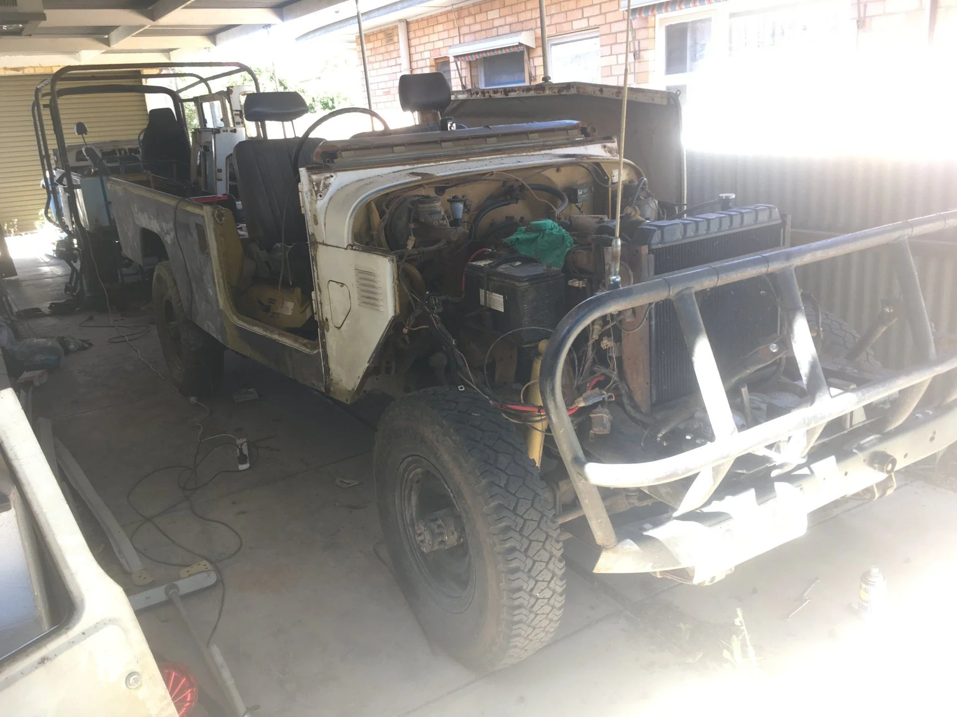

Pulled off all the rusty panels.

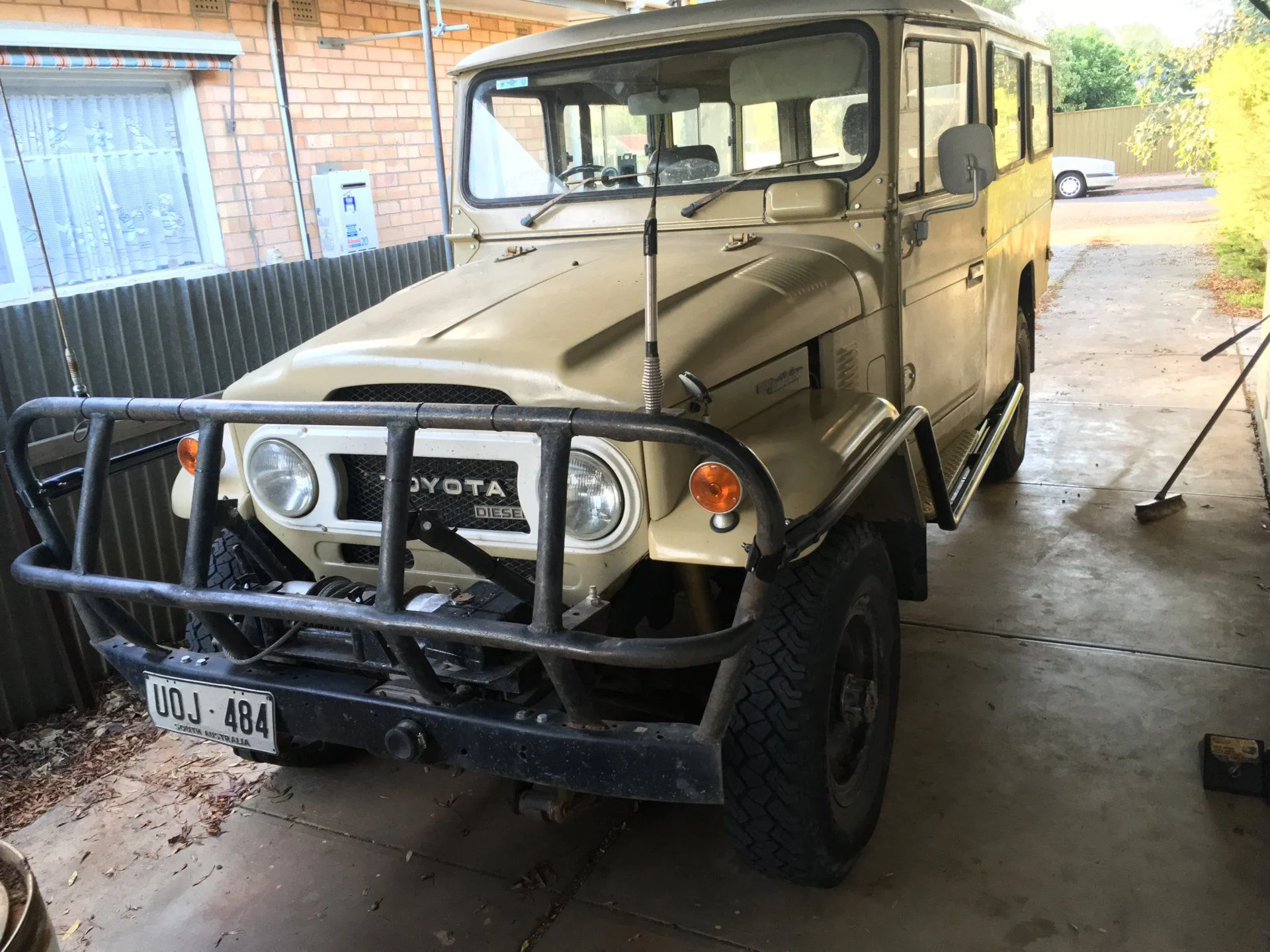

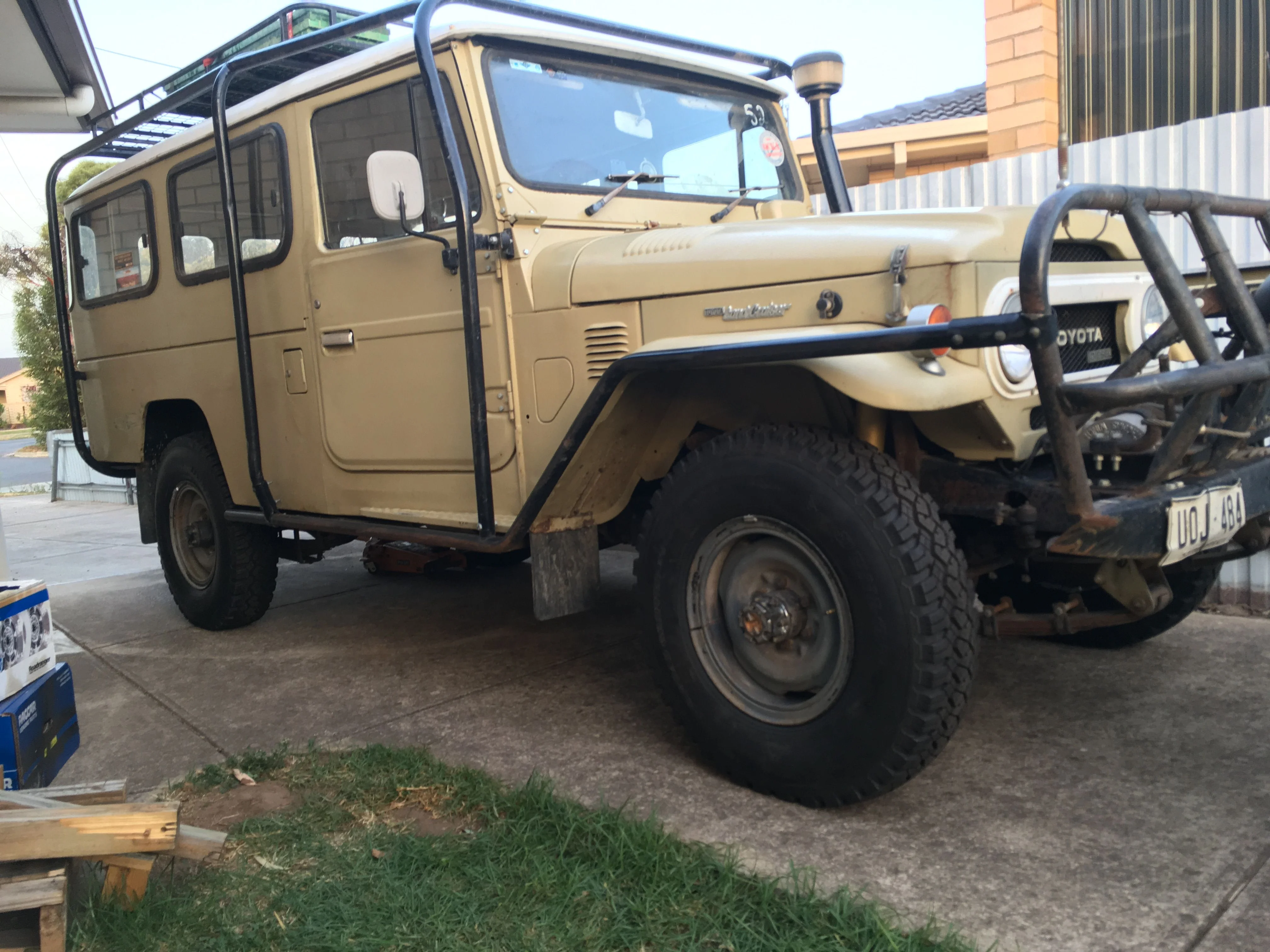

All back together will most of the rust repaired.
I used an early style front because it was what I had that wasn't rusted and I like the look.
I got a pair of genuine early indicators for cheap. I prefer these because they are steel. The plastic ones I used before would crack in the sun and on rough roads.
The headlights are semi sealed beams with park lights.
At this point the only original panels are one rear door and one front guard.

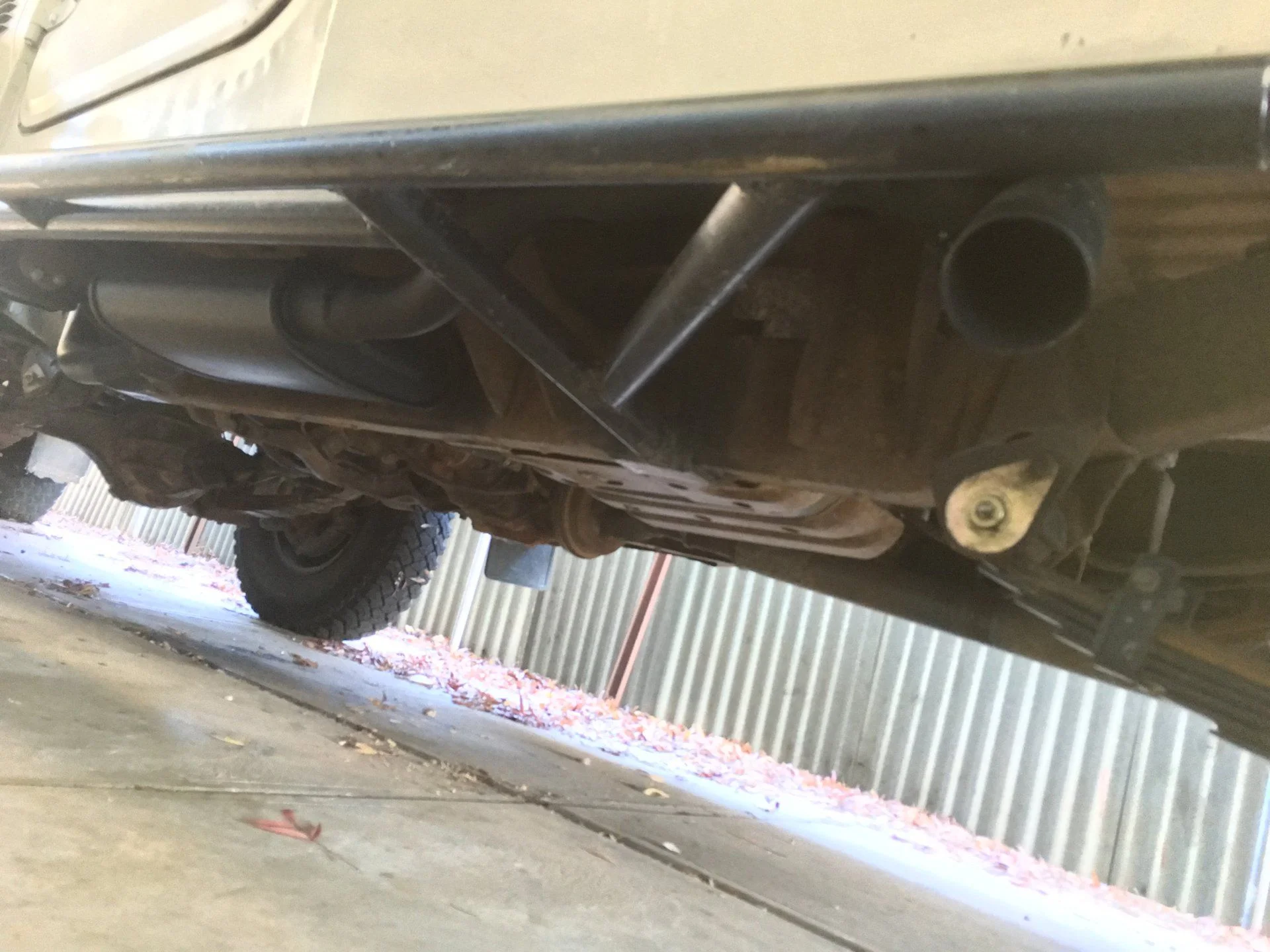

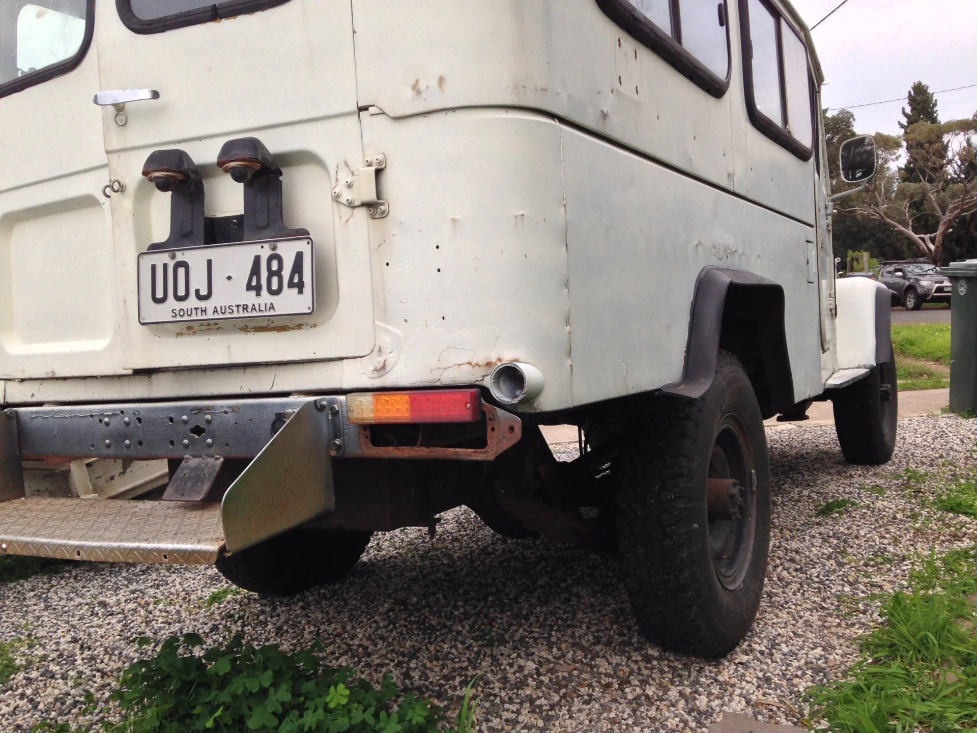

Got a new exhaust after having the old one fall off a few times.

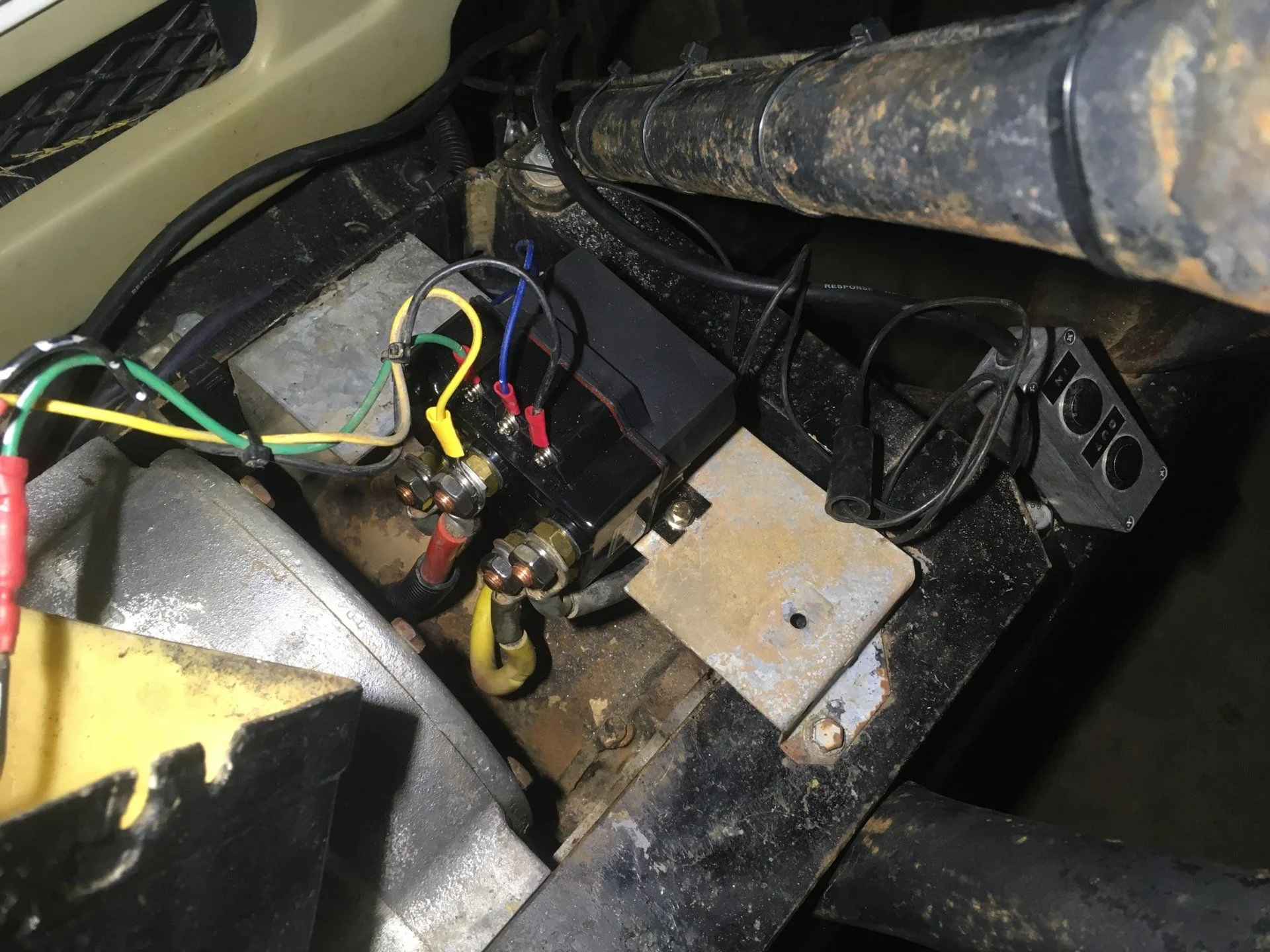

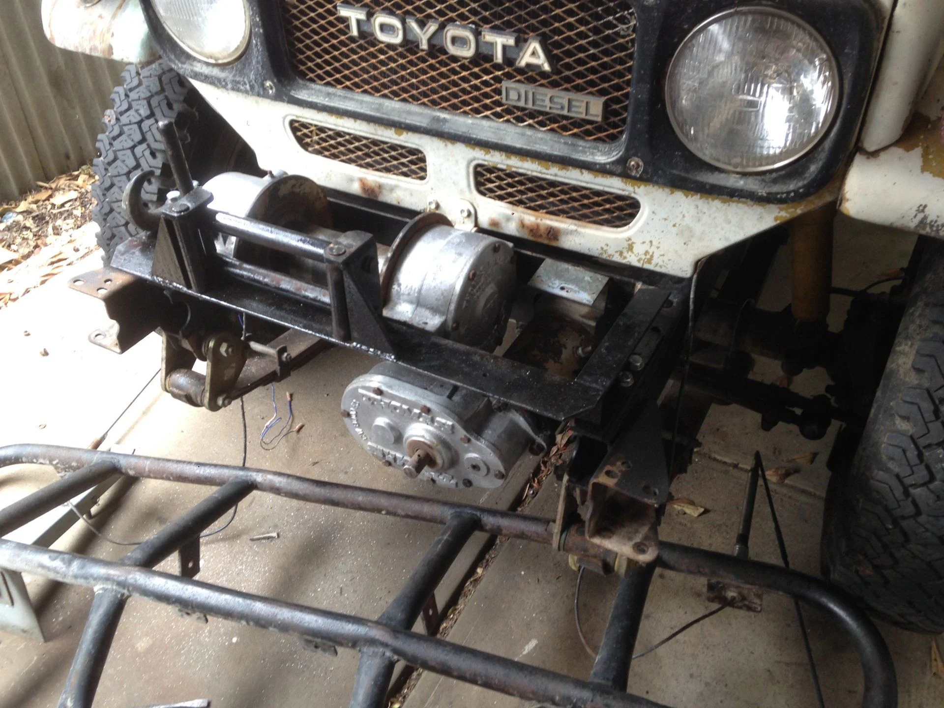

Winch solenoids were having issues with water, replaced with a Runva waterproof solenoid.

Snorkel I made out of some 3" exhaust pipe

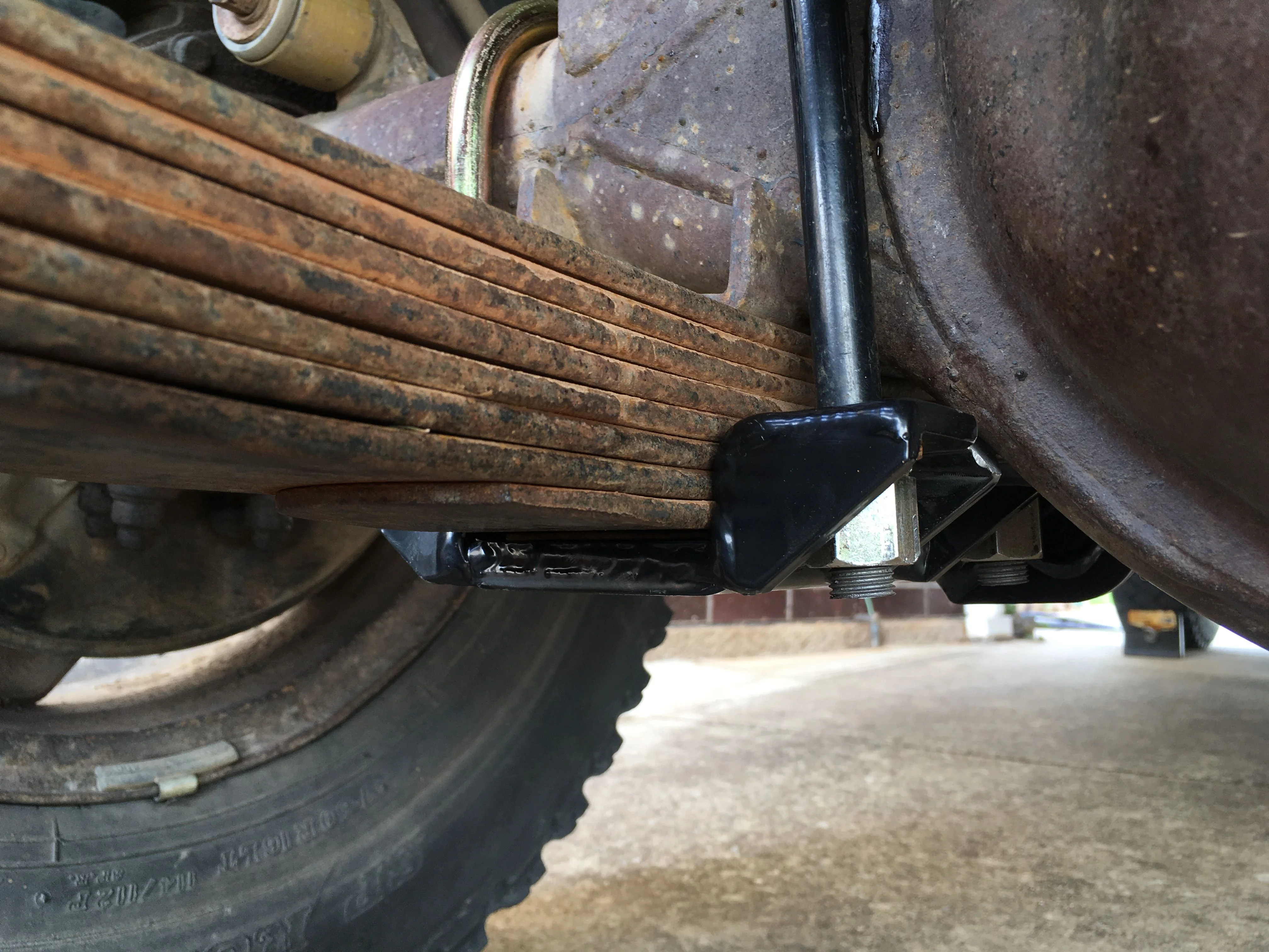

Got some Superior high clearance u-bolt plates. They are made for the rear of a 70 series but fit front and rear with some modifications.
full
full
full
33" tyres and the u-bolt plates together give almost 2" more clearance under the springs, as well as a smoother surface and prevents the u-bolts catching on things and getting bent.

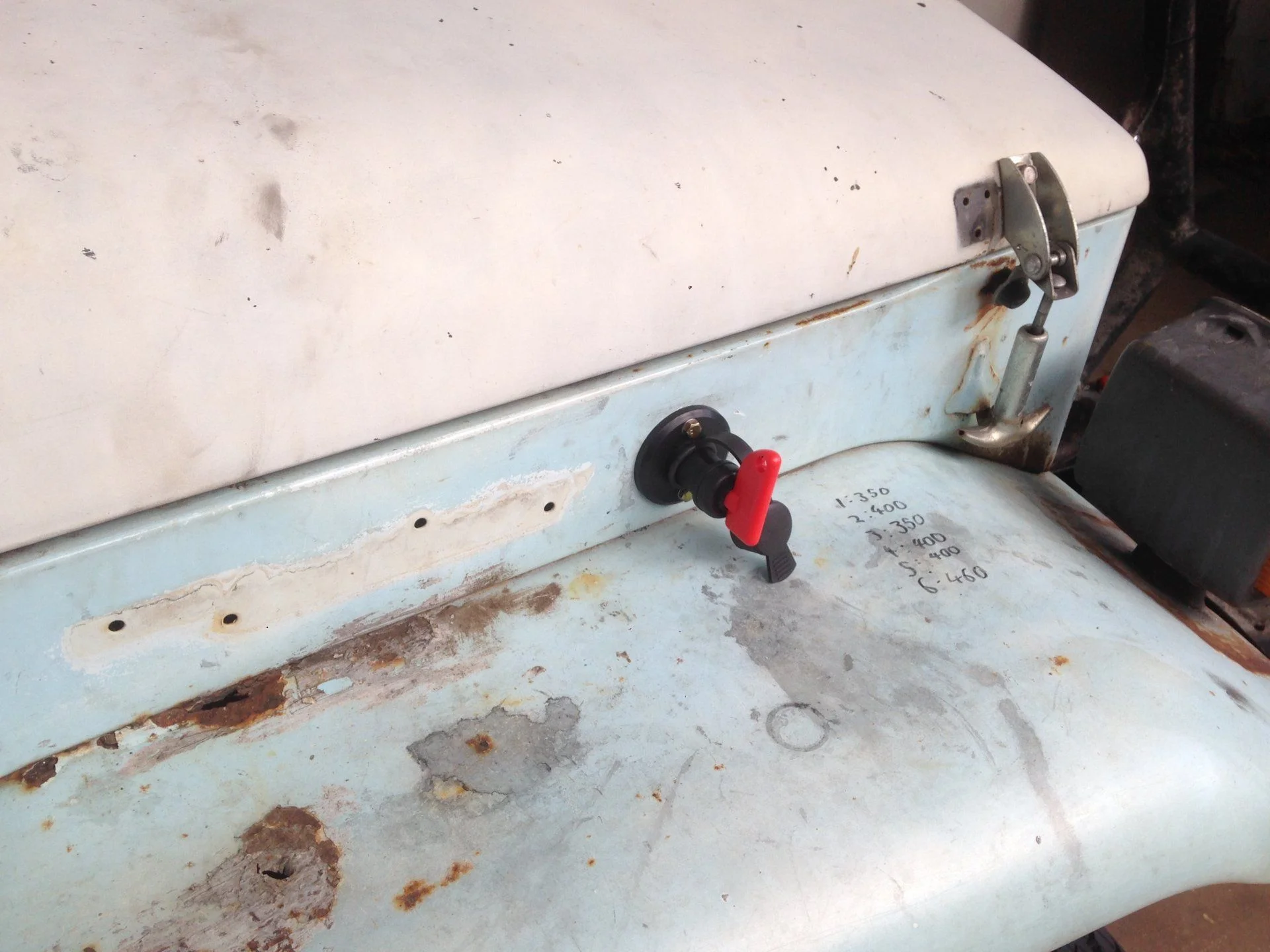

While I was doing the wiring I added a manual battery link switch (for winching and jumpstarting) and a winch switch on the dash.

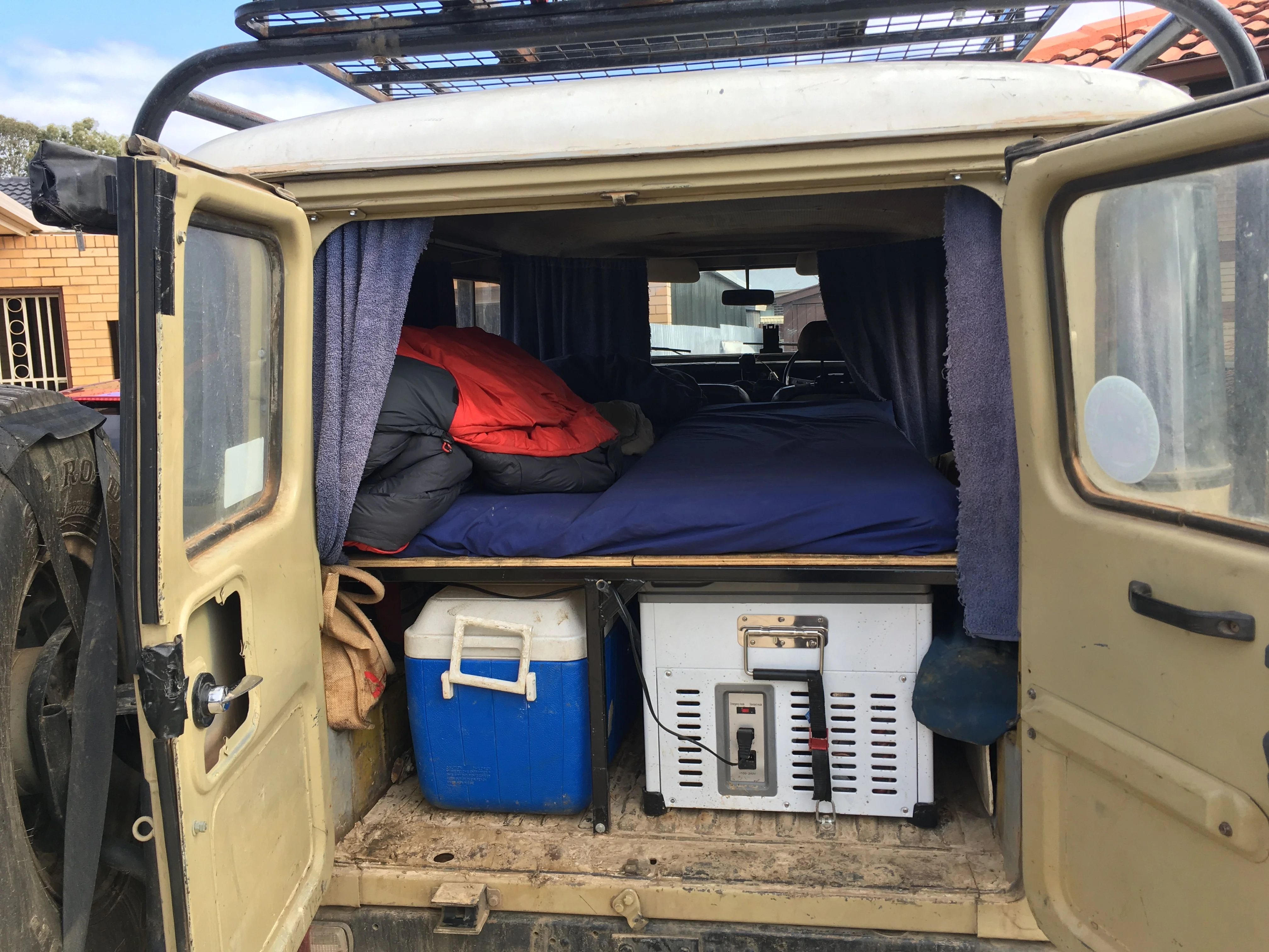

The double bed setup I used. Since then I have made the bed higher, it can be converted into a single bed by removing a piece and the fridge slides out the back.
full
