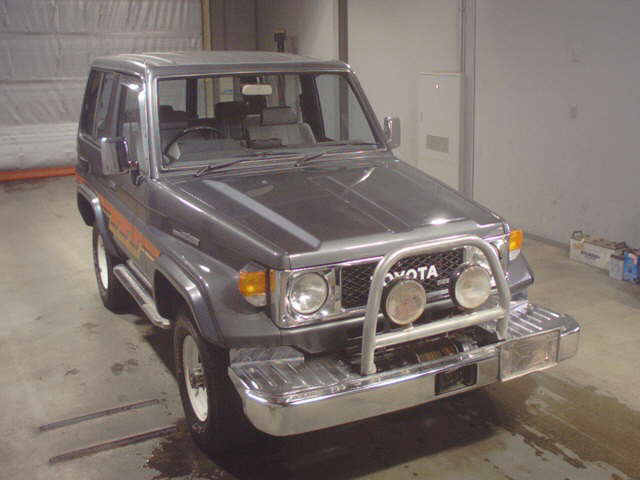

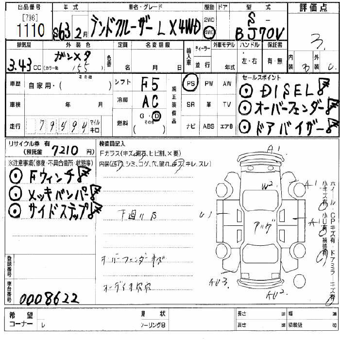

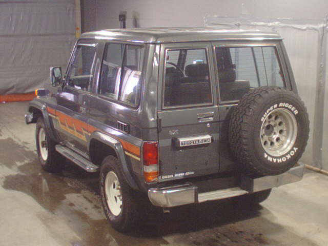

I've have someone translating the sheet for me fully, my Japanese is pretty piss poor, but I can sound out the kana. She said the exterior was rated 0/5, which seems crazy. The interior was rated 3/5, which I can see why. What I'm wondering is, did this get submerged? Notice the stains on the rugs and inner lining of the rear doors? It's a uniform brown silt. Could be explained if the owner was in a very dusty area, but after 49k miles, it just seems a little funny.
Possibly in the 2011 tsunami.

Those were my thoughts as well... it may explain something about the light body damage, too.

Auction grade 4 is rare with a vehicle of this age, but they do come around every so often, when they do I am skeptical of the actual grading. 3's and 3.5's are the norm for purchase worthy vehicles. Your interior and exterior grading is in the upper right hand corner of the inspection sheet.
I see it now.
Overall = 3
Exterior/外観 = C
Interior/内部 = B
Three scratches, one significant body damage (back left), one notable (back right), one dent (left) - more or less.
The Japanese VIN is BJ700008622.
