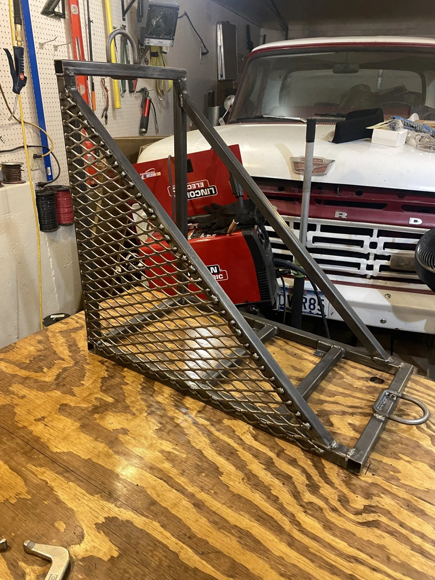

Stopped by the metal shop after work and picked up the little bit more tube and expanded metal I needed.
I wanted to fab the drivers side of the carrier as a big square, to install the expanded metal on and act as a nice mock-molle panel, but the square design would’ve lead to really tight loading clearances with the tire, so I opted to angle it like the passenger side and live with less storage space.

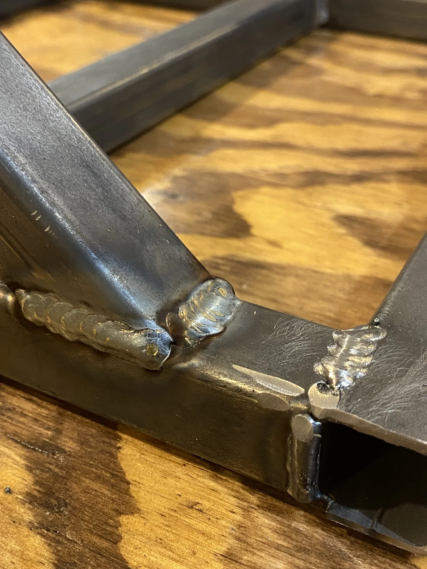

Your little Lincoln welder looks like it puts down some nice dime rolls!
I’m really liking the Lincoln. I started with a Hobart welder and thought it was ok, but after a few years using it, I just couldn’t help think there was a bit better for the price range.
A friend, who’s an actual race car fabricator, suggested this entry level Lincoln 140 and in the last few months, I’ve been very pleased with it.
@r2m you weld some too?
I’m a very amateur welder, but I like this one. It does what it needs to do…when I use it right, I think it’s a great hobby welder.
Here’s a closer up of my attempt at sloppy dimes. Thankfully, I’m not trying to earn a living with these welds and have plenty to learn still, but have enjoyed learning thus far and think it’s good enough for the type of projects I want to tackle, like this carrier.

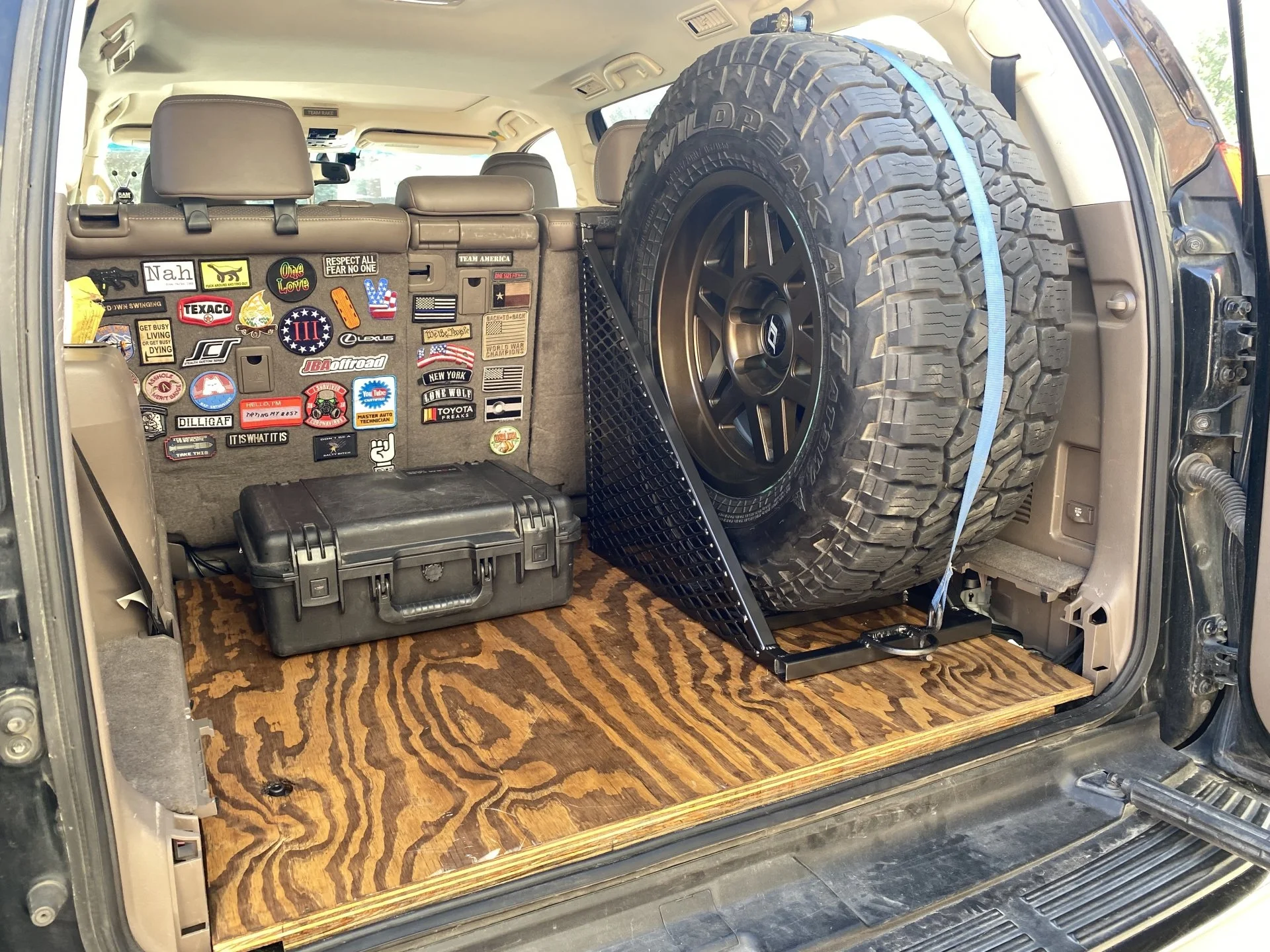

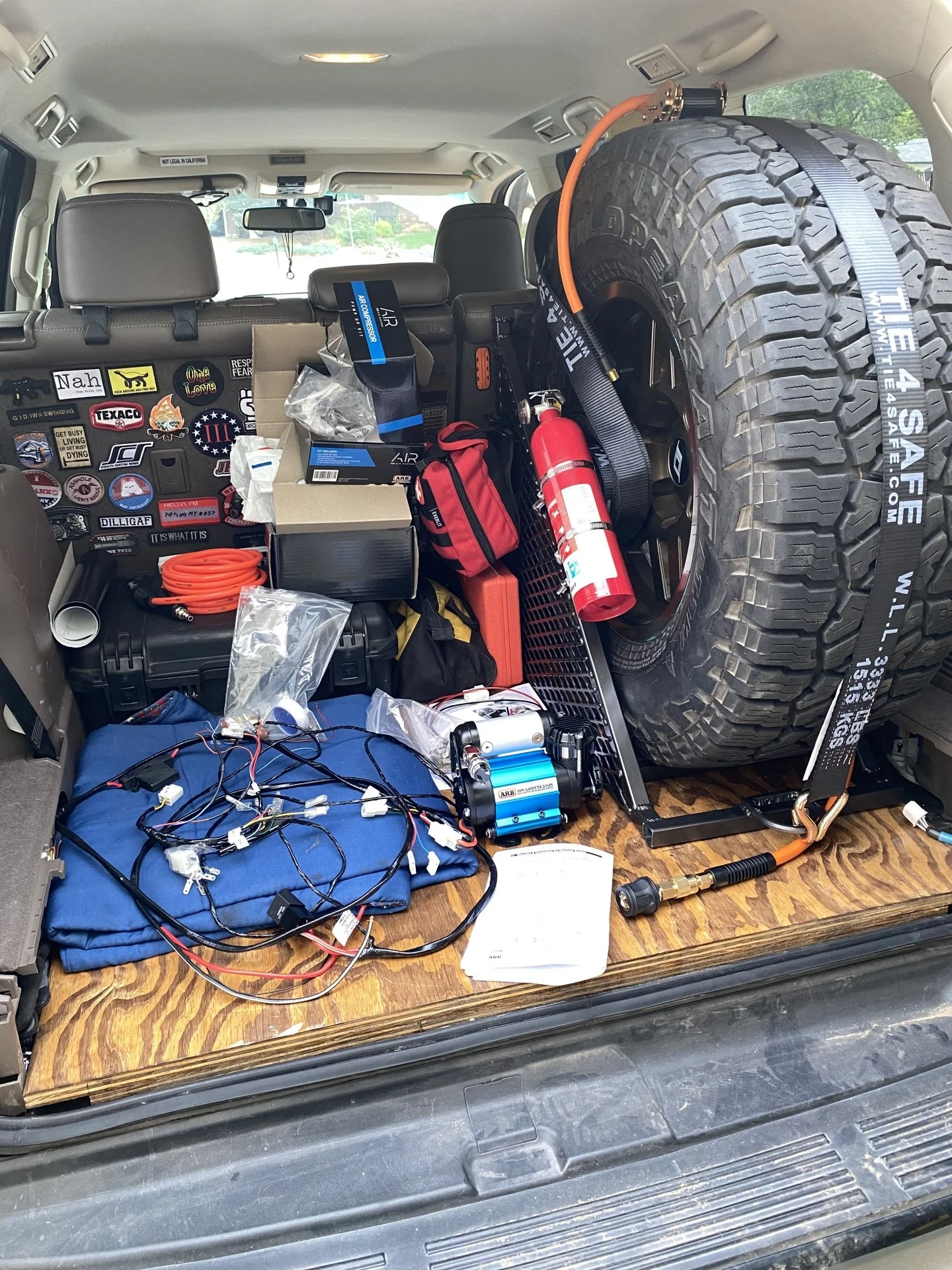

Well, wrong color carpet came in and the nice and wide tire strap is still delayed, so I painted the carrier, covered contact points with some felt for squeak management and installed it with a temporary strap for a little test run.
Went well with one exception; the weight of the tire moving over bumps/turns makes the front unsecured edge of the platform bend a bit, so it seems I do need more than two platform securing points. I’ll have to figure out how to attach it as I don’t have a rivet gun.

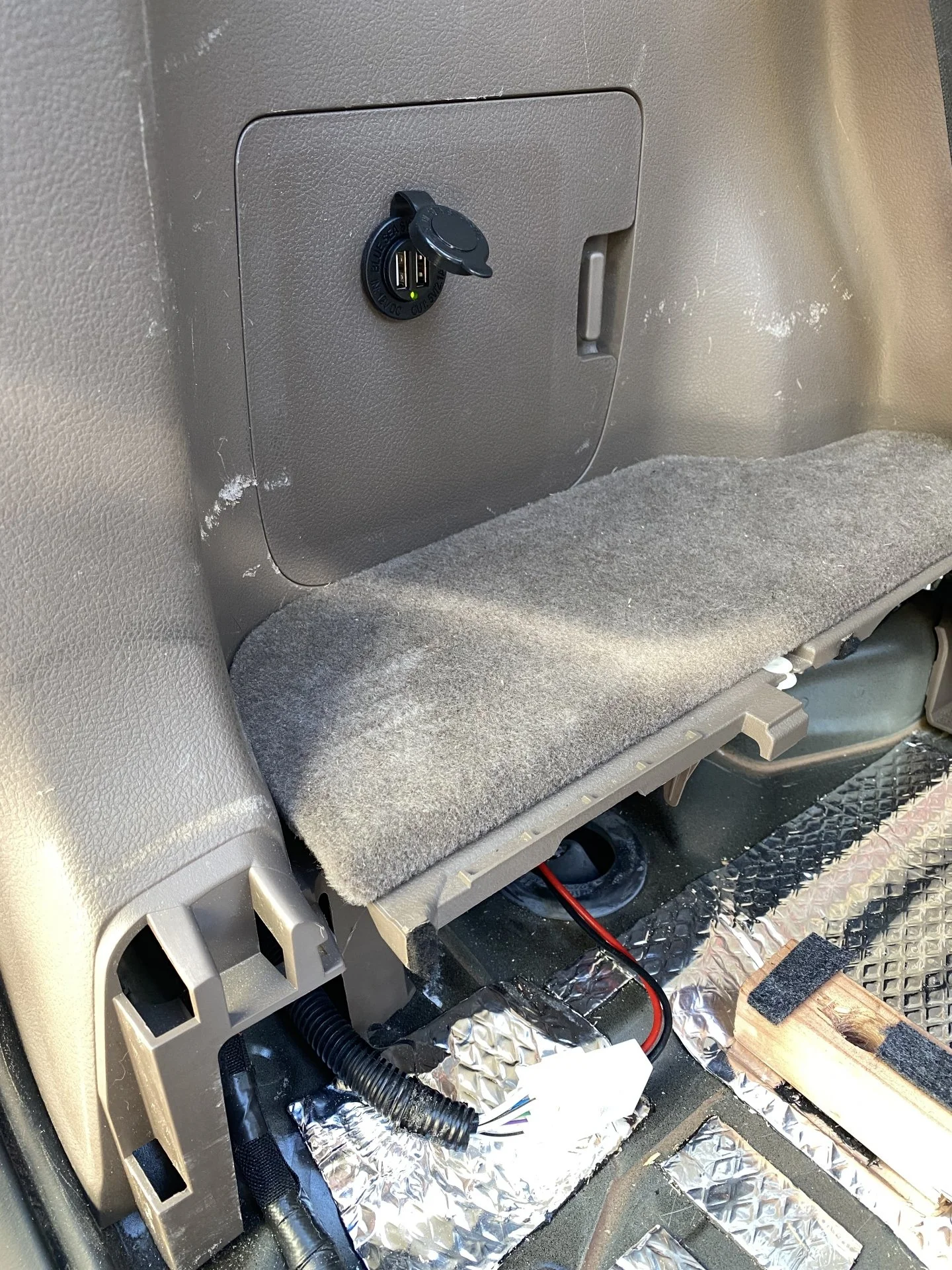

I also got around to installing my Blue Sea USB outlet with @THEOZMAN sweet connectors that make it an absolute breeze and clean install.
Drivers side is USB and passenger side will run the ARB air compressor.
View attachment 2701295View attachment 2701296
Glad they are working out for you. Please be carefull of the amp draw of the ARB air compressor. If it's at 20 amp or under, I would recommend changing the 30A fuse in the fuse box under the hood to a 25A since it will be running at a high power for a some time while inflating tires. Let me know if you need an help
Indeed. I planned to measure current draw under load and double check everything’s happy with the length, gauge, heat dissipation, etc when it gets here, but very wise tip on the fuse.
Regarding the flexing you're getting with the spare mount, is it the plywood flexing or is the metal frame you made flexing?
I think either way, if you add one diagonal support rod from the top of your metal frame down to the the bottom of the drivers side plywood, basically down along the back of the the middle seat, that should mitigate any flexing on turns.
As an example, how racers use to add a diagonal brace behind their head rests on race cars.
It’s the plywood flexing up in the center, near the 2nd row seat back. The tire weight and it’s mounting points are just too much leverage when I shake it by hand.
Not too surprising, I was pushing it by only securing it with two bolts and knew I might end up having to add more, so no worries.
Joined some friends for a quick camping trip last night, did 20+ miles of washboard roads and another several generally off-road and it didn’t seem to move much, though I’ll still secure it more.

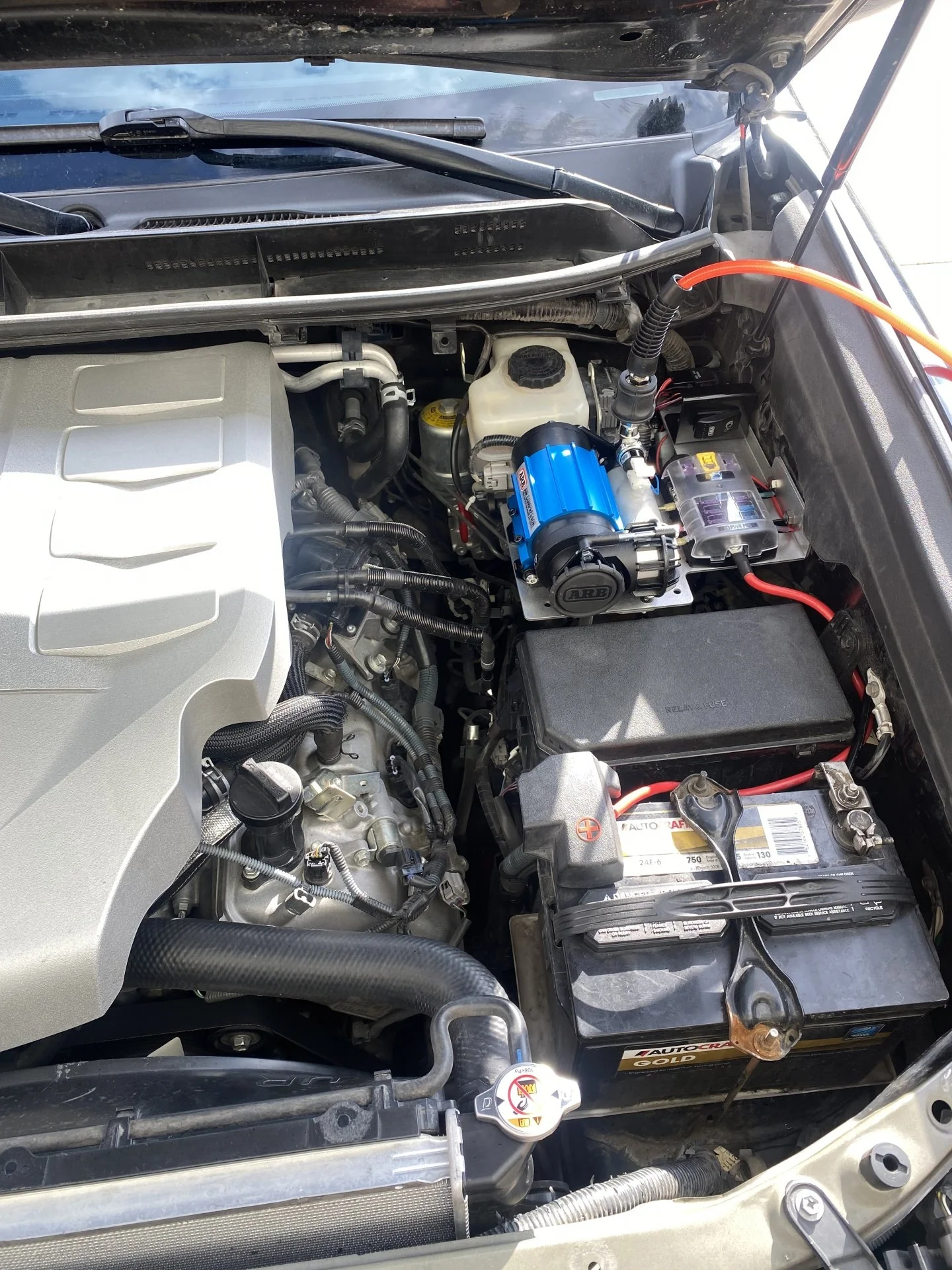

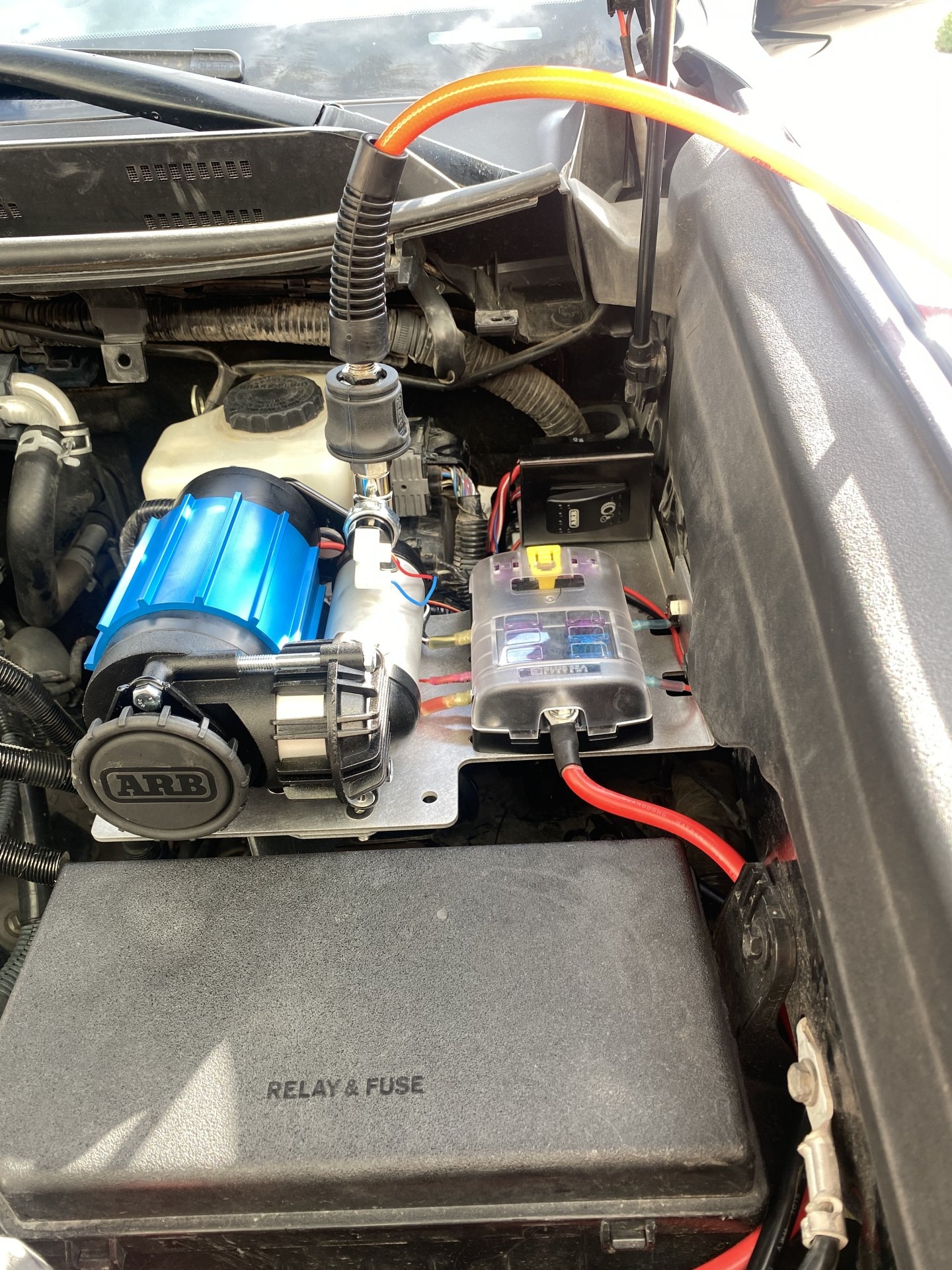

The wife wasn’t thrilled with the idea of the compressor inside the cabin, so plans changed and I ordered the Rago Fab compressor mount.
Installed it all today, put a Blue Sea fuse block on the unused portion of the mount (since I’m running the baby single ARB compressor) and rewired my ditch lights to the junction box as well.
Installed the compressor switch inside the engine bay as well as I didn’t have a slot available inside that’d fit the switch.

First, good call not having it in the cabin! For me, too noisy, especially when I'm airing up tires for 10 minutes with my wife in the cab waiting.
I have my compressor in the same location and have not had any issues with the quick release and were we live, off roading is usually very dusty.
If you really want to, just get a male nipple/connector and cap the end of it. Stick it into your female compressor connector and call it done! Or you can keep your hose plugged in.
