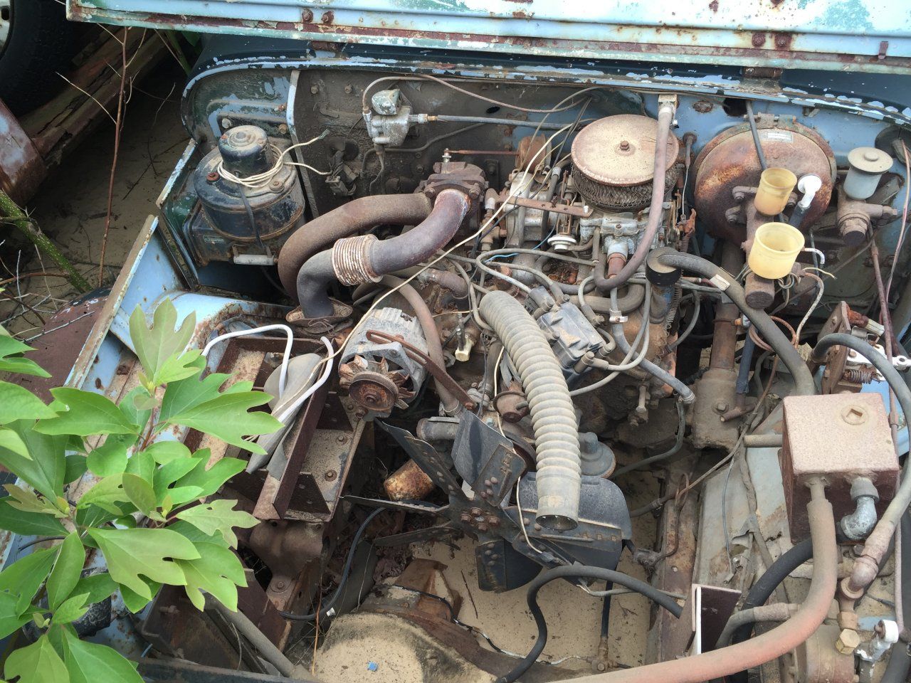

I did find one old 40 with some odd little v6 with a turbo.

That is a Buick V6. Odd place to find one.
225 or 231?
good torquey motors.
:hmm:

225 or 231?
:hmm:
Most likely the 231 which was turbo charged in the Buick grand national. That may have been one fast fj40.
