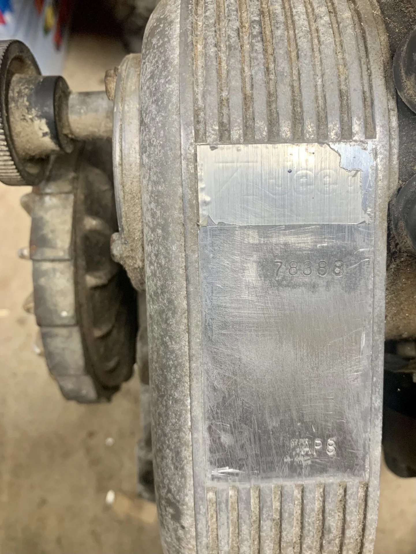

I have a Jeep SE 8274 and there is a date code under the decal towards the bottom. I had to remove the decal to reveal the date code. The Jeep SE models serial number is in a different location and the Jeep SE decals have an opening that allows the number to show. The warn decal will cover this. I’ve included an image of the date code on my Jeep SE model.
