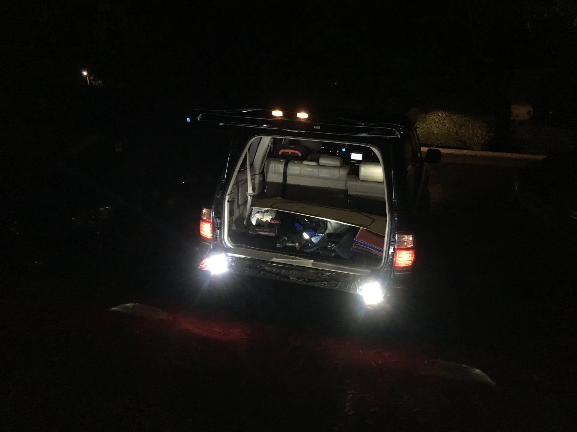

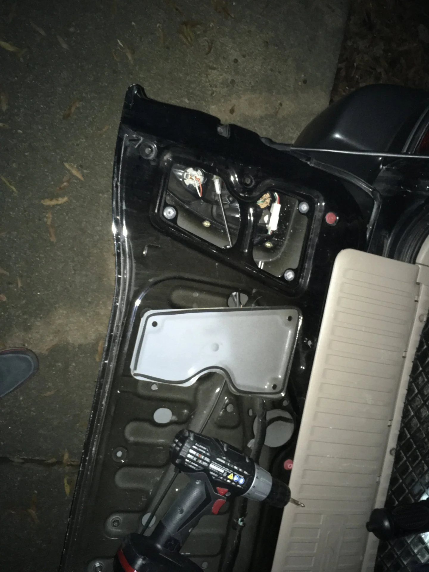

Ever since I bought my 100 earlier this year I noticed how great the outward visibility was, but with factory California-car tint (2001 Lexus LX 470), trying to back up in-between two cars in a parking space at night in the rain felt like roulette. Even after I installed an aftermarket backup camera with my aftermarket headunit, the lighting seemed poor. Both reverse bulbs worked, but they were not putting out enough light.

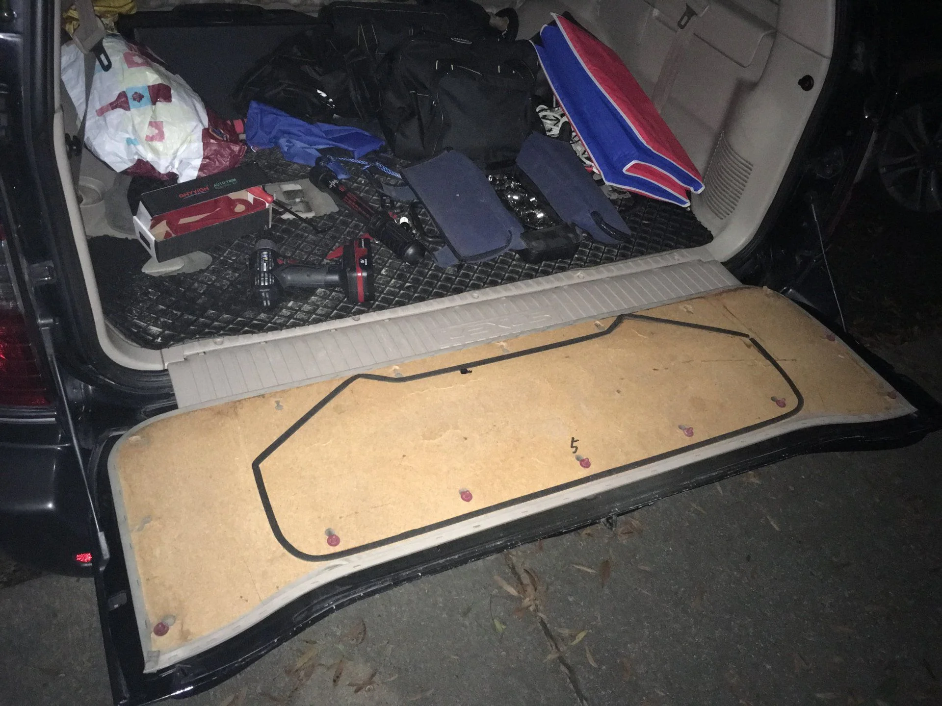

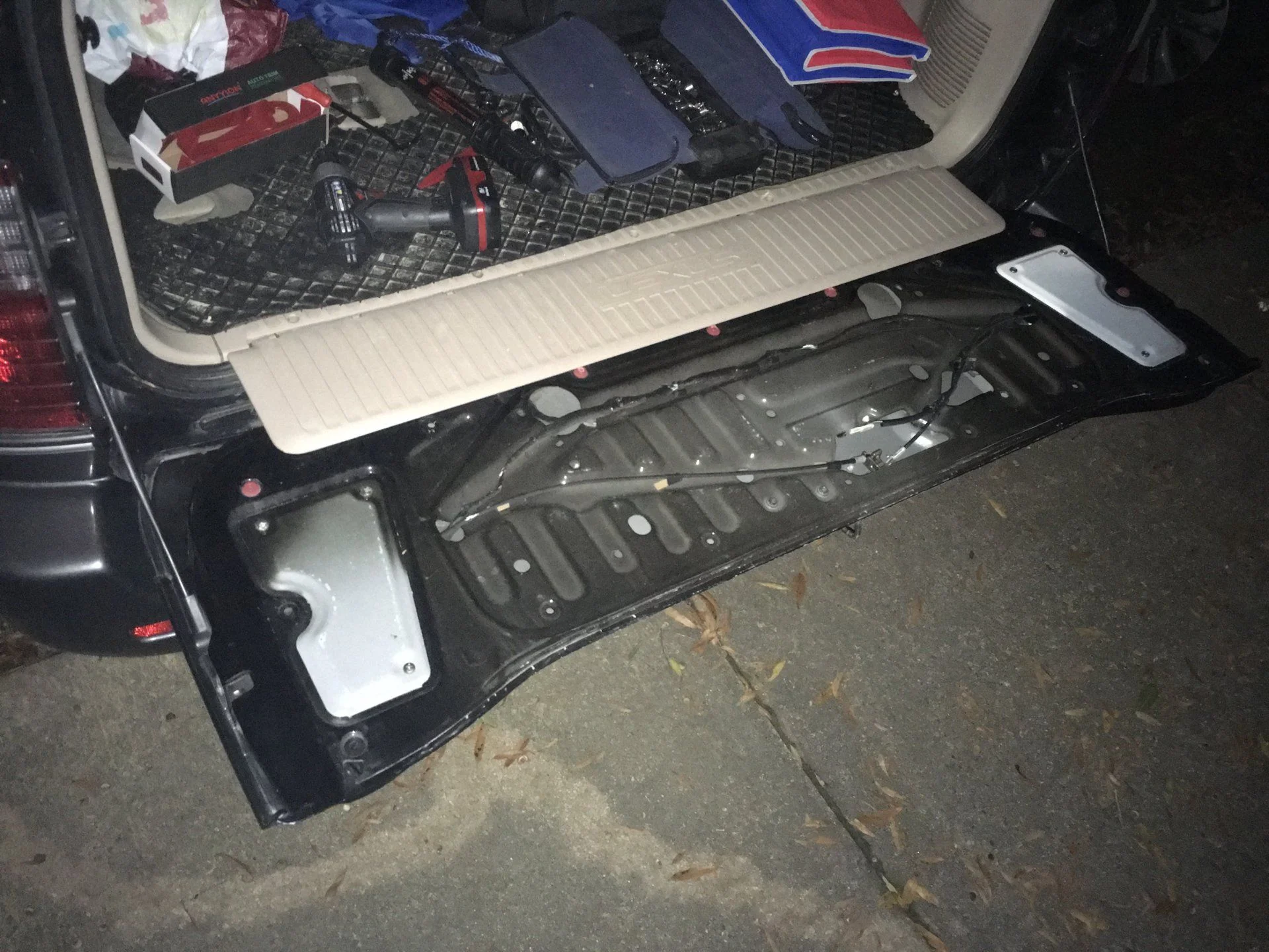

I dropped the lower hatch and used a trim tool to pop off the carpeted lower hatch covering. Then on each side it was three screws to remove a metal plate and I could access each taillight. Just unscrew the top one and pull the bulb out, then stick the LED bulb in. Reviews suggested that if it didn't work, pull it out and reverse the insertion of the LED for polarity's sake, but I never had to do this. Anyway, I put it in reverse and backed up.

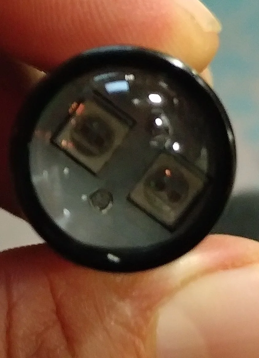

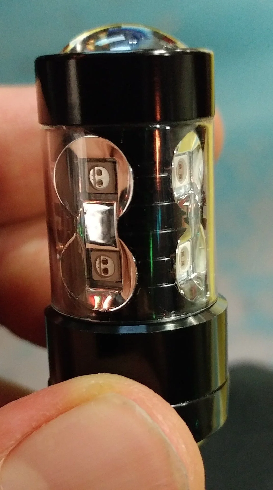

Pics... last one is of me testing them before inserting into the housings and putting all the trim back together, but you get the idea. They are bright.
I have them as well, 2yrs now. Love them. I can now see kids in the parking lot as I back over them, before I was just feeling the bumps.

Also, this may be a dumb question but here goes.. Was your carpet missing from that panel already or is removing is from the board behind it part of the break down?
In the first picture I flipped the carpet piece over and positioned it to show where the snaps are, they are a little hidden.
Interesting, mine look totally different... see pic.
