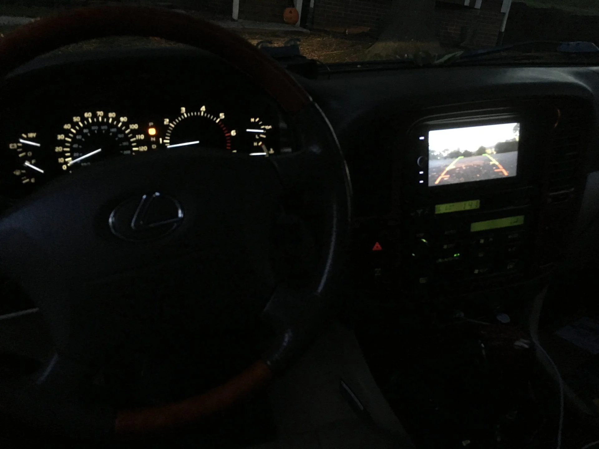

I'm surprised it is washing out your rearview cameras. For me, it's only an improvement. It's brighter but that's the whole point. I have a Pyle aftermarket camera running into a Sony headunit, if that makes any difference. Are you guys using factory backup cams?

Where is your camera mounted? Mine is right above my tag and has little LEDs built in it.
Next to trailer hitch on drivers side, sharing a mount with the trailer wiring plug. No built-in LEDs.
It's not so much washed out as the screen itself is just so bright now that it's distracting. Liken it to someone turning on a map light when you're driving at night. I can still see the image in the screen, though.
I see. Yeah, my screen is pretty darn bright now, that is accurate. I'll take extremely bright over I-can't-see-anything. :)

My back up camera is still perfectly visible at night with the LED reverse bulbs. I also have LED license plate lights that are super bright, they are on either side of the camera.

I'll play with the screen brightness just in case it was turned up for some reason. Generally I keep them set pretty low, and the screen isn't even on 99% of the time.

I realized today while at work that the reverse lights on the Lexus 100 series is on either side of the license plate, which means they are right nest to the camera, and on the Toyota 100 series they are in the tail lights.
So if you have a LX I can see how the extra bright LED’s would mess with the monitor picture. So I apologize to anyone who has the LX and thought I sounded harsh.

spike you make a good point. My 01 LX has the backup lights inside the taillights like the LC does, so that may be why it doesn't blind my rearview camera as much (and my camera is mounted low, on the trailer hitch).
