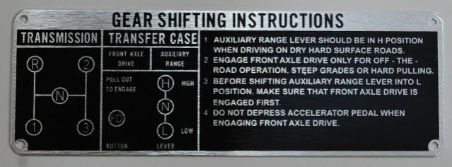

This is all I could find with the FD knob. Mine has the same plate.
attachment.php
*Oops, that's a three speed.

gear shift instructions
In the end it should look like this,

cool rudi, you found this on the EPC?
so for all wondering if my plate design/layout also exist in english, it probably does...

This is from a page from a parts manual that I have in pdf format. It's 67 pages included positions of the emblems probably for jdm versions. It's a 1.3 Mb file. PM me if you (or anybody else) want a copy.

More info,
I found the same info on the EPC. I entered BJ43 1978 Gen market and found that the part# is 74551-60180 for Japanese, 74531-60161 for english and and 74531-60190 for english with text magnet front drive. Price €43.43
