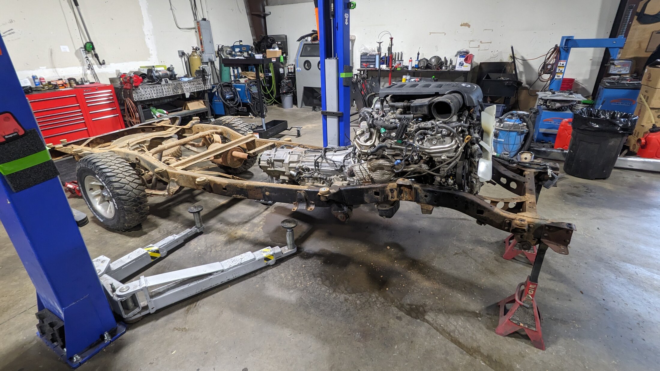

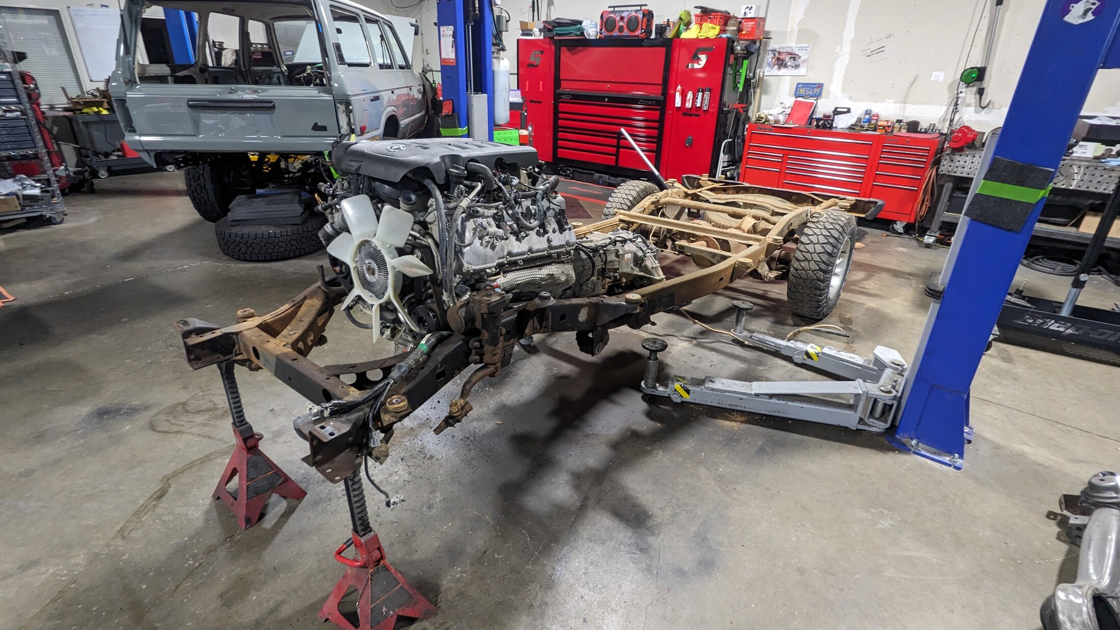

A good day and to recap:
2021 Tundra 5.7 I-Force, 6 speed and tcase.

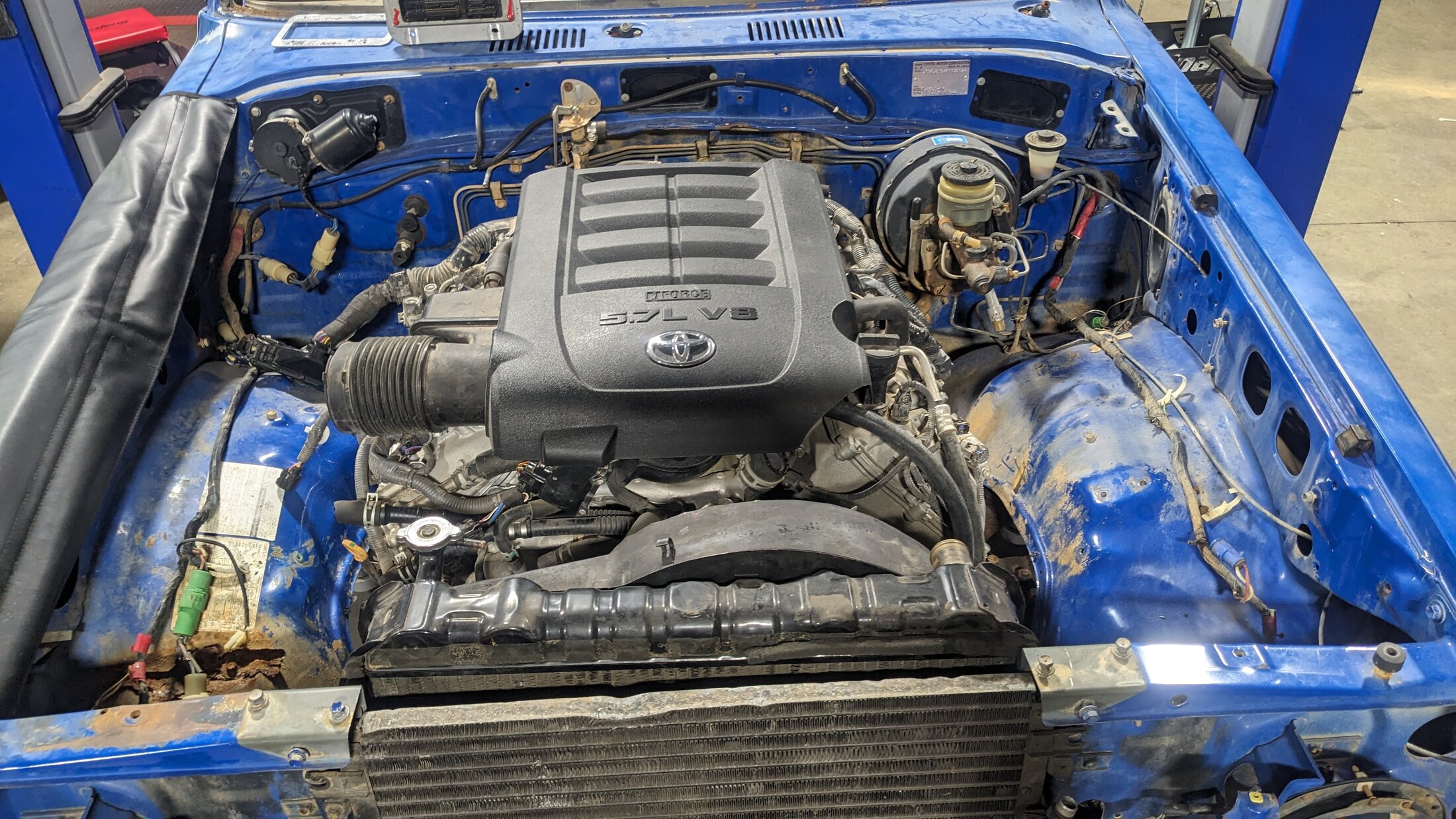

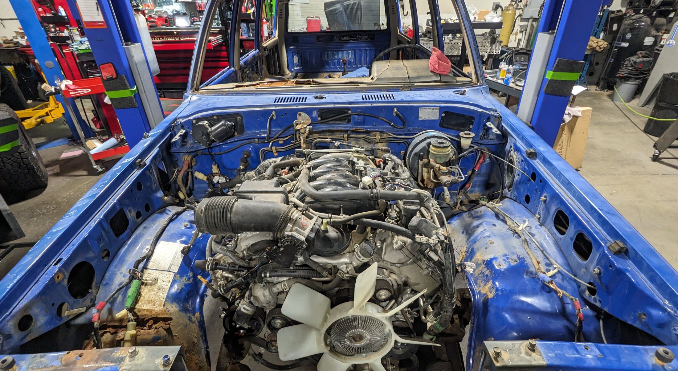

Good thing there was a piggie in the shop to get some grease to shoehorn that 5.7 in the 60.
Fit up was awesome; no mods to steering, brake booster cleared, plenty of room for exhaust, custom motor/frame mounts, donor radiator is a perfect fit and will extend the shroud for optimal air flow and protection.
CUSTOM FLIPPED FRONT 80 AXLE IF YOU HAVEN'T BEEN FOLLOWING ALONG TO ACCOMMODATE THE TUNDRA DRIVETRAIN.
This is a 100% Toyota build no aftermarket conversion pieces here.
Now to pull it all apart and down to the frame.
Then the rebuild will start.

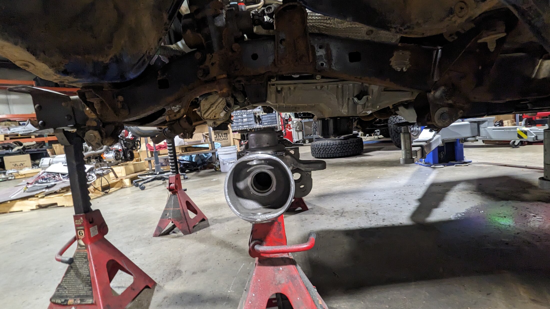

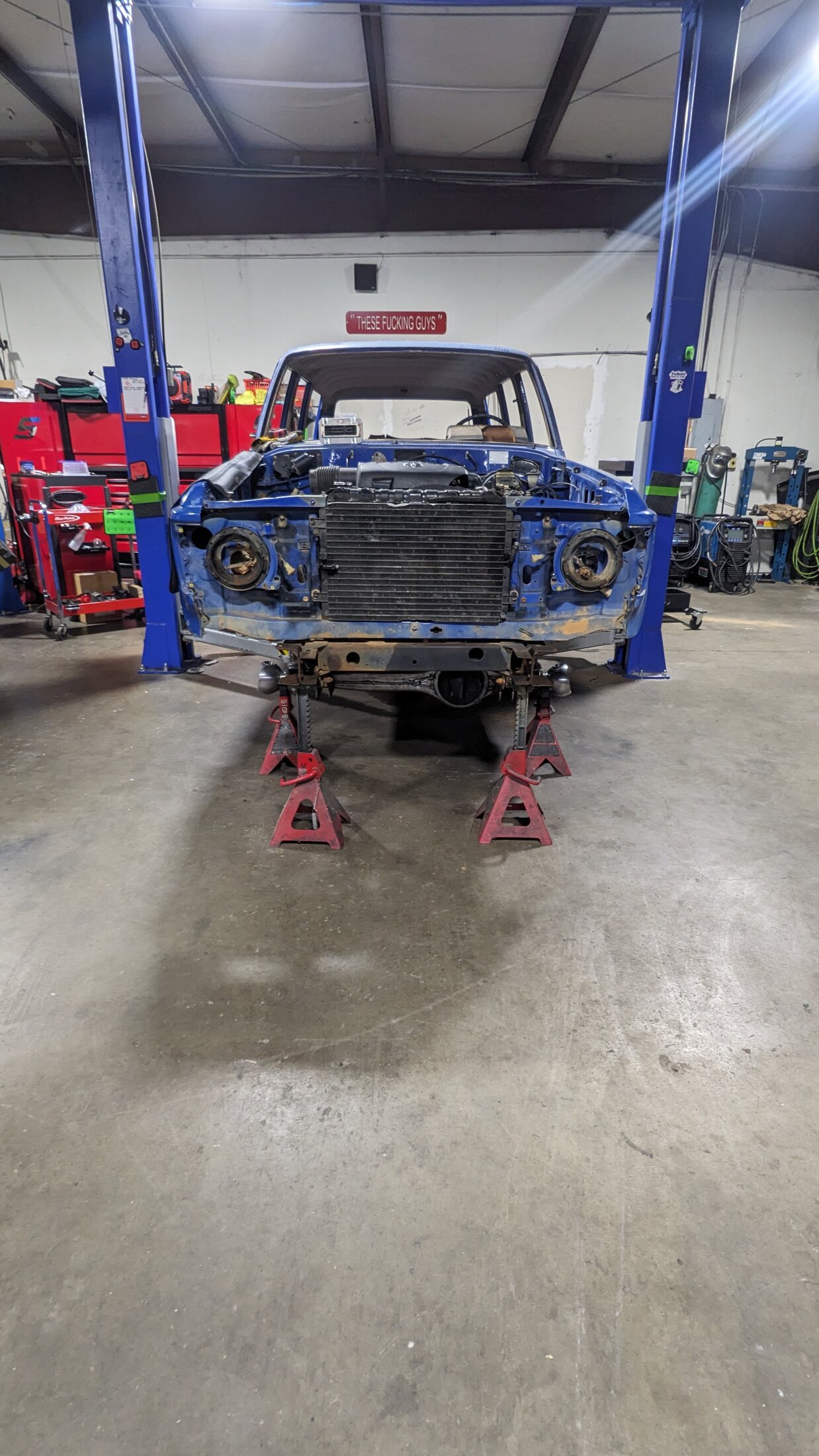

Setting the axle in place and checking clearances. Set the frame at approx. ride height compared to two others in the shop.
Will relocate the oil filter higher up in the engine bay. Its in the the way of the steering and panhard both. Maybe 2" of up travel before it will make contact. Otherwise no issue anywhere else.

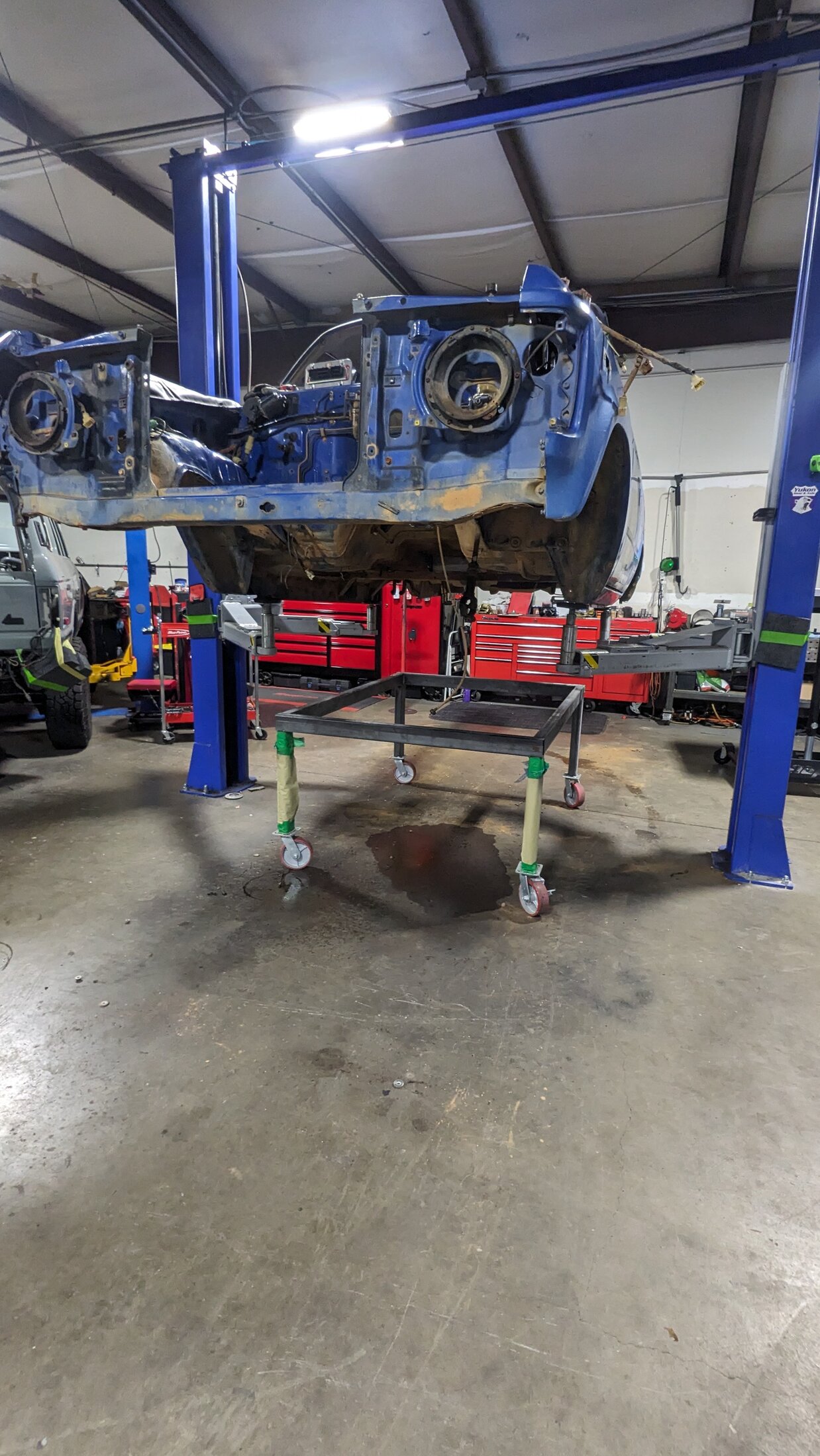

Now we can pull the drivetrain and I can start on the coil conversion and make up the relo plates and bungs.

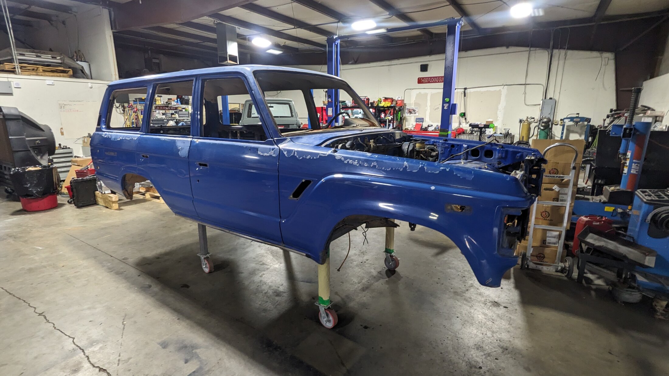

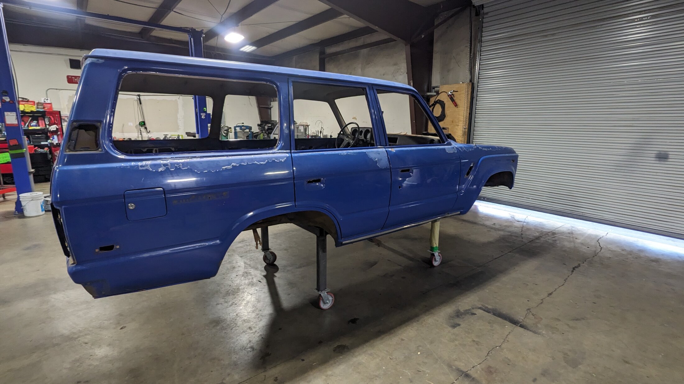

Body will get pulled and over to the paint shop for a complete paint job. Other than 2 little dents and door dings it should go smoothly. No rust repair on the main body at all. Two small windshield weatherstrip areas will get addressed (about 2" in length each)
J
J

What’s the size/weight/power compared to an equivalent LS?
Sure would be cool if someone were to develop and sell some kind of kit for owners who would be interested in a diy Toyota engine swap like this…..
Depending on how this one goes, I may make a kit later on. I have all the files saved for the motor mounts and transmission crossmemeber.
I don't think the Magnuson supercharger would need a hood scoop, but certainly more air intake.
Nothing to do with air... would add too much height to motor for the hood to close. I have the motor sit in the lower possible location and still able to remove the AC/Alt if ever needed. Any SC would not allow the hood to close that I have measurements for.
