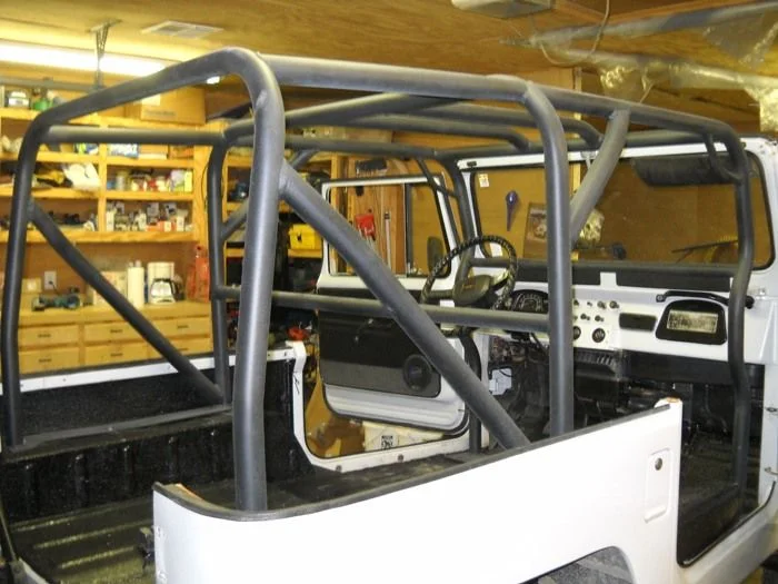

We would have added the rear spreaders but he didn't get the tubing for that. The bar right behind the front seats came from his shop. Anyone got any 2" tubing he can get for the rear spreaders?
only tubing I got is 1.5 inch which won't look right against the 2 inch tube.
Holy COW You guys don't fool around! It took me months of fitting before anything got welded in. Should have taken that welding class a few years earlier.
Looks great JRob. All my extra tube from my old cage is currently Jeff Davis' brush guard!!
Did all of that in 5 hours. If I could have gotten my lazy ass out of bed we would have finished it!
Lenny, I didn't order those rear bars...wish I would have.
I should have something around the shop that is 2"....I am going to look tomorrow. I am thinking about putting a bar behing the back seats. what do ya'll think?
As for as the progress..... had a desent welder!!! He welded it out today in 2:30 minutes.
Took a minute to get going, but after we got the first notch (after 4 tries) right...WE ROLLED ON!

Trying like hell to get this thing together so I can drive it,... check it out before I haul it all to Texas.
The cage is fine. I have rolled much less of a cage than that many times and it held up fine.
Maybe a "V" in the back over the rear seats, but I would not get too wound up.

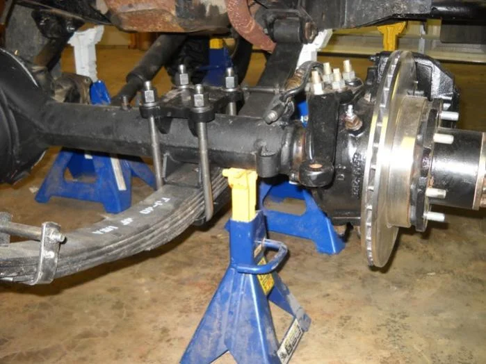

here is a little progress update.

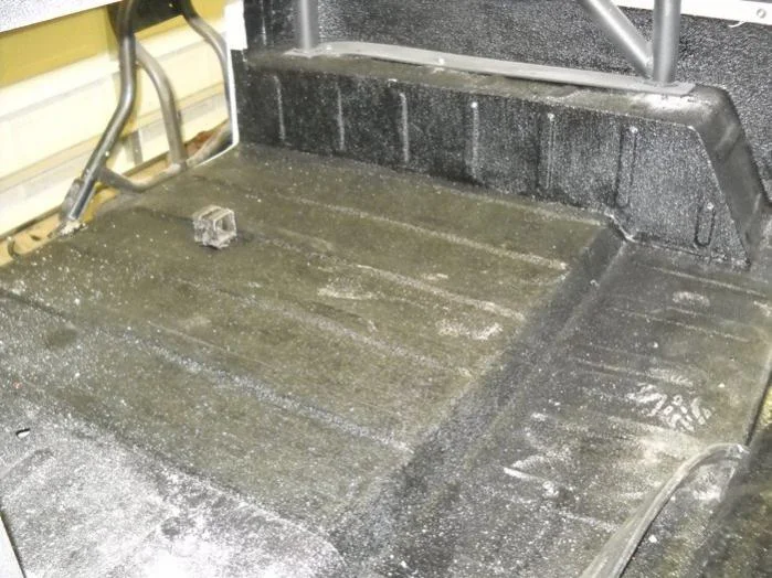

I had some help from a few of the fellows over the weekend. We got the front springs and front axle under the truck. I have issues with the rear....PO must have seized a bearing at some point(i forgot to take pics of this). Taking it to a machine shop tomorrow to see wha they can do. I got the interior bedlined and the cage installed.

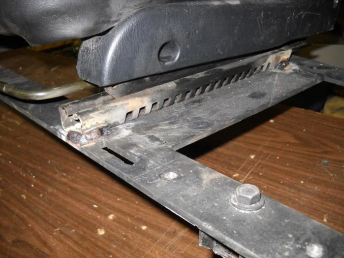

here are a few more pics of the cage, bedliner and where I had to weld the seats directly to the seat frame.
