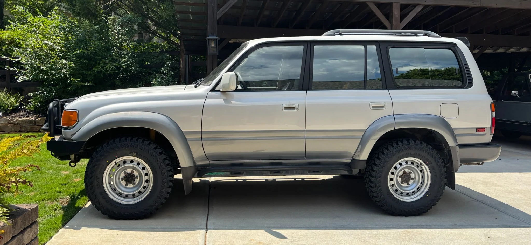

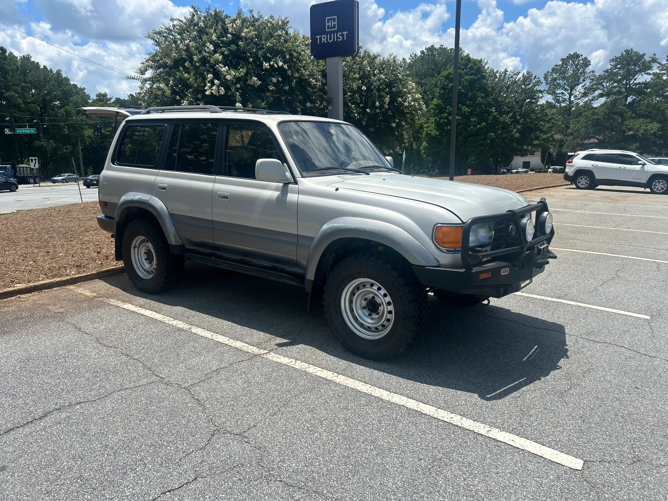

I've been a FJ40/55 guy since 2018, and a Toyota guy for years...but today, I joined the 80's club.

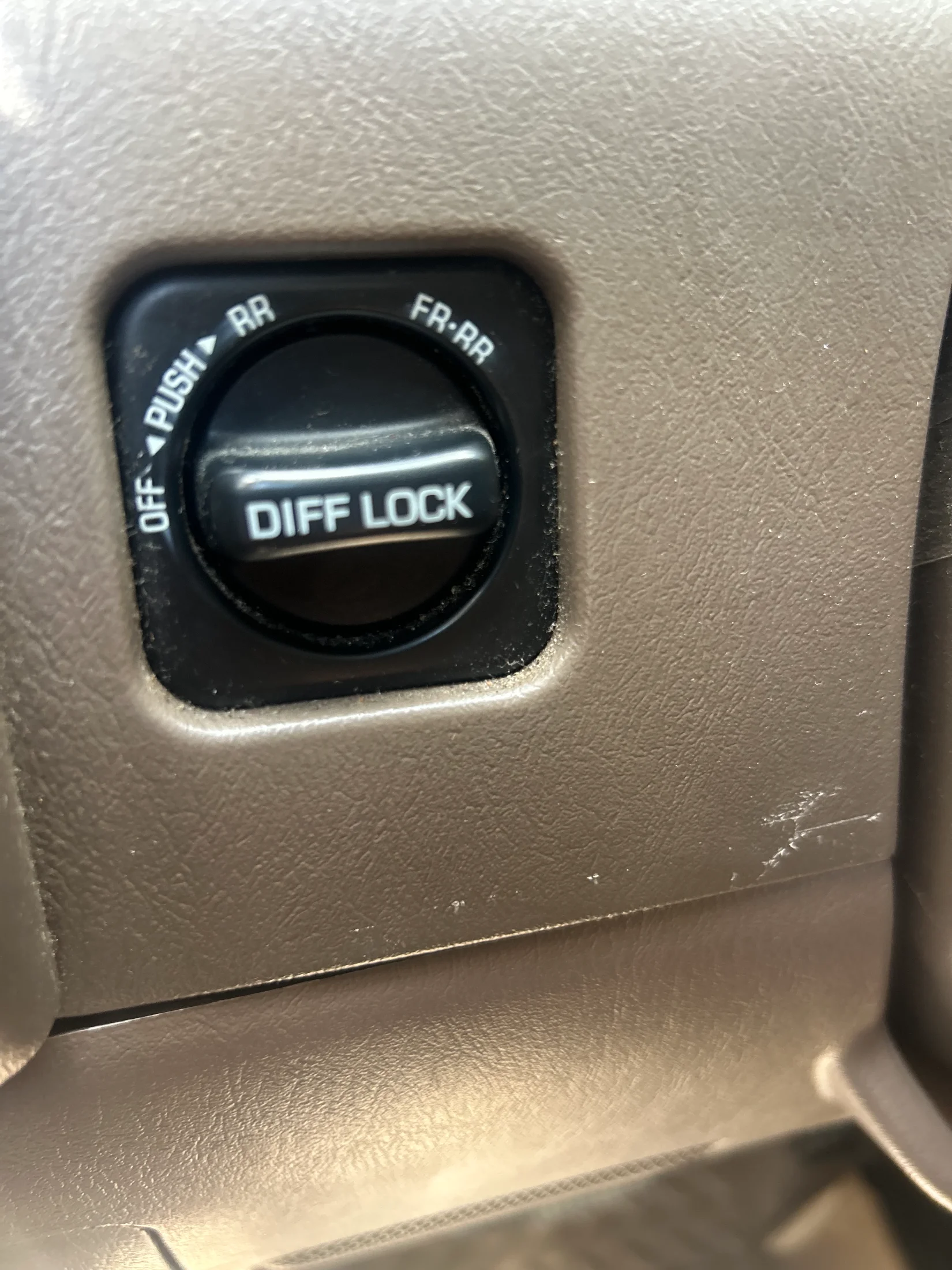

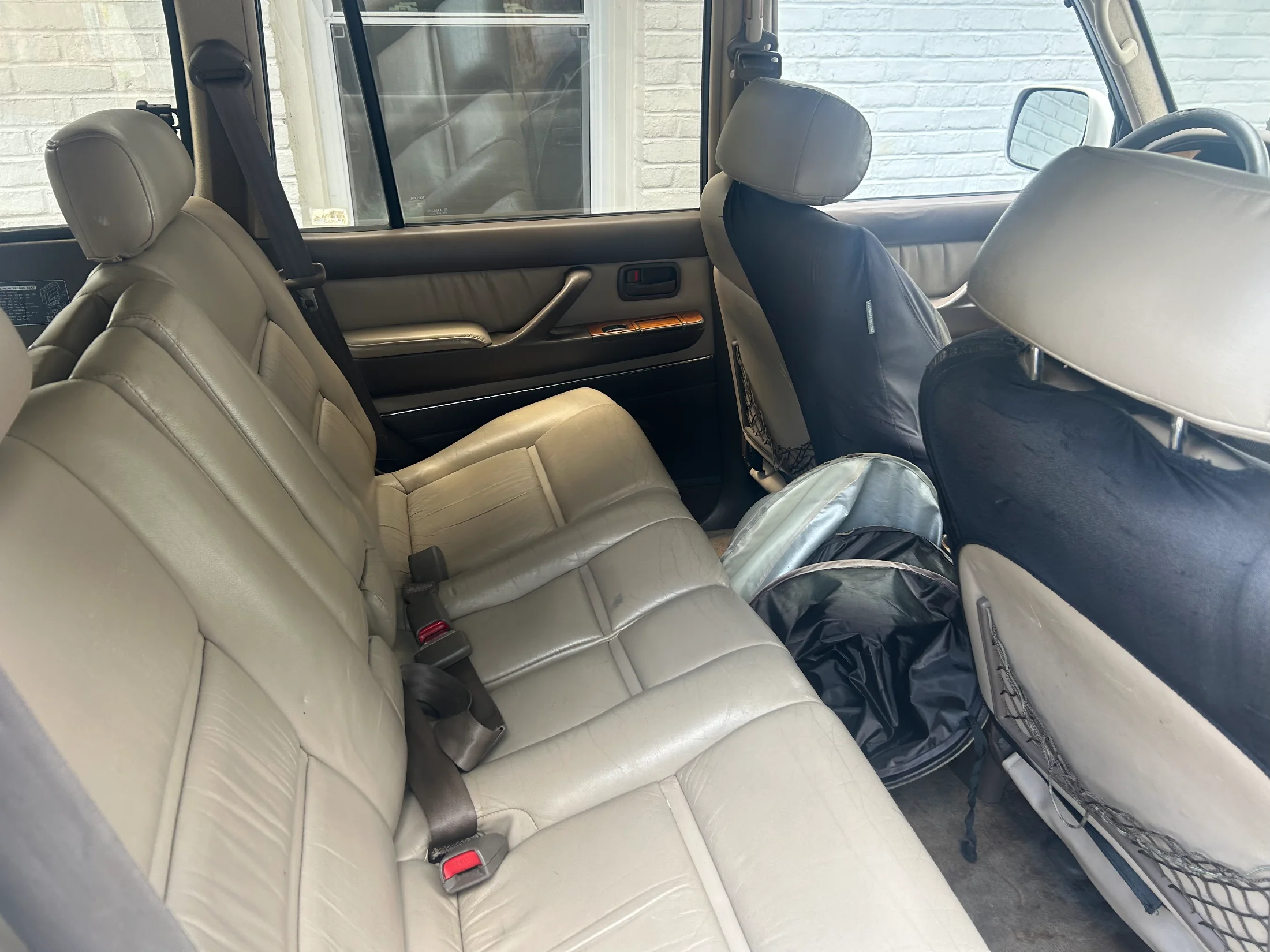

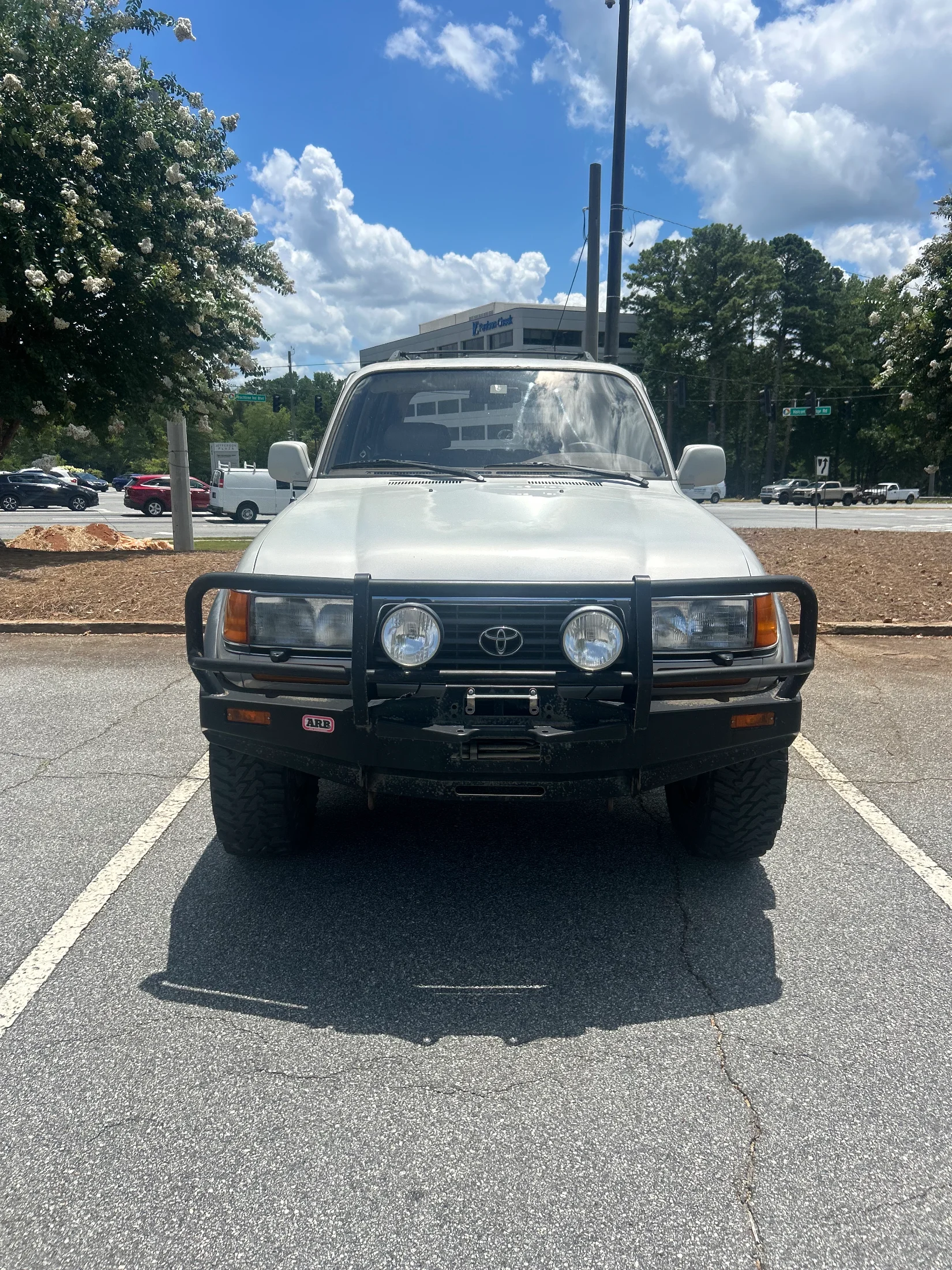

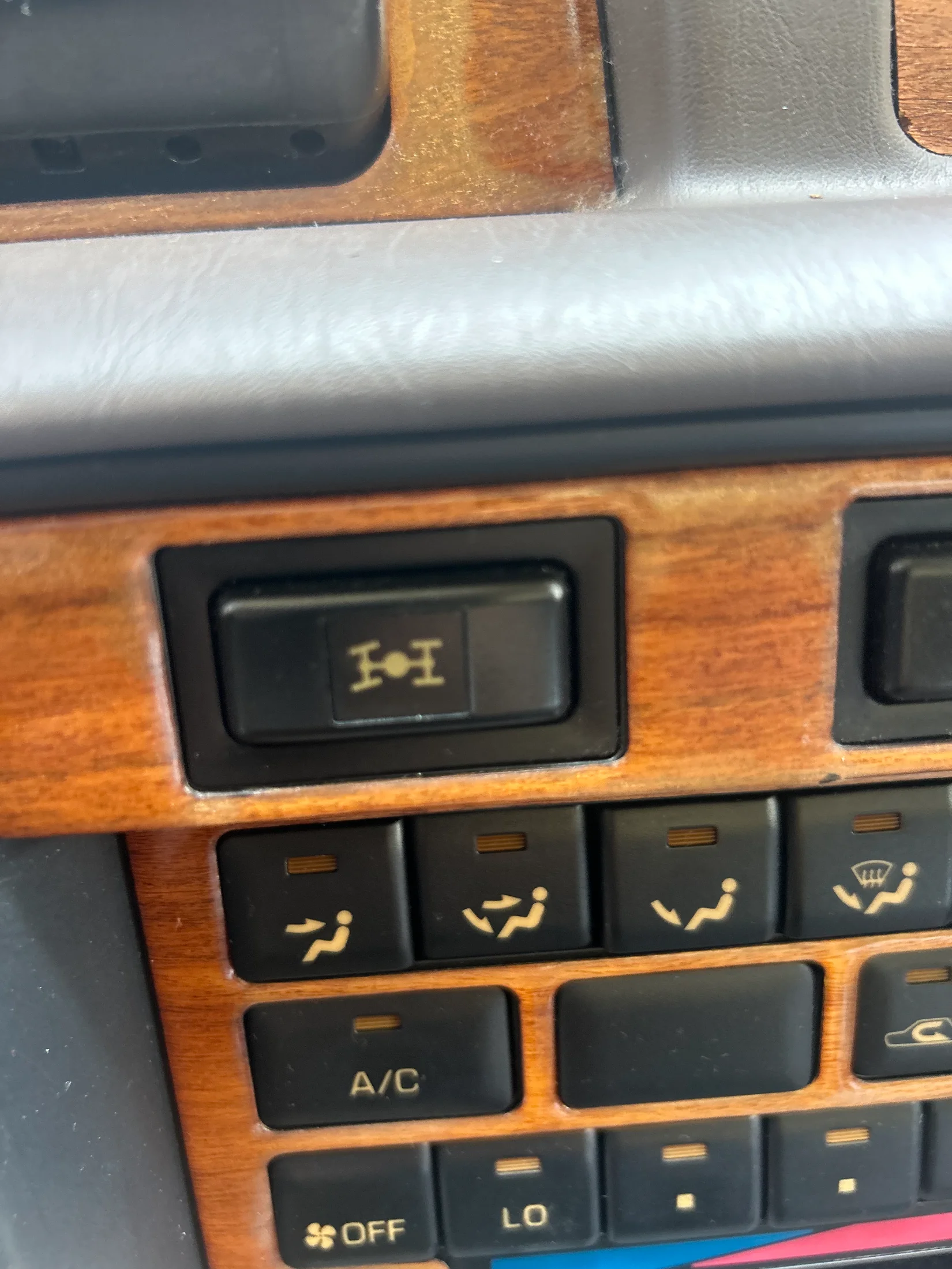

I purchased a Triple Locked 1997 FZJ80 in Desert Dune with Moonglow Pearl accents. I don't plan to make many modifications; I'll mainly tidy up a few small details and, most importantly, enjoy it. It has been well maintained and recently had a front-end rebuild, along with the replacement of the pesky heater hose. Here is a short list of a few items on my to-do list.

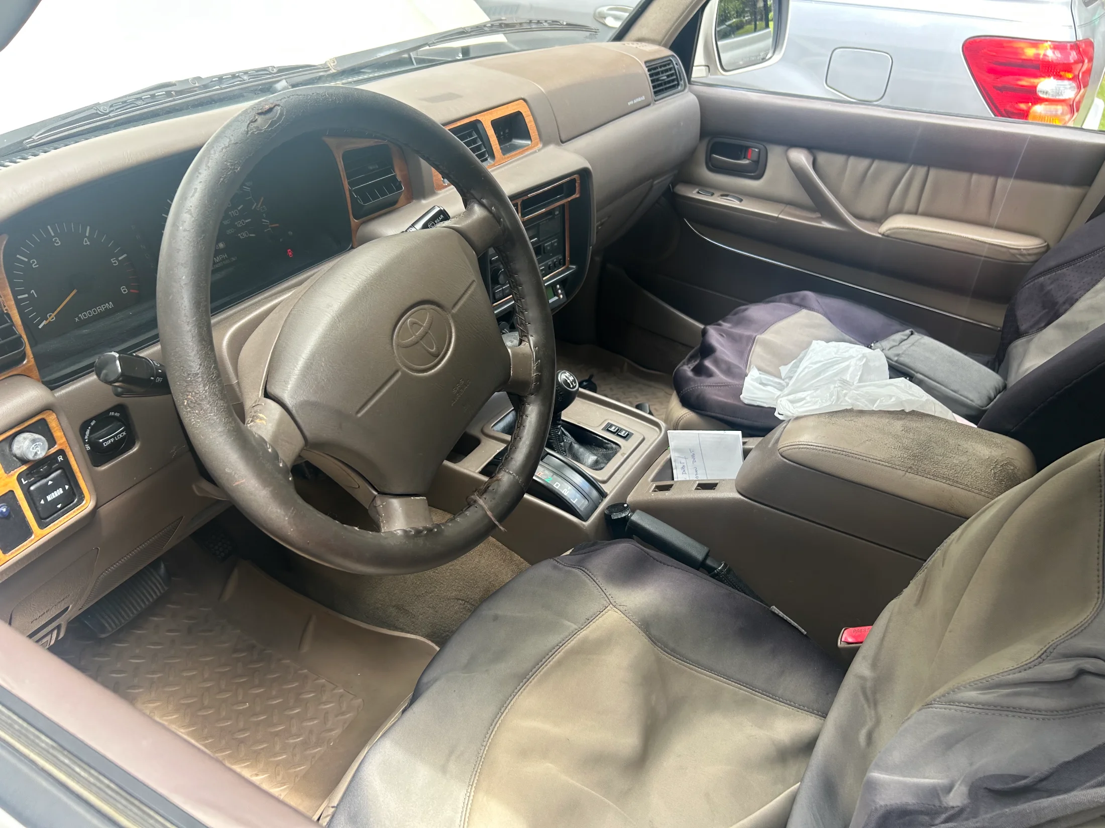

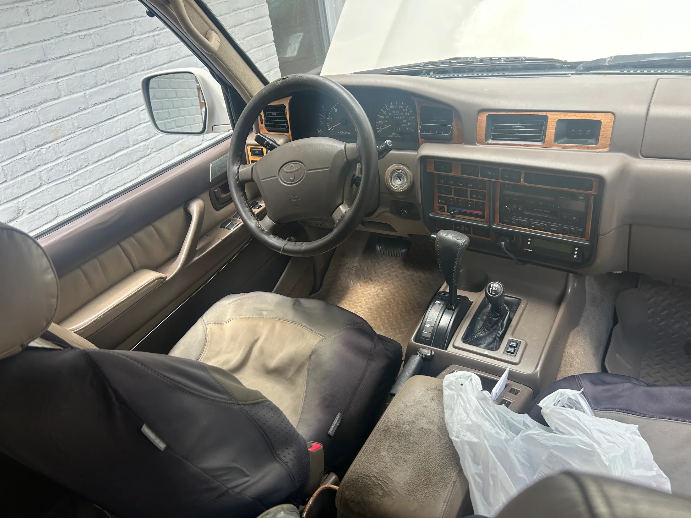

- Replace front seat covers
- Fix seat motors/switches so I can adjust the seats.

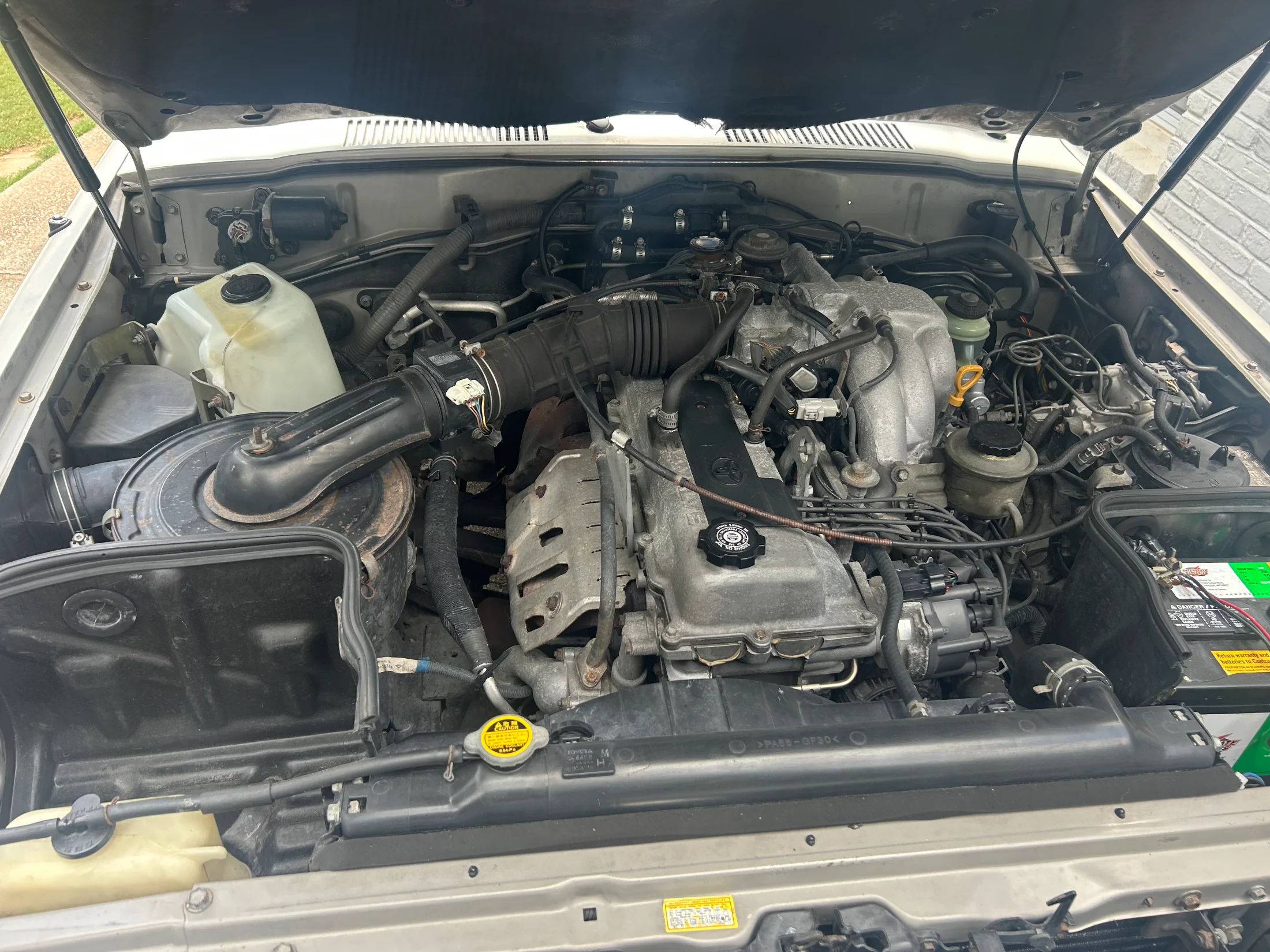

- Replace all the vacuum hoses under the hood
- Fix small rust spot on the rear upper hatch

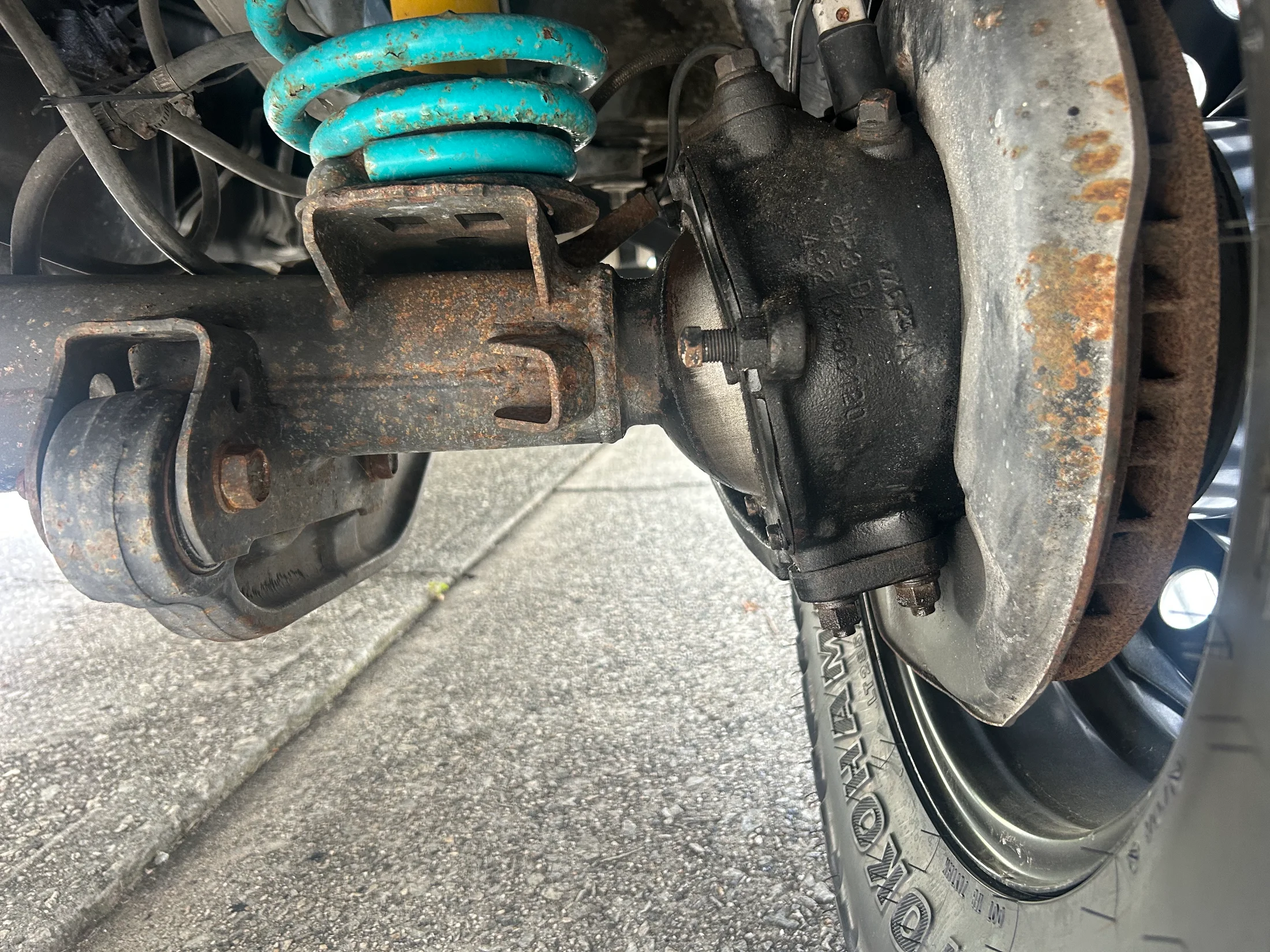

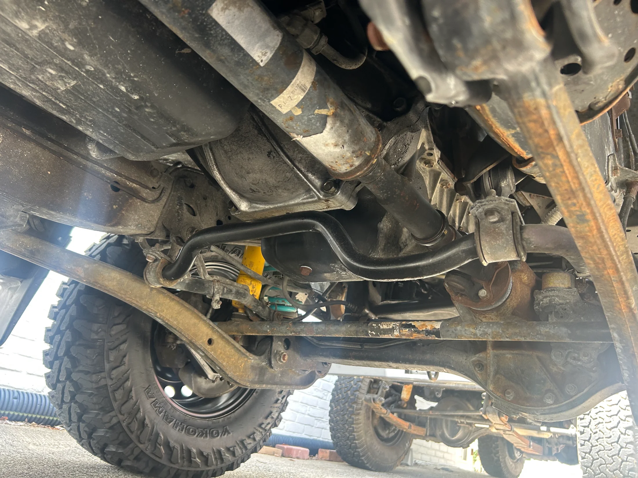

- Clean up some surface rust and seal up on the underside
- Wet-sand the hood and roof and spray on new clear coat
- Repaint the wheel flares and clear coat
- Ceramic seal all the paint
- Clean up some wiring
- Fix the front spot lights
* ENJOY THE HEAK OUT OF IT!!!

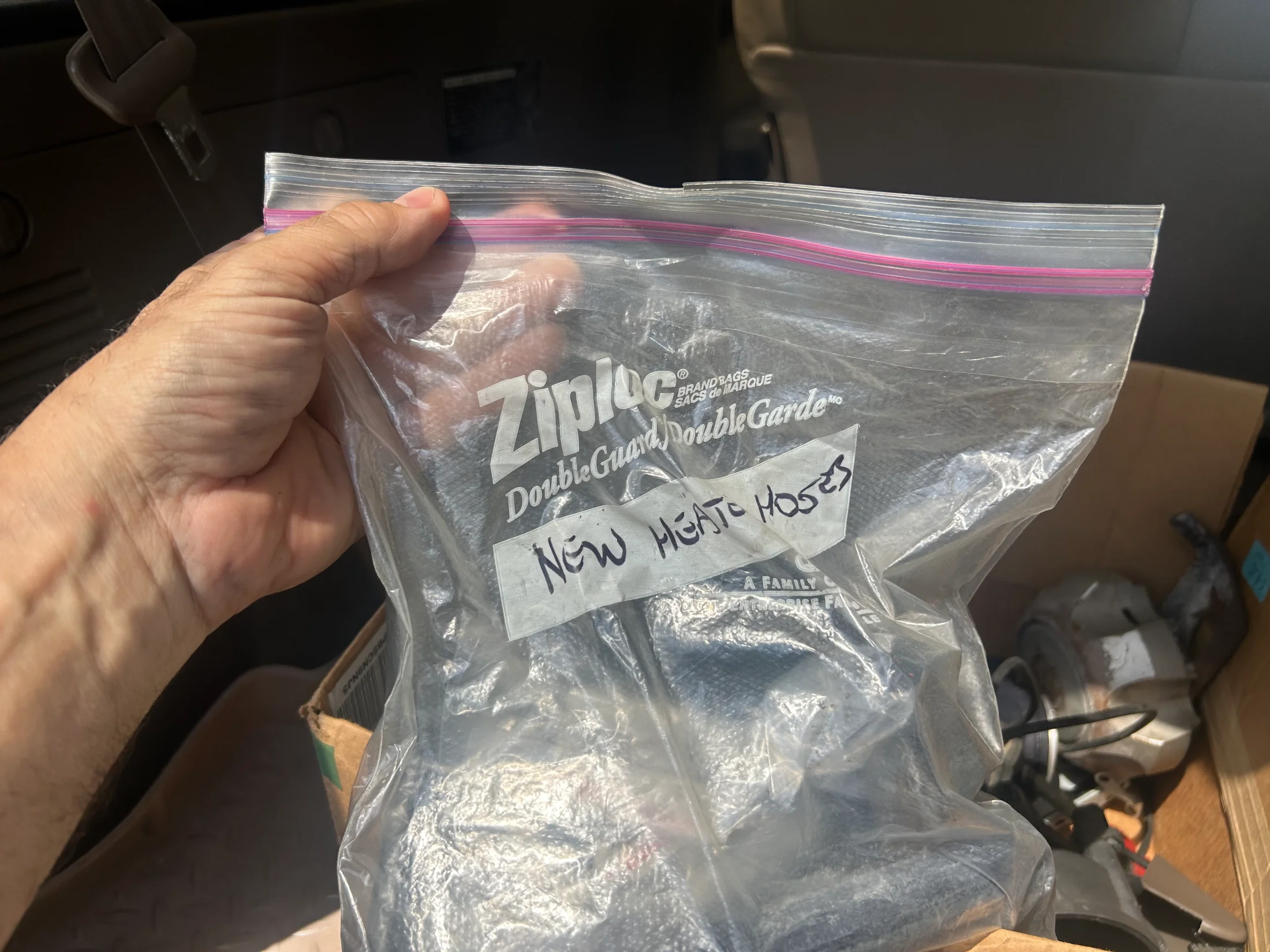

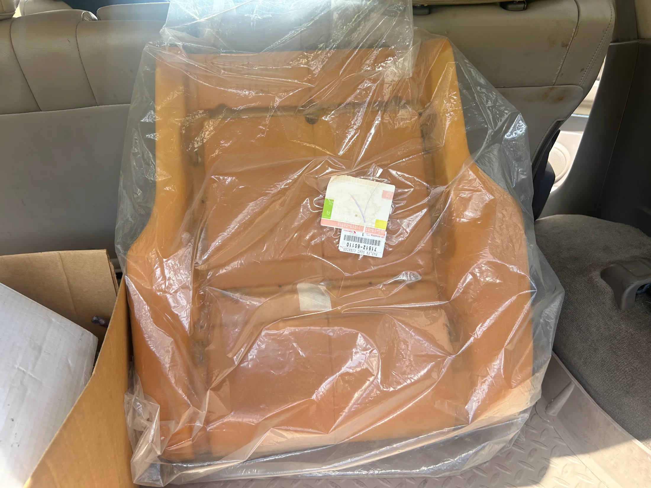

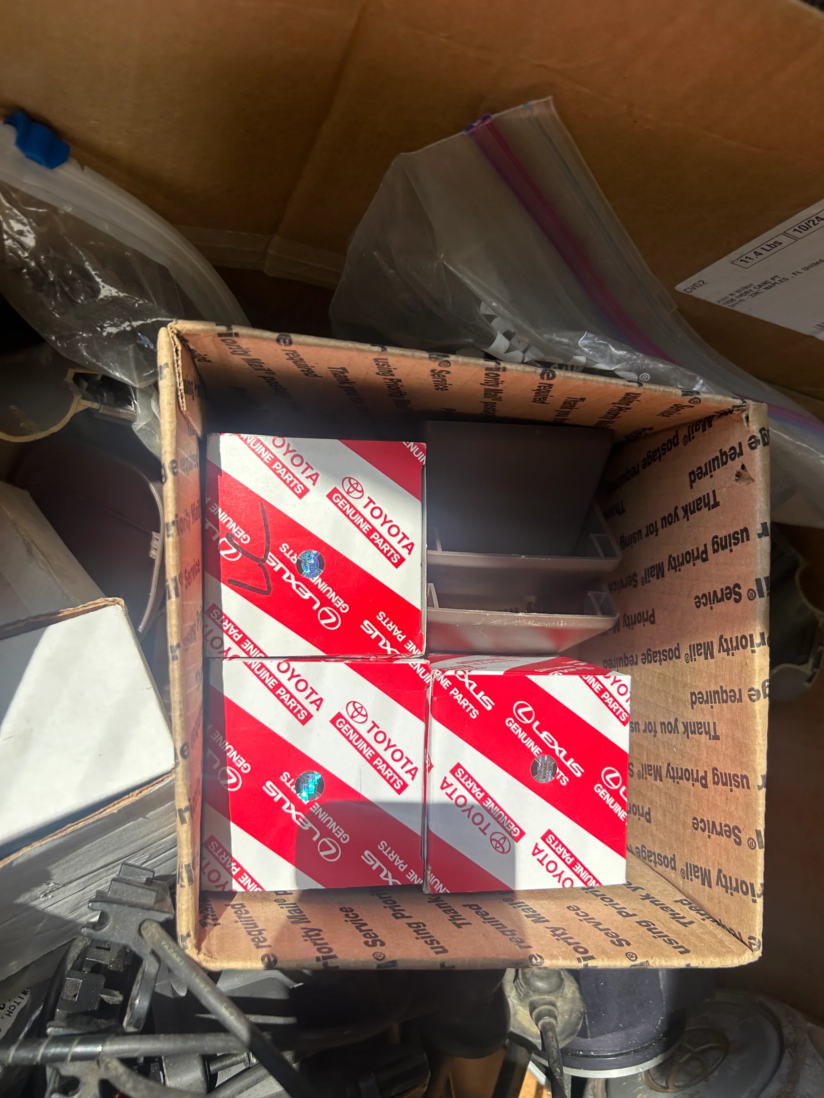

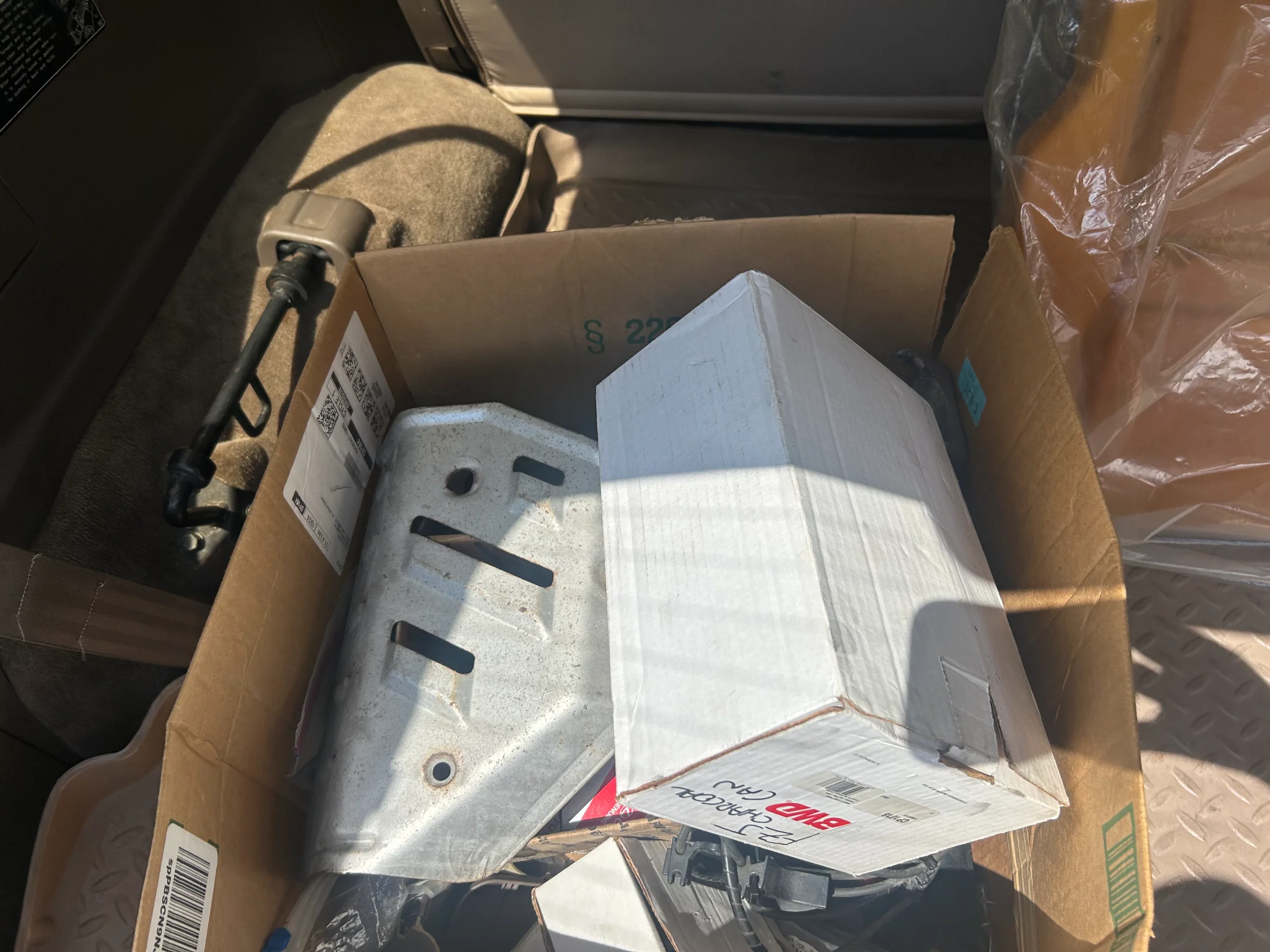

It came with a box full of OEM parts and a Factory Service Manual. The previous owner was a Toyota guy for sure...

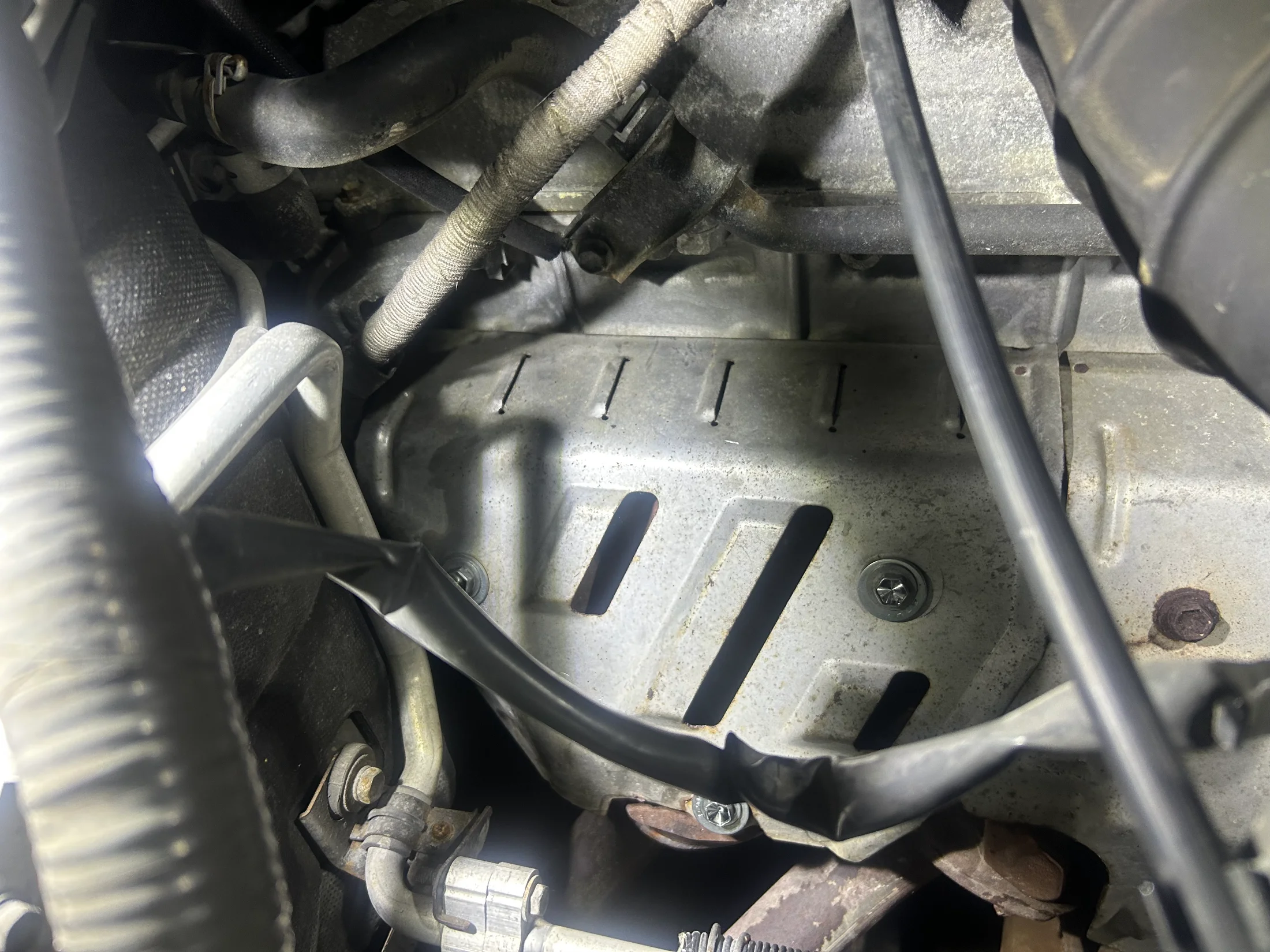

First project completed!

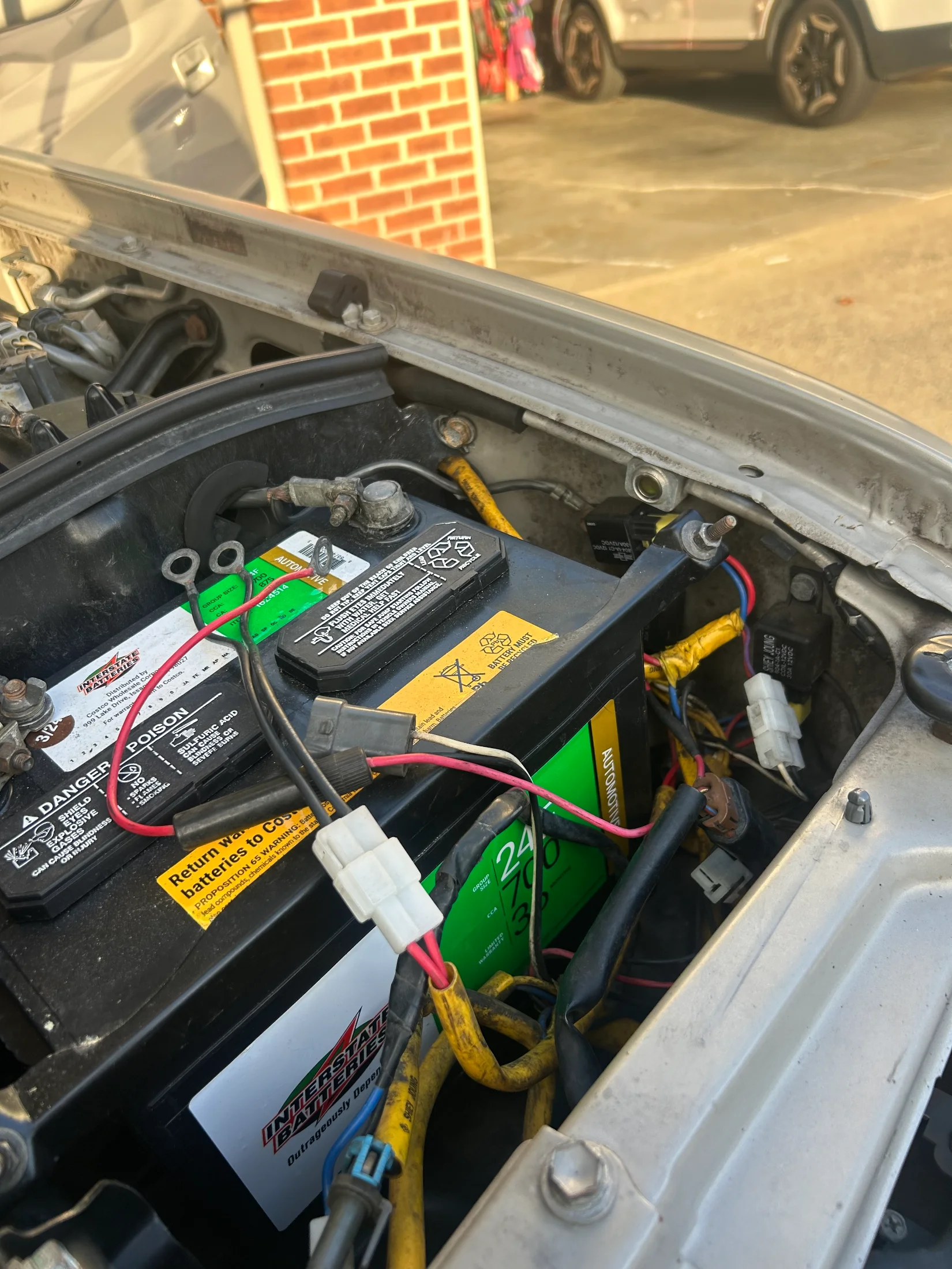

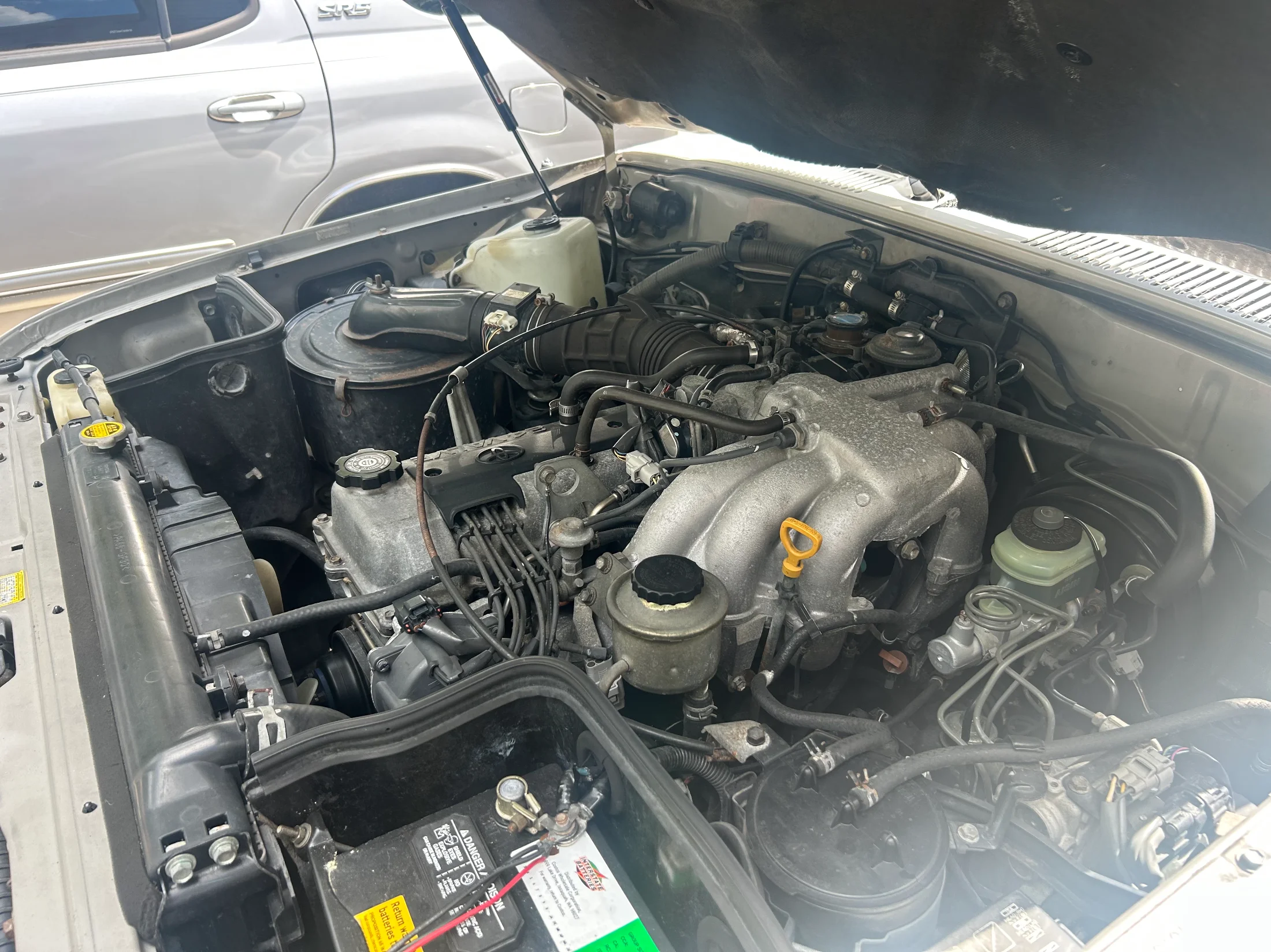

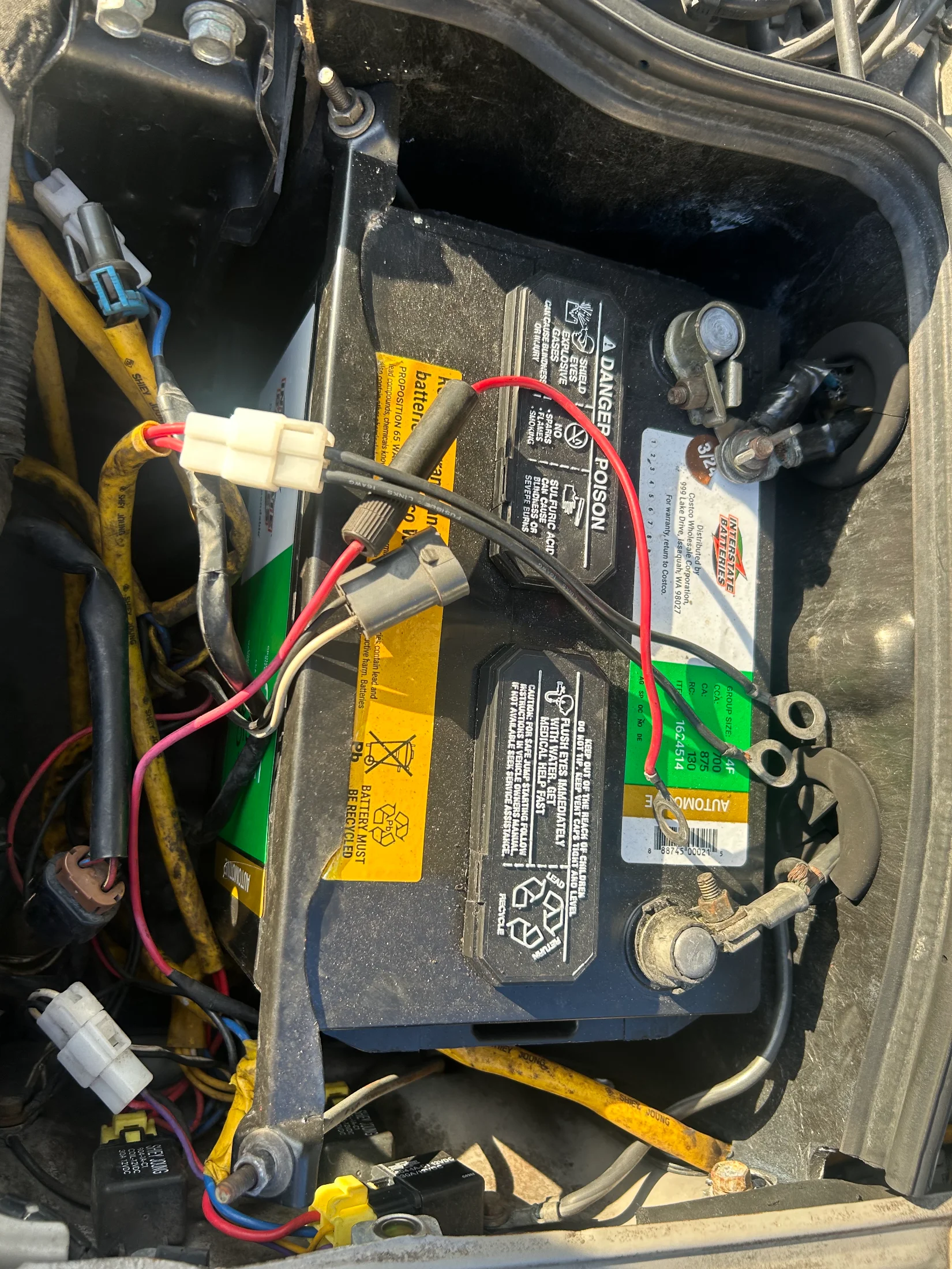

I am not sure why, but the rear exhaust manifold heat shield was in the box of parts in the back, so I reinstalled it. I also spent a little time sorting through the mess of wires on the front. It has some lights, and at one point, it had a winch and a second battery. Still more work to do here...

Love the look of those steel wheels. Wanna trade? 😁 The PO of your 80 set you up well, complete with OEM oil filters and hoses. Nice find,

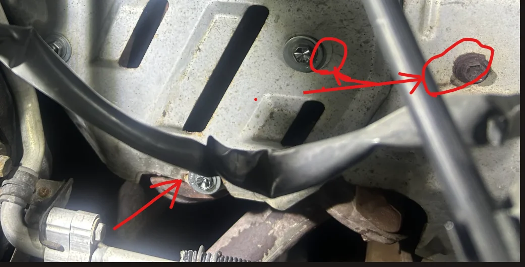

The arrows and circles point to cracks in the heat shield. Mine were so bad the area around the flanged bolt head broke away. I welded washers to the face of the heat shield around the holes. Need to be very gentle as the steel is thin.
Then covered them with Aluminium refelective hight temp paint. Been holding up for a couple years now.
Thanks for the advice. Yeah, I noticed the cracks, and that is why I added the larger washers. I will also need to do some work here. I will add this to the list.

I did the same trick with welding on some washers. In my defense, it was my early days of learning how to weld but it looked like a bird had been trapped under the hood s***ing out welds. I ended up buying new shields and hardware 🙄

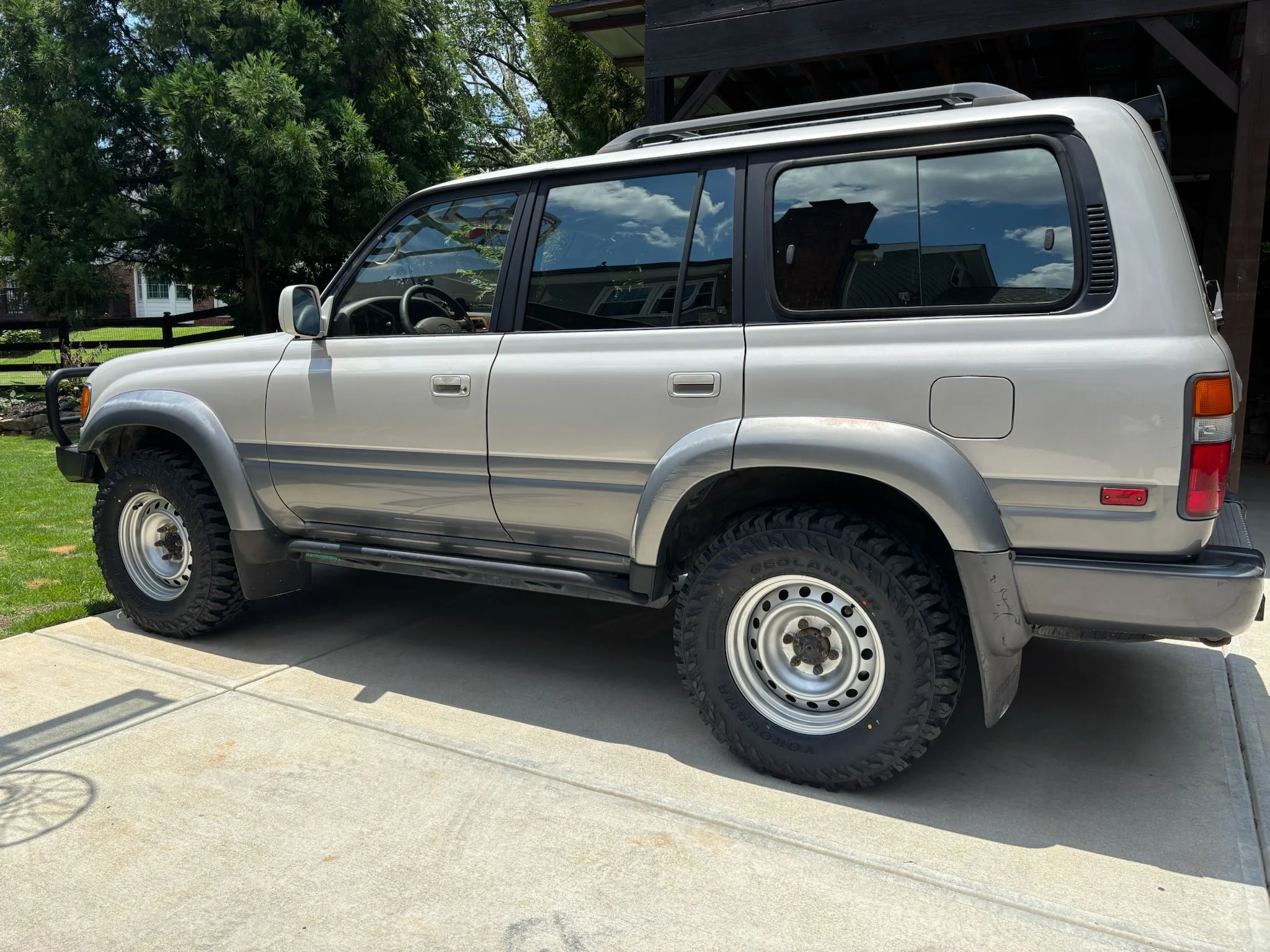

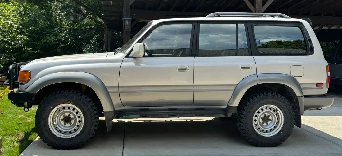

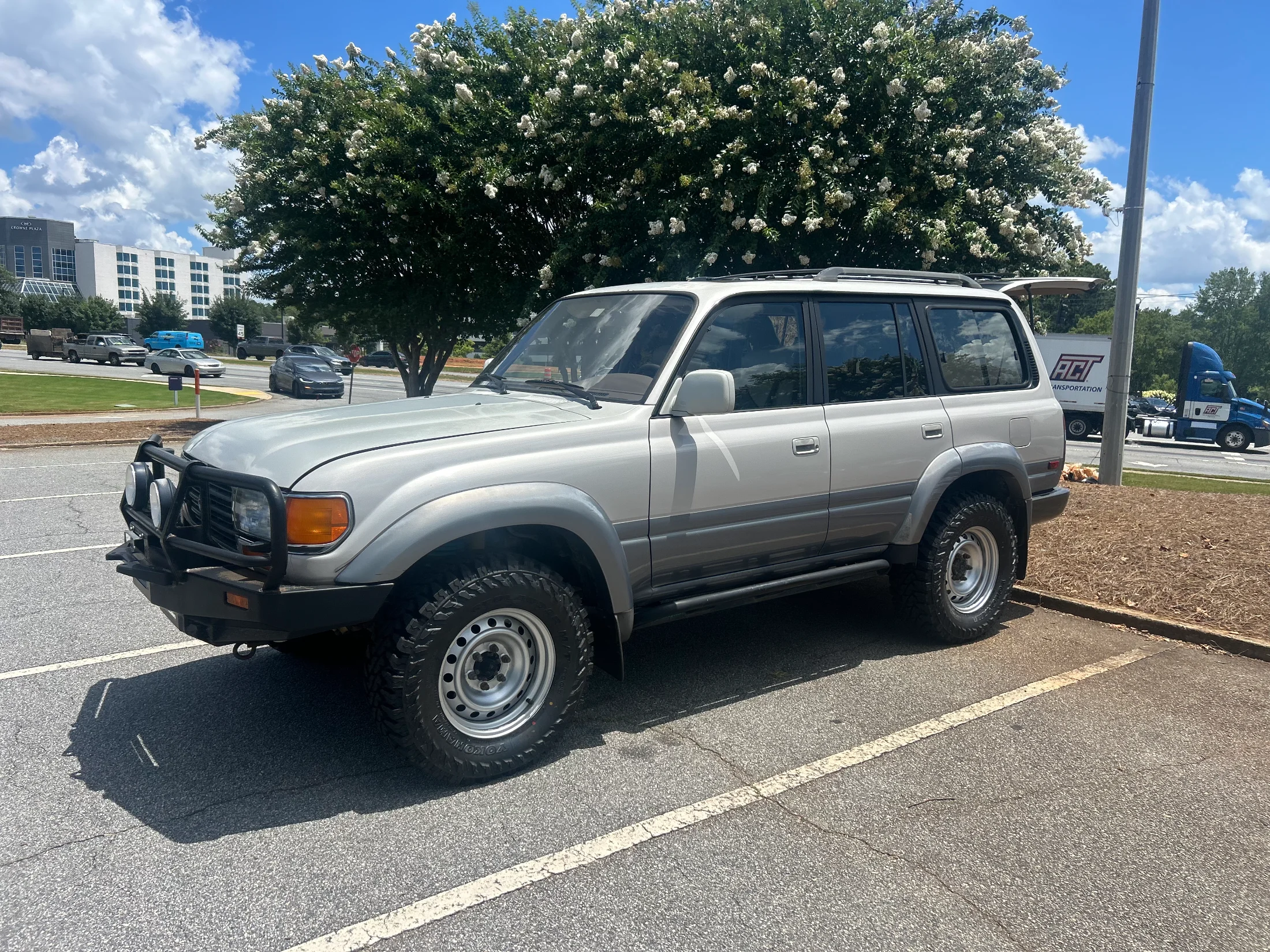

I really need to stop looking back at your pictures... those wheels are making me think I need an upgrade!
Anybody know where these come from, wheel / tire sizing, and cost?
It doesn't help that my LC is the same paint combination.
These look like either 17" FJ or 16" 4runner spare steel wheels. I'm wondering if they require spacers.
I just painted a set of 17" FJ steel wheels last night. I went with black, but am thinking silver would have been even better.
Yes, they are 17" FJ wheels, and yes, they have a spacer on the front (two-inch, I think). I am not a big fan of spacers, but these are the wheels that came with the 80 when I bought it. I might eventually paint the original wheels Moonglow Pearl and put them back on. I like the way the original ones look.
