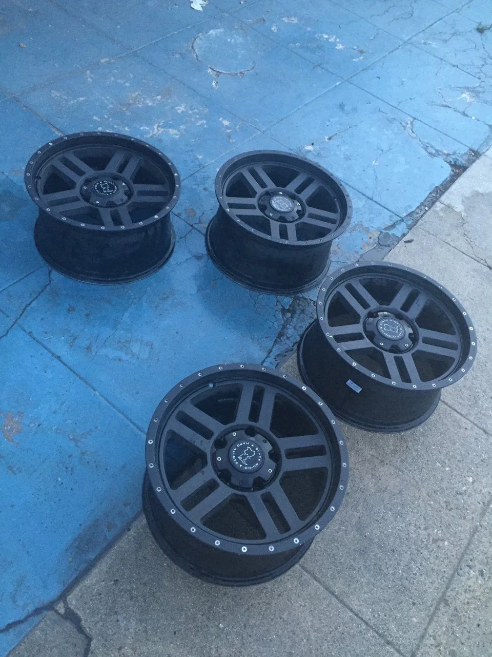

I think I am going to powder coat gloss black my factory 18's. These will be for sale for $500 if your interested. Thu are rhino Black wheels

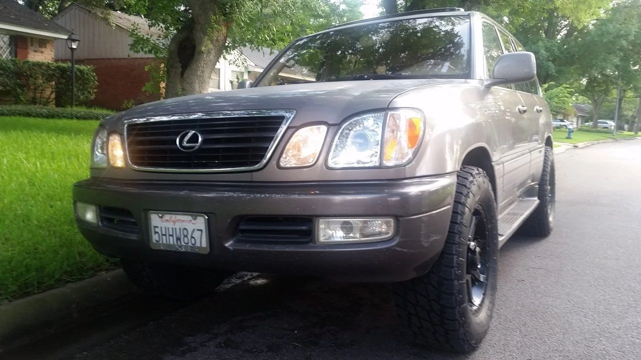

These are 8 spokes but around $700 will get a set to your door! They also have a better offset than the FN BFD's in my opinion. The new 100 series FN wheel is made specifically for our rides though and should be the best option. Most people feel that with the added sidewall that a 17" will allow you, that they would be best. As of now though there just aren't a lot of good 17" options out there in 5x150 and the right offset. My buddy has the BFD's in bronze and they do look frickin' great. His offset is +12 and that gives a really aggressive look. The offset above is a +35 and the 305/65R18's sit almost perfectly flush. They do stick out maybe half an inch or so. Just a little more understated than the BFD. If you are interested, they are Ultra Crusher 195's in satin black. Tire rack has them or I know a guy at SD Wheel that can probably save you a few bucks. PM me for his info if you want it.

These are great and actually have a good offset - it's the +12 on the BFD's that gets you into trouble.
I think the +35 and the 305's look perfect.

Thanks boz! I had done the math and was confident in the choice but even still, I was pleasantly surprised at how well the fit! :)
