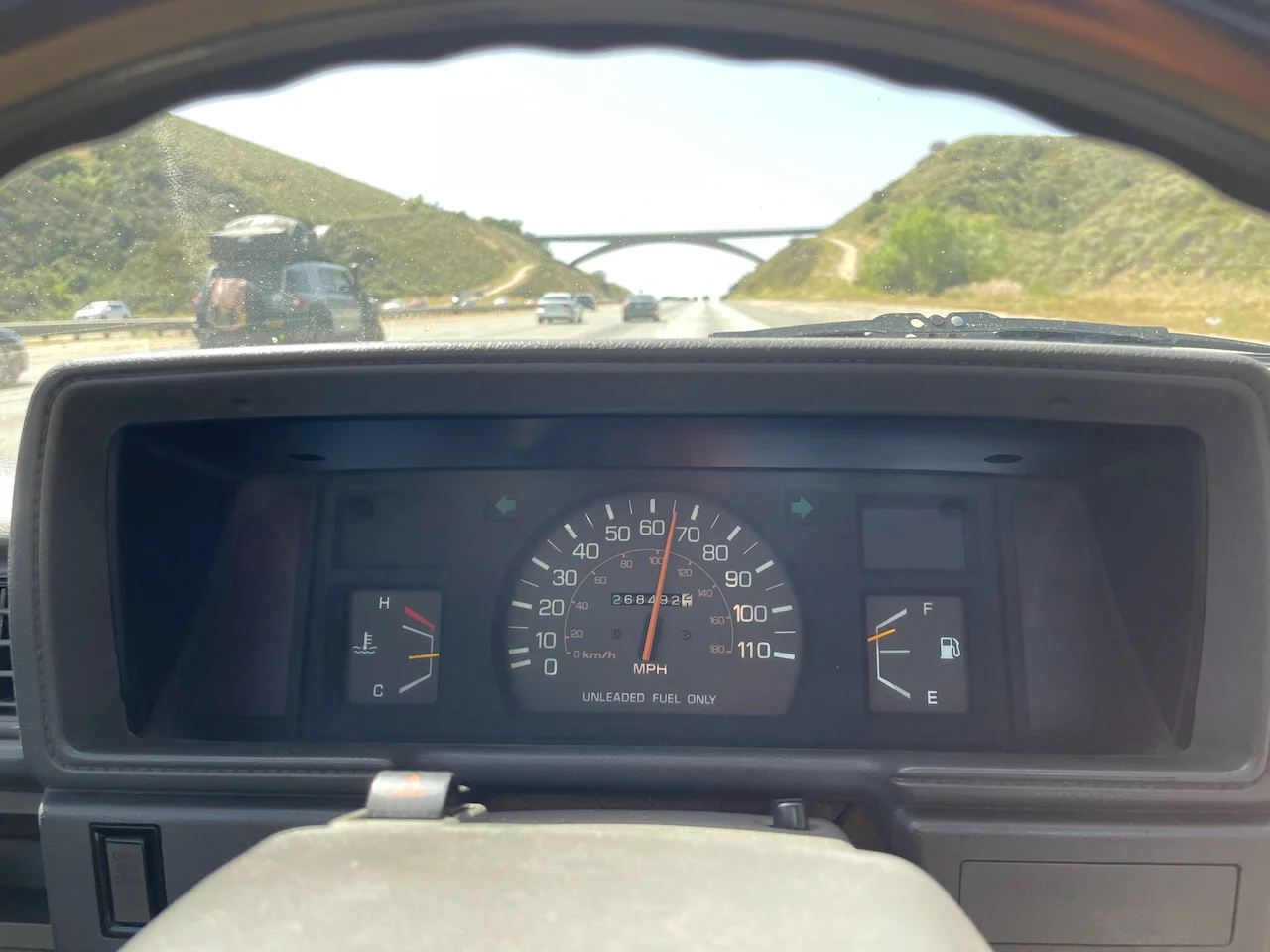

Hi All,
I have a 1987 Pickup 4x4 with a 22R (California Emissions). Recently replaced the thermostat (non dual stage), all coolant hoses, radiator + cap, temp sender and water pump. Noticed that the temperature will spike a touch higher than the middle of the gauge ("highest") for a minute or two, then go back to the middle. Sometimes, it'll go down even further a little higher than 1/4, "lowest". But it never has gone past the highest point, yet at least... :meh:. Before all the parts were replaced, the temp gauge always sat at the lowest mark IIRC after warming up.
It occurs most when driving on the freeway here in San Diego. Ambient temperature has been around 70 degrees +/-. This morning, it went to the highest point while in a drive-thru but dipped back down to middle, then to the lowest reading. Short drives around town, the gauge will be at or between the lowest point and mid point. I did "burp" the cooling system after replacing all the parts previously listed by parking the truck on a hill and running it with the cap off for a good amount of time. I'm inclined to burp it again but with the cap on and a hose as shown here
The temp readings are the same whether or not the heater control valve is set to cold or hot, which leads me to believe a dual stage thermostat will not fix this.
Also, I only get nice hot air when the RPMs are high. At idle, the heat air is luke warm at best. Which then leads me to believe I need to do more burping. Any ideas/suggestions? Dual stage stat? External temp gauge? Thanks for reading!

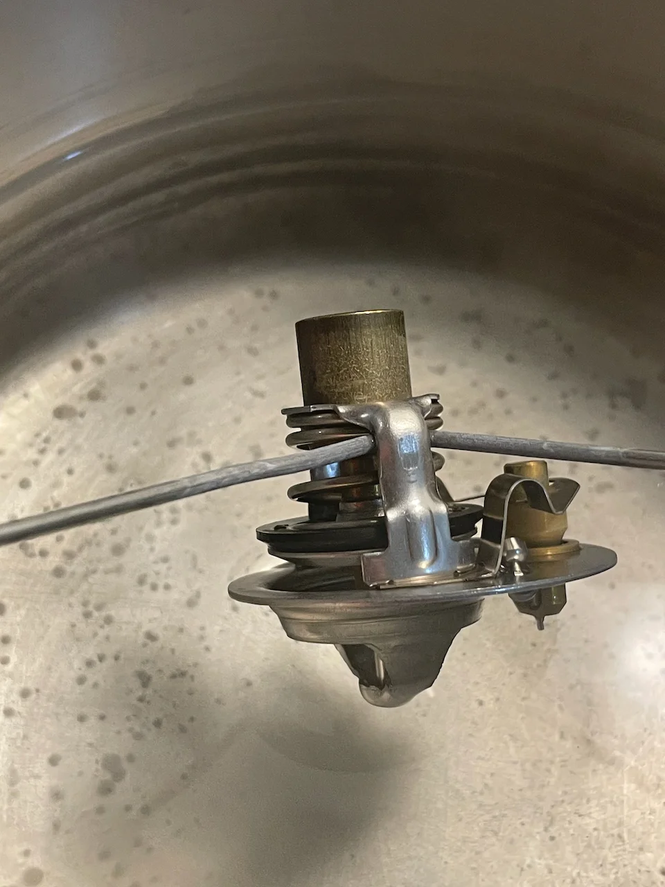

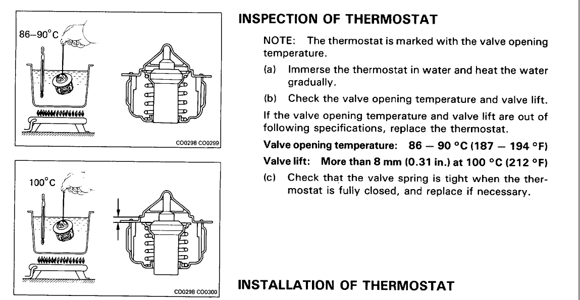

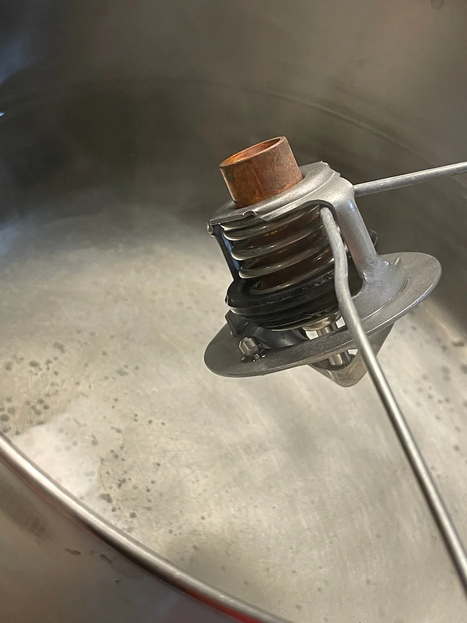

Got the pipe in, spliced in a new alternator pigtail and cleaned up the wiring. Tested standard OEM Thermostat versus OEM Dual Stage Thermostat, both have been installed on this truck.
Hard to tell from pictures, but to me, the standard thermostat appears that it would allow more volume flow versus the dual stage when fully open. Either way both thermostats pass inspection per FSM.

Dual Stage @ 212F
Standard @ 212F

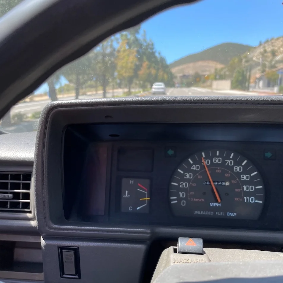

Took her up the test hill but could not get the temp any higher than what's in the photo. 3rd gear, AC on and off, HVAC on cool and high, no difference in temp overall. Ambient temp is around 70F today. My earlier test was on a 90F day. Monday will be warmer so perhaps I'll try to do a longer drive to Temecula up I-15.

That dash gauge look OK to me. Here is a page from my owner's manual.
Thanks @pappy. The more internet reading I've done on 22R/E motors, it seems like a good majority of them have quite a "sensitive" dash gauge which I need to get used to. I've been more in the camp of: If it moves higher than where it normally sits, there is something wrong.
Well that's good news. Hopefully good to go. I'm sure you'll be watching it like a hawk though.
For sure. I won't stop obsessing over this until I get to drive it over a desert pass later in May. Fingers crossed..
Just did an extended drive up a few good sized hills on I-15 between San Diego and Temecula. Approx 80F +/- ambient temp. Temp needle never even hit the middle of the gauge. Very happy so far. Green lighting our plans to drive from San Diego through AZ and NM next month!
