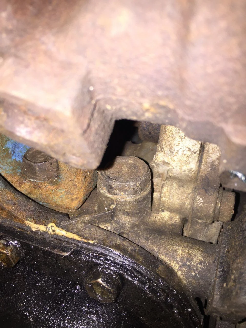

Is this a pic of my oil pressure relief valve?
Mar 20, 2015
26
81
I think that is the 'oil cooling reliefe valve' and this is the 'pressure relief valve'.
That is under the front of the engine (driver side), bash plate doesn't need to be taken off but will help for more room to move your hands around the oil grease soot s*** dirt sand and dry flakey mud that's falls nicely right into your eyes.
BUMP. I'd also like to know as my part is on the way and want my oil pressure a little lower for a trip that is quickly approaching. Thanks in advance duders.
I am also doing my pressure relief valve after finding that my oil pressure goes well above 100psi. I just installed a mechanical gauge last night. The idle hot sits at about 60. To confirm, THAT is the location of the valve, yes.
Thanks for the reply, I've got limited time to install this so the less confusion for me the better. I'm easily confused.
Just to clarify. I meant the one below the power steering pump. that's the one that need replacing. I will do mine and post pics as soon as I have it take care of.
