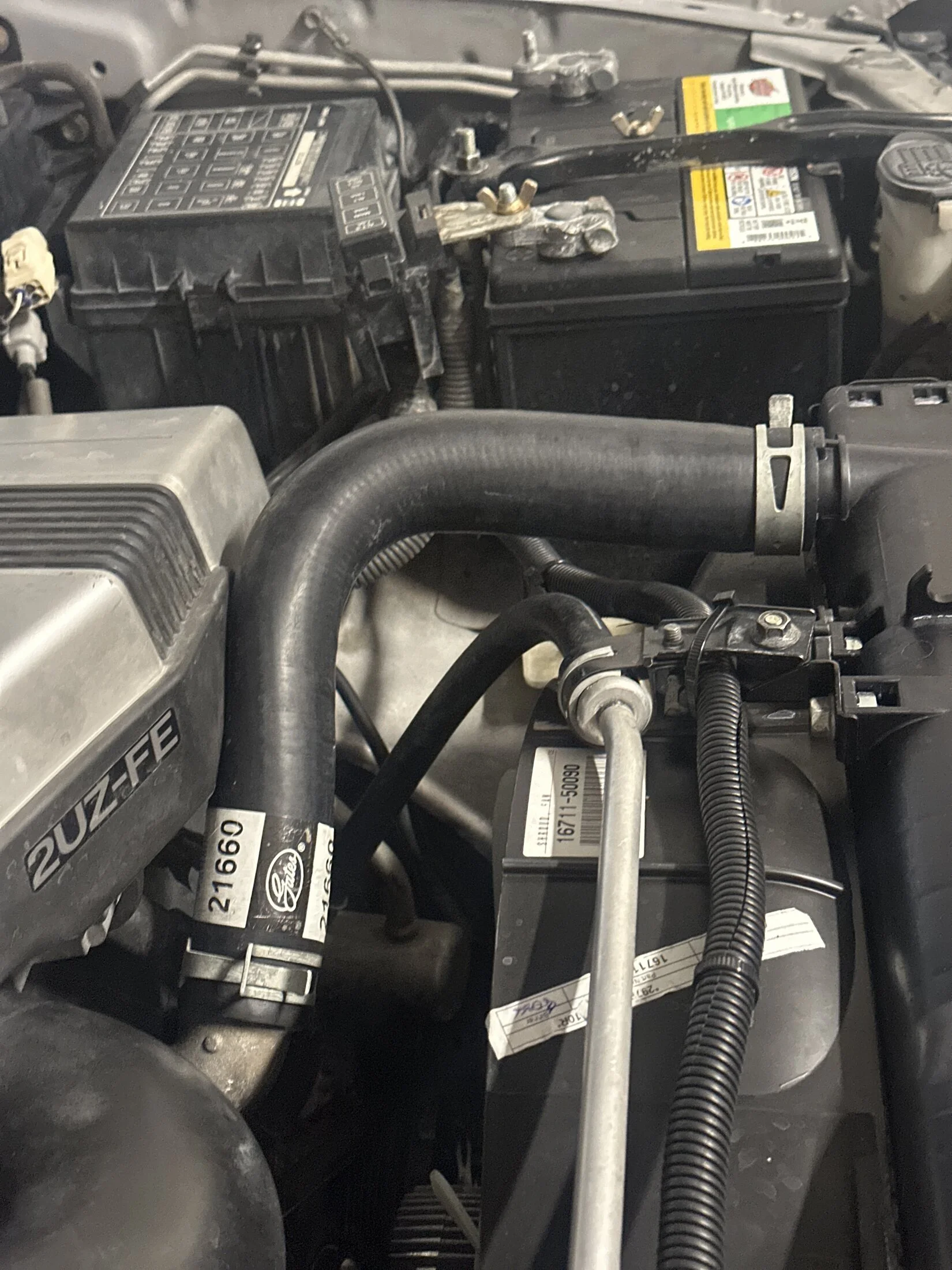

Is the upper radiator hose a cut to fit ? Gates brand

I would remove it and cut it without hesitation. A number of non-OEM hoses (like Gates) for older 4Runners say 'cut to fit' - so it's expected.
yes i measured it is symmetrical. I'll give it a snip. thanks guys!
My experience is that Gates is cut to fit and OE is perfect without cutting. So I threw away the Gates and got OE.
