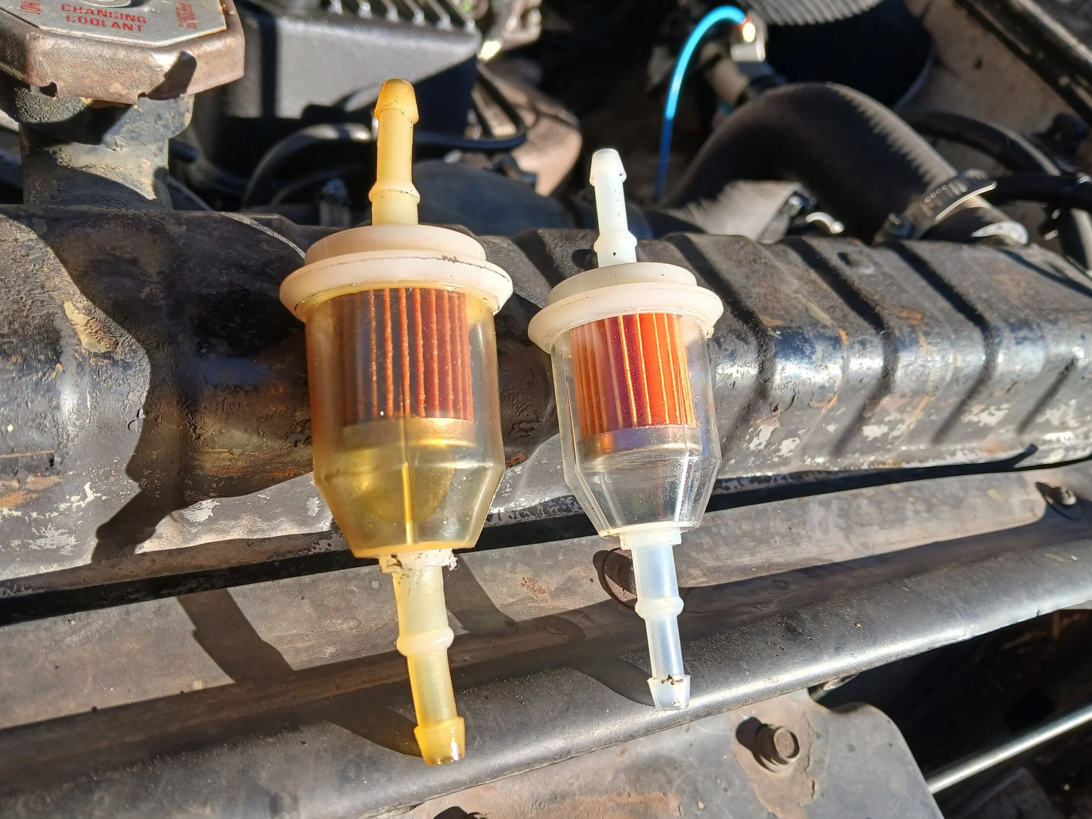

My 2f started runny rough with a little load, like above 2k rpm (no tach, guessing). I figured either needs a tune up or fuel problem so I'd start with fuel. I have a new tank that I've run almost a full tank through, newish lines and pump so I thought id change the fuel filter first. Can I use a generic, see through filter or is the the 2F fussy about what filter to use? I did a quick search and lots of varying opinions.
I like clear fuel filter so you can see what's going on. I now run a gascolator from a Cub. Where you buy gas is important - go somewhere else if they are filling the underground tanks. Spring and fall add some gas drier to your tank every so often - warm days and cold nights will condense water in your tank as it breathes.
Yes, I always keep a couple in the Pig

That said, your symptoms could be fuel delivery. Try driving with the gas cap off to check for vapor lock. Also, with a clear fuel filter, you might see a little bubbling from an upstream leak in your lines.
