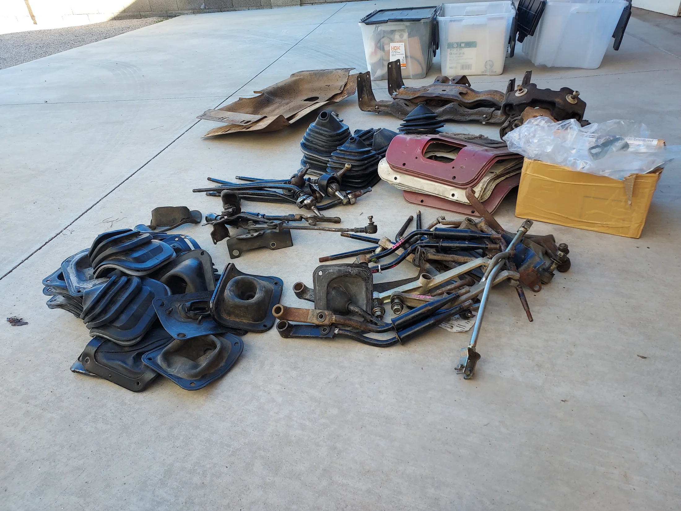

I'm aware of the crossmember and other items needed. Twenty five years ago got heavy into the early Land Cruisers. 2013 for reasons for not worth going into I moved on. Last ten years I started collecting 8/80 plus items most which are from Australia. Still have pallets there needed to figure how to get them shipped. For the crossmember 10/82 the design changed because of the longer H55F which the front driveshaft was now lower at the crossmember. It's groove got deeper. Interesting a member pointed out to me that the 8/80+ FJ45 and HJ47 did have a hand brake on the rear axle in a general market incomplete built vehicle. But it still only had a four speed like other long wheel base which was because of the torque tube behind the transfer case. The five speed also changed the PTO, shift lever moved to the front side to clear the torque tube with a five speed installed. 8/80+ four speed skid plate you can just cut the front section off earlier ones where the crossmember is. All the mounting bolt holes line up. Five speed is a different story. Those and the transfer case shift levers are harder to find than the 40 series H55F top cover.
