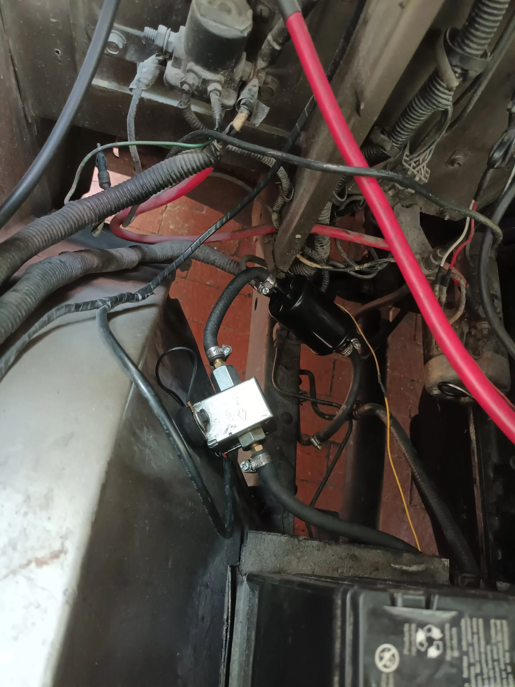

I have the same electric FP on mine … mounted below battery area … filter between FP and carb
Do not put the filter near carb or above manifold … if you use the plastic filter and it leaks or cracks it is bad :meh:

When I got my rig. It had an AFI system on it. They placed the full pump right behind the gas tank on the frame rail - which seems like an ideal location.
I pull that system out and have a factory carb and fuel pump - and couldn’t be happier.
In 30 years I’ve only replaced it once
Those lil box pumps work great … just mount it as low as you can get it
Don’t use the metal fuel filter that comes with it
I use a vw plastic clear filter

Where did you mount yours?

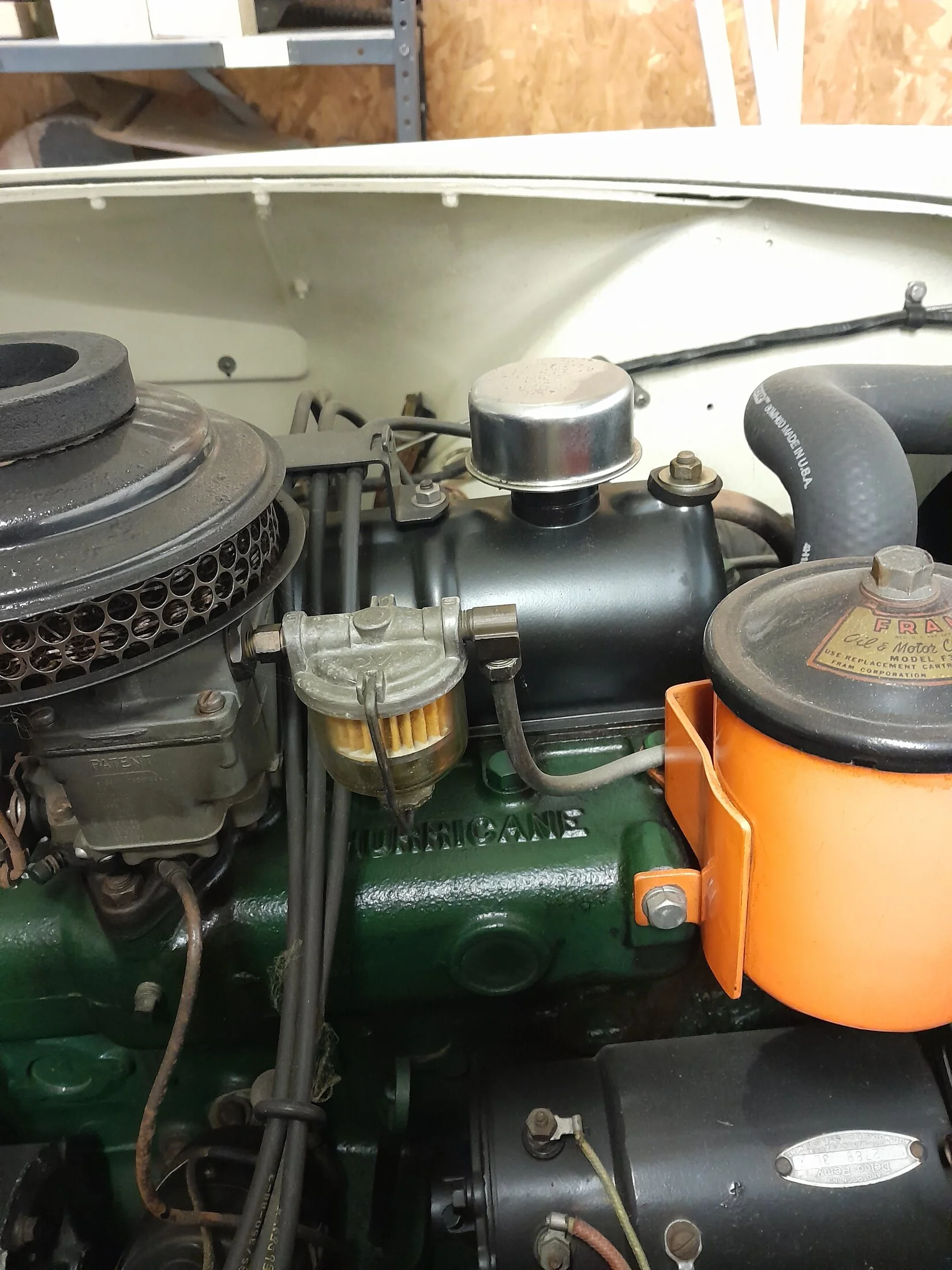

The worst sound is the "whoosh" from the explosive gas fumes fire from a carelessly and incorrectly installed glass bowl of the fuel filter. Ask me how I know. Look closely to see the paint bubbled up on my air cleaner. This could have been catastrophic for vehicle and garage/home. I got lucky.
Filter bolts right onto the carb?
