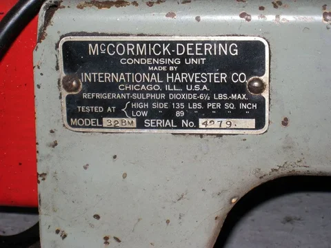

My compressor is a circa 1940s McCormick Deering International Harvester which is blowing the crankcase oil into the compressed air stream. I havn't torn it down yet.
Are old compressors like this worth repairing?? I can't find anything online about it, so I have no idea if repair is even possible or if parts are available.

I have attached a few photos. The tank is remote mount and originally it was as refrigerant compressor but has been used for air since my dad was a kid in the late 30s-40s.

that is refrigerant compressor. it is built with rudementary attention spend on oil control.
most unit dont even have an oil control ring.
Truly a poor choice for compressed air.
