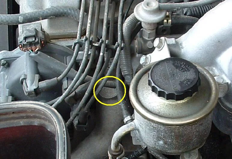

Where are you guys putting the sensor or sending unit for a second gauge? On my 80, there was a boss in the casting of the water outlet, and I machined the hole there for the second gauge.
attachment.php
Is there any good spot to add or are you abandoning the stock gauge and using that sender location?
