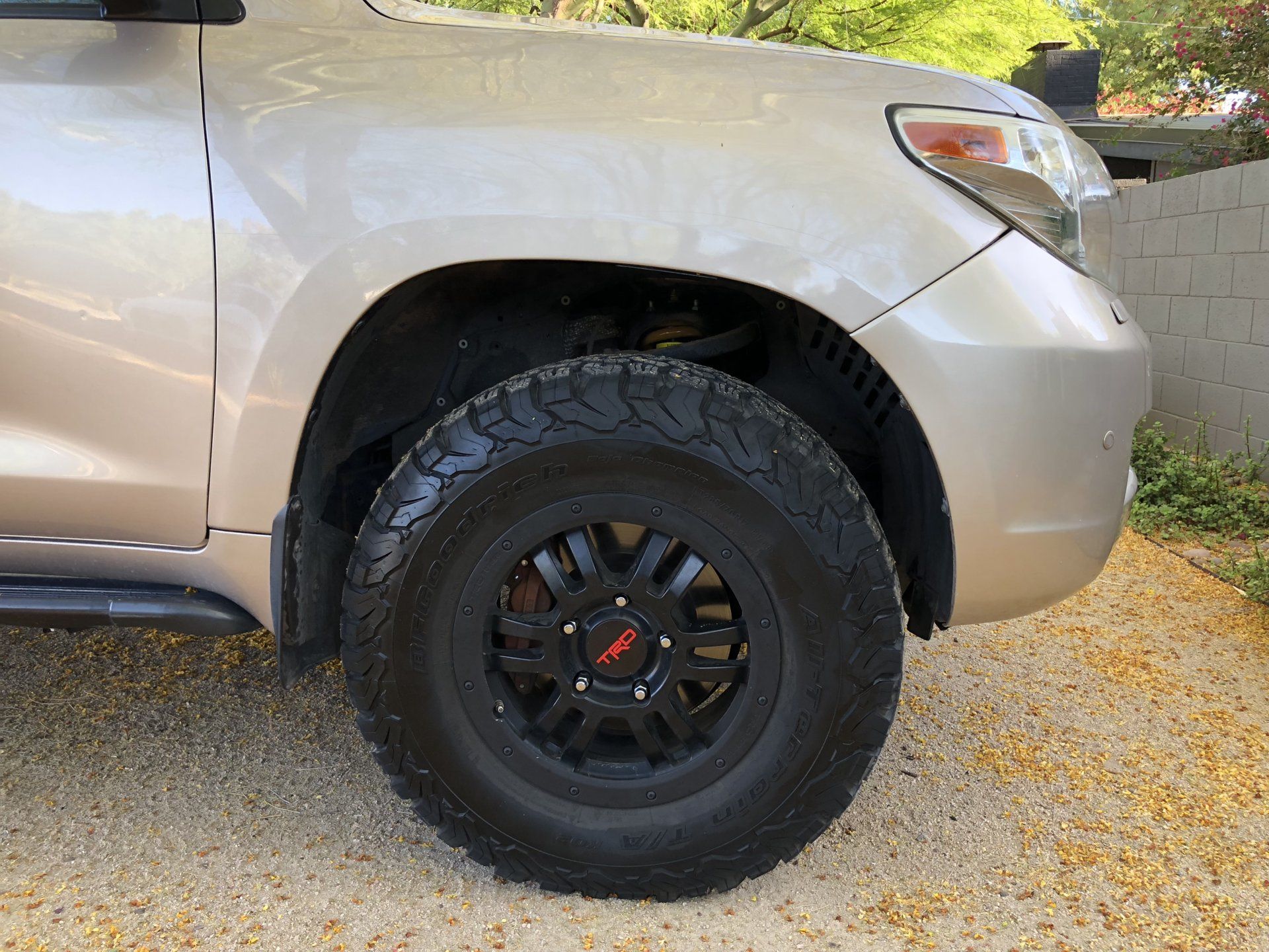

Are those Tundra TRD wheels? Very sharp!
No they are the 17” TRD Rock warrior wheels, just powder coated black. When I was trying to find a set of used rock warriors for a looooong time I considered doing the Tundra 18’s as they were much easier to find.
Those look fantastic powder coated! Those sweet TRD caps threw me off.
Yeah I got them used of Craiglist in Phoenix a coupe years ago and they actually came already painted so I dig they are a little different. The caps are just stickers but they look well done. They had silver bead lock rings but i plasti dipped those black.

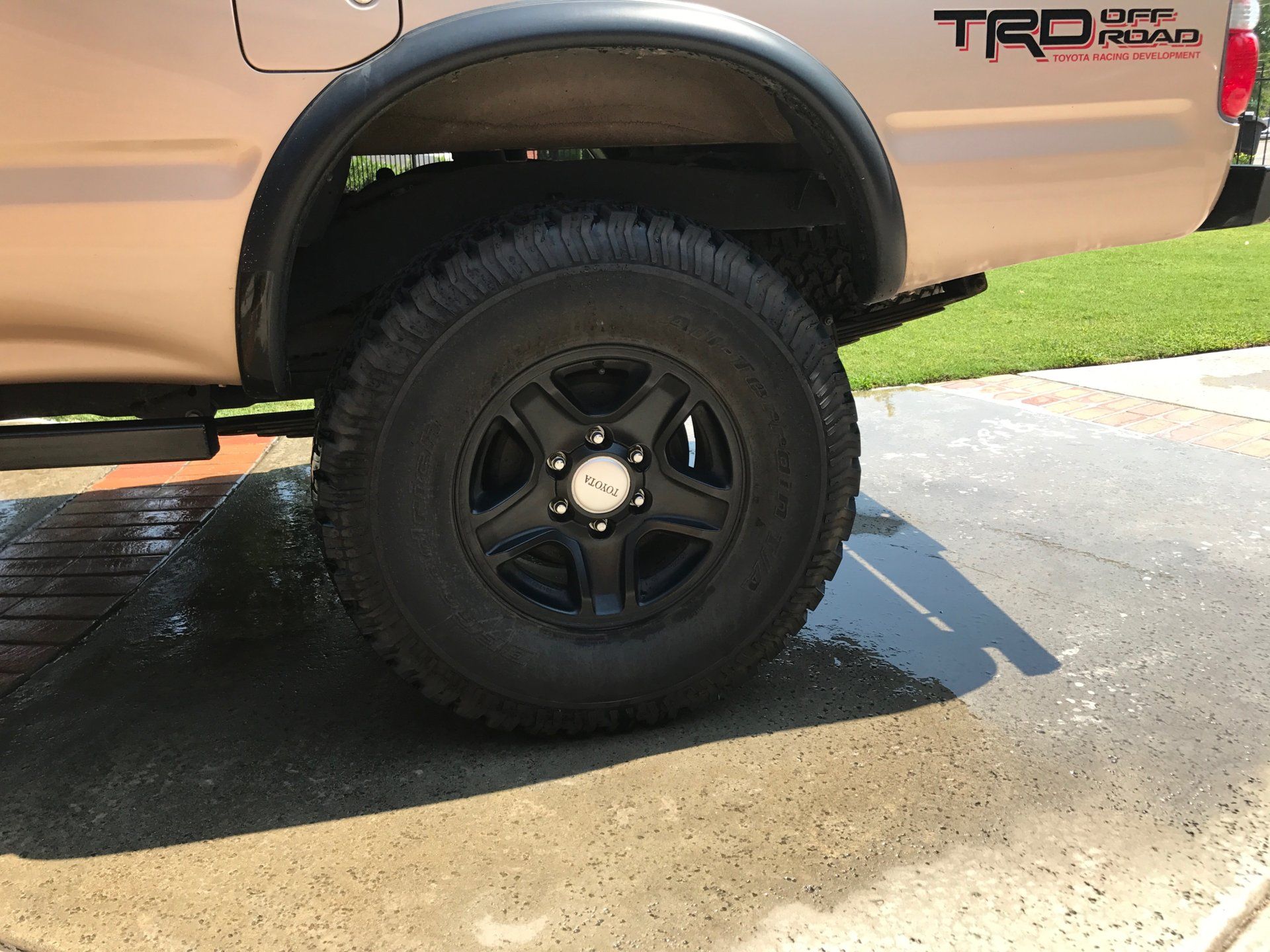

I just now ordered a set of 4 on eBay for a grand. I plan to have them powder coated like yours and like I did on a set of 4Runner wheels I put on my Tacoma. Where did you score those stickers, I like the look or I could leave them original like on this photo.
I just now ordered a set of 4 on eBay for a grand. I plan to have them powder coated like yours and like I did on a set of 4Runner wheels I put on my Tacoma. Where did you score those stickers, I like the look or I could leave them original like on this photo.View attachment 1693324
Looking good. Yeah I dunno the stickers came with the wheels

I cry a little bit inside every time I see the "wrong" lug nuts on those wheels ...
Wrong like chrome, or wrong like not splined? Yeah these were free so that’s about all I can say about them. I heard so many negative comments about the TRD splined set and they are so expensive . Ideally someday I’ll swap out for black McGuard conical splined
@DPA200 You have the "Rock Warrior" wheels (with TRD spline drive lugnuts) that came with the Tundra Rock Warrior package. They're not too expensive if you look locally on Craigslist. You can find a set for ~800-850 if you look around. After checking Craigslist for a while, I picked up a second set a few hours away for $600. They are the only forged 17" wheel you can get for this platform. The only other wheel I'd consider are the 17" Hutchinson Beadlocks and those are much more expensive.
But compared to the oem alloy 18" ebay take off wheels that sell for practically scrap value, they are more expensive.
I agree with Gaijin - probably safer to run the lug nuts designed for the wheel even though they are overpriced.
Oh believe me, I’m aware of exactly what I have, I spent about 6 months tracking CR to find these. They do pop up fairly often (less the past year), but they also do usually sell within hours at least in the Phoenix area. Several deals I missed out in just because I wasn’t the 1st person to get there even in same day they were posted. Low supply very high demand especially as 200’s are growing in popularity on the used marked. I did finally score for $600. Easy to find often on EBay but usually prices from $1200 as high as $2500 from people who already know they are in demand. Regarding the lugs (which I will replace at some point) , these may be the “wrong style” but they are perfectly safe. Toyota’s installed these here. The lugs are conical seat with the correct threading and length, they just done have the splined ridges which is just protects from theft better.
