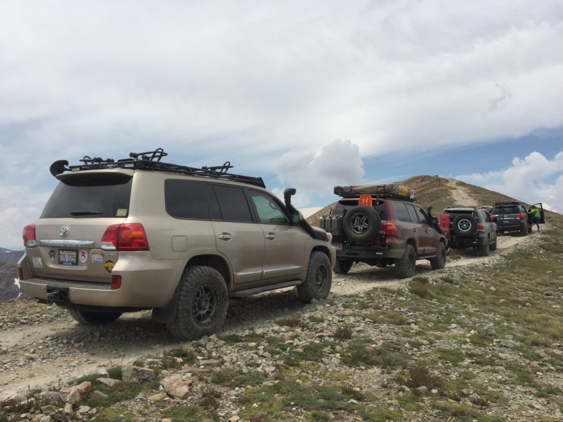

Thanks buddy. You have gold too? When I first saw the gold I was quite unsure but I have definitely grown to love it. Also amazing hiding dirt in the desert
Yep.
The roof rack is by Gamiviti. It’s a full expo rack with grid. It’s super versatile and barely any taller than the factory rack
The snorkel is a Dobinson. If I was going to do it again I’d go with ARB - the snorkel itself is fine but it’s molded for a 2008-2011 body and so on the 2013+ there are a small gap where the A pillar meets the body.
No skid plate upgrades yet. I will probably do budbuilt aluminum ones when I do.
Trail Tailor front bumper is on order. Hopefully @reevesci will have it done by the end up June (fingers crossed). I’ll do a rear in the future but holding off right now since the LC is our only vehicle and my wife’s DD and I know swinging the tire out will annoy her
