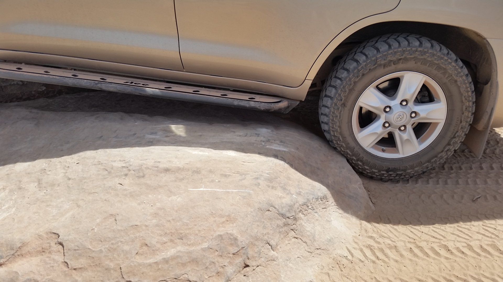

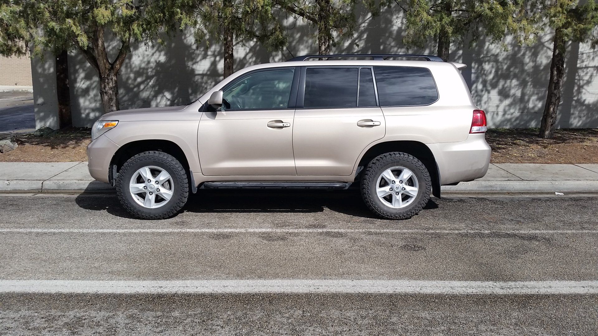

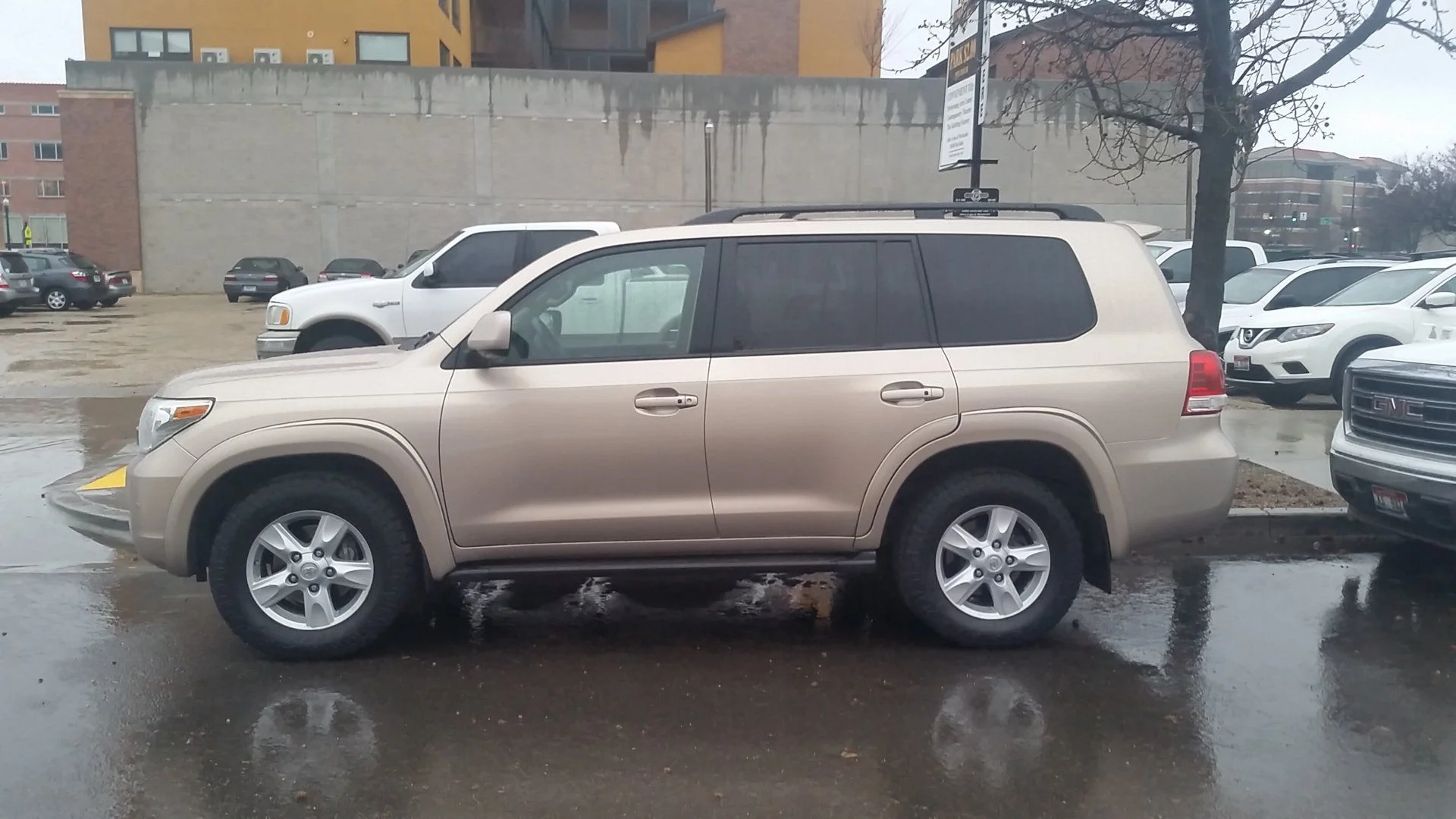

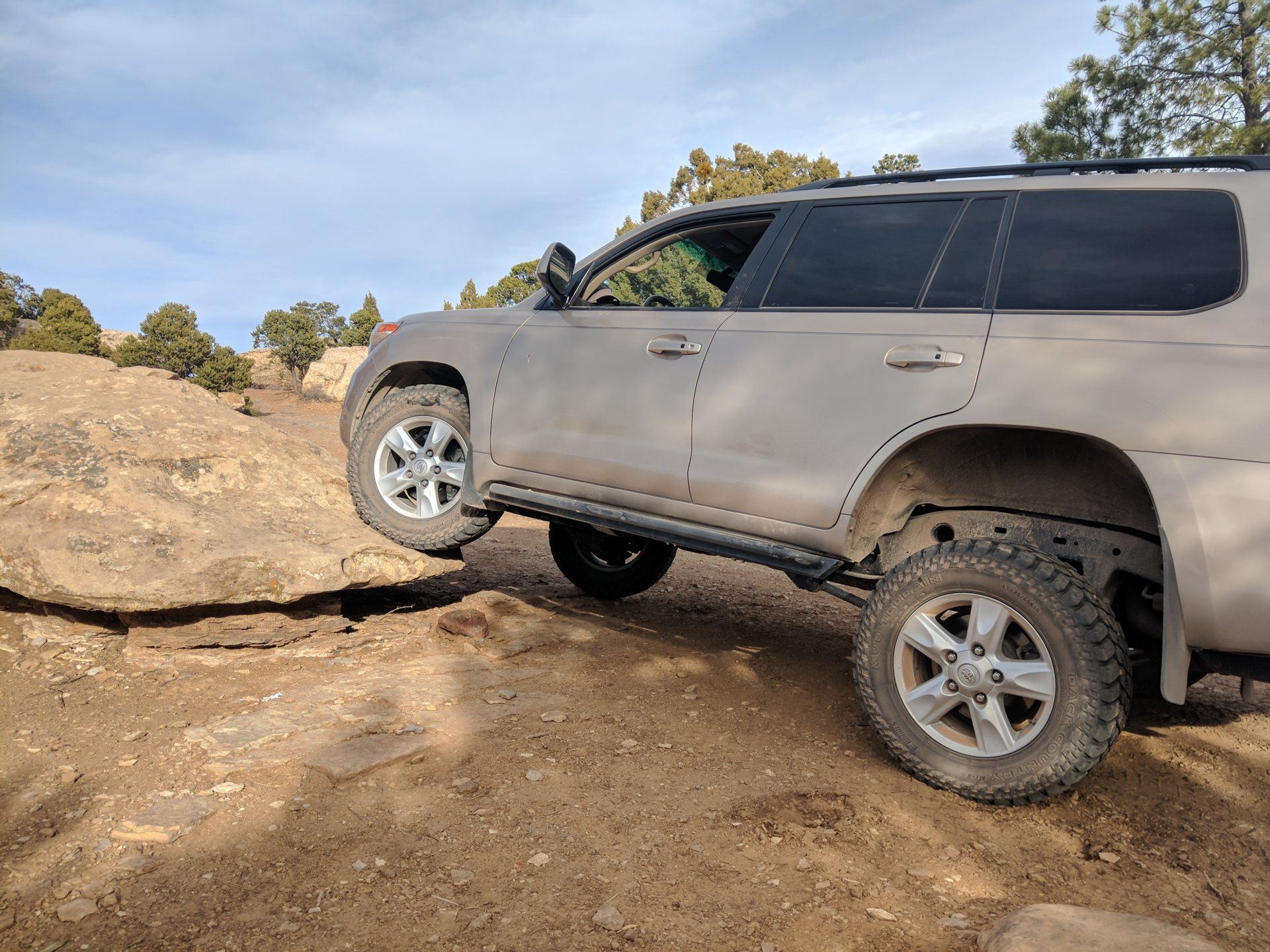

I recently did the same install you describe, less the diff drop. It works great. As mentioned, 2722 rear springs are too much. I had way too much rake for my tastes. I ended up with 2720 and a 10mm packer in the rear. I am going to try 2721 next. Good news is that you can change rear springs in an hour after you do it the first time.
Rig handles washboard roads at 60 great. Handles on the freeway great. Handled Moab trails great. Not sure what you need a diff drop, but I might be missing something. I think I got about 1-1/2" lift ( didn't measure before and after). I have attached some pics trying to show before and after

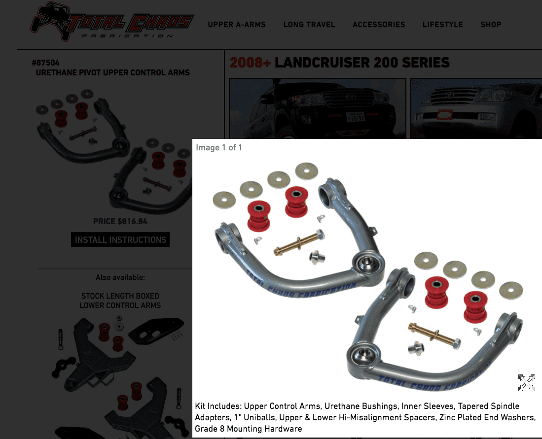

I have TC uppers for about 15k miles now and no squeaks, ever. I run the poly bushing though and not heim joints (heim take more maintenance). I do grease through the zerks every oil change. I like TC because they are a Toyota focussed brand, they build their arms perfectly to each application (from a dimensions perspective. No need to "adjust" either because they are already set for proper). Alignments are always on point. Put it this way, a couple of the other arms out there are basically "copies" of the TC UCAs from a dimensions perspective, heard this from a couple manufacturers, even one that sold his own (copy of the TC UCA). Copying is the biggest form of flattery!
SPCs have their issues too.

I recently did the same install you describe, less the diff drop. It works great. As mentioned, 2722 rear springs are too much I had way too much rake for my tastes. Indd up with 2720 and a 10mm packer in the rear. I am going to try 2721 next. Good news is that you can change rear springa in an hour after you do it the first time.
Thanks for the info and the pics. I hadn't heard of the diff drop either but my local shop (who i trust) recommended it and its pretty inexpensive. They said Front differential drop kit (this keeps the front CV’s at a good angle).

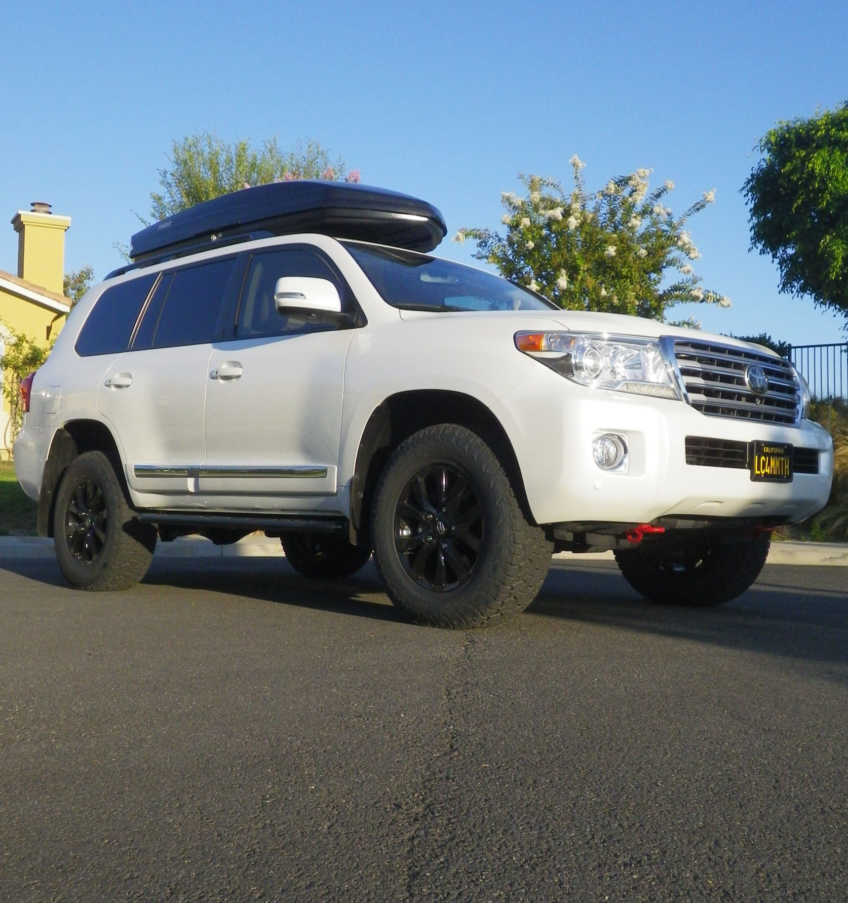

Thanks @SQRRRL . Great looking 200! I love the black license plate I remember those from when I was a kid in California. When you say you had the OME in the past was it on a 200 or something else? Just curious if you tried both on a 200 series. I hadn't really considered Tough Dog but now you got me looking. I looked on their website to price this option out and am a bit confused with the number of options. It looks like they have 41mm Foam Cell, 40mm adjustable, 45mm adjustable, and 53mm Ralph. Each one of those options has light, medium, and heavy rear load. What configuration did you go with? Probably best just to talk to Jason @ Trail Tailor like you suggested. Another question is how did you get away with NOT needing Upper control arms? I heard you need these to get the alignment back to factory spec? Am I missing something on this? Let me know, thanks.
Are these the ones you have?
Yes, if you get them get a little extra of the superlube that comes with tjemthem follow instructions. No squeaks.
And I'm not the only one running these, I know @Taco2Cruiser is a fan and they are preffered by owners on other platforms too (I think the LC guys like the SPCs more than other Yota model owners like the SPCs - just an observation). Edit: forgot to mention, SPCs will be less maintenance, TCs will require some. Take that into consideration, you may want the ease of the SPCs.
