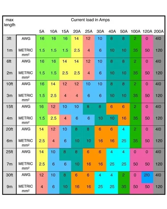

Yes, you can do your set up no problem. Decide on Sine wave or modified inverter. A 1500 watt inverter will need at least 2 gauge cables from the battery to your inverter. Use a cable size calculator like this to determine what cable size you need to run. Error on the side of larger than smaller.

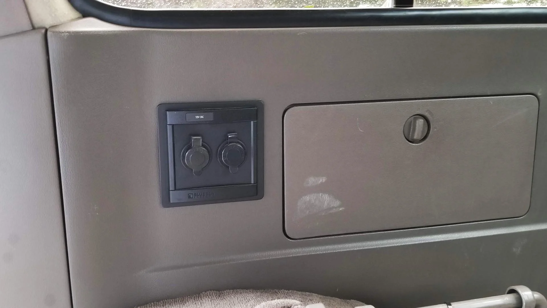

See what you mean here. The one thing I hate about this is the location of the plug and the fact I will lose that plug for other charging. I’m trying to increase plugs, not just use the only available one I have for another purpose. I also would like the unit to be in the back of the truck most of the time, charging while I’m driving. No room for it up front. And based on what I have read, the dc to dc charge will be much longer than any ac power I can provide a power station.
So add plugs. A heavy gauge wire to an auxiliary fuse panel and then as many plugs as your panel rating will allow. I have a total of six different ones in the back of my 200. I use Bluesea marine products exclusively. You can mix and match cigar, powerlet, USB A, USB C, etc.
I enlarged the 3rd row seat ashtray hole for a dual Blue Sea panel. Standard 12V for my fridge and dual USB A. Wired to my aux fuse panel (constant hot). Phone charges while i sleep and I run a USB powered clip on fan.
