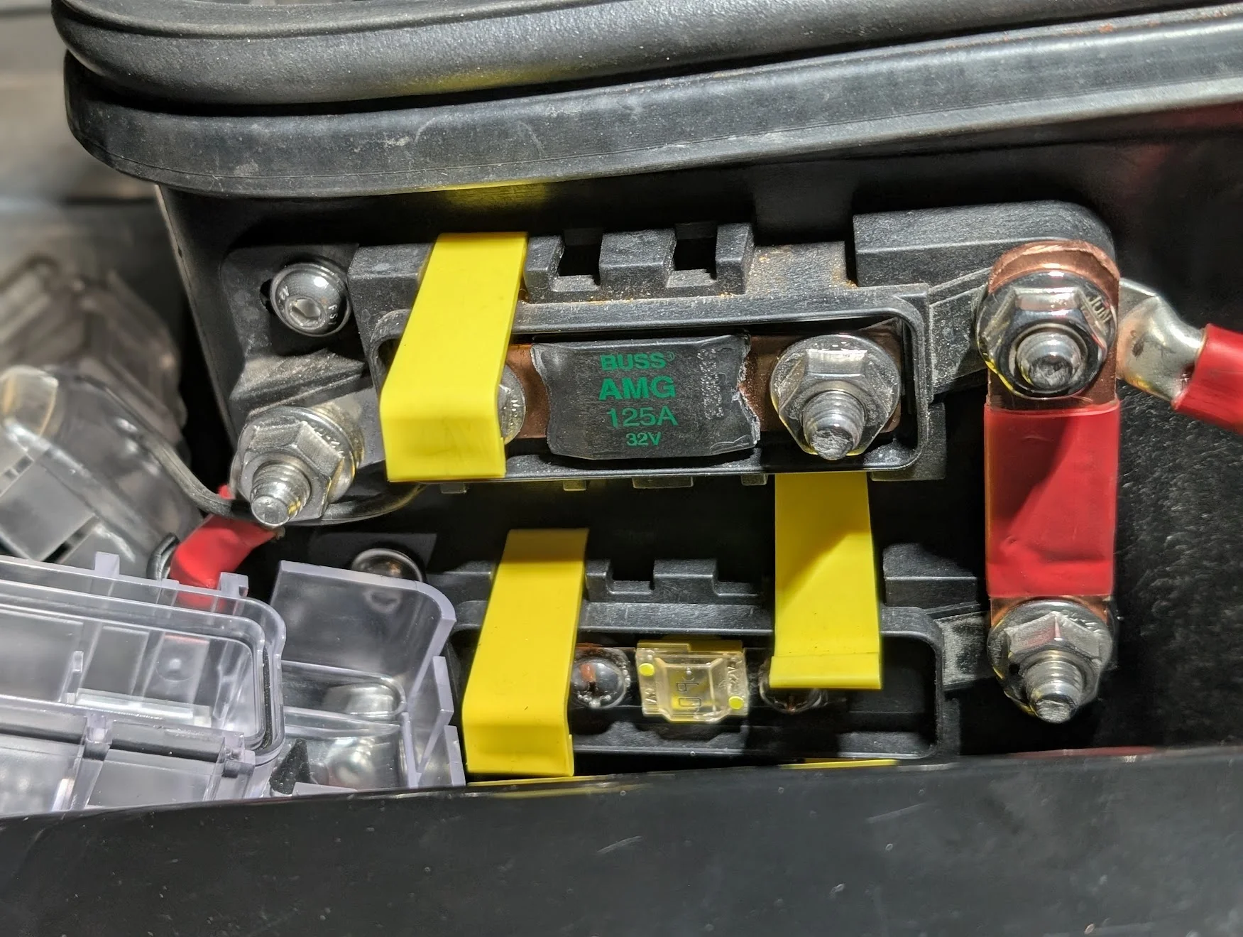

That makes sense, so putting a fuse in. However that also isn't done for starter wires? Or is there a fusible link somewhere that I have not seen?
Yes, use always use a fuse, and if current can flow both ways, fuse both sides as close to the source as possible.
OEM do not fuse the starting wires. Fuses tend to be more problematic at high current loads.
No the starter wires are not fused. They're also not 10awg. They are sized appropriately for the available current.
