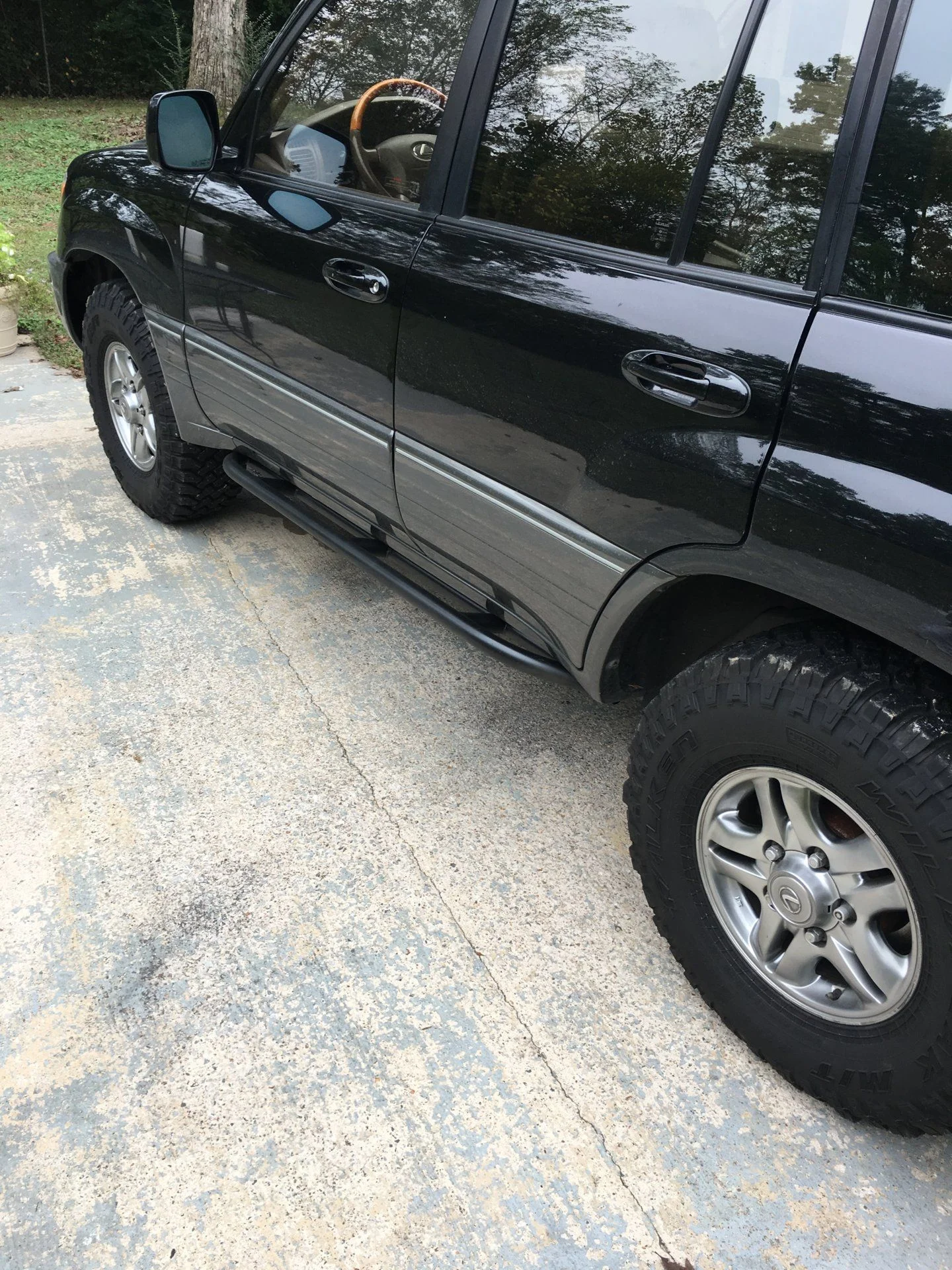

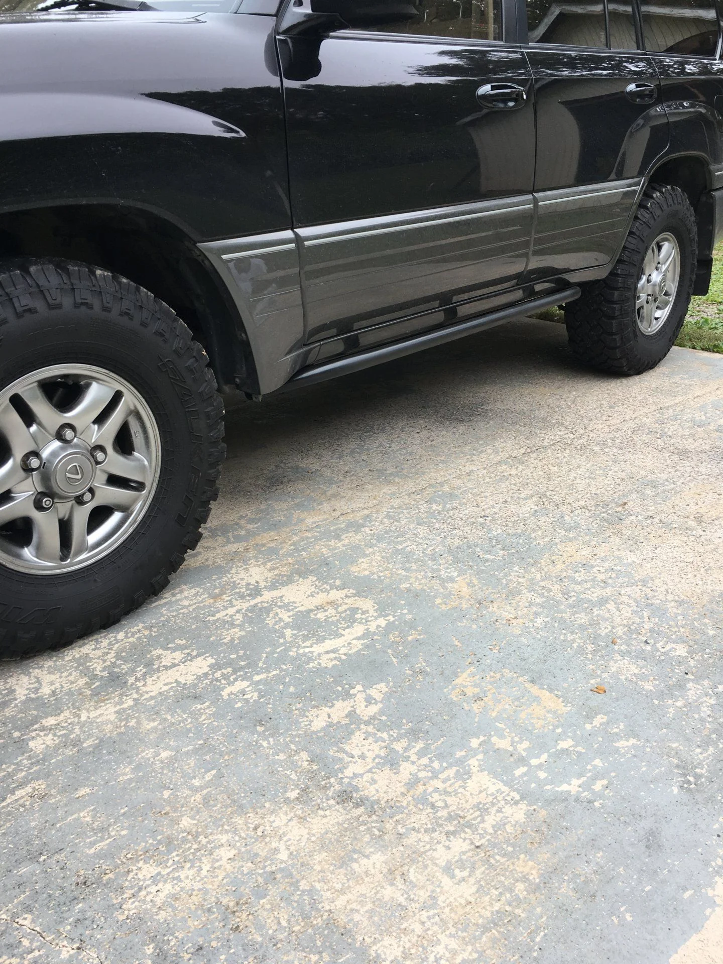

Sliders are done and they came out great.:clap:
bars and mounting kit $225
3.5 hrs mock up and weld $130
paint and primer $12
Welding to LX after paint $35
skateboard grip tape (on hand) 0
Total $402

Nice! Couple questions:
- I noticed one of the frame brackets had some trimming. Details?
- One of the outriggers and the frame bracket itself is at an angle. Was it complicated to mock up?
- Does the placement of the outriggers work with AHC (not sure if your LX still has it)?
- What length did you go with? It looks like there's room to go longer for those not running front mudguards.

There are only specific places on the frame that will allow for the brackets to mount. On the drivers side rear bracket(first) i positioned the bracket further forward but when i did the passenger side i decided to trim the bracket to fit in between some obstructions and position it further back to help support weight on the rear of the bar. ( if you look at the unpainted pic u will see that the trimmed bracket is further back.) Both front brackets are at an angel as the frame is angling inward for clearance for the front tire. It was not a complicated mock up just time consuming. Basically you look for the best placements for the brackets and clamp them to the frame and start making connection bars to reach the side bar that was positioned where i wanted it on the jackstands. FYI the bars angle up 16 degrees. All of this was done with my AHC in place. These are 67 inches in length but the only larger size that trailgear sells is 78 and that was too large for me....
Observation (not a criticism): Believe the gap from inner tube to outboard tube should have some grating spanning the gap. That gap may trap foot and break ankle/leg when using as a step while exiting the rig. The round tubing exasperates this as is predisposes slipping. There is a thread somewhere on mud that mentions this.
Very similar problems with semi-pro residential wolf kitchen ranges (and the like). the handle to the heavy oven door is such that can trap hand & break wrist when opening.
Live to ski,
I appreciate your comment. the angle of the pics looks like there is room but its not very open and I just tried to get my foot thru and could not (size 7.5) My boys are older and wear a larger size shoe. I will warn the wife but the skateboard tape is like 40 grit sandpaper and slipping off the bars is just not happening........
