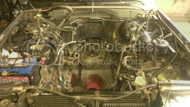

1996 80. I was trying to achieve a 1 week hg job and all was going good. First thing the timing chain guide has a small tab where the tensioner push's on. Well that was broke. So off goes the front timing cover and oil pans. Then after cleaning the head deck I noticed on cylinder 1 the head gasket had burnt into the head deck around the front of firing ring. Not good. The block needs to be decked. So very long story short the engine is out.

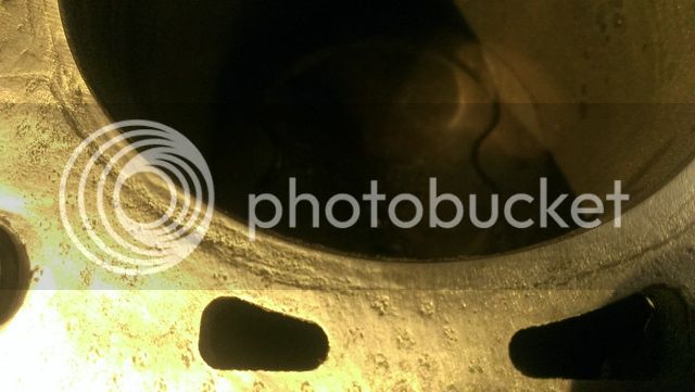

First pic shows cylinder 1. Piston rings are grooved in. You can feel a descent indent in these spots

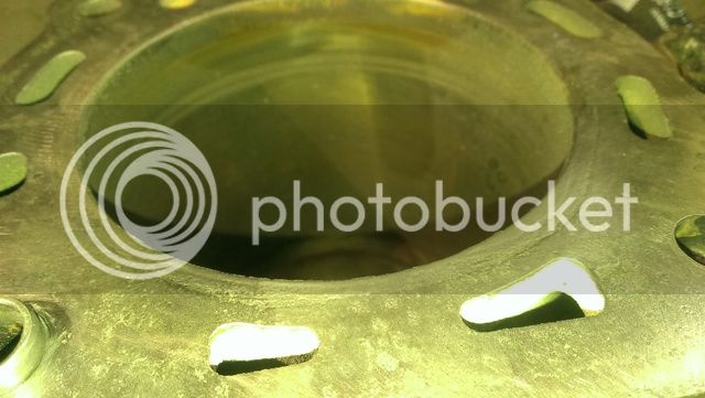

Second pic show deck damage. this is also cylinder 1. damage is prob more than 10 thousands deep.
Funny thing is the head gasket leaked externally on cylinder 6 and internally on cylinder 5.
Machinist says the engine was likely overheated. IDK.

If it were mine I would just see if they could deck that block. I did exactly that with my 94 to remove fire ring pitting. New rings, honed cylinder walls and was good to go.
The machinist was saying I would need to bore and used over sized pistons. Did you have any ridges in the cylinders?
All cylinders will have a ridge of carbon built up on them. That's why they get a ridge reamer used on them but that's different from having them re bored. So yes I would expect to have the ridge re cut and you would need a step hone before you put new rings in, but the block only needs re bored if you have a cylinder that is overly worn. How do the cylinder walls look ?

Pics above. Cylinder one shows indent from rings. You can feel the steps with finger.
Head is pitted out common on cast iron blocks not ALWAYs tho u gotta chk REmber that when buy a used engine speak on it before u buy its had gasket failure same on my old block an its on sell ring u will need a mls head gasket 180 200 alone an machine honing rings yes could get it to work then you have the head job an the reinstall been thr same wit other engine thoughts.they discontinued the 1fze an restocked it wit supceeder number. 80 is popular demand shorts r going around 2400 2800 3100 after market 3500 a block me 3100 plus tax dealer you start fresh my pops said same an its a 80 land ah yeappp priceless like 1st gen 4 runner thnk about it you miss rideing already do the yota short
