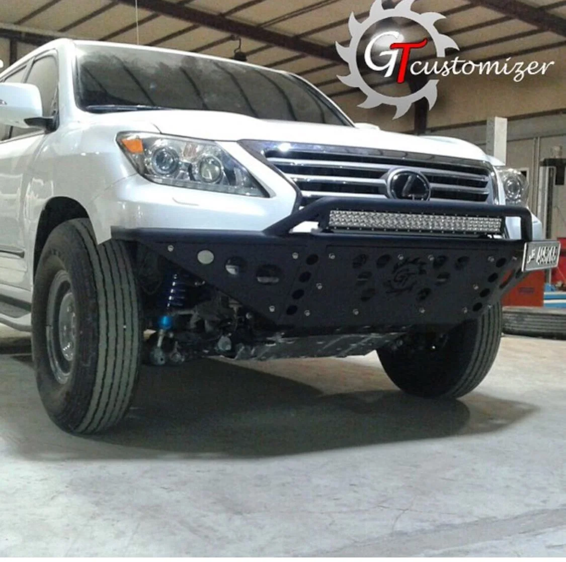

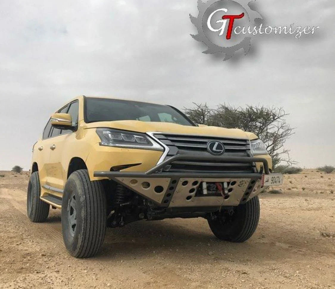

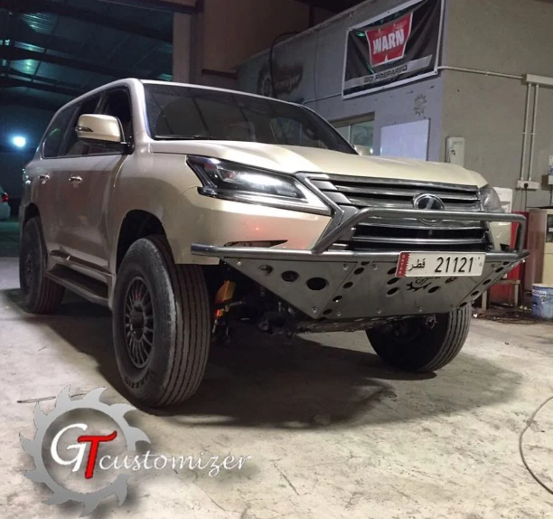

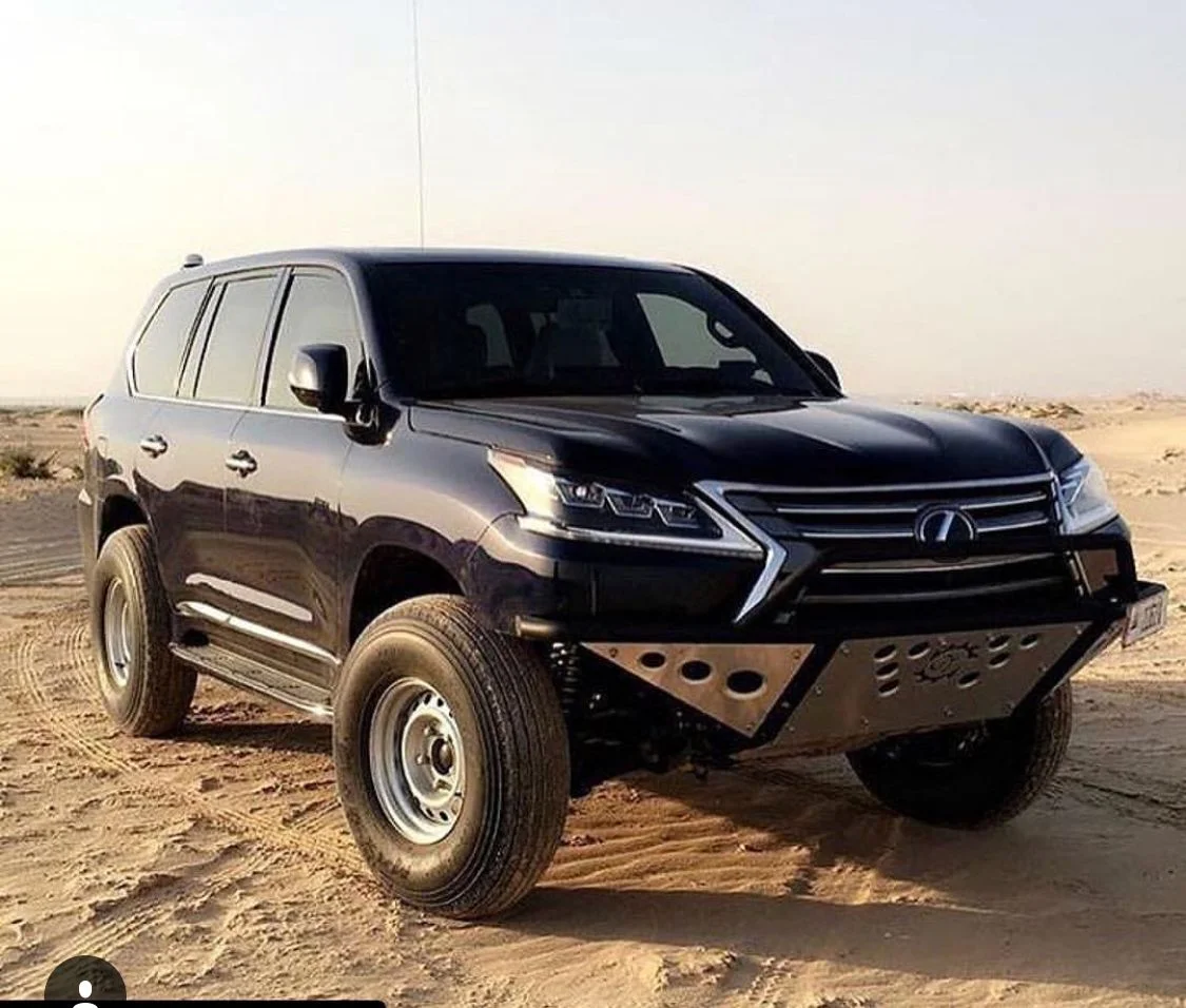

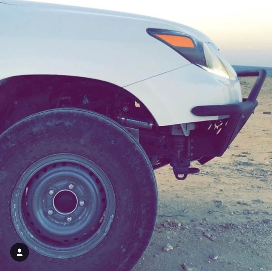

Guys its FAR from impossible !, almost all lx570 especially 2016+ have the AHC system removed in my country, only downside is dashboard lights. Dont cut the stock wires tho! Ive done it myself with a help of a mechanic and some energy drinks.
Examples
Are these one-off custom fabricated pre-runner bumpers, or are they specifically manufactured stock for the LX? If so, who is selling them?
