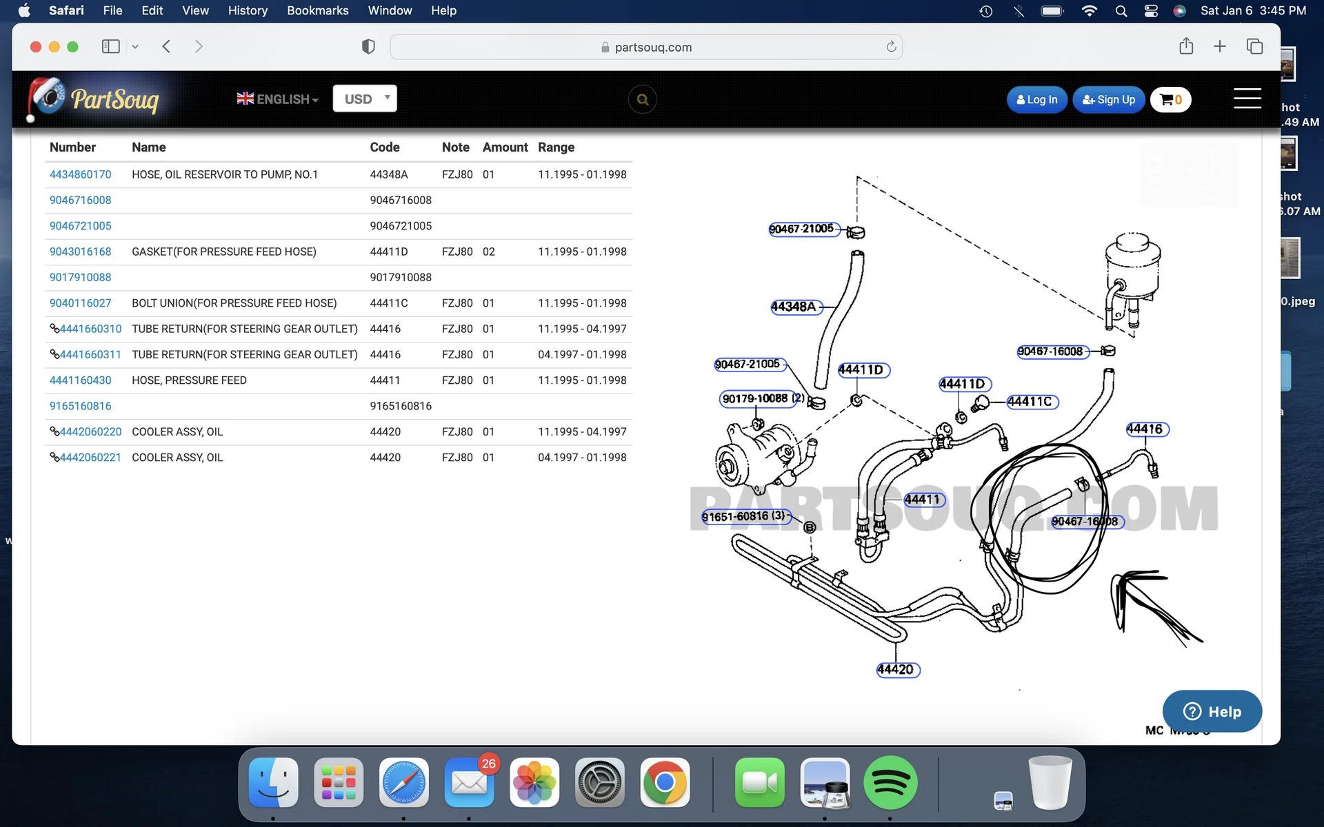

I did the search on 'mud and found out I need Gates 5/8 Transmission oil cooler hose for the power steering return hose that's about 12 inches long. Toyota doesn't even have a part # for it because it's attached to the oil cooler assembly. I've went to 2 Autozones, 2 O'reillys, 2 Napas, and an Advanced Auto and nothing. Any idea where else to look? If someone has a chunk of it id gladly drop a few bucks by Venmo or whatever. I've attached a pic with an arrow pointing to it.

ive brought the L- shaped fitting into each one of the parts stores along with the original hose, and none of the trsmission oil cooler hoses fit on it.
I used a piece of bulk transmission hose from NAPA. Take your old one with you. "Tight is right" when it comes to fitting.
