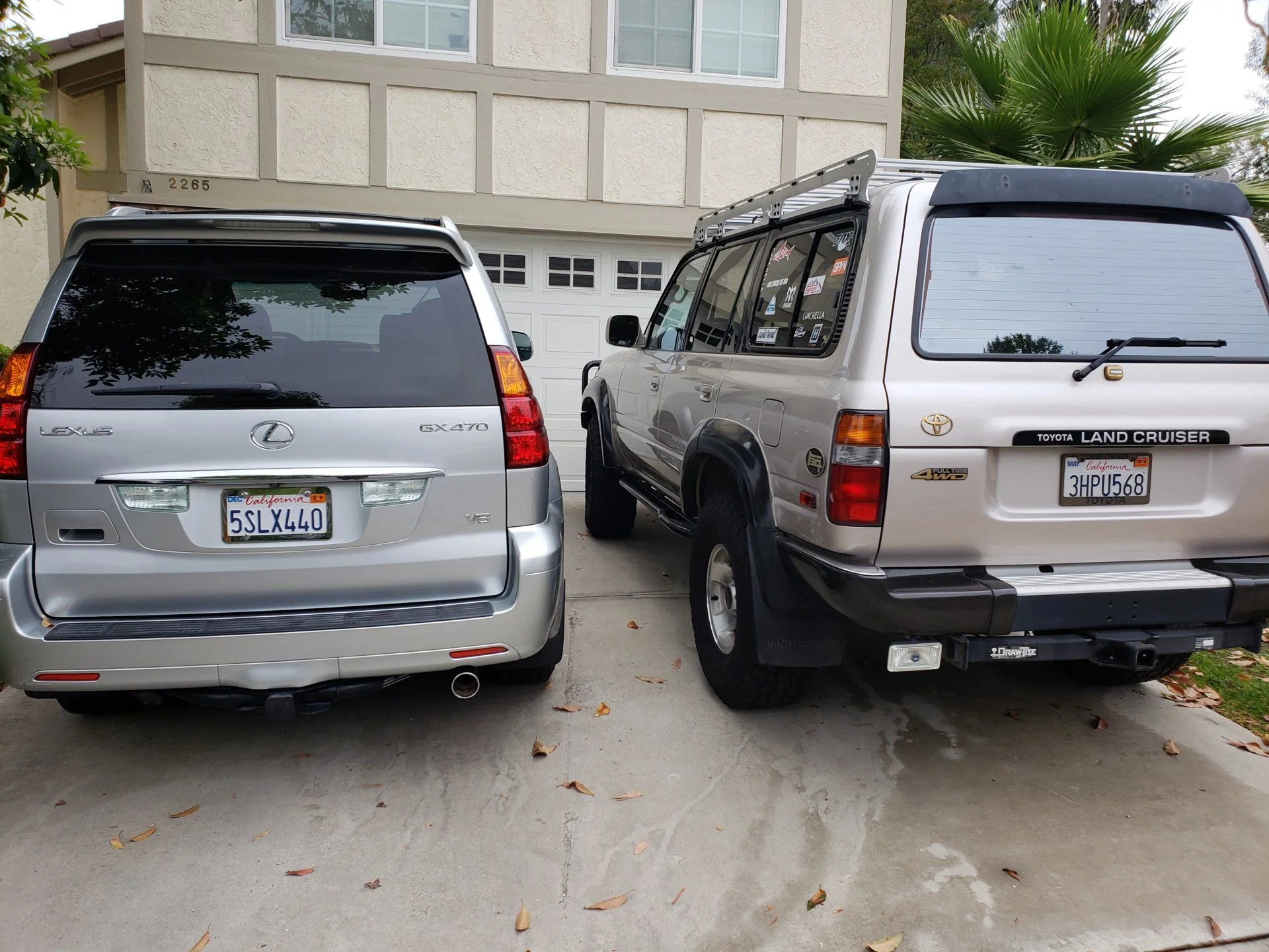

Gotta have one of each...

Different tools for different jobs I guess. I just did 700 mile trip in the 80 with wife and 2 kids. I must admit that I was longing for the comfort and power of the GX but there's no way I could have brought all my gear...it just won't fit in the GX. I was eyeballing some tent trailers I saw around camp though which would work. Kinda cool to have multiple camp neighbors come by and want to know about the 80 though...it's fun to chat about.

If I needed more space I'd be looking at a 200. The 80's are just too slow. I loved mine (it treated me well on a 6 day Baja trip) but it needed another 200hp.
