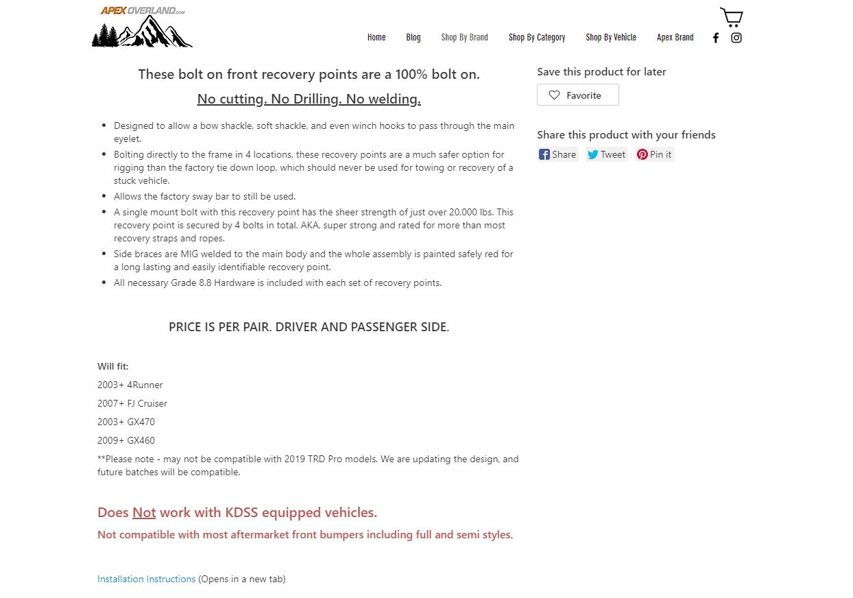

the APEX recovery pt says right on their site, does NOT work with KDSS
I can’t comment on KDSS but my APEX recovery points fit perfectly on my GX470 non kdss model. In fact, I did a video and photos of the installation that I proudly installed myself.
no drilling required. I did have to remove the sway bracket to slide the apex recovery point under the bracket, but everything lined up and bolted into place. Recovery points share 2 bolts with sway bar brackets and another bolt holding something else.
Check to make sure your mechanic considered that bolt holes on frame are shared.
Thank you for your reply. It is the KDSS that is the problem, and while I thought I read every product description carefully, apparently part of this is my fault because 2/4 of the products say not KDSS compatible in the product description.
I didn’t see the kdss warning in the apex recovery point description either until @ebbs15 pointed it out.
In hindsight, the advice to all kdss owners is to call and confirm fitment with your rig.

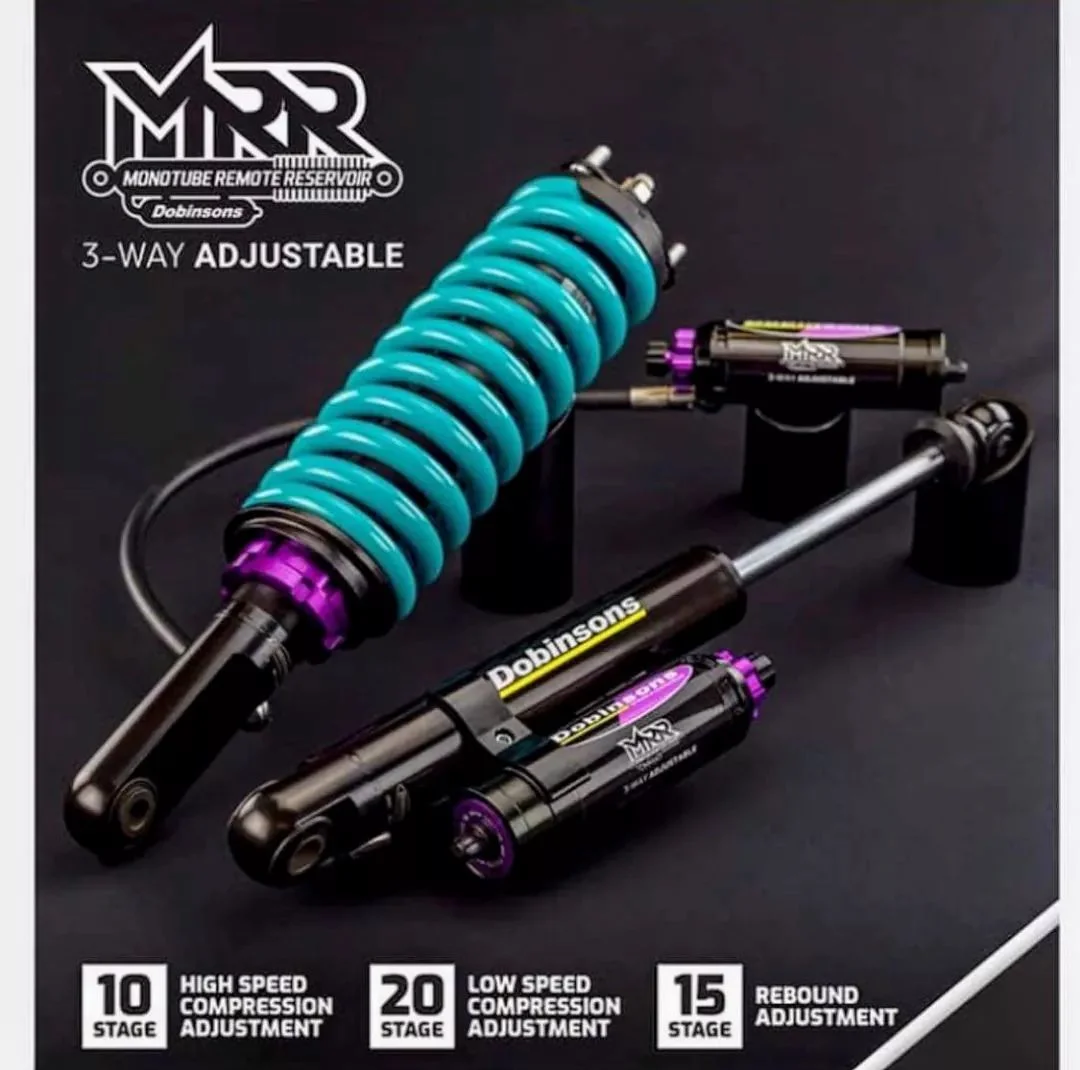

@Jstawgn
Are you running these now, or Toughdog?
(I can't remember your setup.... :geek:)
I still run the Toughdog. Stil working good for me. Did replace the front coil with OEM 2886 since it only give 1" of lift. End up with 3.25" with 2886.
Add cheap ebay 1" coil space to the rear to keep slight rake.
