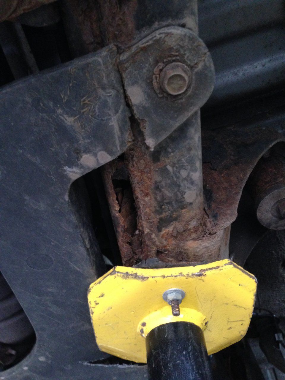

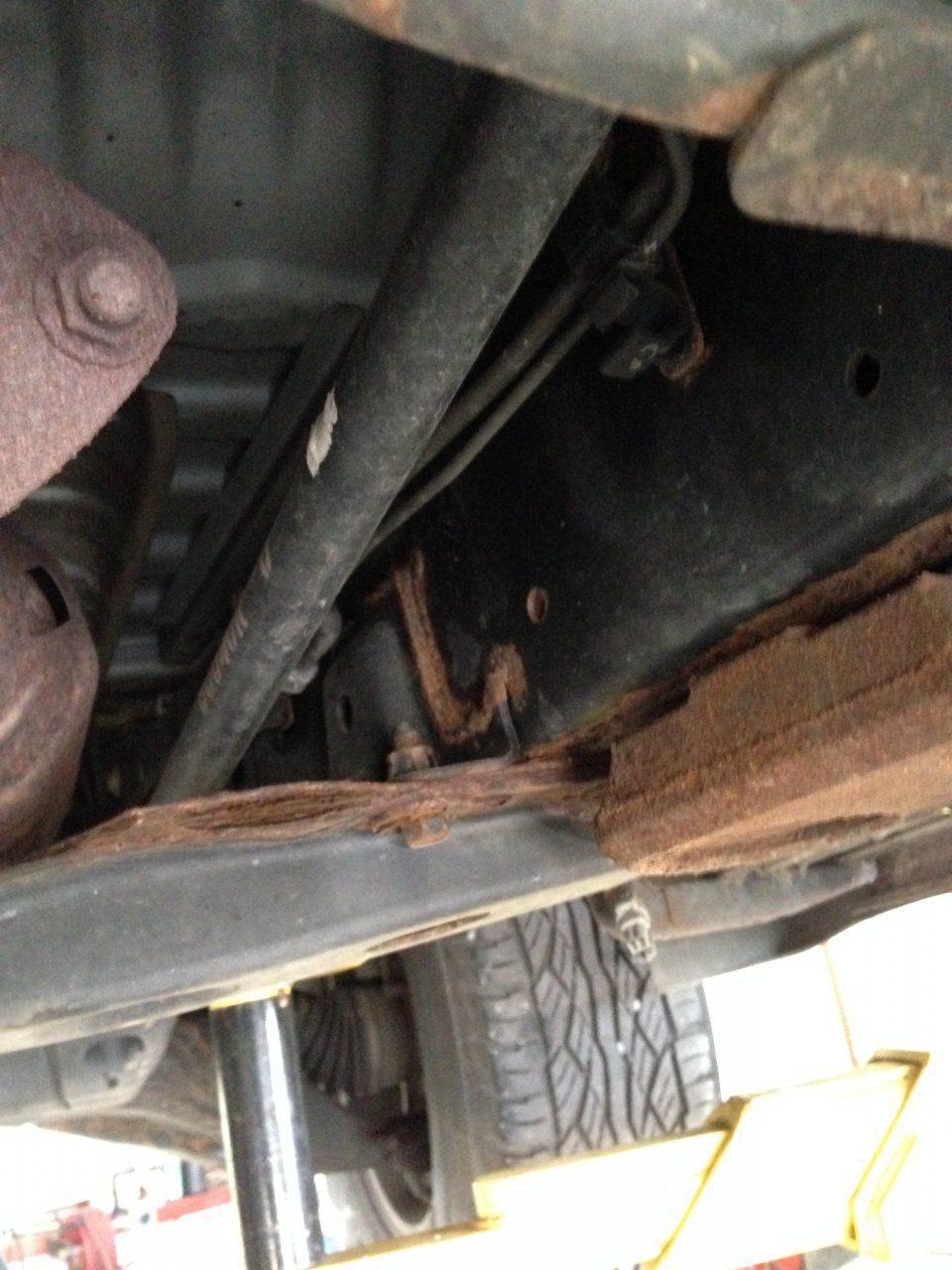

Bought this at auction sight unseen. $7700. It came from NE and I'm in TX so my mechanic is not used to seeing rust of any kind, but he told me run, don't walk. Any thoughts?

I would not worried too much about rust on a component (sway bar and shock on pic no 4). These most likely need to be replaced, rust or not due to age. Pic no 5 showing a broken plastic shield - no biggie, but is that a hole on the background? I cant tell for sure. Pic no 6 is showing a hole - I cant tell what that is, but that does not look good. I would check the frames to make sure you do not have rust thru holes and go from there. Look like you have rust on the frame here and there (pic 1-3). Maybe you paid a bit too much, but honestly it does not look too bad from what the picture - I have seen worse in my area - Kentucky and Ohio.

Don't beat yourself up too bad over it. Here is my take coming from the NE, inspect all of your suspension mounting points for cracks or weakness. That will be a killer. Clean all the flaky rust of with a hose and scraper and wire wheel the rest then slap some paint on. That will buy you some time. Do you have any maint records on this truck? Hopefully you have some mechanical knowledge. I would try not to put too much $ into this. When it needs major repairs part ways. If the body is still good most dealers never look underneath and will still give 1500$ over kbb fair trade. Remember one mans junk is another mans treasure. I sold my 96 4runner with 225k a bad head gasket, extensive rust and a broken shock mount in 2 days on craigslist. The buyer said he didn't care that he would fix it. IMO the fully boxed frame can have rust holes on one side and still be somewhat strong.
@bctlex I believe pic 6 is the rear fender area. I have the same rust hole on mine. Correct me if I am wrong.
I think you are correct that pic 6 is rear fender area. The pipe must be AC condensation tube (?) I do not have rear AC, so mine do not have this.

Bought mine with a bit of rust.....my rear upper quarter panels look like yours, and I've got a body guy that's going to fix that and my rocker panels for me. My transmission cross bar member looks like yours, but you can buy a new or used one and replace that. The other stuff looks like suspension components etc. Put it on a lift and scrape the hell out of all the bad areas. Then buy VHT rust inhibitor spray off Amazon and coat everything, then over spray that. As long as the frame isn't rusted out just repair and reinforce those areas.

To me, Pic 5 is VERY SCARY (the one showing the lift pad)! That is major frame damage. If that spot is rusted clean through the bottom of the frame it's probably almost thru in a much larger area.
This looks like near the front cab mount. I'd start here with a ball peen hammer follow that rust area and see how far it goes
