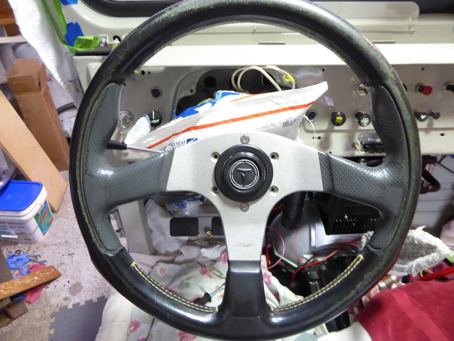

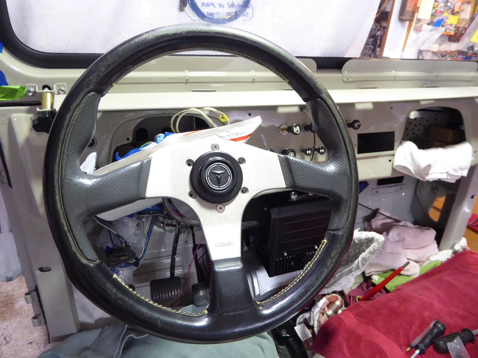

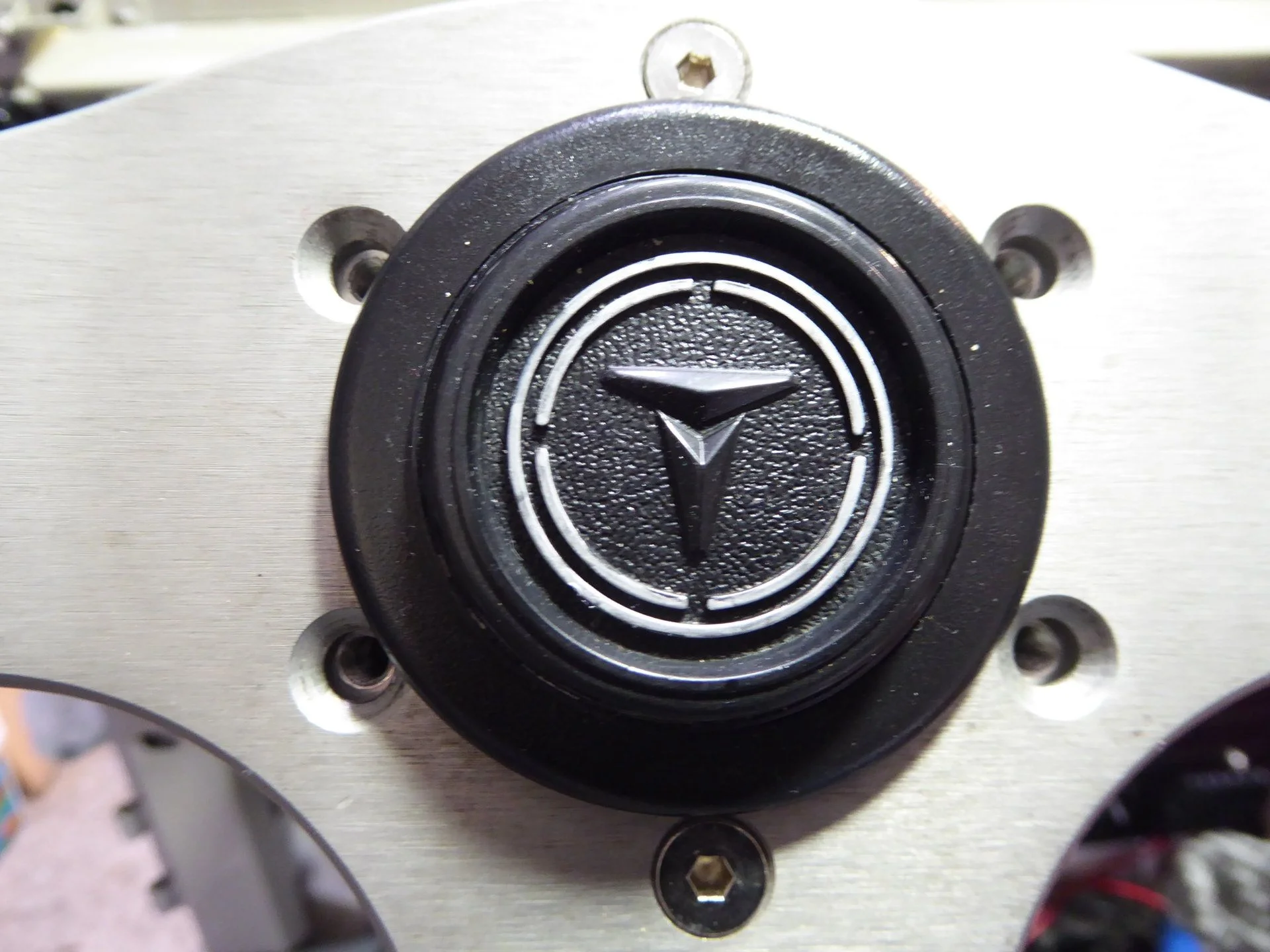

Glad to see you are still looking at installing a Toyota steering wheel onto your aftermarket column....I too am interested. What I'm leaning to at this point is a Moma steering wheel. I had a horn button from an earlier Toyota wheel, so I sliced and diced it to work on the Momo horn button. Still needs a little clean up, but it's all a work in progress.

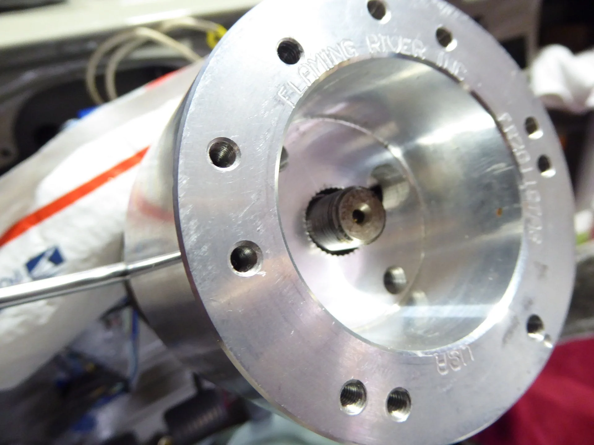

I have a Flaming River (same thing, GM based). The picture is of a FR adapter to fit the Momo (I think it also fits Grant) wheel to the FR column It's dished down an 1 1/2", one thought is too cut it down and tap it, and mount the wheel in the same fashion as Momo's...which is 6 screws or add a Toyota spline to a plate....while trying to accommodate the extra thickness of a stock wheel vs a Momo. All random thoughts at this point.
I think you have to add the spline. I don’t know that I’d trust make shifting the wheel to those mount points.
Or- a plate that mounts to those locations with a centered spline to drop the wheel on and bolt to.
