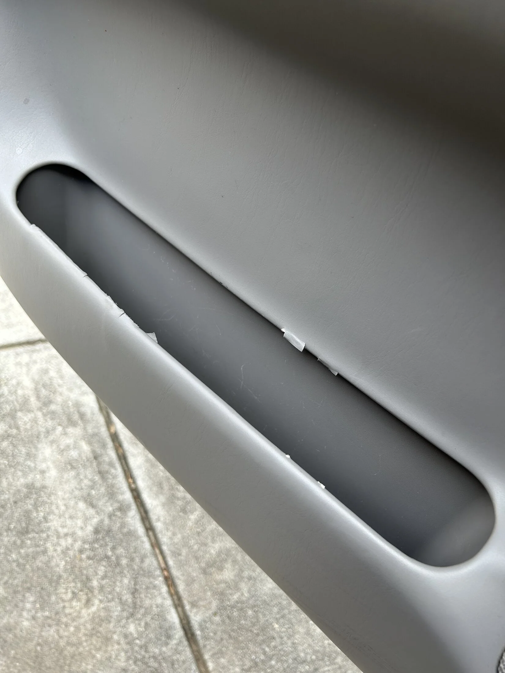

I'm on a mission to clean up the 100. I've had it for 15 years and 160,000 miles (it has 196,000 now) and it's showing its age. The list is long and has some of the expected items, e.g., new leather, new carpet, etc. There are a few obscure things that are bugging me too... like the door pockets on the front doors.
Any suggestions for fixing these... without buying new door panels? I thought about just glueing it but I think that could end up looking like, well, like I glued it.
Without being too creative, because I'm not, you could try a piece of fender guard trim that will wrap around the lip. Use some SEM to dye it to match the door panel. But, that may look kind of... odd.
@MongooseGA I thought about that - using door/fender edge trim - but couldn't see where I could terminate it without it looking bad. Also, those curves may be too tight. I think the punchline is that I need to shut up and try it.

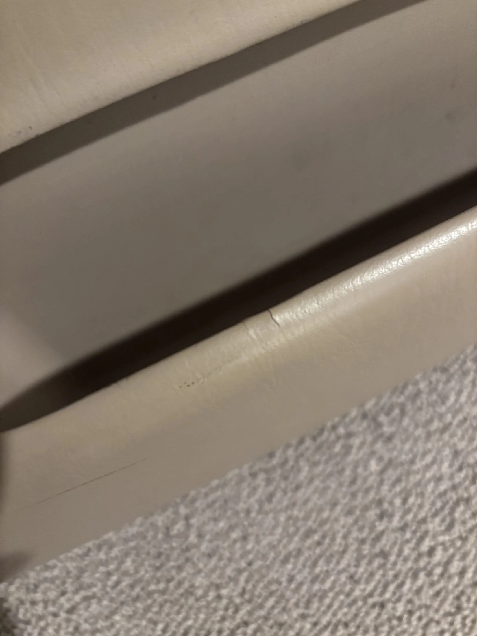

I just got done LX-ifying my LC door panels. I had one small spot like yours and put a dab of superglue underneath the little ripped part, and you can hardly see it. I would go that route and then patch with a vinyl repair kit, if it’s still bothering you. I think adding a piece of trim there would work well, if you have something that can secure it.

Not photographing particularly well, but here is the superglue fix.

Swing and a miss on with the door edge guard. I had high hopes. I tried two sizes. The smaller (5m) wouldn't stay on the straight sections - the edges of the door pocket are too think and widen a bit as you move from edge. The larger door edge guard (8 or 10m) wouldn't make the tight curves.
I glued the the loose flaps with super glue (couldn't use Touch ID o my computer for a day ;-) ) and it still looks like crap, just less noticeable. I'll ask the upholstery guy when I'm there about the seats. Yeah... gettin' spendy.
