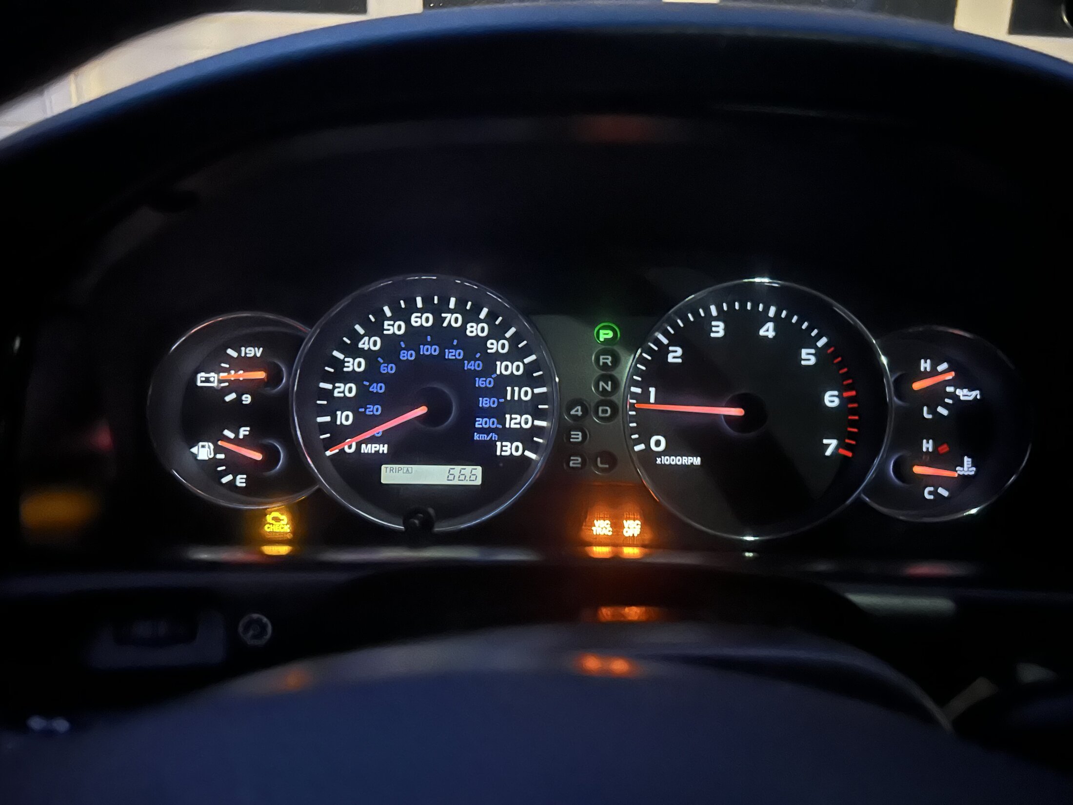

Update on this issue, still waiting on a gas cap and then I need to run more gas through it and try this Cataclean. Also gonna research removing the cat and cleaning if off the vehicle. Code and VSCC lights come on daily after I clear it.

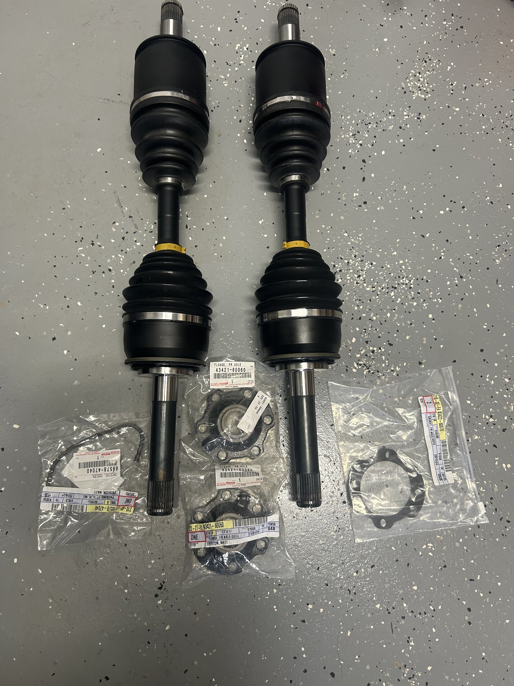

Slow progress, mainly waiting on parts at this point. Ordered the diff mount arms and other small bushings from Impex. Man they are slow, no correspondence in a week. Took advantage of the 25% off sale on OEM parts and ordered new CV axles. Mine are slinging grease everywhere and have lots of play at the outer splines. Also found a BT-45 Toy for seamless BT integration.

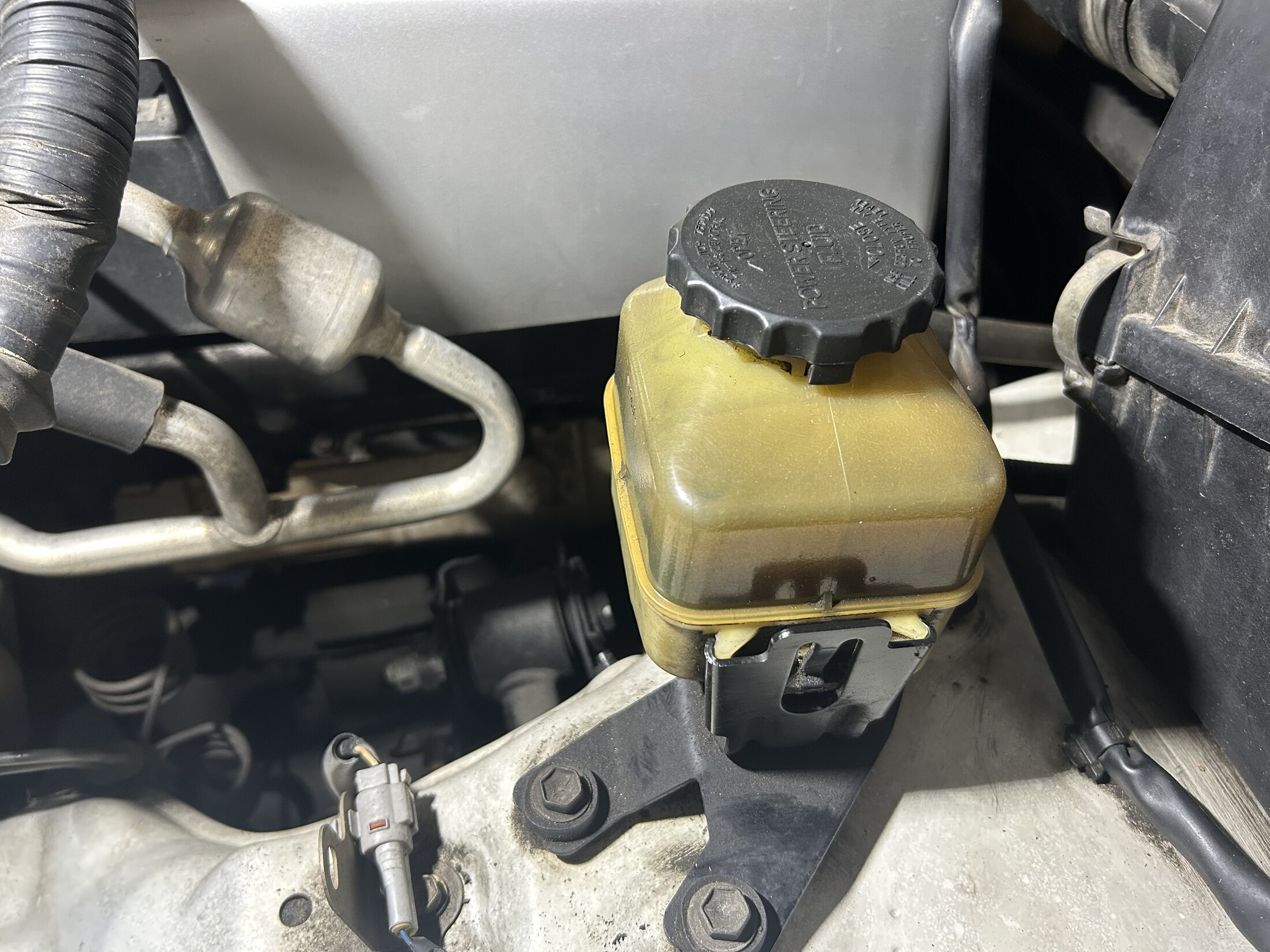

I did flush the power steering fluid. Also noticed that I have an oil leak on front of motor. It’s minor but dripping above oil filter and it’s hard lines. I am taking it this week to local Toyota shop to get their feedback on the leak and broken AC.

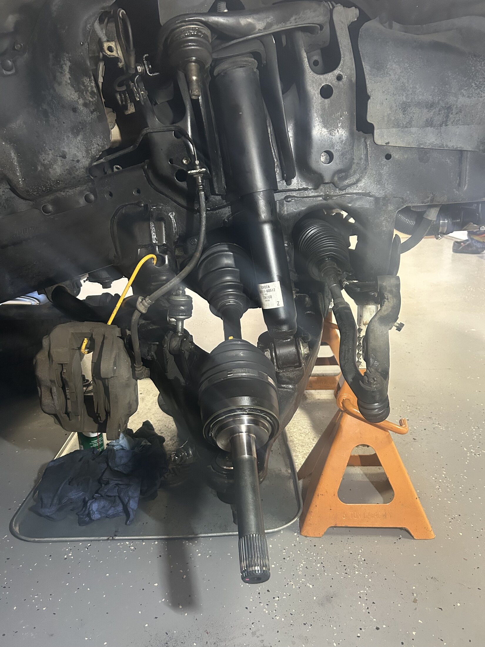

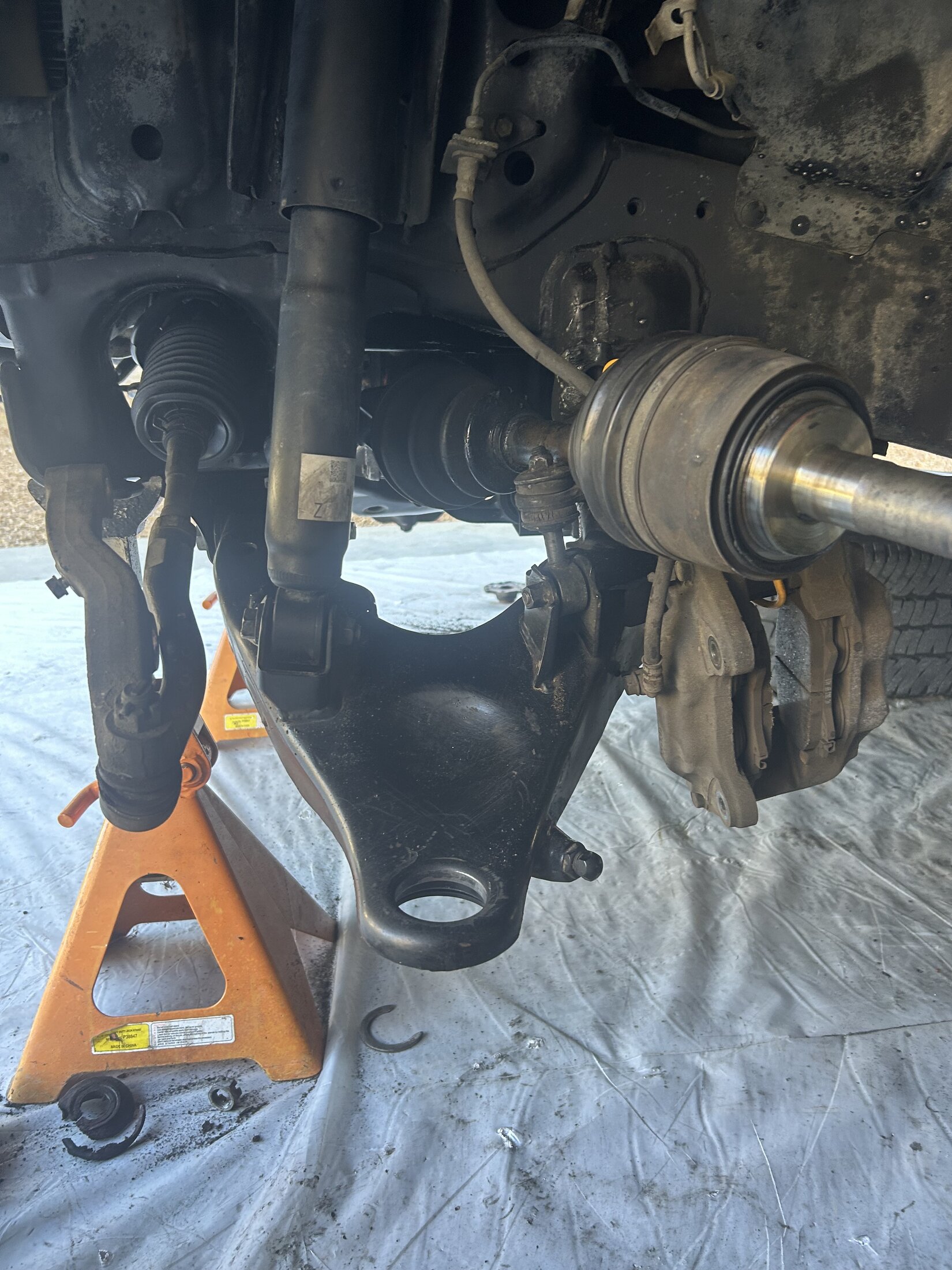

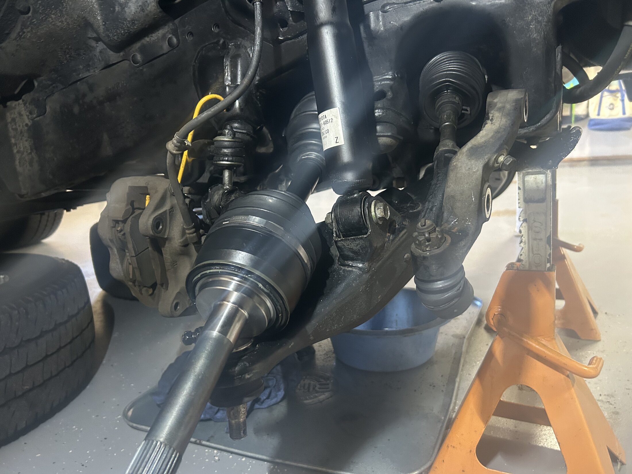

Got a shipment from Serra Toyota on Friday also and put in new CV Axles and Drive Flanges today. Hopefully this will help with the clunk and it will definitely eliminate the grease slinging everywhere. Pretty easy job but I did discover a stripped hub stud on the driver side. So will have to fix that. Gonna try and run a die nut on the stud, hope I don’t have to replace it. Ordered new cone washers, nuts, and one stud just in case. Pics of the CV axle install. Love fresh parts!

-P0420 Code

-Clean PS reservoir & replace fluid. Will add AT205 as the rack has tiny weep

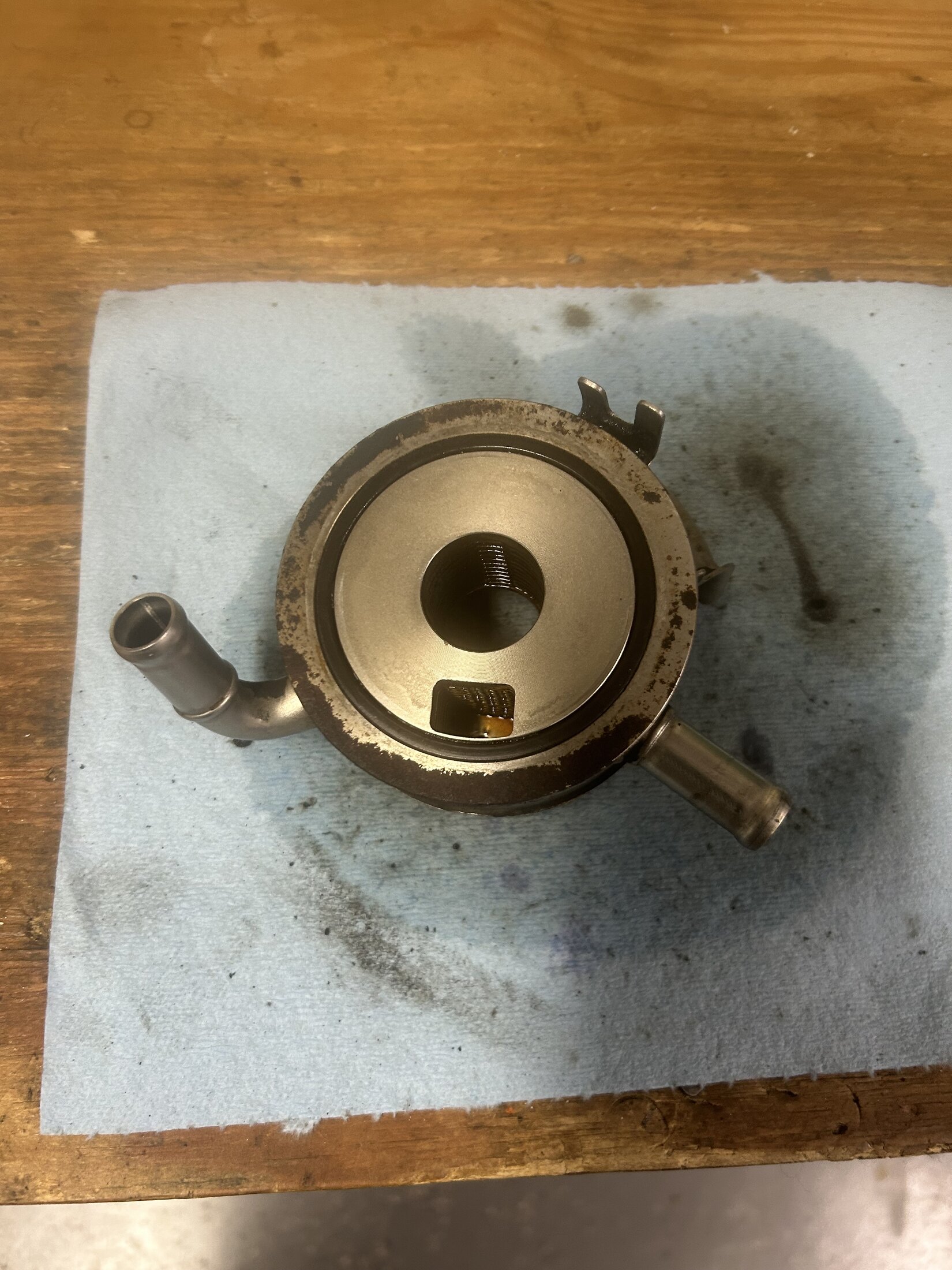

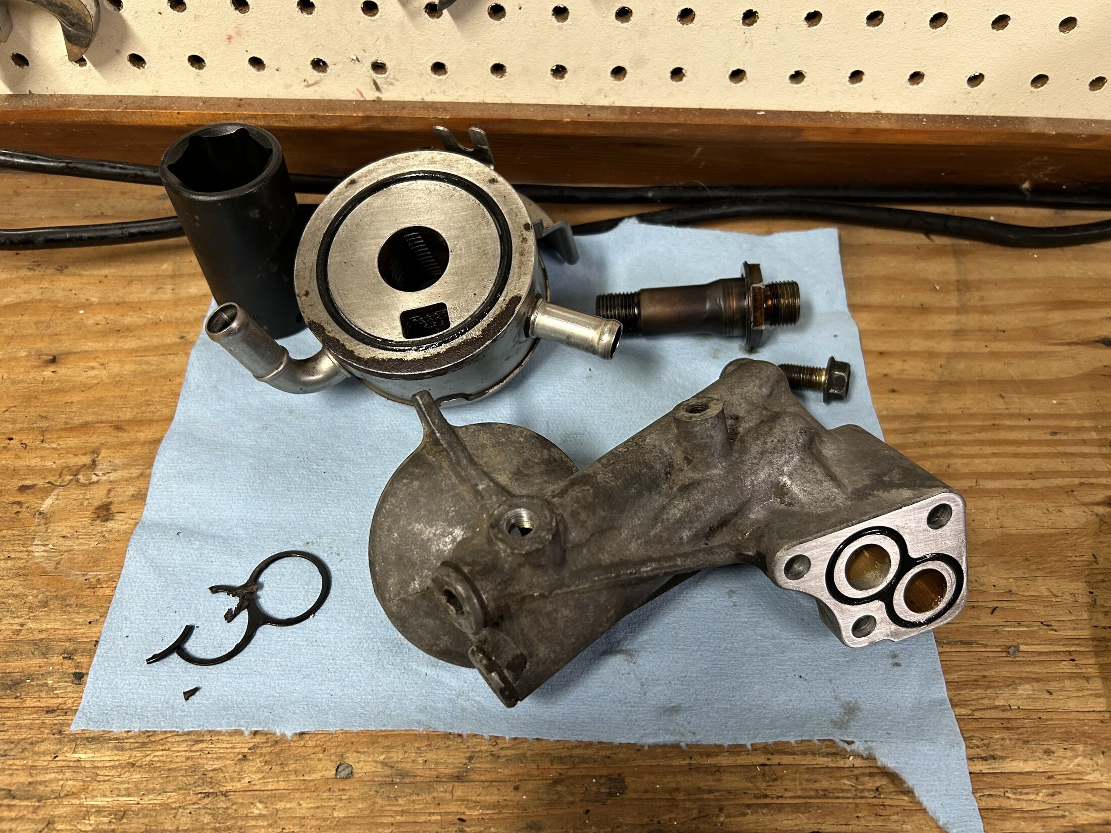

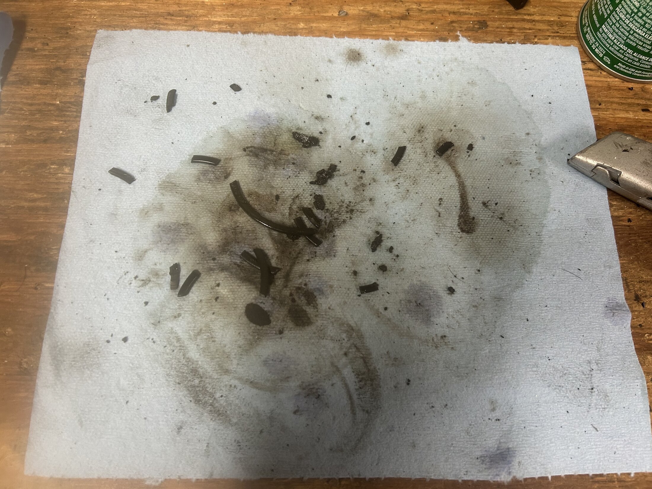

Two separate projects over the weekend. First is addressing an oil leak behind the oil cooler (oil filter housing). I replaced both the o-ring and the figure 8 gasket. It was more difficult than expected, but both gaskets were hardened and in bad shape. One pic shows that the o-ring came out in 10+ small pieces. It took several hours and I lost all the coolant, so that was a kind of a pain. But it worked and there is no more oil leak. If I did it again I could probably do it in half the time. Good thing, because I need to do it on my 98 LX!

Still have the P0420 code. I have tried replacing all the cheap items for troubleshooting the cat efficiency issue, to no avail. Code just returns after a few days. Gonna try a new MAF sensor, then it’s on to a new catalytic converter.

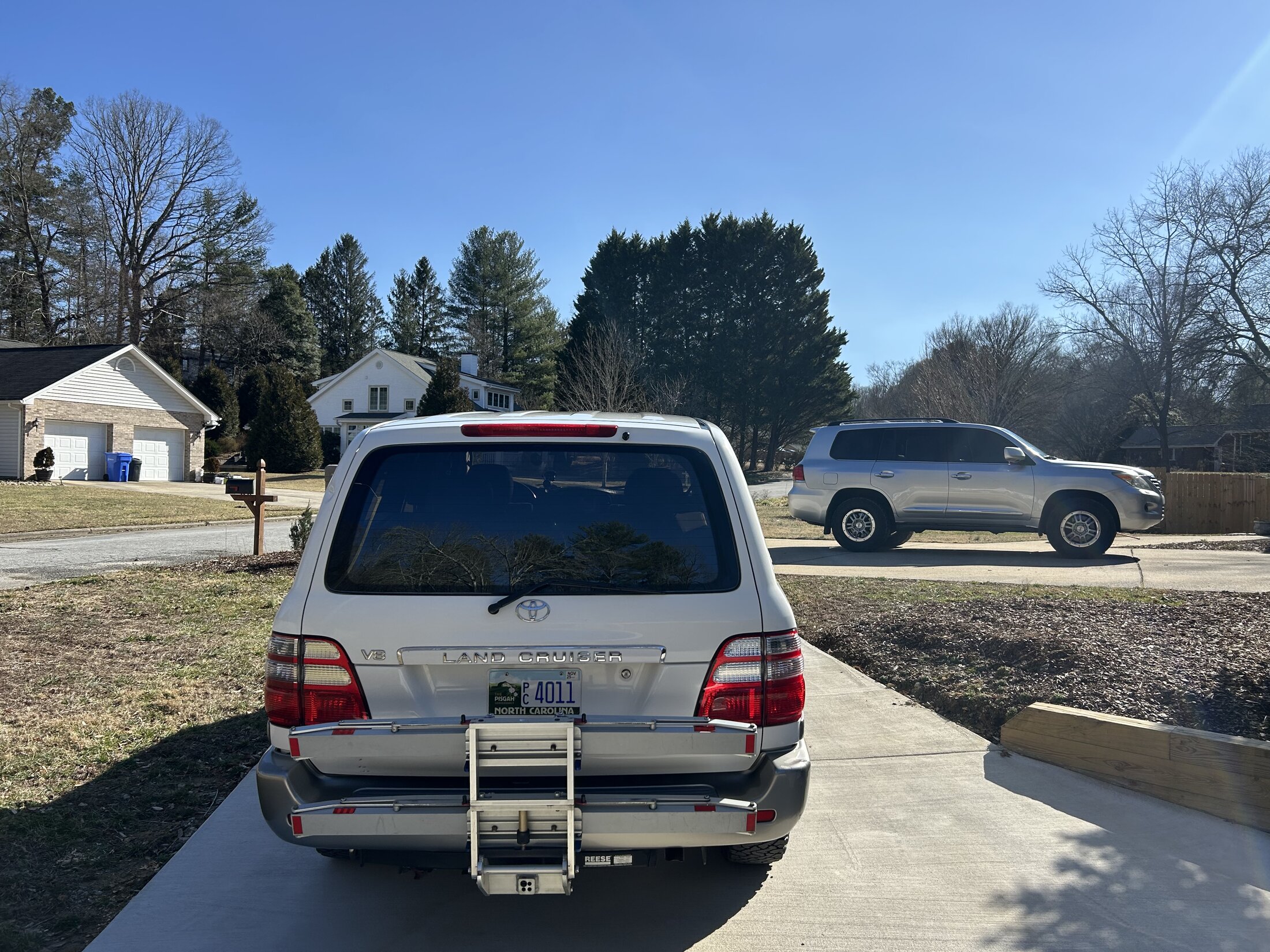

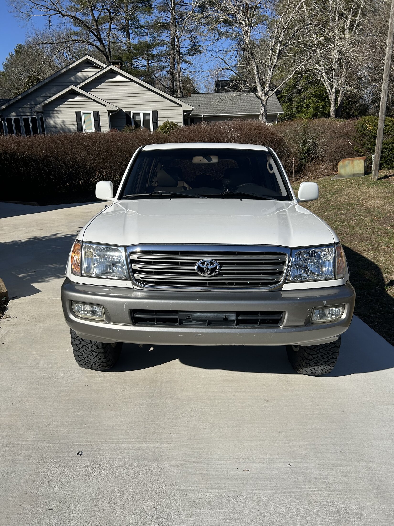

Got the 200 Series wheels mounted up to some 275/70/18 BFG KO3’s. Also a good shot of the new wheel spacers and OME Rear Springs. Really digging the look. Have a few more issues to sort and I will call it good for a while.
