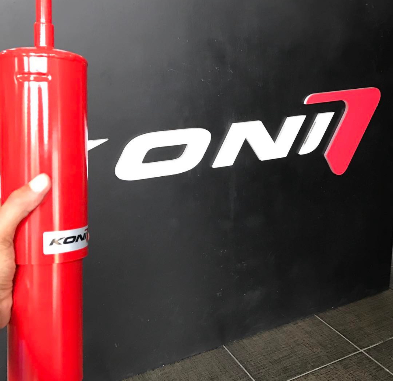

From my personal experience, I would recommend Koni RAID 90's. Replaced my AHC, done over 40k km on smooth tarmac / rough corrugations and love them. They're not gas pre-loaded, so they retain good small bump sensitivity (mind you, I haven't tried kings or any other high end shocks).
Rear springs are the lightest load EFS, front TB's - Ironman
Nice Hundy! Not familiar with Koni RAID but I will look into them! Is that an AUS company?
Thanks!
I think they're from the Netherlands. If you can get a hold of them in the US, I would say they're worth taking a look

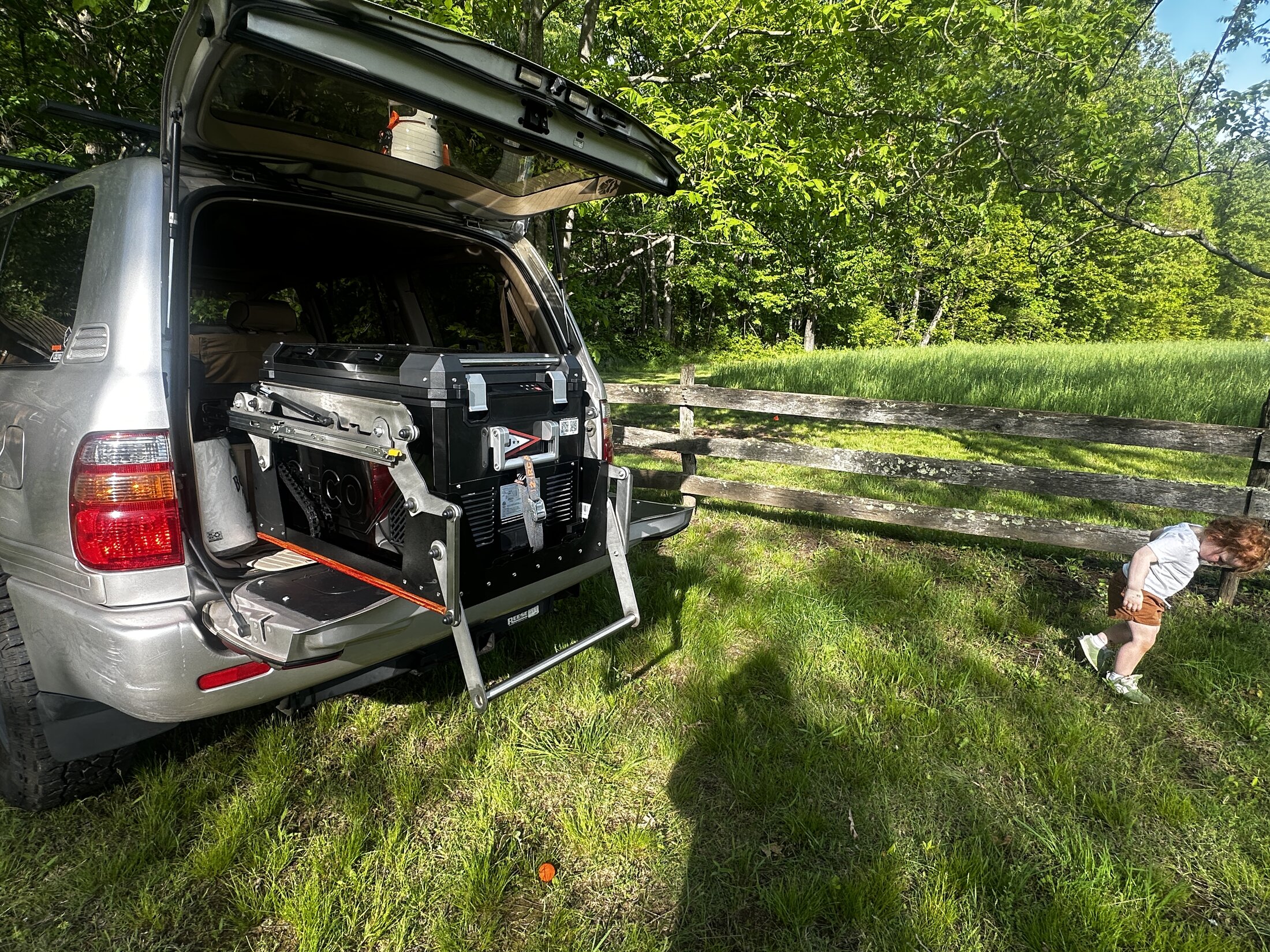

I love love love my IMS shocks and 167 springs like @GerLC100. I also have airbags in the back to level it out if needed. I think I’ll go to 185s when I add a rear bumper.

View attachment 3917237View attachment 3917249View attachment 3917250
KONi Raid indeed. Personally tried and tested this with different rigs like Disco1, Nissan Patrols GU/GQ, LC80, 100 and 200 series and a few GWagons. It’s manufactured in The Netherlands.
