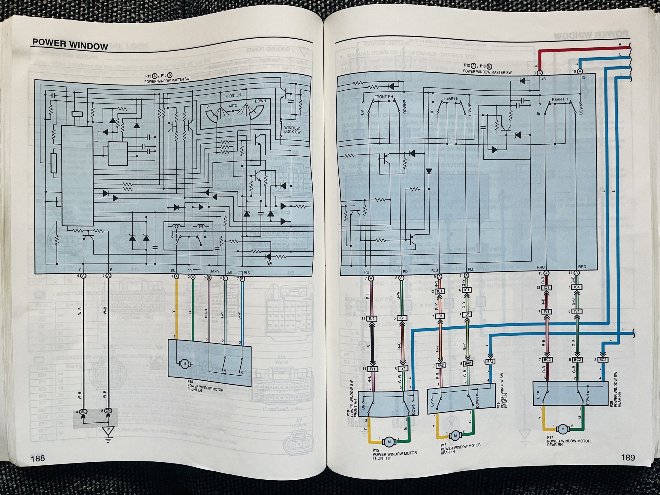

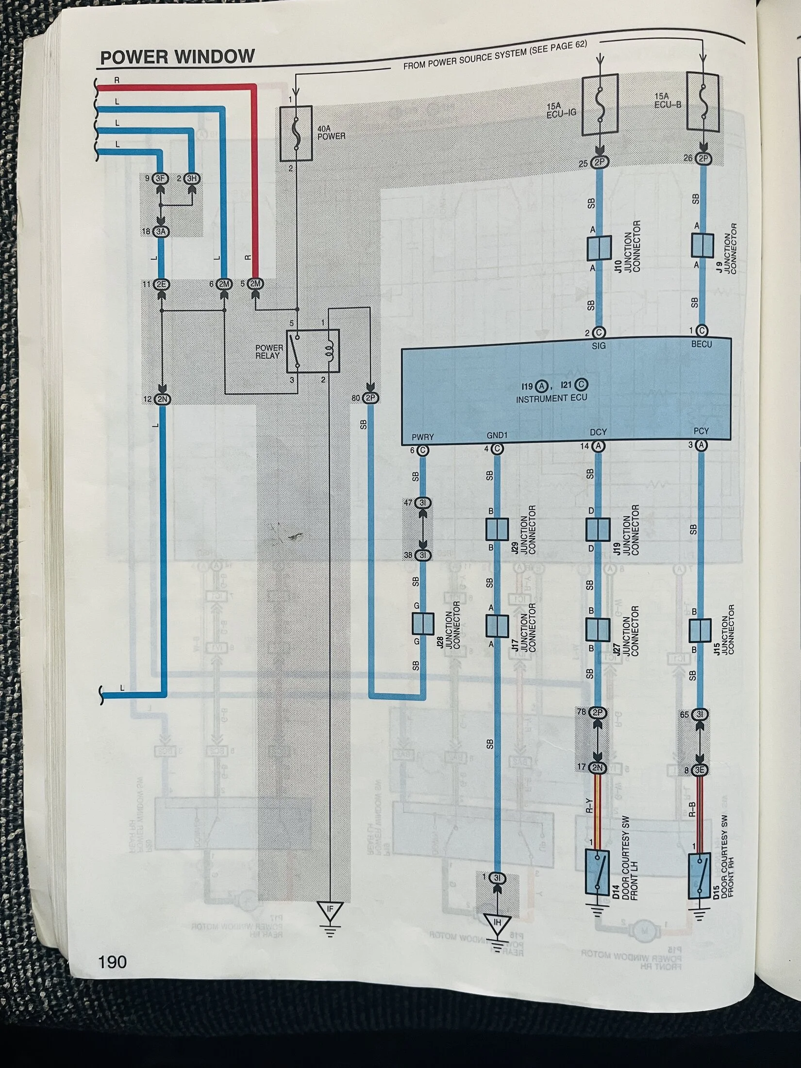

I think I finally found a wiring diagram with it- and it simply says IG- which I think is insulated ground. I’m going to solder connect the two ends together today and see if it fixes the master window switch issue I’m having .
The blue wire is the power connection from the driver’s door power window switch to the three other doors’ switches & motors. Hook it back up and all should be good.
