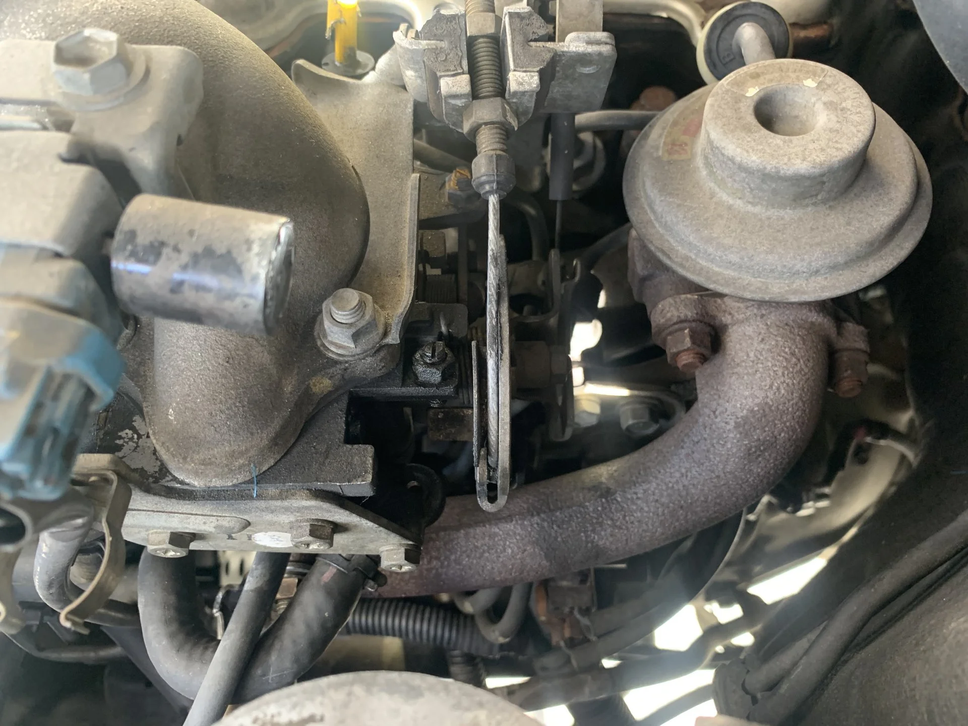

Hello, absolute rookie here but currently locked down in NZ and wanting to have a go at doing an EGR delete on my LJ78 2LTE. Could someone please walk me through the idiots guide of how to do this? I have found a few threads with bits a d pieces but all a little difficult to understand for someone not mechanically inclined like me! Lastly any other suggestions for 2LTE improvements I can do from home without supplies would be awesome!!!
Thanks in advance
See first photo (cleaned engine bay as first lockdown mission) Am I correct in thinking the EGR is in this area (2nd and 3rd photo)

You are right on the money, the EGR valve is the UFO looking thing right next to the throttle cable. Just follow the the pipe on both ends of the UFO looking thing, one goes to the Exhaust side and one to the Intake that is where you will be putting the block off plates.

Thanks for the pointer, unfortunately I am a little mechanically challenged and was hoping someone could give me a step by step guide of how do this?

Thanks for the pointer, unfortunately I am a little mechanically challenged and was hoping someone could give me a step by step guide of how do this.

Honestly you don't need to be mechanically inclined to complete the EGR delete just make sure you use plenty of PB blaster and dont over tighten anything. I was also looking for a step by step guide but couldn't find one so i just pieced it together by looking at multiple different posts in regards to it. Dont over think it, i was stressing a bit to but once i started getting into it was a piece of cake. While doing the EGR delete i realized these engines are fairly easy to work on, the hardest part is messing around with the diesel pump other than that everything is straight forward, dont be intimidated
