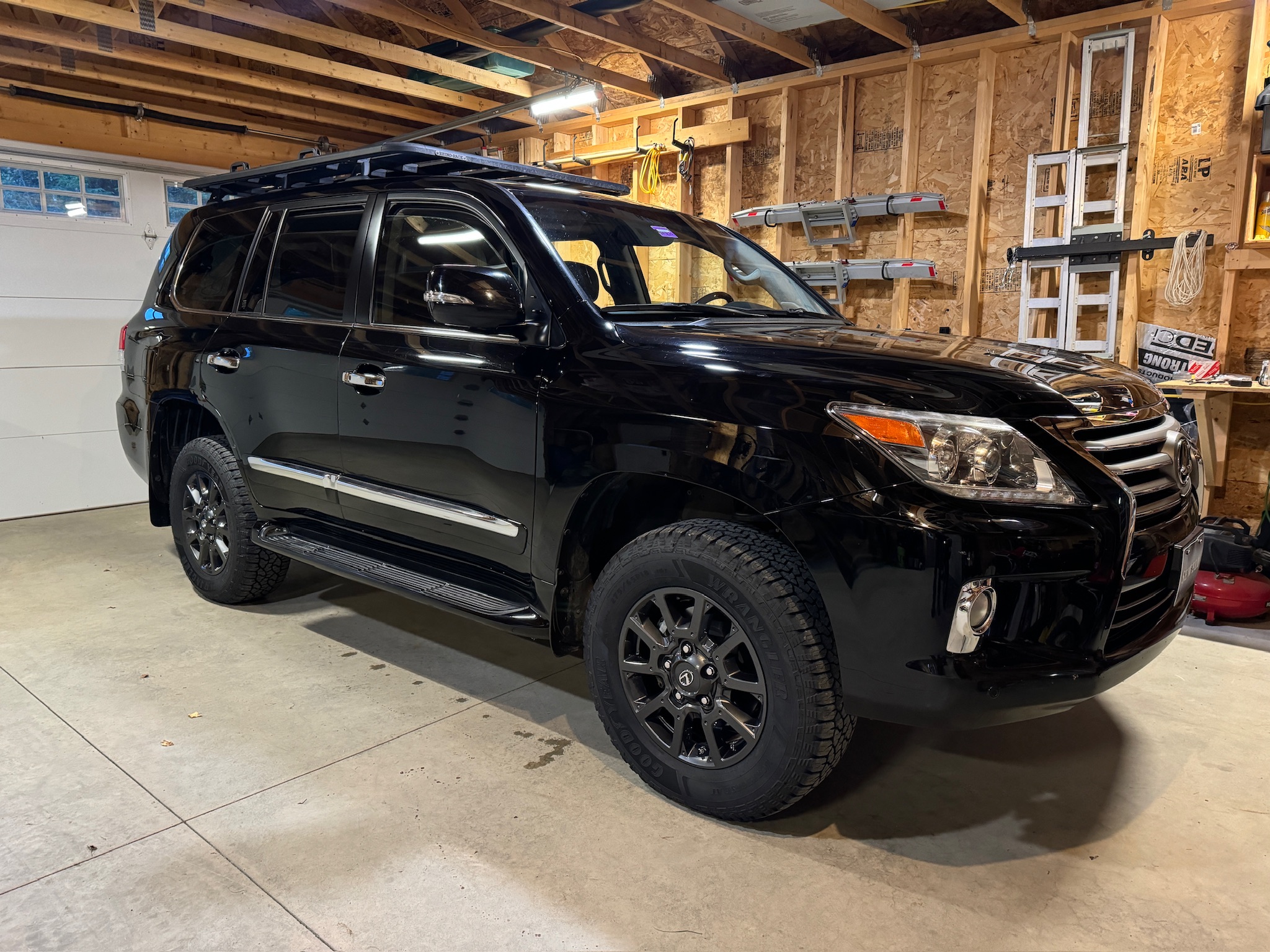

I almost always pick function over fashion and prefer an OEM look. With a great selection of Tundra take offs in a few different colors and styles, it's hard to beat the Tundra 18" wheels at roughly $100 to $150 per rim.
For reference, I recently picked up some 2021 Tundra Trail SE rims (tires were shot) for $600 and sold the OEM 20" rims and tires off my LX for $550. Since 18" tires are usually about $50 to $100 cheaper than 20" tires when comparing apples to apples, there's a financial justification to getting nicer (in my opinion) looking and better riding setup.

good looking wheels.
what offset are they? if they are what I looked up, I'm confused as they look much further out than 60mm offset would imply.
Thanks. Not sure the offset of them, but all Tundra rims of this design should be the same. The picture is a bit deceiving, they don’t stick out at all. I’d actually prefer them to stick out just a bit more. Which is odd for me as I REALLY dislike the go kart / wheels beyond the fender look.
Funny, I have Dobinsons UCA's and if my current tires weren't so small they would definitely rub the UCA's. And mine are 60 offset as well. But they may be wider wheels. Not sure. Your obviously dont rub, so no issue there.
