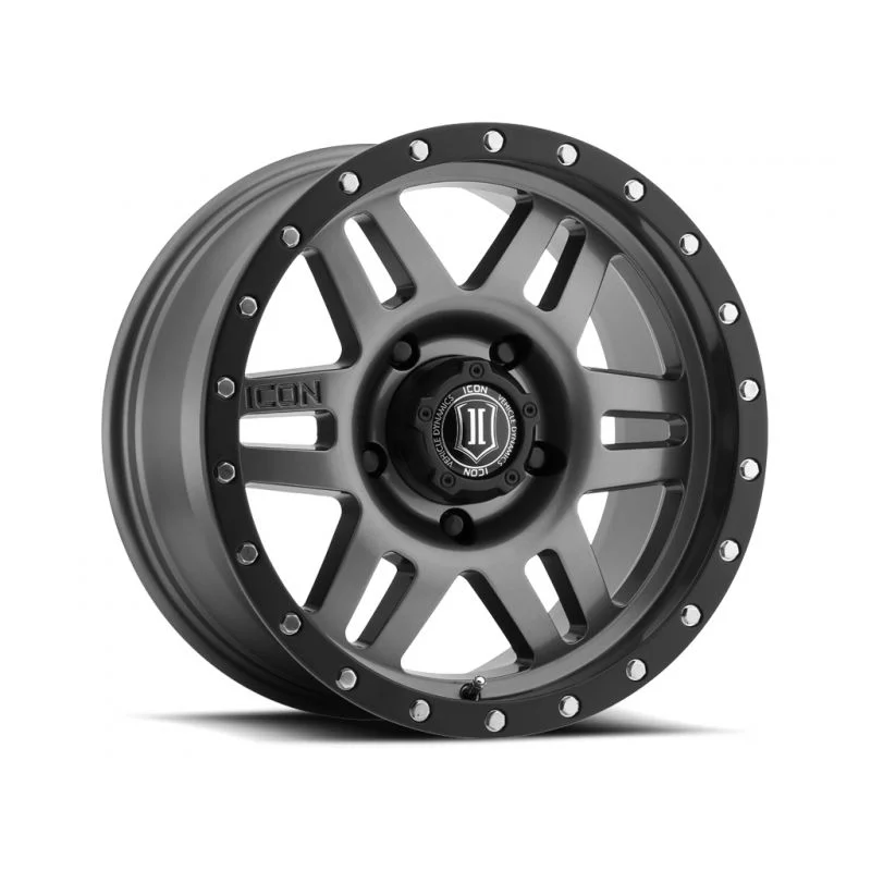

2nd and 3rd choices that come closest to this fit are the Icon 6 speed and the Dakar’s. Neither fit quite as good as RW, but both very popular on this forum.
Icon:
Dakar:
or 4th option is keep the stock 18" and just get them powdercoated or vinyl wrapped to the color of your choice. I've seen XD wheels on 200's a couple times before, my opinion they don't look good. maybe ive just seen them on waaaay too many jeeps. Leave the XD's for jeep guys. I did look on the website and yeah 17" doesn't come in 5x150 anyways. Icon's are actually less money than the XD's, closer to the right offset, come in dark gray and are good wheels. 17" 5x150 is a very limited market

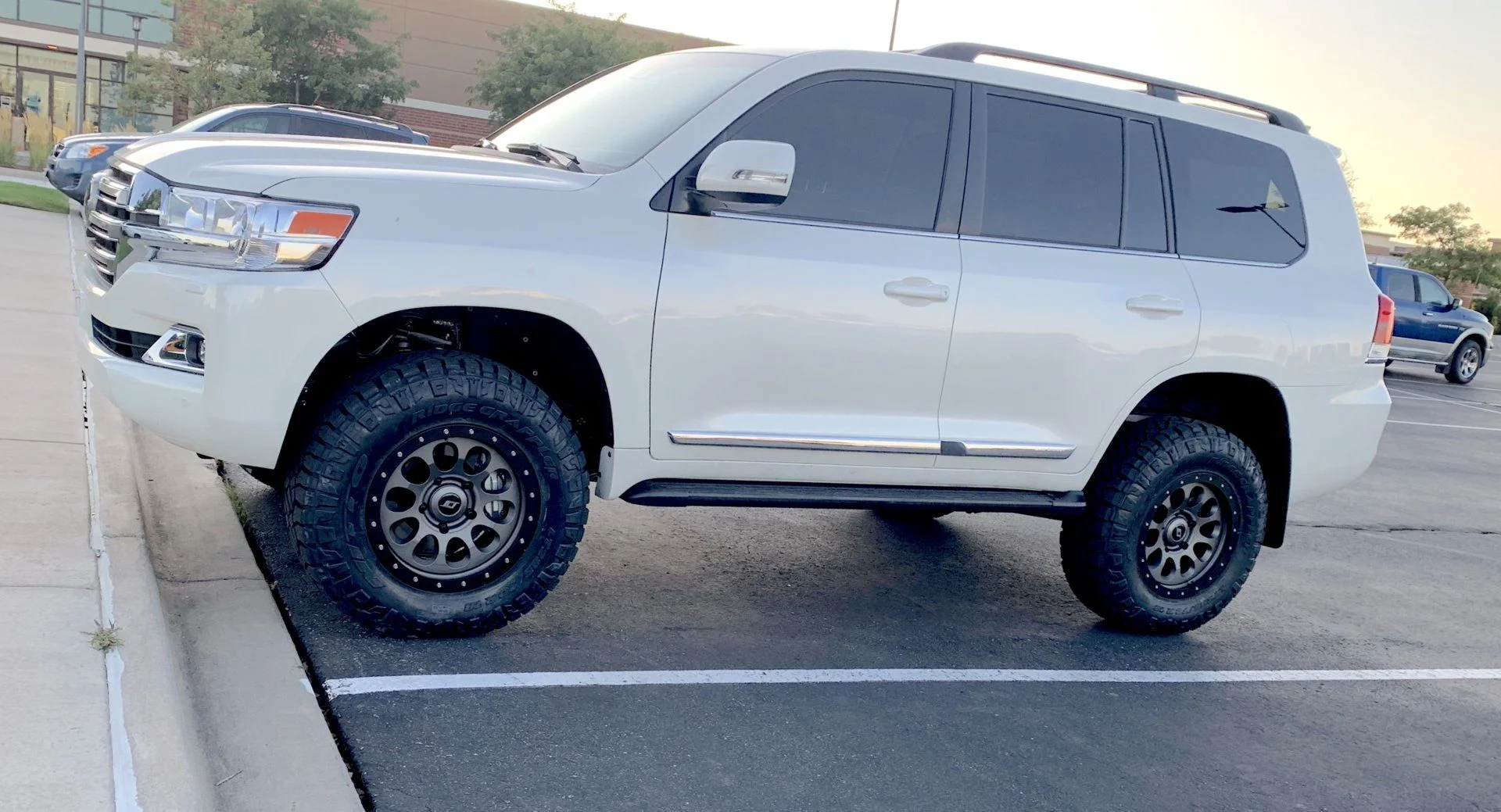

I have 17" Icon Alloy Rebounds on my 16 and no clearance issues at all.View attachment 2065243
Just found the ICON rebounds yesterday at Toytec in Denver and really like them. Toytec has the same wheel on their shop LC200. Like the price, weight, and offset as well.

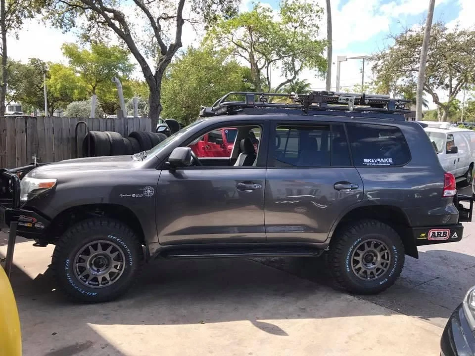

I have 17" Evo Corse Dakar wheels on my 2016 Land Cruiser. Only two fitment issues. With 33's the front tires rub on the mudflaps. I took a heatgun to them and reshaped them. The front wheels have to be balanced differently. The brake caliper just barely clears the wheel barrel. If you put wheel weights where the the caliper rests, They will rub against the caliper.
