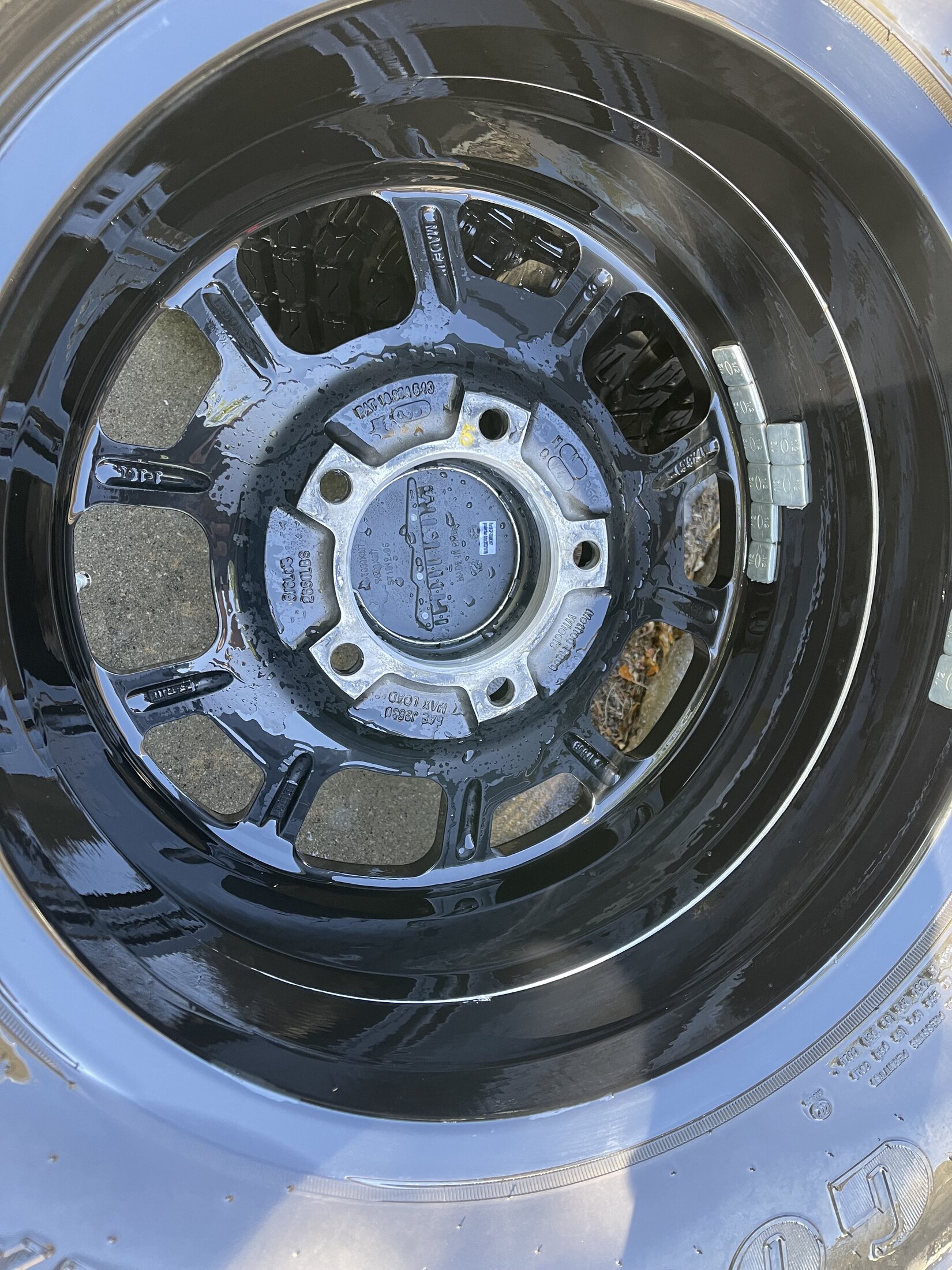

I don’t think you need to worry about running a smaller diameter wheel and rocks getting lodged between the wheel and brake caliper. I would say most 200 owners run a 17 if they’re modifying their vehicle to Offroad. Can’t say I’ve ever heard of anyone having this happen with a detrimental outcome. Rocks in between the rotor and shield is a more common occurrence for me atleast.

I actually had this exact thing happen on my 4 month old 17" methods. Oddly it happened on one of the rear wheels. There is a pretty healthy gouge 5/8 the way around the inside of the wheel drum. I think what happened was the town over from us chip sealed all of their roads and i think a chunk got flung up and lodged in between the caliper and wheel. I remember we were driving through town and heard a weird noise for a second coming up to a stop light. I didnt notice the gouge until i went to rotate the tires the other day.

That's exactly what a shop locally told me. So it does happen.
Apparently. And best I can tell, it happened just driving down the street. Not even like i was bombing down some gravel forest service road or something.
