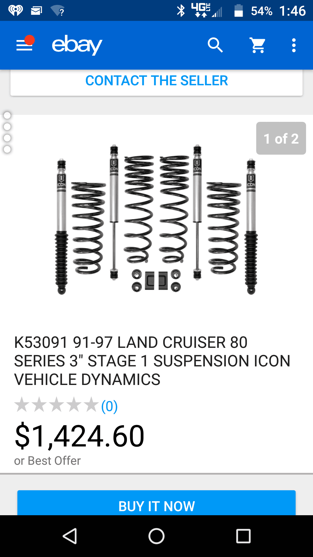

Hello fellow Mudders...
Has anyone installed or has any reviews to share on the Stage 1 kit? Considering this kit over an OME 3" lift setup.
Any comments / opinions appreciated. Thanks in advance.

Yeah, right now the Icon is the best bang for the buck in dual rate as far as a complete dual rate suspension kit. Just get the kit!

Did you read the first post here? That's the Stage 1 kit. You'll want to get brake line extensions too.
