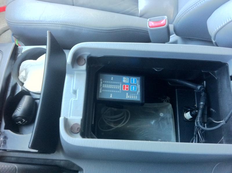

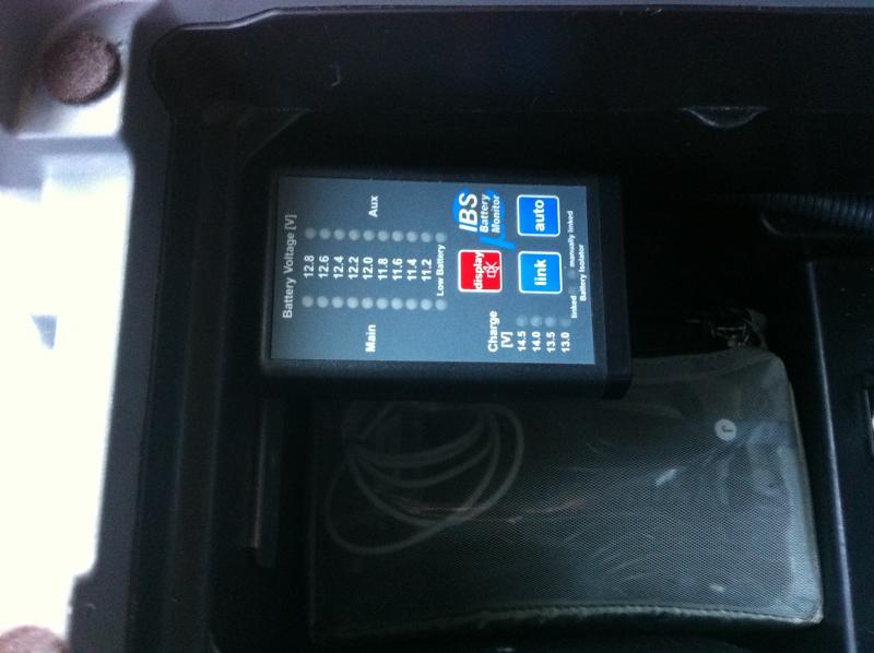

Getting ready to do mine and heres where I mounted the controller:
The display showing status only lights up for a short time when you press display. Otherwise, its just a green led or two telling you its charging.
It would be bright if it showed the status all the time, but it only does it when you request it
