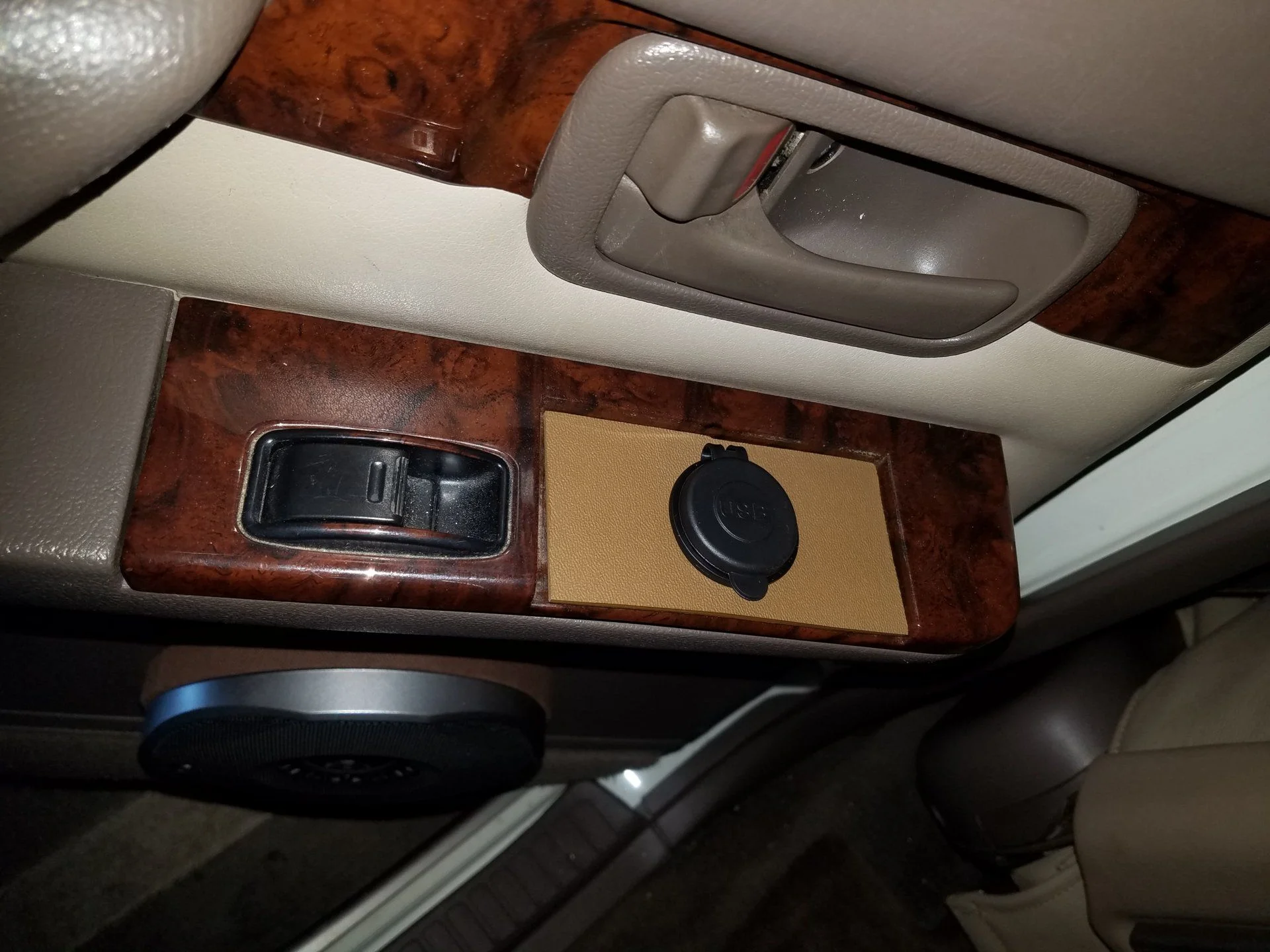

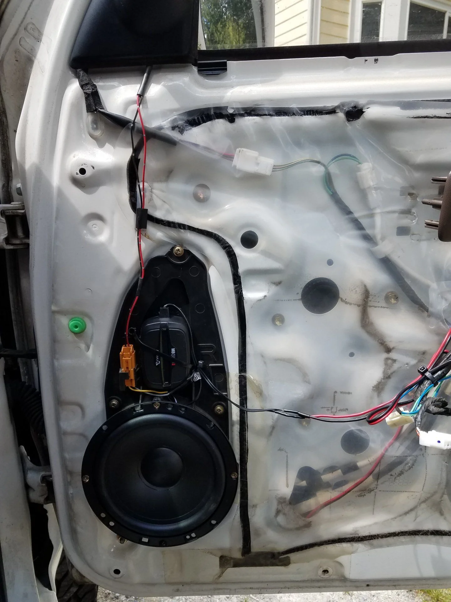

As I said earlier, 1 speaker didn't work so I guess that meant replacing something....

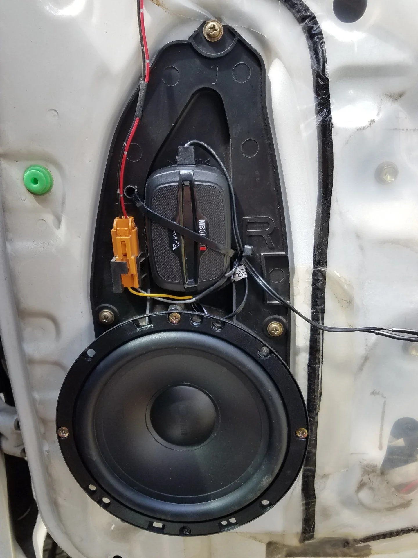

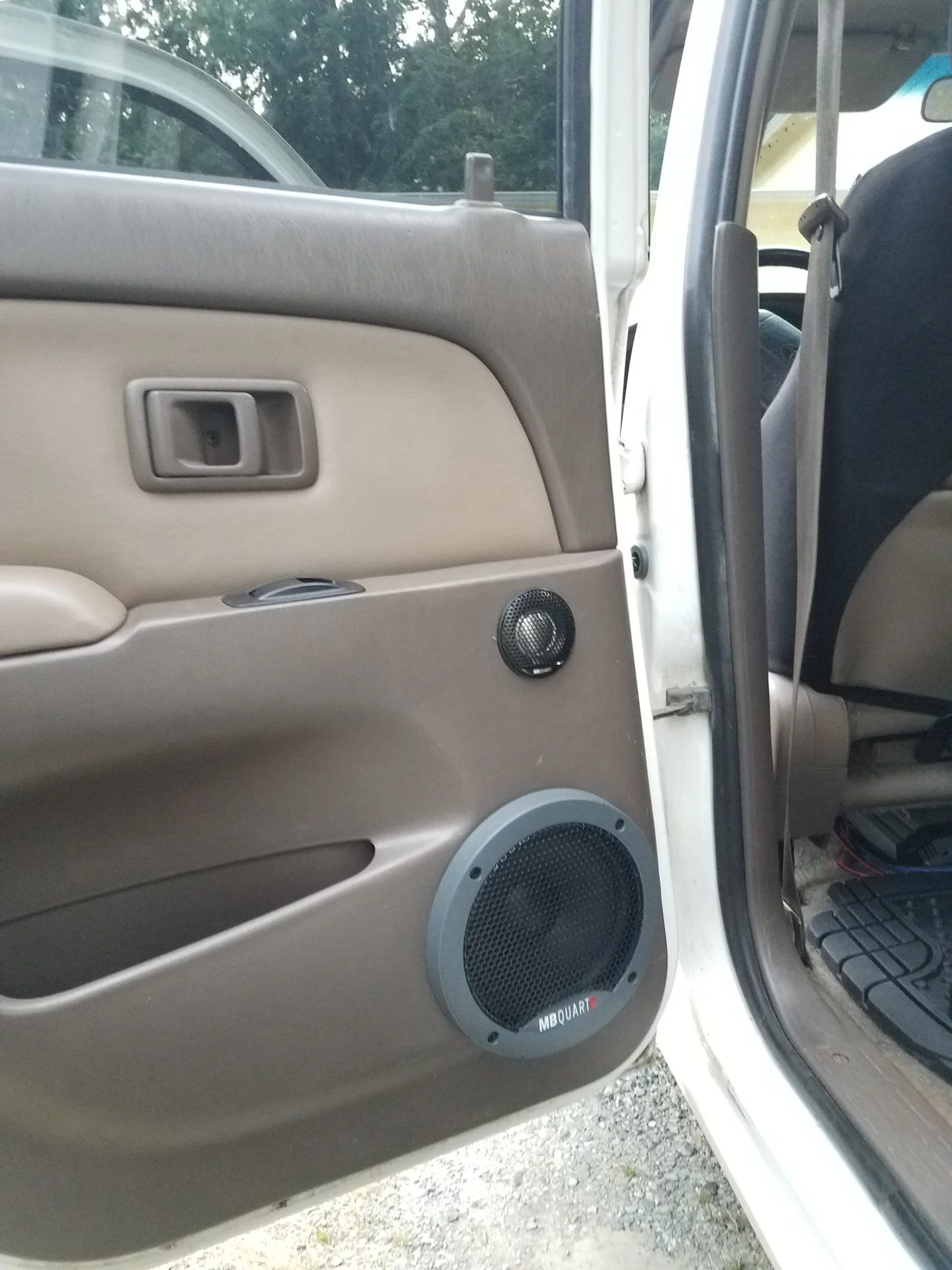

Installed a Hifonics 4ch amp (I had one of their class d amps in an IS300 - it destroyed Rockford Fosgates top of the line 10" sub and made a Pioneer premier sound amazing) and 2 pairs of MB Quart components.
Front stock tweeters worked great with the aftermarket crossover - plus the MB quart tweeter wouldn't fit in the stock location. The crossovers fit in the front when I trimmed out the stock speaker wire connector then simply drilled 2 holes and zip tied it. It's a tight fit without the zip ties - they aren't going anywhere.
Speaking of not fitting.... 6.5"s dont fit in the rear.... at least these don't while allowing the window to roll down. So, as much as I didn't like it, they went into the door cards instead.

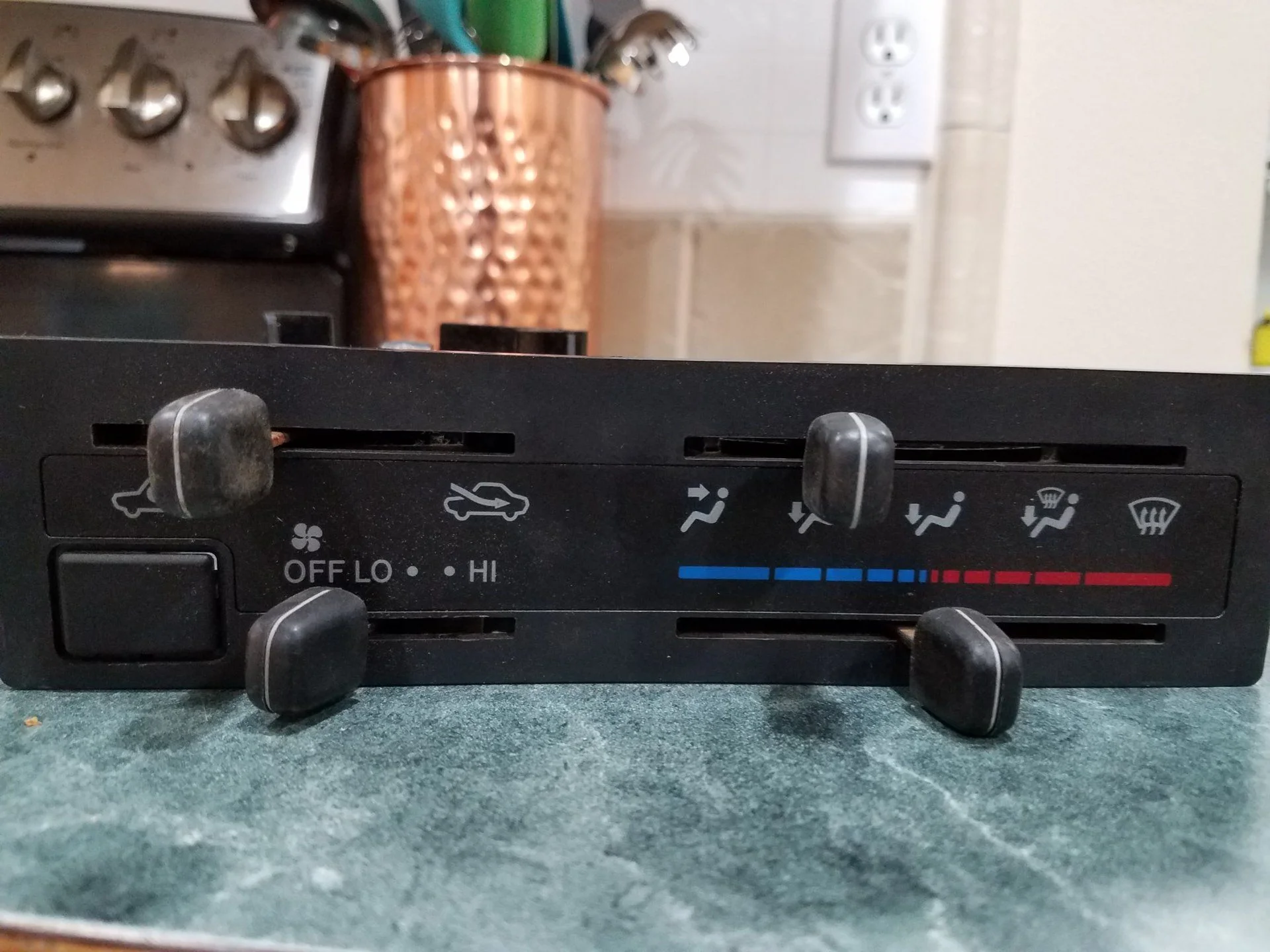

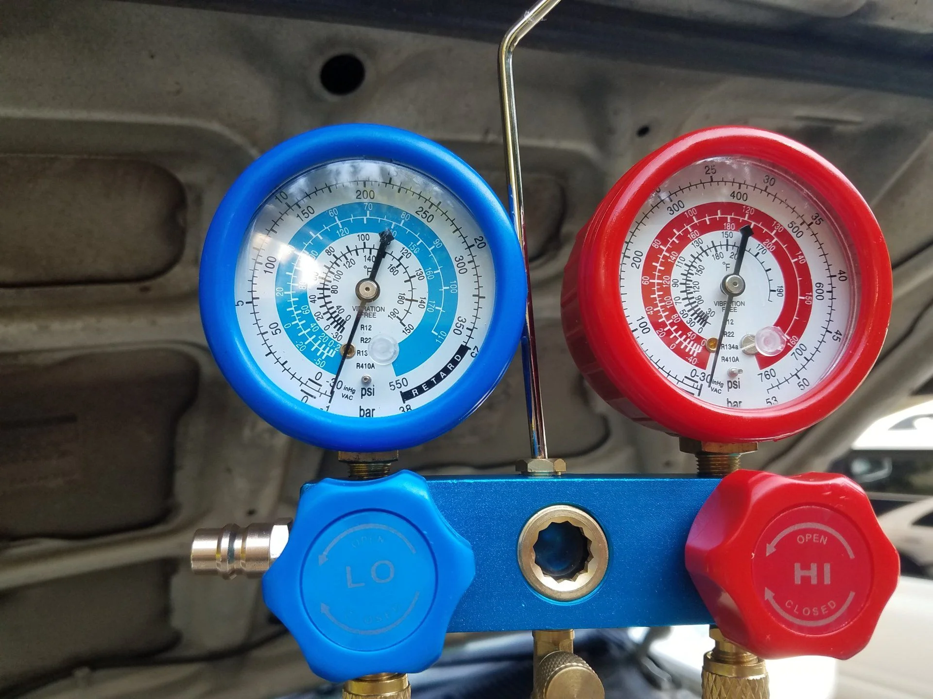

When you call a junkyard, tell them you need an AC switch, you expect them to say they sell it as part of the heater controls, you say 'ok, but to remove the heater controls is a lot more work on your guys to remove the whole panel and the AC switch requires to be removed first - either just send the switch or make sure it gets sent I'll pay the same either way", and they say ok....

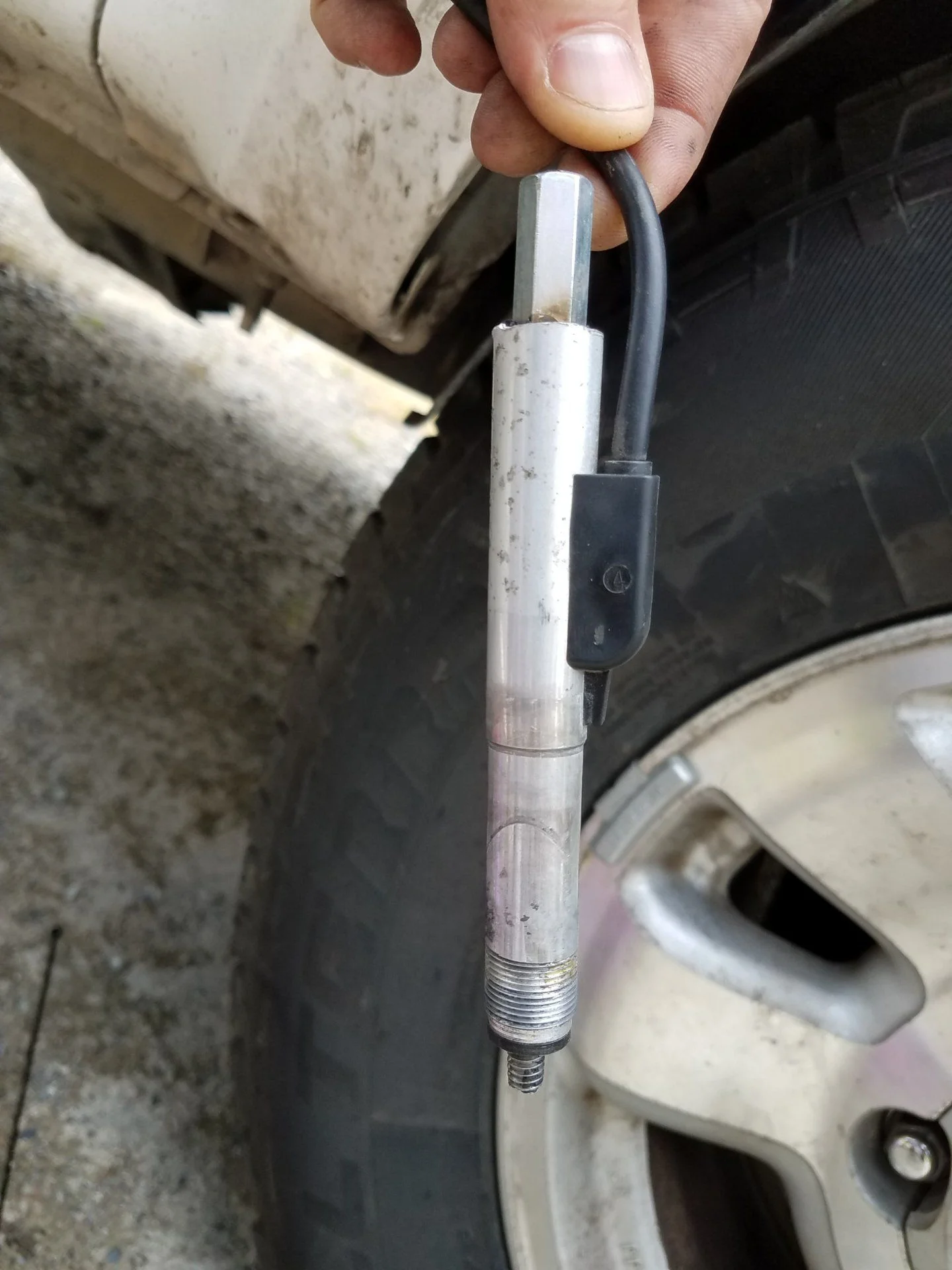

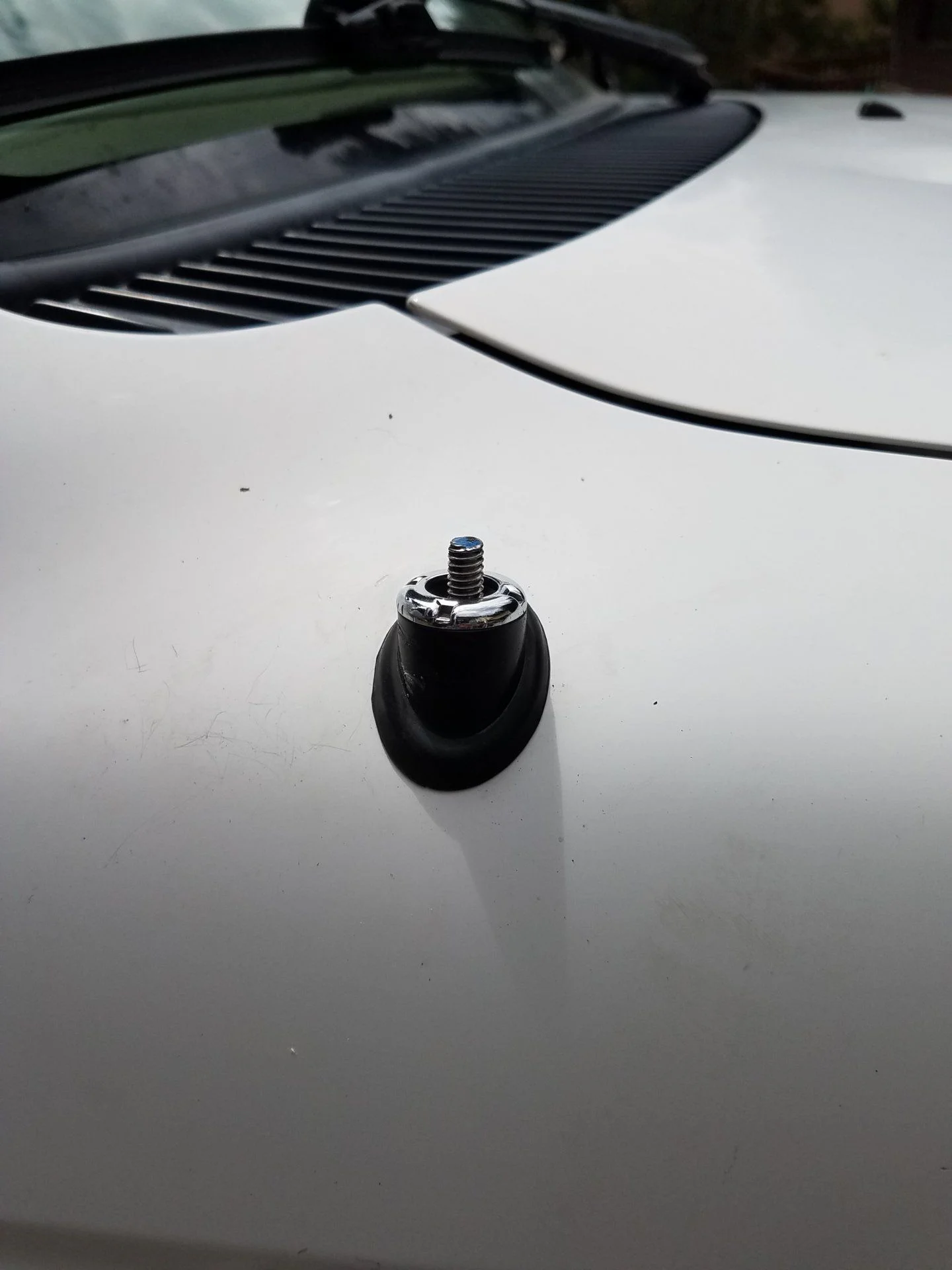

My solution to the power antenna mast being MIA, no radio frequency, and the power antenna motor driving me nuts.
Theres 2 couplers with the edges ground down in the middle to make contact with the antenna wiring and the bottom/middle couplers tacked in place. Its a tight enough fit that I had to tap it into the sheathing with a hammer.
The result is an antenna mast that will take any 1/4x20 thread or adapter. Seems to work exceptionally well.
All in all... $2 for the allthread, $2 for the couplers, and $11 for the shorty antenna with adapters.

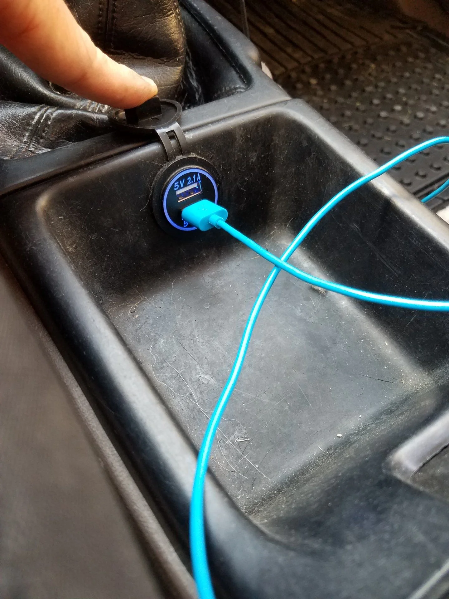

Wired key on via relay, high amp dual USB charger.... these are some of the handiest upgrades I do in my rigs.... and at under $20 including relay, well worth it.
Completely agree. Installed 3 so far in my 80 and one in my taco.
USB in this rig was wired key on, meaning it's off when the ignition is off.

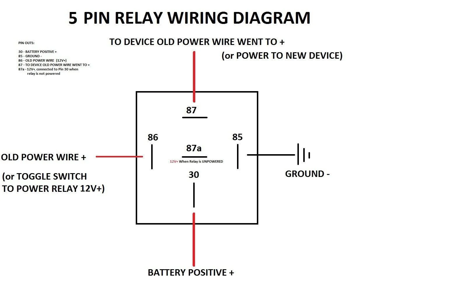

I used a standard 5 pin Bosch relay, a 4 pin will also work.
2 wires are run into the cab from the engine bay, 3 total wires are needed to be wired in the cab for this.
In the cab:
USB negative needs to be wired to a grounding location in the cab, shorter is better. Mine is about 12" to a bolt under the center console.
USB positive runs to the relay I mounted in the engine bay, pin 87
Pin 86 of the relay runs to a 12v switched source. Draw is very low as the relay has it's own power source. For this, I ran a wire and tapped into the 12v cigarette adapter.
Under the hood you should have the 2 wires from the cab to the relay.
Pin 85 runs to a ground - I like to make it short and use the bolt I'm mounting the relay to/with.
That leaves 1 more wire, which is 12v constant. Run it to the battery (or a good strong 12v source) with a fuse between to pin 30.
That's it.

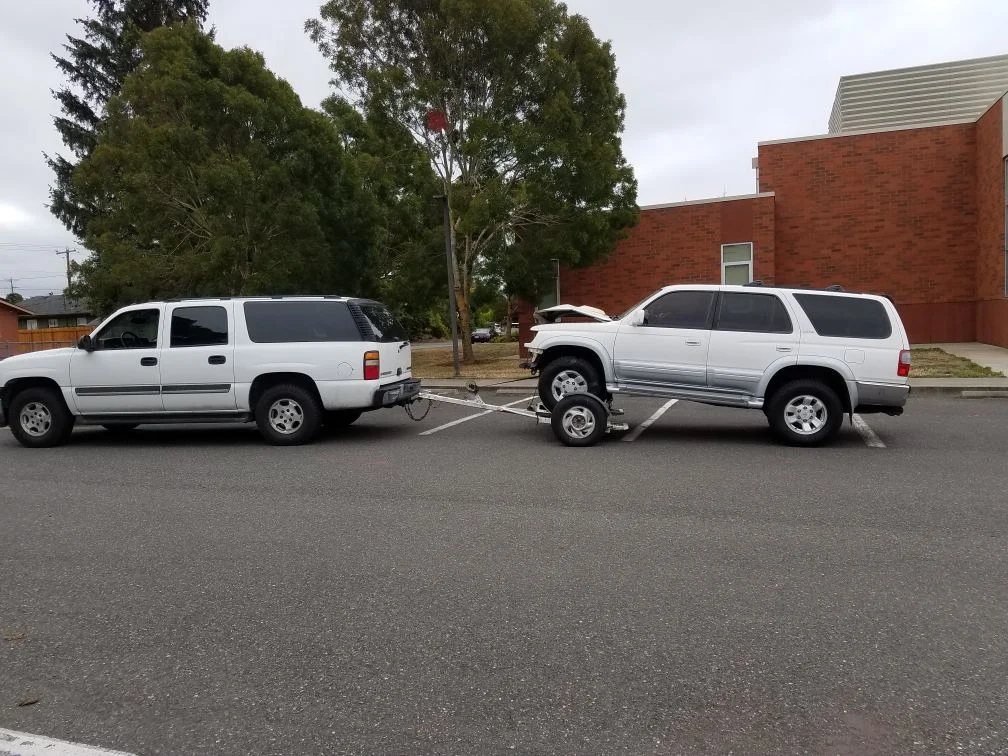

Well this happened.....
Now have a parts rig for the pieces ours needs....
