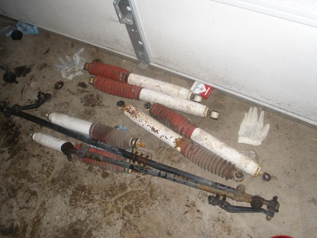

I spent the last couple of evenings tearing apart the front end to straighten out the SOA setup. It was ghetto fabbed a bit but no more worries. No more "extreme" Rauncho setup for me. Anyone want to buy this setup before it hits the cans?
I'll give you $20 for everything in the pic, except the rubber gloves and cigerette pack, if it's worth your time to bring it to the tech meeting.

You're kidding right Bill? Tell you what I'll toss in a half pack of 'Boro's for free if you want. I'll be at Tech with Brian. I'll have the "extreme" Rauncho setup for you if you're serious.
Honestly, I could use the shocks for setting up my new shock mounts (single shock) and I'm making a home brewed crossover steering setup.
(side note)I can make some crap out of some crap.:D
Bill, Dont worry about Phil. He just has no imagination. Just take HIS "garbage" put it on your truck and then tow his broke ass off the trail with his own "garbage"....Ill take a picture :flipoff2:

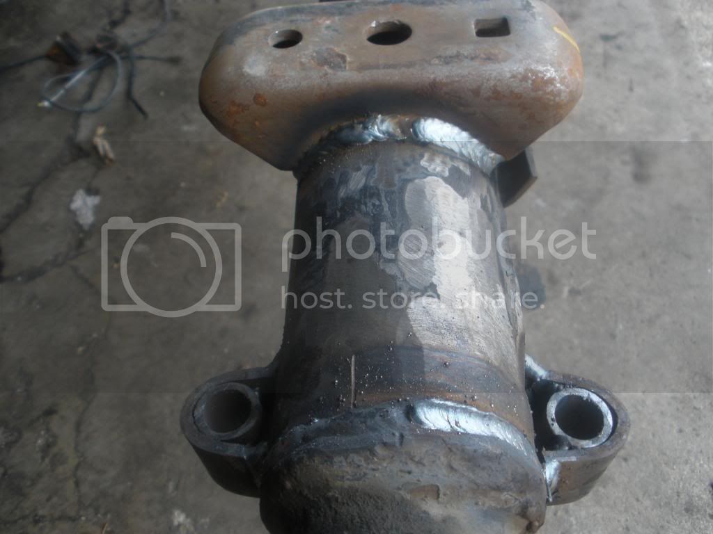

Tom did a great job on the axle and fabbed up a sweet chunk side spring perch for it. The dude can weld! I also scored a set of calipers that should fit! It looks like I'll be in the garage a bit this week!
